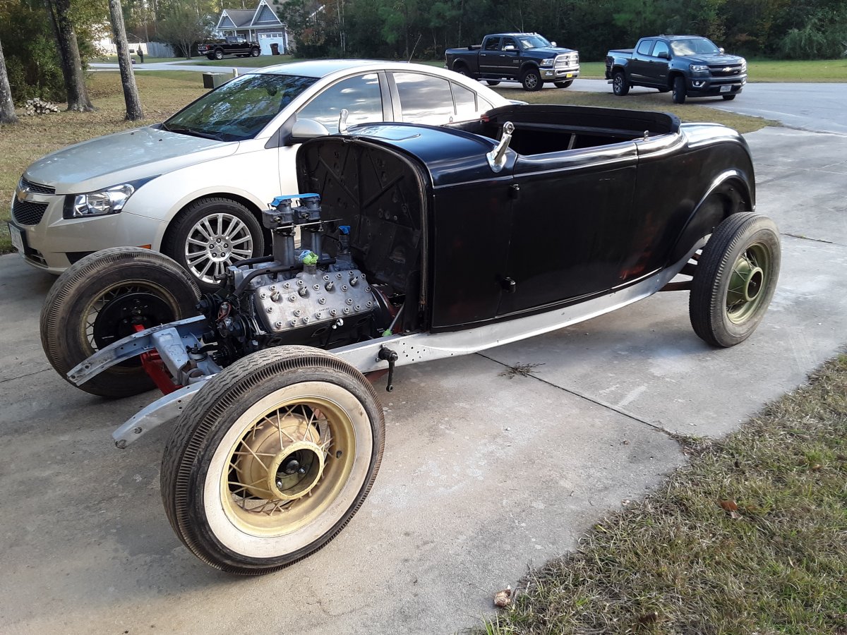

    Finally got the car on the ground with the new frame! Right now the car has 4.50 tires up front and 7.00 on the back. I'll be running 6.00 up front and 7.50 out back. Also, I only had 150 lbs on the rear cross member. Between the bigger tire up front, and the body weighing the back down, the car should get a little closer to level. Love the rake, but the cars sat a little more level in the late 40's.

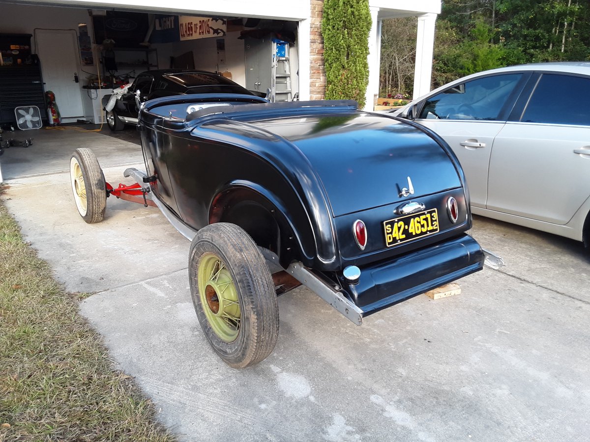

    Got the rear end set up with the Lincoln brakes and back under the car!

    Back on the ground with the Lincoln brakes and wire wheels. 6.00 tires all around, it'll be perfect with 7.50s out back. Lincoln backing plates needed some clearancing, but nothing too crazy. The front brakes require a spacer from Speedway to get the wires to fit.

  16. ALLDONE
    Joined: May 16, 2023
    Posts: 4,193
    ALLDONE
    did you put the wheel shims on top of the spacer????
  17. ALLDONE
    Posts: 4,193
    ALLDONE
    what drums are theres on the front??? and is that a wheel shim, if so does it fit tight on the lugs????
    Vic Walter likes this.
  18. RICH B
    Joined: Feb 7, 2007
    Posts: 6,299
    RICH B
    What you are seeing is the flange of the hub, not a spacer.
    On '46-'48 Ford drums, the drum is actually mounted on the inside of the hub's flange.
  19. ALLDONE
    Posts: 4,193
    ALLDONE
    so what did you do to be able to run the 35 ford wires????
  20. ALLDONE
    Posts: 4,193
    ALLDONE
    so if you can't bolt 35 wires to 40's drums... what was done???
  21. RICH B
    Joined: Feb 7, 2007
    Posts: 6,299
    RICH B
    You can use '35 wires with both styles of '40's brake drums; just have to support the center.
    Long time ago, we cut a piece of black pipe (can't remember the size) 1/4" thick and tack welded it to the drum.
    Now-a-days easy to just buy the support rings from Speedway.
    '46-'48 outside flange hubs many times have balance weights welded to the edge of the drum; they need to be knocked off to use '35 wires as the wheel center will hit them and twist them up if tightened down against them.
