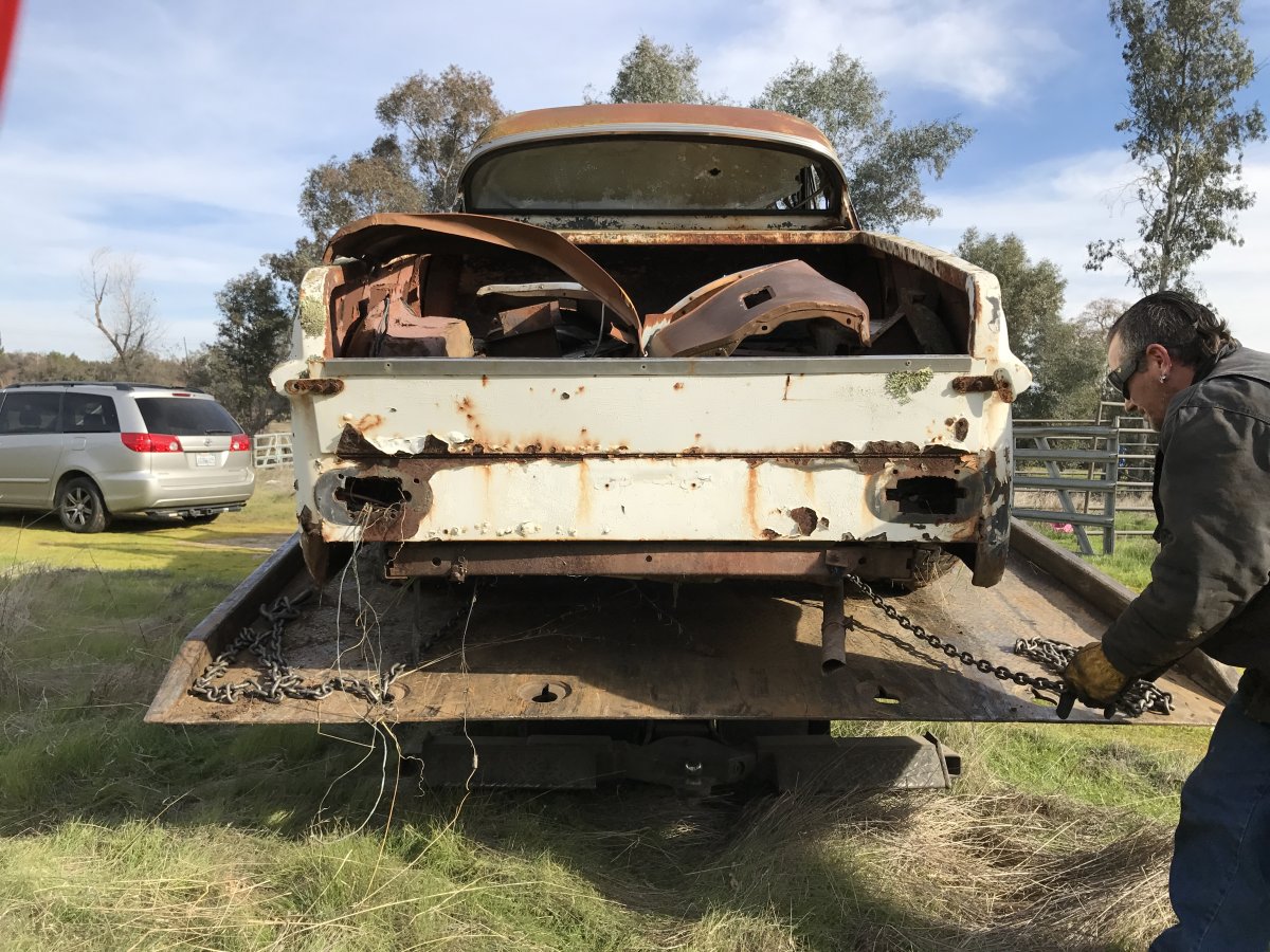

    Don'cha love flatbeds. I'd still be digging the damned thing outa the dirt and trying to get it on the trailer.
    The Good; the brakes aren't locked up, all four wheels rolled as we pulled it onto the truck. The frame looks structurally sound, just surface rust.
    The Bad; both rockers and about 6" along the bottom of most of the car need rust repair. Also the floor will need substantial repair. The rocker on the passenger's side is pushed in.
    The Ugly: there's hornet's nests in every nook-n-cranny. The tailgate is, uh, indescribable, kind of just a flap with a piano hinge and wood on the inside - very homemade looking.
    I think it was an automatic, I don't see a clutch pedal. Looking at the top and trim, I'm starting to wonder, it looks factory. I'll look more closely tomorrow, but I don't see any scars from splicing front and back halves together. The inside upper garnish molding is a long swooping piece with a courtesy light built into the molding just above shoulder height.
    BTW, I didn't actually sit in the driver's seat yet (it's nasty) but there is more room in the cab than meets the eye. I'm looking forward to slipping behind the wheel. Note; the driver's door won't unlatch - the passenger's won't close. No idea what taillights were on there. The lady has one old photo and is still looking - I'll get it tomorrow.

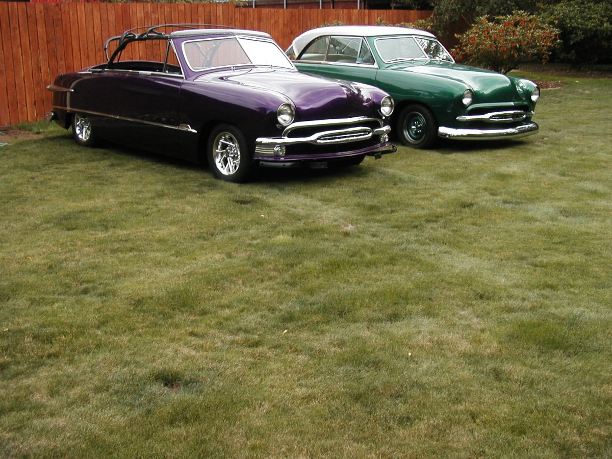

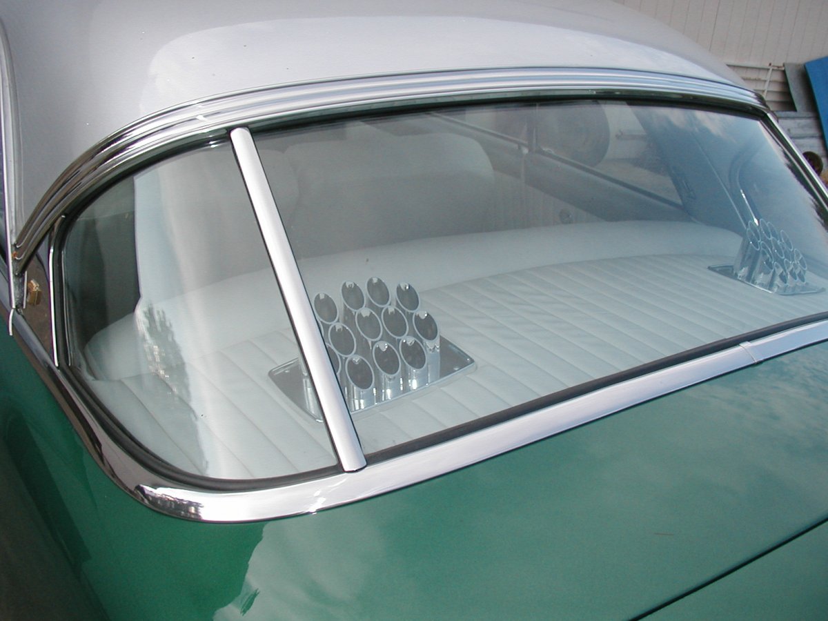

  13. I still think it started life as a 50 Vert. The door garnish molding is for sure 50 Vert. The roof molding with light is factory 51 Vicky. Here's the stock one in my 51 before I installed the lens.
    51 Upholstery 002.jpg I think your door glass frame is stock quarter window. I agree with adding the Stock 3 piece Vicky back glass. I don't think head room is an issue but would just look better.
    51 Upholstery 003.jpg Here's where some of my 49-51 knowledge comes from. These are 2 of my Kids getting an in progress photo saying Look at us! They both have been body off and back with my own 2 hands.
    P1010184.JPG I'm looking for info on your Frame. Does it have the big X ?
