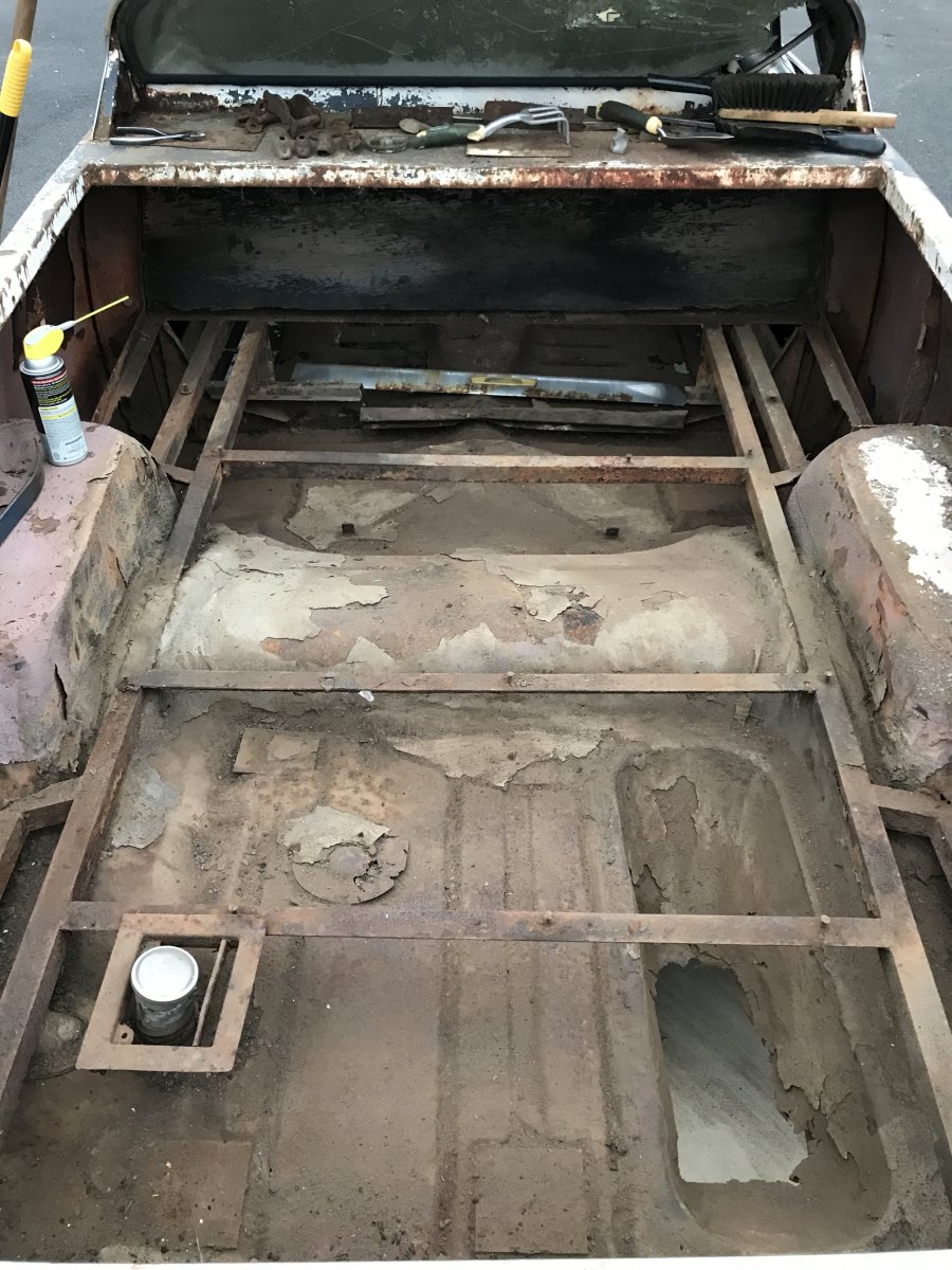

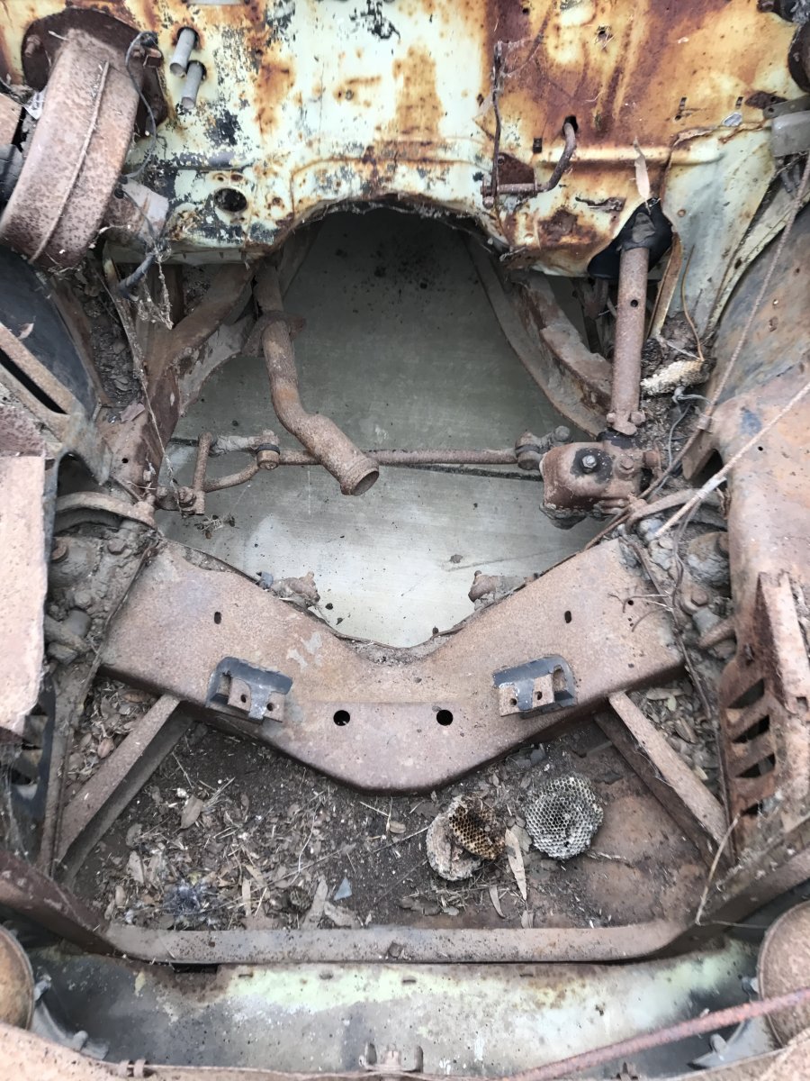

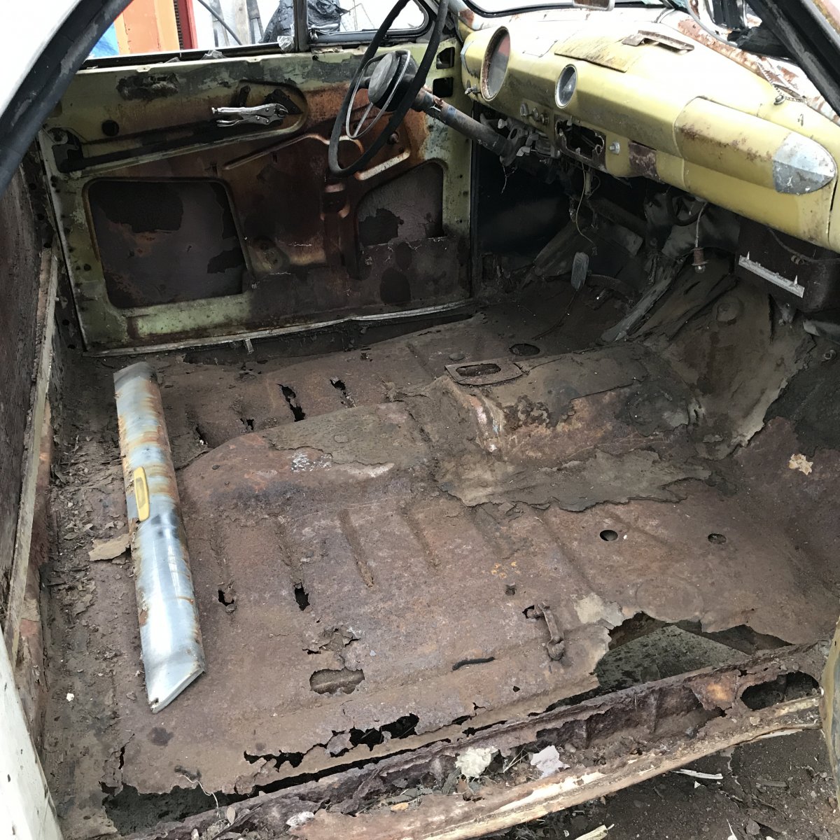

    Progress! My new best friend Eric (my daughter's boyfriend) helped me do the nastiest job this project has to offer - clean out all the debris from inside and the bed. Yuck. Years of broken gl***, leaves, pods, acorns and mouse sh!t.
    Eric found out what was keeping the driver's door from opening and he got it open, I got the p***enger's door to close. The seat is a goner, a tug and it pulled right off of the floor, the frame is rotten away. No big deal I have another idea for the seat anyway. We pulled off the remainder of the wooden bed floor and the original floor back there is pretty good. And there we found some clues.....
    There are hydraulic cylinder anchor brackets for a convertible top. So we pulled the hood and there was a super heavy duty X in the frame. So I guess old Harold started with a V8, automatic, convertible!
    We had just finished cleaning up the mess when the rains came ending the fun for today. Here's some pictures of the progress......

    From the size of those wasp nests, good thing you didn't find this car a few months ago!

    Ugh - hope you got all the bee/wasp nests out. Did you get a look at what's on that little plaque next to the speedometer?

    Until now it wasn't safe to go in there! lol. I'll look tomorrow, looking from outside at an angle you can't read anything, it looks like a tag with several lines and little inspection stamps at the end of each line. But then maybe I worked in aerospace too long......

  8. Trans hump looks to have been grafted in out of something Not 1950 Ford. Throttle linkage is Not Ford. Exhaust pipe has been grafted together and flange is not stock 49-51. Top flange on drive side of X member has a relief hacked into it. 51 Automatic brake pedal pad was larger than that one and they mounted horozontal. That is a 50 Top ram bracket, not a 51. It has a stick shift mast jacket bolted to the steering box, not an Automatic one. Yes that is a Convertible only Frame not a Vicky frame. That little piece of channel iron that runs from the p***enger side rubber motor mount to the frame rail, start right there on top of it with some sand paper and clean it off. You might find what your looking for. My money is still on it starting life as a 1950 Vert.

    So how does that ultra stout X work with say a Buick th400? I've never seen an X made of such thick material, it must be 5/16" thick.

  13. Yes, the X member is double tough. I guess that was to off set the Weeney frame rails. I think Henry had a deal with the R-R co. The actual frame rails were so minimal that they actually skip welded a piece of flat bar on them. My 51 Vert has a 700-R-4 in it with just a light bolt hole adjustment for the rear mount. I did have to bump the floor for fill tube to clear. I would guess the T-400 would fit a 51 floor just fine. I know a T-350 does with nothing done. I have no idea how what's there now will work out. I know there have been Buick motors put in these cars but have never had a hands on with one. It looks like your getting into the Car overall and will probably keep it and build it. If so before taking on all the rust that seems to take 4 times longer than we want and can burn down the drive if not careful. Personally, for motovation I'd remove the front clip in as much of one piece as possible and set my Nailhead and T-400 in place just to know it will or won't fly. Then put the clip back on and see what it takes for a Rad/fan install. Then you have just a bit more floor space and with a little luck it could be a driveway mover under it's own power. That will inspire ya for sure.

    Yeah, railroad or a structural steel/bridge builder! Man that X is heavy duty.
    My helper and I were talking about pulling the front sheet metal yesterday, we just got rained out.
    Good idea to get the Buick in there, unfortunately I don't have a transmission for it at the moment. If anyone has a line on a Nailhead TH400 in California let me know.
    The Buick I have has center sump pan, I'm hoping that it will fit without dropping the tie-rod, unfortunately the starter is on the steering box side, we'll have to see how that works out.

  21. I was working on my Truck project yesterday thinking about this T-400 issue and that X member. The X member by design don't lend itself to modification very well. Back in the 50's and 60's when using the Nailhead was a common option the factory Trans behind them was in fact close drive. That was what made bellhousing adapters the standard part of a swap and the stock 3 speed was left in place making the Motor Swap much easier (sometimes). I'm not sure what year your Buick motor is but going back to a stick shift might be a good option if the T-400 becomes a pain to get in place. I have some of that "stuff " in the left over pile. A latter 3 or 4 speed would be acceptable and bolt in the stock trans mount place. I have made the late 4 speed work with a stock 3 speed column shifter a few times so Vintage looks are there with an update. Just Food for thought here. Umm, Have I told you yet that I don't think like normal people?
