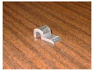

    Well, not exactly my first, but it is the first decent looking part from my mini mill! It'll hold new 5/16" fuel line tubing against the frame of my '55 Mercury. I'll make a couple more just like it for the complete tubing run.

    Here's another picture. "De-billetization" will be accomplished by using gun smith's aluminum blackening solution. [​IMG]

    Thanks, Jay! [​IMG] There's about one hour's worth of machining time in the piece. I'm certainly not geared for production! [​IMG]

    Looks like a good first project Chris.
    Small parts like that have their own difficulties in manufacture,
    like how to hold them without distorting them.
    Lil John Buttera showed how to do those in Hot Rod back in the early 80's,
    and a whole industry was born making copies.
    Power tools are great,but they still have their limitations.
    Don't be affraid to use a files and emery paper,
    if it will help you create the shape you want.

    the easy way to make more, is to make one really long clamp, as long as you can hold in your mill, mill the profile, then cut it up int individual pieces, if you can start wit a blank 6" long, you should be able to get a dozen clamps or so from it.

    Yes . . . but, as an old machinist once said, "It's just about as easy to make ten of something as it is to make one."
    I've found it to be true.
    When I made the brake line hold downs for the 32 - using an un-rare non-ferrous metal - I wasn't sure how many I'd need so I made twenty.
    Used nine and the other 11 are still hanging on the pegboard.
    They'll get used on the 31.
  10. Unkl Ian
    Joined: Mar 29, 2001
    Posts: 13,509
    Unkl Ian
    Some times it's easier to make more,than just one,
    because you can justify a better setup or different tooling.
    Most of the time spent making the first one,
    is in doing the setups and developing the sequence.
    So the cost,and time,to do 10 is perhaps only 2 or 3 times as much as the cost of the first one.

    Ed - My mill is a Harbor Freight mini mill. I got it for $459.99 (with free shipping! [​IMG] ) It's a nice, sturdy little machine, but it did take a little work to get set up for use. As far as tooling, I think I've spent almost as much as the mill itself. And I don't even have a rotary table, yet! [​IMG]
    Unkl Ian, Ray and Jay - My little clamp was made from a chunk of 1/2" square aluminum rod. If I can scrounge up some 1/2" X 1 1/2" rectangular aluminum bar stock, I can cut the profile of the clamp sort of like an extrusion. Then cut the individual clamps off the longer section. I wish I could raid the dumpsters at work for material, but that's a big No-No! I'll just have to see what I can find at the recycler. [​IMG]

    Don't woory about getting a roatry table too much.A digital readout is a better investment.
