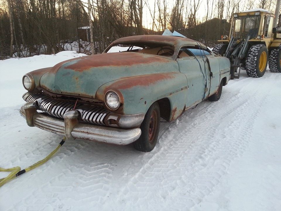

    At last my modesty rusted out merc arrived home.
    no floors , no rockers, badly shopped roof, rust here and there and so on ,,
    still happy as a kid on christmas eve :)
    the original engine is there with the transmission , and it seems to be complete .
    thats a keeper i think. eventually a swat for a merc o matic in the future.
    gona start trying to figure out the roof and the chopping . then the floors and the 4d to 2d conversion,
    i guess the first thing in order to do is to fix the back window frame they cutted apart. then maybe unchop it a bit, dont like the chop now way too brutal about 6 inches, goint to weld back about an inch , good that they kept all the pieces they did cut out.

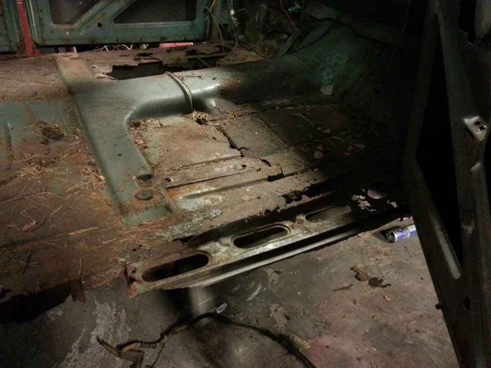

    oh forgot a pic on the floors.

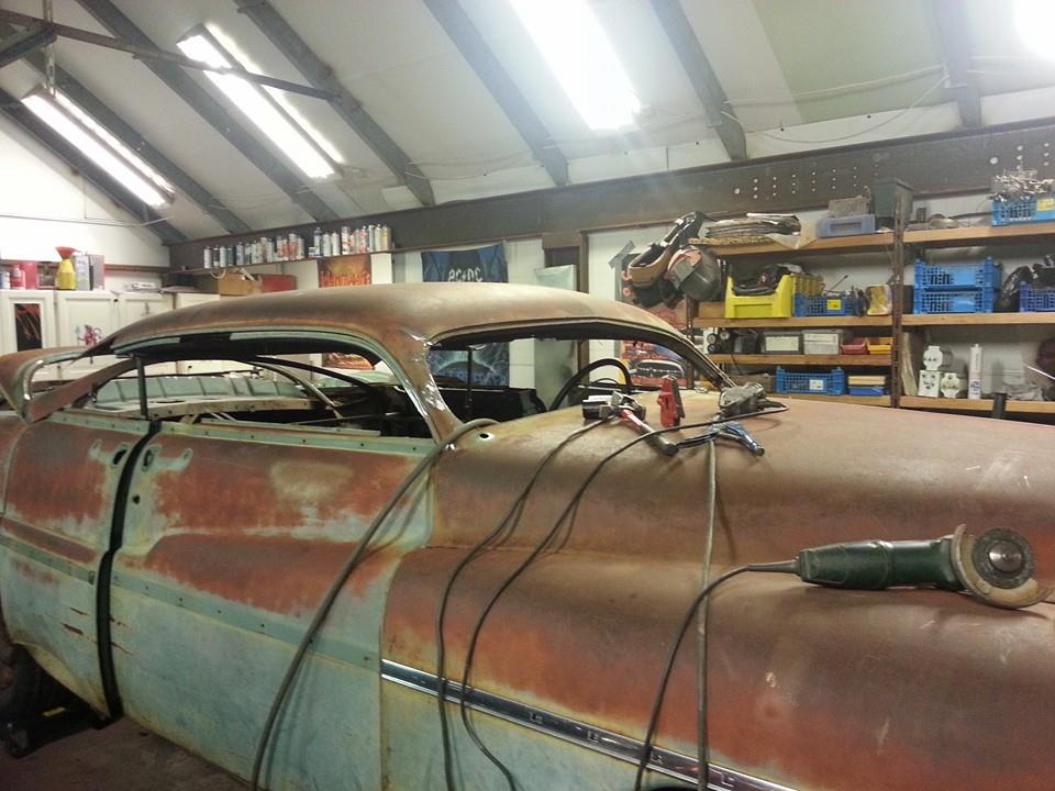

    Decided that i had to unchop it a little bit , 1 1/4 inches . looks much better now i think, still low but not crazy low

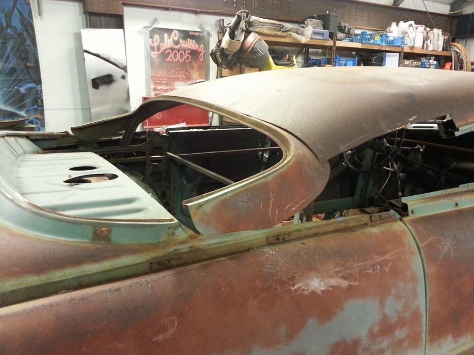

    finished all of the weld front , and started to mock up the rear pillars
    not so happy about the looks of it , but i guess they wont be visible at all when i put on the rear side window frame ,
    to bad that the previes owner did start the chopping. would have been easier i guess to make it a 2d before the shop, and then shop.,

    Your floors look pretty normal for a Merc of that era. Only in the desert southwest of the USA do you find ones that you can't see through as well. Coupe rockers are available if you are going to convert. That and some floor pans from Matt could save you some time. Rear quarters & coupe doors are out there but likely a long way from you.

    before i can continue with the back pillars i must do some rust repair on the top of the rear fenders,. where the roof meets the fender,.
    one side done now one to go ,

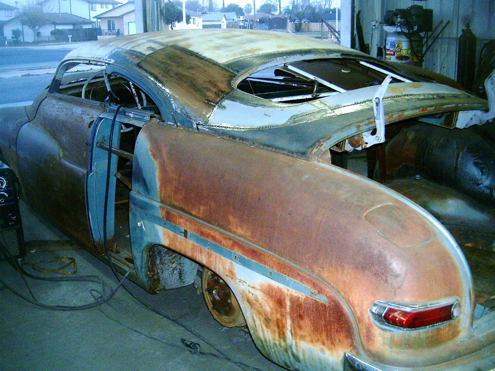

    here is a four door made into a 2 door using a 50 ford back window upside down
