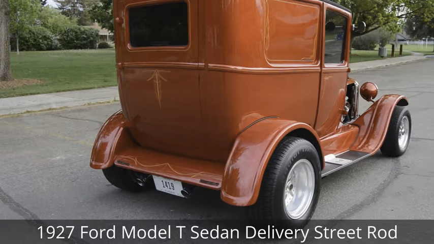

    at the bottom center of this car there is a pan between the fenders i never see on cars is that a stock piece and whats it called if it is in modern terms i would call it a lower rear valance panel but she aint modern

    I guess the pan is for looks. It could be that if its a real delivery it could had been a footstep there.

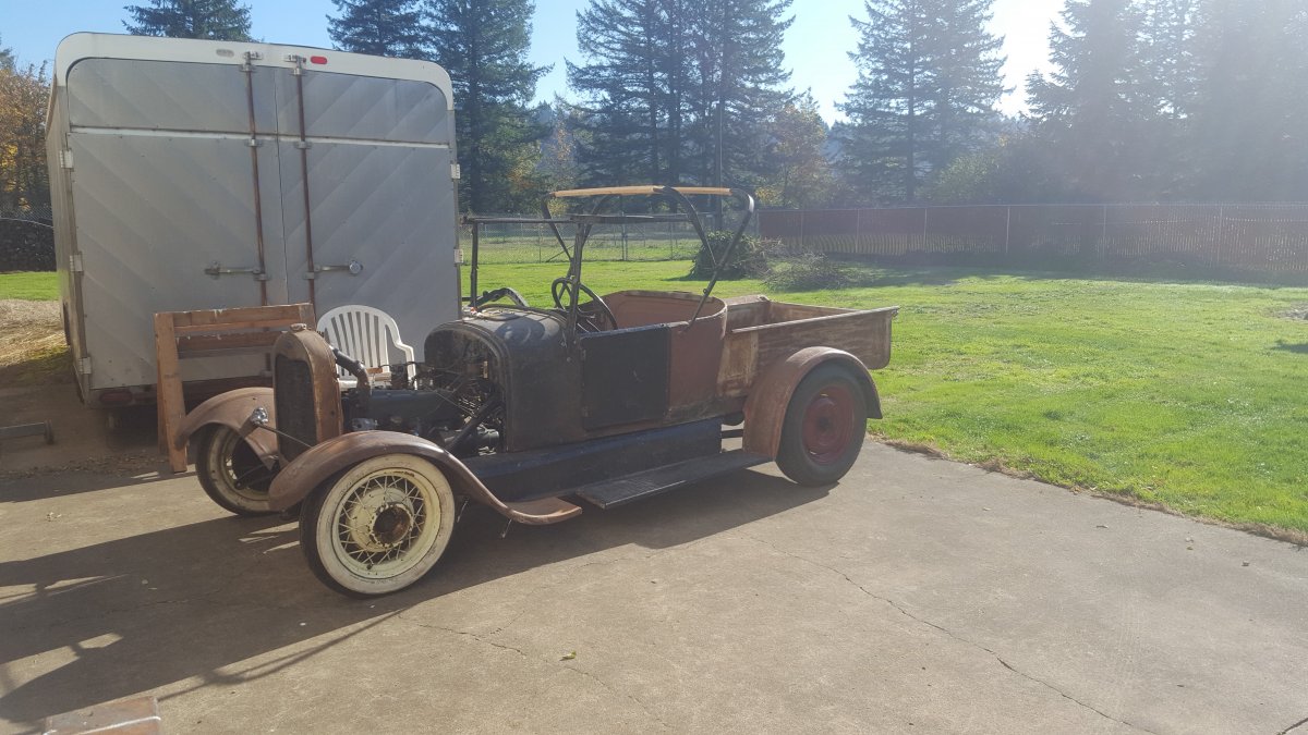

  24. Sounds like you've come up with a plan and built it in your head. That's all good. One thing I know for sure is there is no set rules or instructions. That's all good too. As far as the different T body's they all share the same exact Ch***is. Same goes for the Model A series. My 27 R-PU is on a stock wheel base Model A ch***is. This reqired 6" added to running board and splash apron. The stock T hood is now to short in stock form.
    The Wizzard
  25. I'll just add here that with rear fenders mounted is stock relations to body this is about as low as you can get a T. This frame has a 3" kick in the rear with a 5 leaf Model A rear spring. I think y0ur plan for a large rear kick should be re thought.
    The Wizzard
    AndersF likes this.
