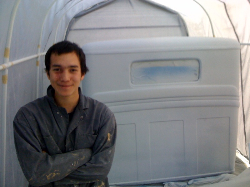

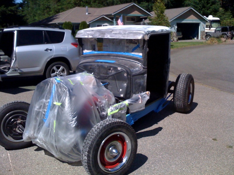

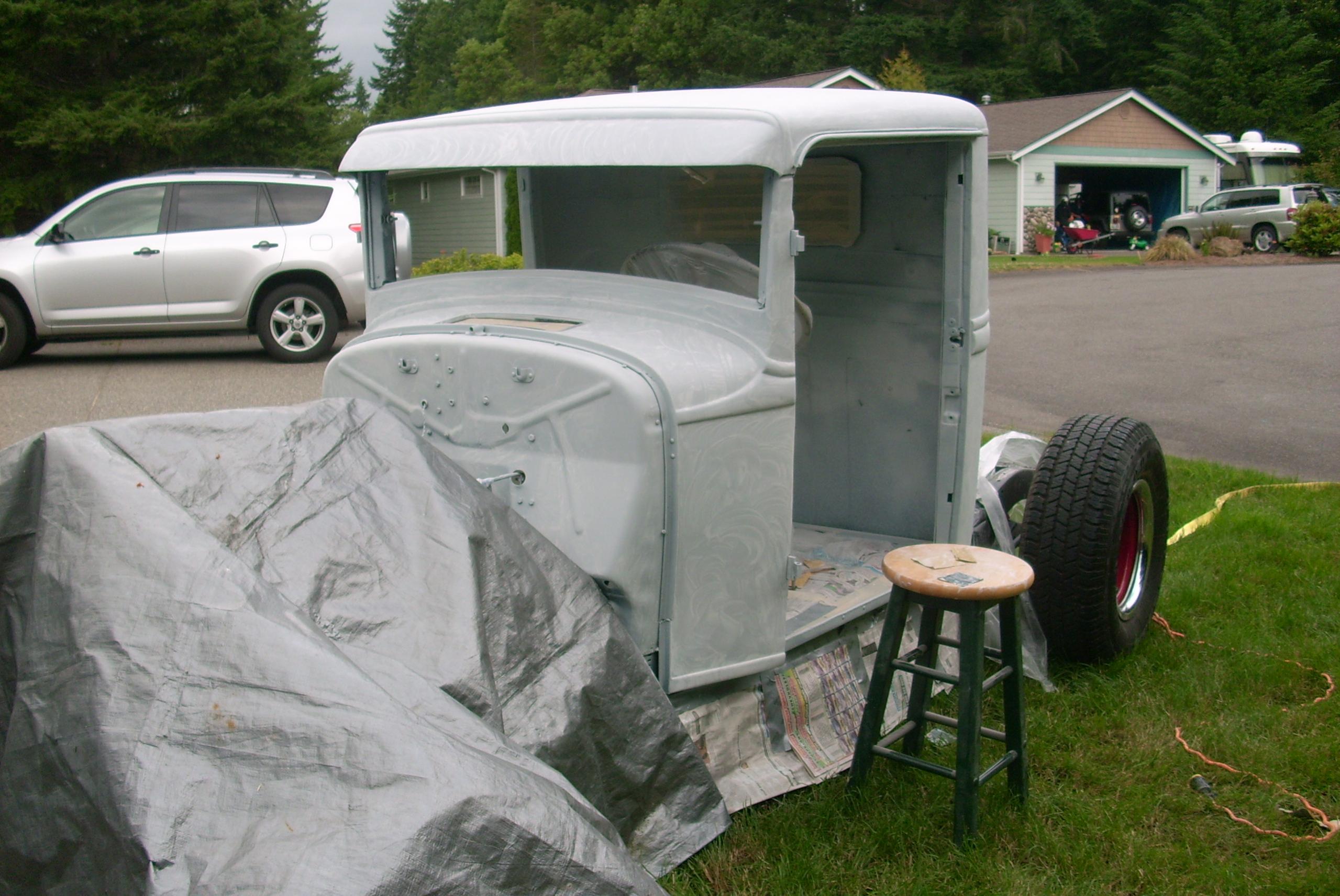

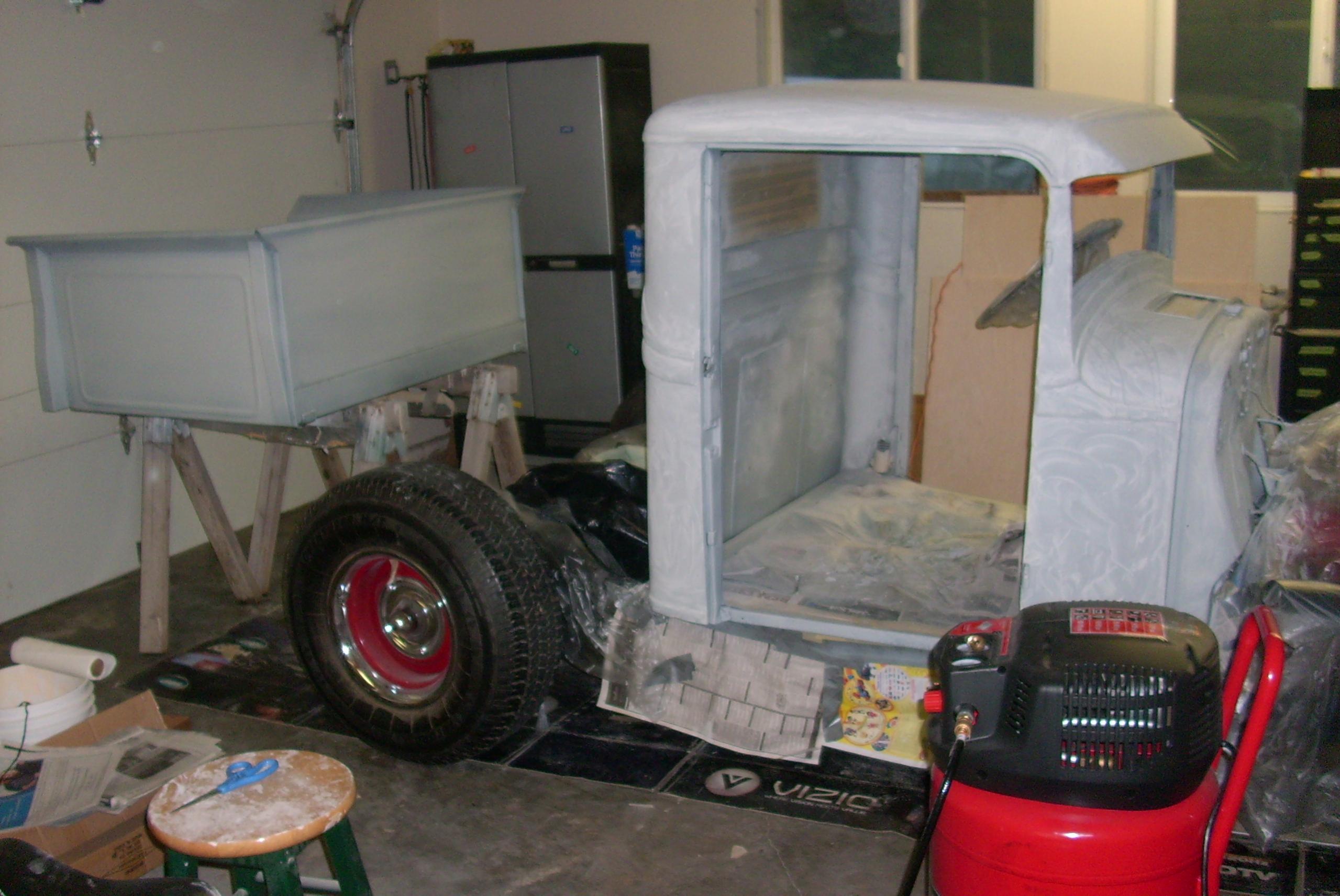

    Alright so I am 18 and in no way plan on having my paint job be perfect. To start, I was planing on taping up my garage and spraying it in there. However, my dad thought completely differently and didn't want overspray all over the place and paint on the floors and what not. So I went to Harbor Freight and bought a cheap car tent garage for like 200 bucks. I put plastic on my lawn and then the tent up and made a little booth of a sort and had a fan with filter paper over it pushing the overmist out one side and a filter up high on the other.
    Since I have no background of hot rodding or even working on cars in my family and most of my friends don't either, none of us knew too much about painting. All I know is what I have read on forums and here on the hamb. So i went to our local Shucks (O'Reily Auto Parts) and bought this Duplicolor primer that is already mixed with reducer and stuff so I wouldn't need to worry about it.

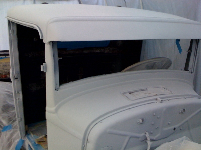

    Well we sprayed the primer on and it didn't turn out half bad. It was pretty gritty and i think we had the pressure on the tank up too high because it was coming out more like fine dirt being sprayed than a nice even line. We also were not using the best guns (Cheap harbor freight one and a Mac one with paint tips on them).
    So far I started wet sanding and since it definately showed a lot of areas that need improvement I am gonna do a little more body work and prime some areas and try my hand next with paint.
    For a bunch of kids that don't know anything about painting. It was fun to try learning a new thing. Definately learned a lot of things NOT to do haha.
    One question. What would be the best option for paint for me? I was gonna shoot this premixed laquer paint but I have heard lots of bad stuff about it? I plan on visiting our local auto paint store and talking with them.
    But, definately having fun learning.

    Make sure you have a compressor big enough to keep adaquate pressure at the gun. that may be why the primer was balling up at the tip and being lobbed onto the car. I learned that one the hard way with paint. there should be enough pressure maintained to keep the paint broken up into a fine mist, about 30 lbs into the gun at all times. Also, make sure you get a plastic air filter (cheap in-line at Harbor Freight) and put it in line into the gun. You don't want any moisture going through the gun with the paint.

    Nicholas, Good for you!!...Lacquer is a good start for sure....you can put a "guide coat" over your primer (a real light fogging of a darker color from a spray can) to help find areas needing attention when you sand the primer to get everything smooth...All my projects have been painted at home and have had mistakes...oh,well look good enough for Randy

    Done the garage thing, ventlate well! Not just for breathing, but to help keep you cool and not slinging sweat every where! Also get some one to help you out with a small ladder and additonal light. Oh did I say light, thats what was wrong in my garage! LIGHT that shop up!!!

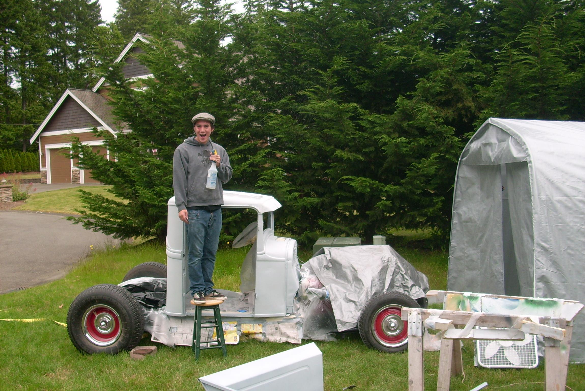

    Like a normal kid I spent tonight blowing **** up and playing with sparkler bombs but during the day I finished wet sanding the cab, bed, and all the parts (scoop, grill, doors, radiator cap, headlights...). Since our shooting wasn't the greatest I started out wet sanding with 400, then 800, then 1000, then 1500. I am officially ready to try my hand in paint.
    Still was not able to go to the auto paint store but hopefully check it out and see what they tell me is easy to spray and will come out with a nice semi gloss.
    I appreciate all the comments and yes we are doing everything safely and still having fun.
    and yes I enjoy wearing old golfer hats when I work on my truck, makes me feel a little more mature (like most of you haha)

    Next time 1000 and 1500 is a bit too fine for base coat. The reason is the surface is a bit to slick for the paint to stick to. Using 400 or 600 leaves more minute scratches for the paint to grab onto. In the paint trade it's known as "tooth".
    While I wouldn't go back and re-sand I would keep an eye on how the paint is flowing right after it's sprayed onto the body it MAY tend to flow too easily and making SNOTs could be a concern.

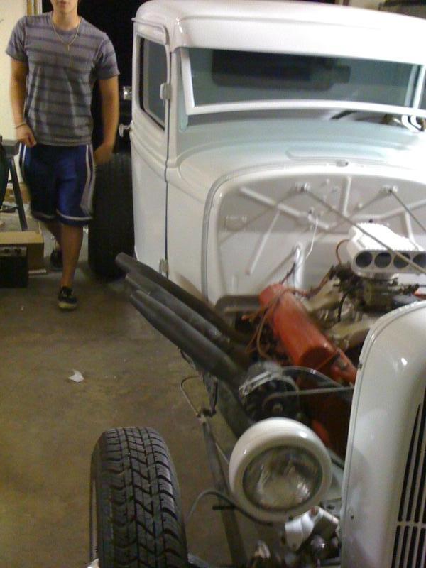

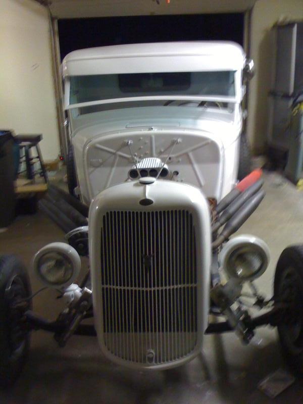

    I appreciate all the advice everyone. I painted it on the 11th and 12th and for the last couple of days I have been putting her all back together. Honestly, for not knowing anything about paint before starting this I have learned a lot.
    I went to the local Napa (Westbay) and they told me to go to a store about an hour away from my house that mixes paint. I got Artic White in a single stage omni paint and they gave me a slower hardening hardner because it was pretty hot out. They told me everything I needed to do, sheets on mixing, drying times, tips and advice. I used tack cloth before hand and everything and painted away. I painted all the parts and the entire car by myself with my dad only mixing the paint.
    I think it turned out much better than I expected. There is a lot of orange peel but I am not too worried for a $400 or so paint job done by myself I am happy.
    I figured I would post some pics of the car put all back together so you guys could see.
    Also. I was told not to "Color sand" which I guess is just wet sanding the paint for 3 to 4 weeks to let the paint harden a bit. I was wondering when it would be appropriate and what grits to use?
    I am pretty stoked to get her back on the road again.
    Also, Anyone know any cheap pinstripers in the Tacoma/Seattle area haha? I want to accent it with black pinstriping. I think it will looks sick.
    Enjoy some of the pics:
