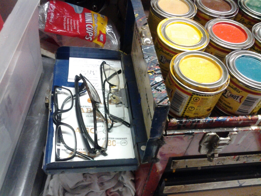

    I use automatic transmission fluid to store my brushes...New Brushes, I wash them out with lacquer thinner the first to clean it up.....and only use mineral spirits from that time on.....take an ice pick and poke 3 or 4 holes around the top of the can where the lid sits down in it....when you pour out of the can, you wipe off the outside and all the rest will drain back inside the can.........I'll post some pictures of my sign box in the next post.......got to go take some pictures of it

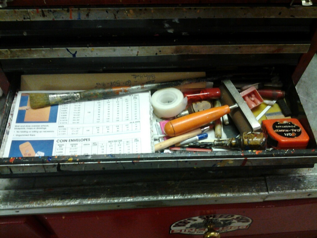

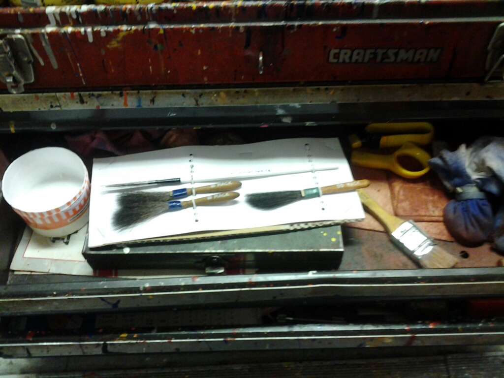

    Here's my newest Sign Box....had it around 30 years.....the can I use to put my mineral spirits in is about 3/16 thick with residue from years of use...I've probably had it the longest of anything.......don't remember if it was a beer can or a drink can.............. 20140713_122459_resized.jpg
