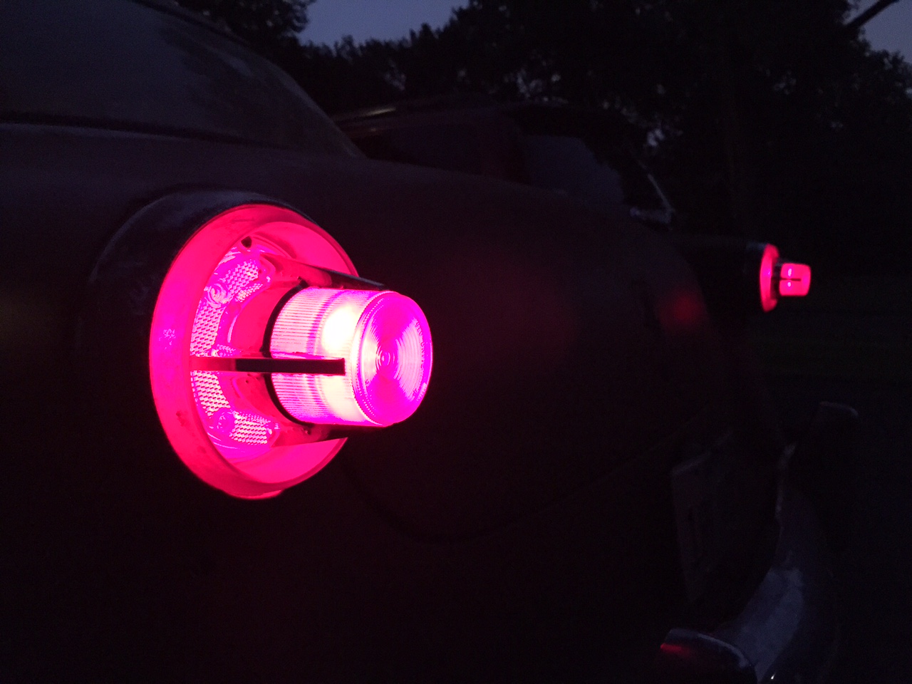

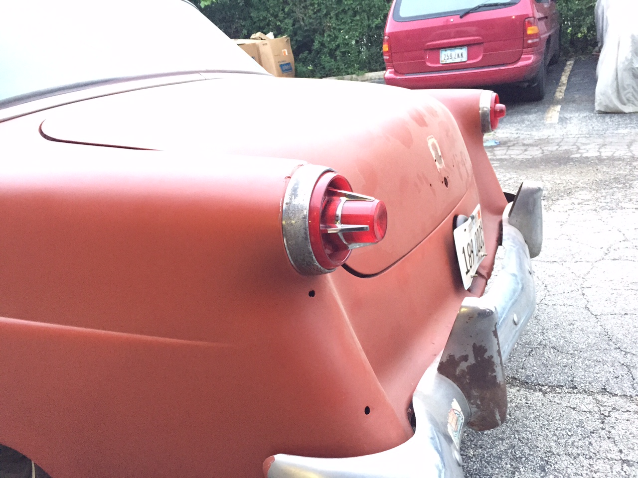

    had the car on the road with other cars for the first time last night. 5th gear is a dream! took it over to a resto shop to hang with an old hot rodder and show him the car. ended up getting a set for 60 lincoln tail light lenses he lad laying around. he told me he wasnt gonna sell them but they looked too good on the car. check out. they fit really nice. now i have to figure out how to mount them in a not hacked up way
    MyCrustyVW likes this.
  19. voodookustoms
    Joined: Aug 25, 2009
    Posts: 650
    voodookustoms
    Those look cool! Are you planning on frenching them?

    ya know. I wasnt planning on it but after seen what you and some other guys have done. Im really considering it.
  22. cdoh
    Joined: Apr 30, 2014
    Posts: 216
    cdoh
    from chicago
    if anyone knows any tricks on molding the lincoln tail lights to the ford ones let me know. i wanny try and stay away from just though bolting it if i can
  23. voodookustoms
    Posts: 650
    voodookustoms
    I would do it just like I did mine. You'll have to cut the inside of the bezel to get the light to fit from inside the trunk, and weld the bezel to the fender. Easier said than done, but with your ingenuity I'm sure you could make it work.
