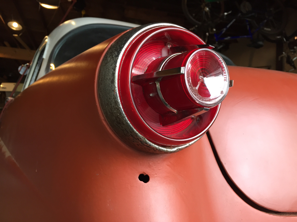

    I decided to do some work since I couldn't be at the yorkville show today.
    I cut out the center of the original taillight lens just big enough for the 60 Lincoln lens to slide through from the back. Then I used the chrome trim to sandwich the two lenses together for a factory look. ImageUploadedByH.A.M.B.1435531133.863348.jpg ImageUploadedByH.A.M.B.1435531150.538921.jpg ImageUploadedByH.A.M.B.1435531165.460810.jpg ImageUploadedByH.A.M.B.1435531200.795489.jpg

    I think it pretty cool because its subtle.

    I think if you could get a decent pair of the '54 'rocket slot' surrounds they'd top it off.
