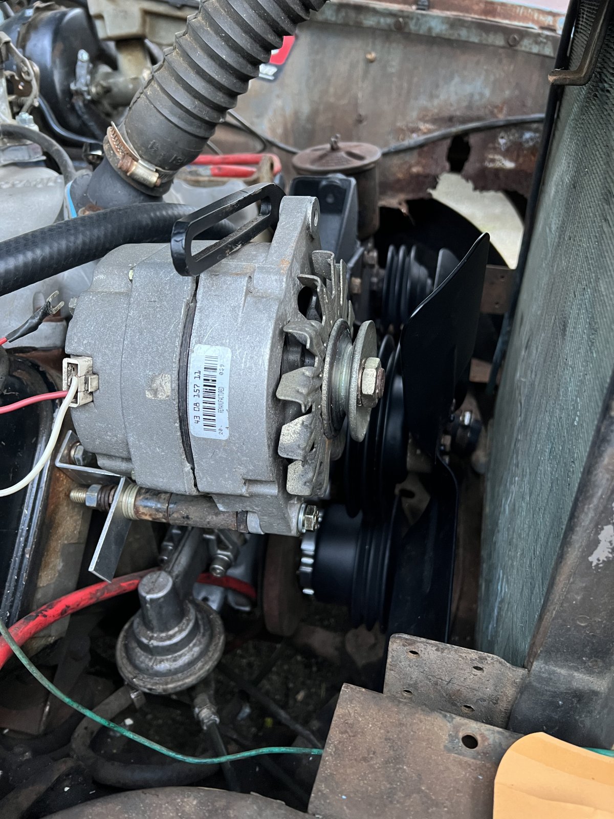

    I am not sure what the purpose of the flipper was. Still haven’t figured that out. The 57 cover didn’t have it so I’m guessing it’ll be fine. I’m anxious to see how the steering is with the p/s finally working

    I am almost finished. Should be done tomorrow and everything will come together. Just have to get some new belts that fit and install the power steering hoses. I can’t use the bottom half of the fan shroud anymore bc the 57 pump sits slightly lower and it rubs but it should be fine. E226CCA0-D839-42FA-8F36-ED2D5720CAD6.jpeg 7A1566FA-0136-460C-ACB5-993F4ACD5F4B.jpeg
