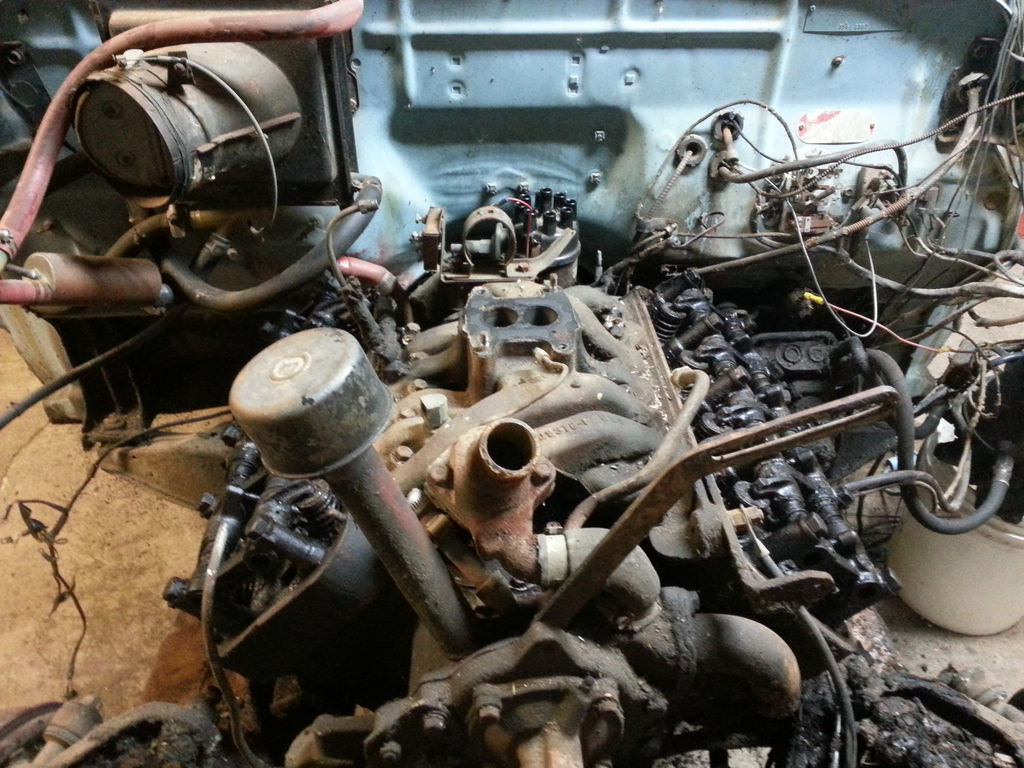

    Pulled the valve covers, all the valves seem ok, still cant get it to turn over, getting ready to pull out, plan to pull it next week after vacation and start tearing it down and see what im in for

    Today was a good day, scored a cherry picker and engine stand off CL for $75, So i'll be pulling the motor and trans tomorrow evening, I also got a running 283 for $200 in case the Hemi is in really bad shape once i pull it apart. heres how she looks atm

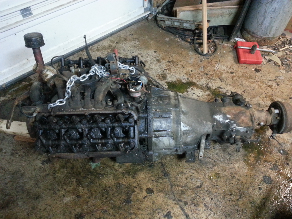

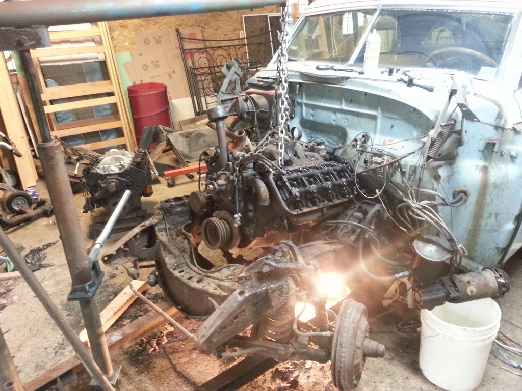

    Got the motor out of it last night! Took about 3 hrs and would have went a little smoother had I taken the cross member out but oh well. Next step is to separate motor and trans and then start tearing the motor down. Wont have time again to work on it again till Sun evening:(

    Don't know what your level of Hemi knowledge is, or if you've found the Hemi Tech Index yet, but...The converter is held on by 8 nutted studs through the crankflange, tends to be a problem with a stuck engine.
  14. Get the heads off first to determine if the pistons are seized beyond merely acetone and ****** fluid to unstick it. Getting that converter out without being able to turn the crank is beyond my abilities, which is why I'd do everything I could to persuade that engine to turn. A last resort would be to carefully chisel out a stuck piston. Takes forever and you can't slip up and gouge the cylinder wall, not even a little bit.

    **** I didnt even think of that:eek: Guess I will pull the intake and heads off where it sits and see what I am working with. I dont know a whole lot about Hemi's, slowly learning, this is my 1st one, most of my experience with building engines is w/ SBC's

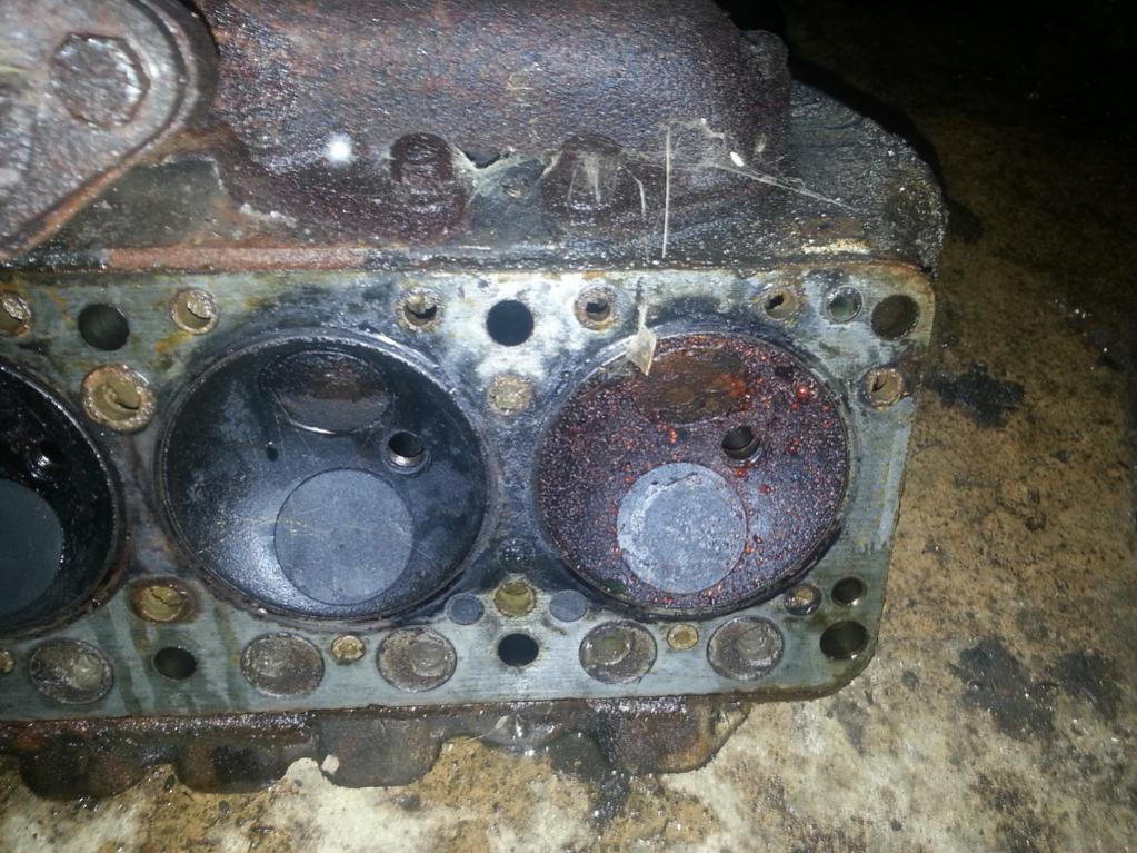

    just pulled the intake and drivers side head off and I think i found the stuck piston, gotta head to work but gonna pull the other head off when i get home and will update with pics then

    Be very cautious about using a BFH to move the piston. A recent thread on the same subject eventually offered the info that two cylinder walls were broken by beating on the pistons.....

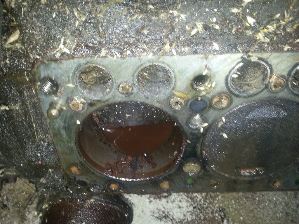

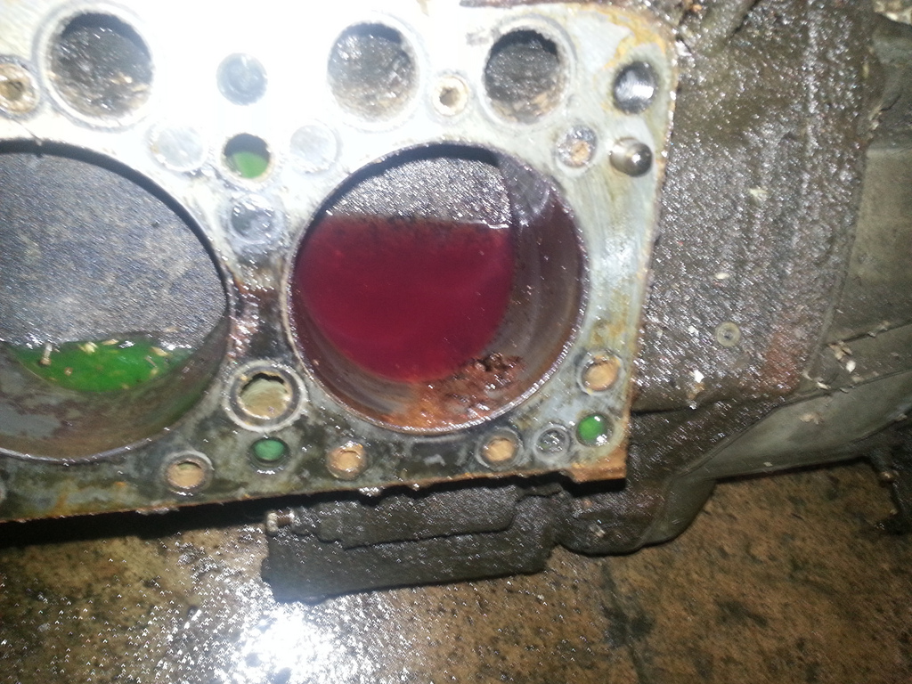

    well got the other head off it and there are 2, possibly 3 pistons that are stuck, cylinder walls look good for the most part, hope i will be able to get the pistons out and get away with just a hone. Also really stumped about how im gonna separate the trans:confused: so i can get the motor on the stand to take the bottom end apart, im planning to use a powerglide regardless of what motor goes in it so if it comes down to it i may just break the bell housing to get to the converter studs if thats what it comes down to but i would hate to do that, here's some pics

    Let it soak with 50-50 ATF and acetone for several weeks before beating on it too much. Also might heat help? Pump hot water thru the block somehow? A few heat cycles may move things a little.

    Run a ½" drill bit through the tops of the offending pistons (1-2 million holes) until you break the wrist pin free and the crank can move. Soaking with all kinds of witches brew is only useful if you are trying to save the pistons.

    Well I am holing to save the pistons. Cant really afford the 2k for the full rebuild kit. Hoping to get away with the rering kit which is 500. The pistons look to be in pretty good shape
