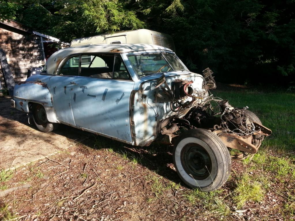

    Sweet old hardtop, I love it!

    awesome, thanks for the info, may run a manual then or just go the powerglide route, i really dig the 53, nice job, very cool car

    I should add there were only 3000 built
    I also love the split windshield

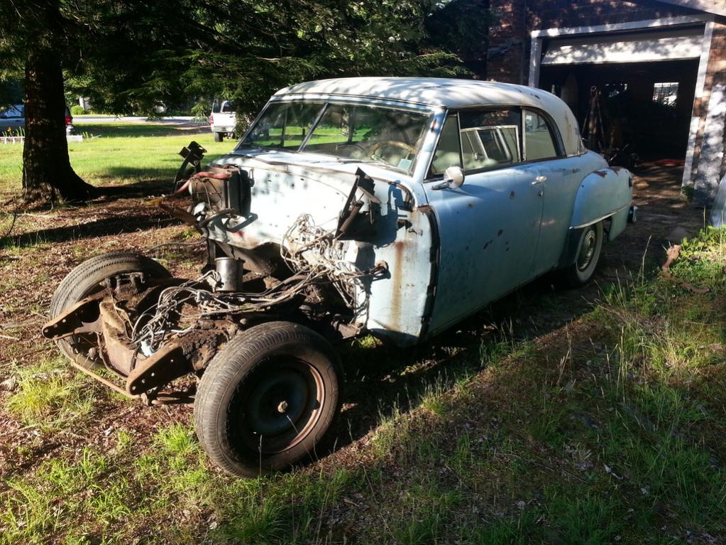

    Got it wheeled outside and am gonna power wash the front suspension, frame and everything else that is exposed tomorrow after work

    cleaned up pretty good

    Take a good look at the frame around the coil springs. I have seen examples of cracks in this area and they remain hidden until the frame gets cleaned as you have done.

    I did inspect those areas and all looks good:)

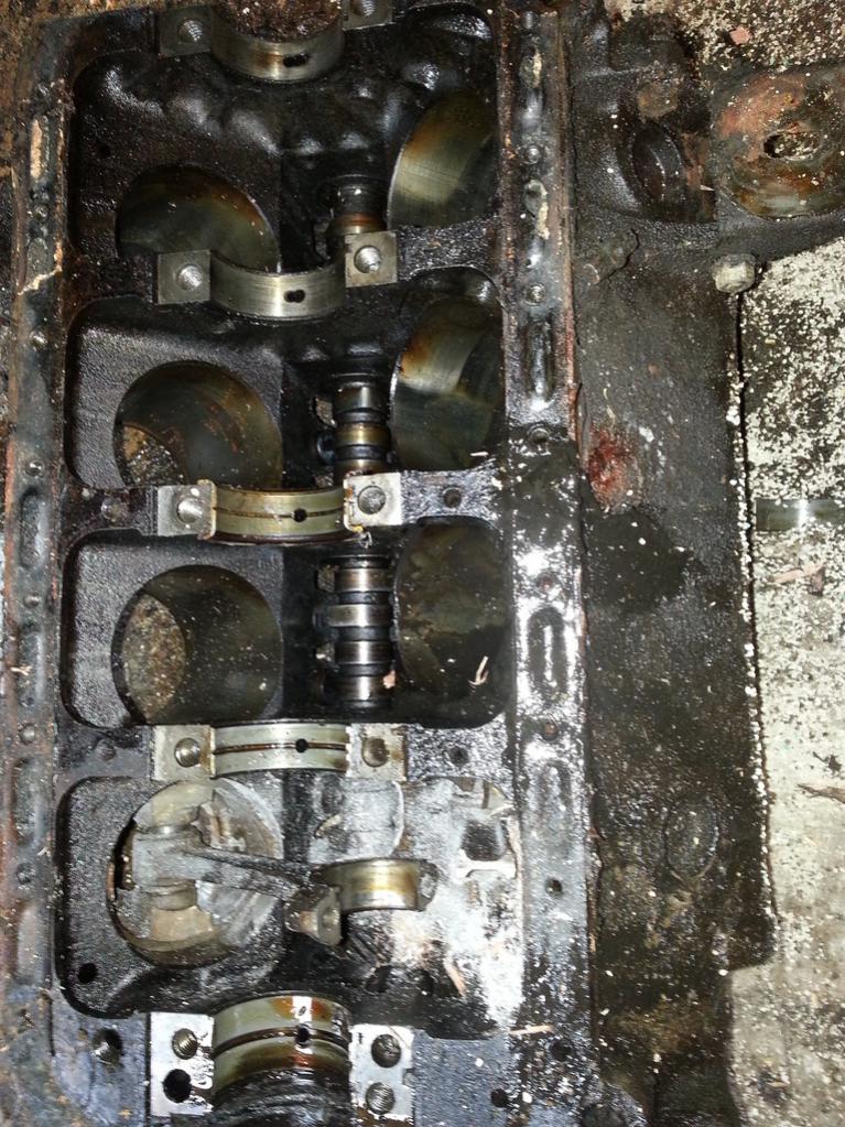

    Got the oil pan off earlier and was able to get 4 pistons out, cylinders 7 and 8 are stuck tight, prob going to have to drill them out, still hoping for the best and that I wont have to bore it, crank will prob need to be turned though

    Don't know if you've gone through the Hemi Tech Index yet, but your engine has a nominal Comp Ratio of 7.0:1 & the OEM C/Rs are often close to a full point optimistic when measured out. While expensive you should look at buying custom pistons in the 9-10:1 ratio.

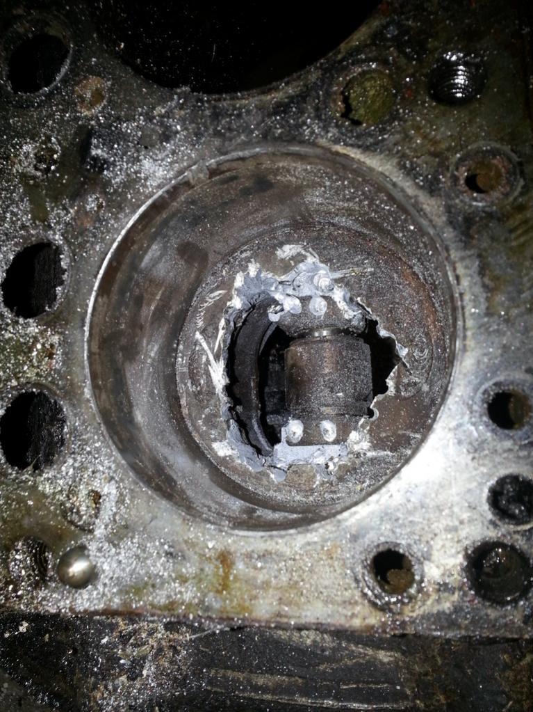

    I dont want to but I think I am just going to cut the rods on the 2 stuck cylinders with a sawzall so i can get the crank out which still has the flywheen and converter attached to it and then ever so gently chisel the pistons out after I drill them full of holes

    Do you think the rods are reusable/rebuildable? If yes you should collapse the pistons rather than cut the rods

    I think they are but a few people have said I should look into new ones

    If you're going to have to break the pistons anyway, try to save the rods.
    Patience. I know you want to get the crank out but a full set of rods is good to have, unless there are spares or something easy to adapt.

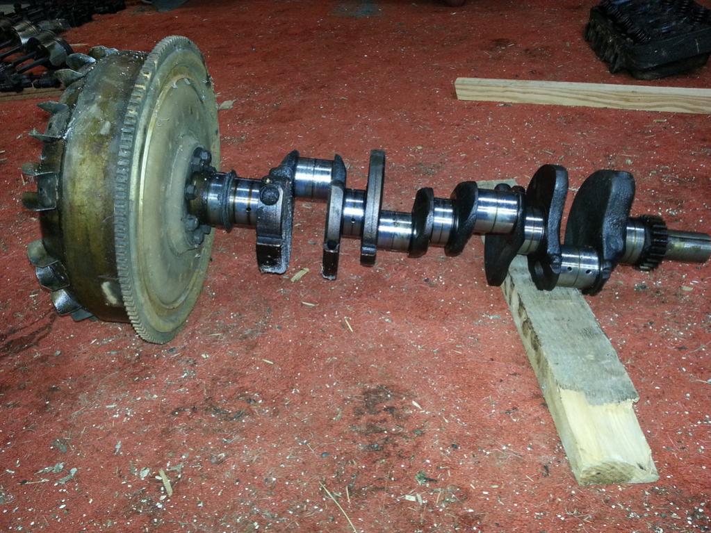

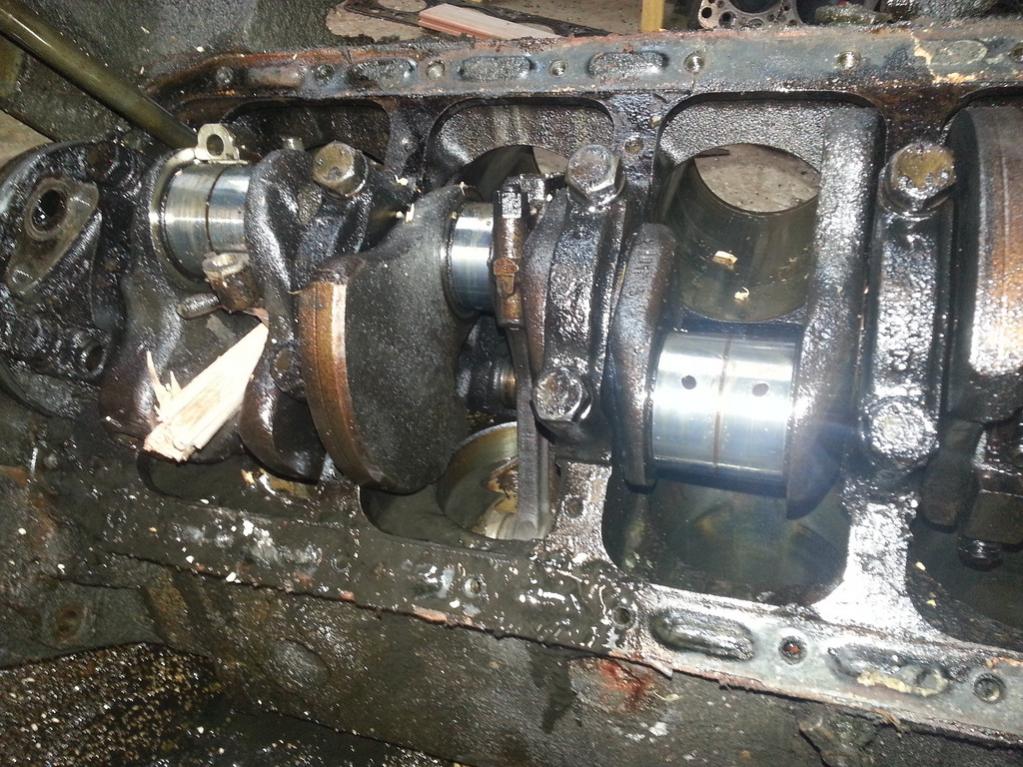

    Well I got the crank out finally, ended up having to cut the #7 rod, the piston was all the way at the bottom of the cylinder so I couldnt really get tools in there and didnt want to gouge the cylinder, I may just let the machine shop get the stuck pistons out, they are stuck tight and I dont want to break anything. Do I need to use a puller to get the cam out?

    Typically they'll come right out, but...I bought a stuck partially dis***embled 331 once that turned out the cam was what was stuck, so you never know.
