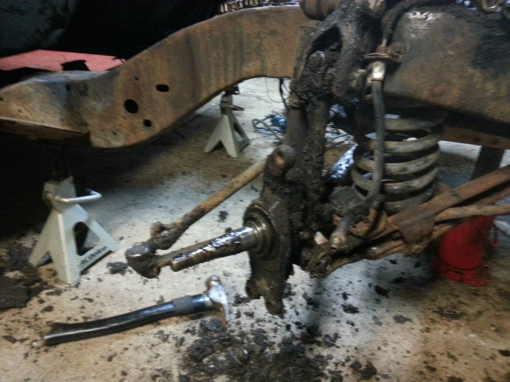

    got the front brakes completely off, spindles and all, it was fun taking the spindles off without a spring compressor, the sway bar launched a beer bottle against my garage door when i undid the 1st spindle:)

    after getting everything apart and cleaning as best i could until i get some oven cleaner i am shocked by the condition of all the rubber bushings, they are like new!

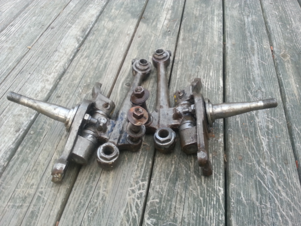

    Got my spindles all cleaned up with some easy off and a wire brush earlier, getting them ready to send to charlie to get drilled and tapped for disc brakes:)

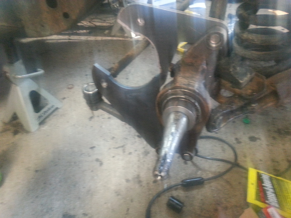

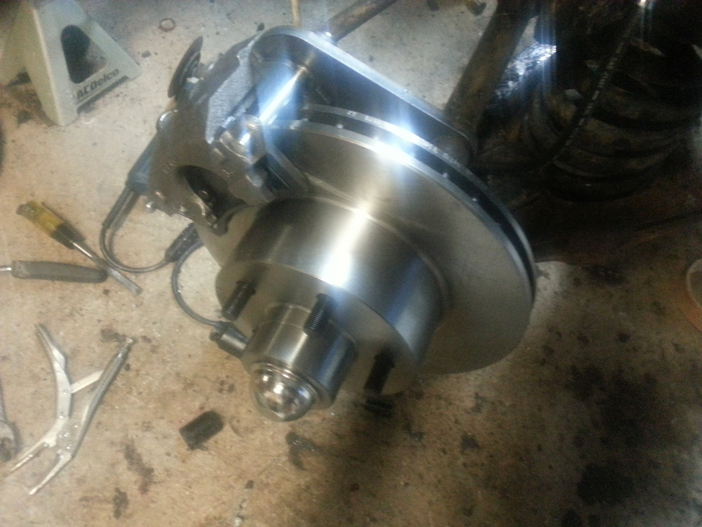

    Got the spindles back from charlie a few weeks ago and finally got all the parts for the disc brake conversion and got one side minus the caliper put together this evening, charlie makes a great kit and super easy to install so far!

  23. BRAINS!
    Joined: Mar 11, 2013
    Posts: 276
    BRAINS!
    got everything installed on both sides, went very smoothly, had to enlarge the notches on the castle nut with a grinder to get the cotter pin in otherwise everything else bolted right on, still need to swap out the master cylinder to a dual resivor and decide if im gonna mount it under the floor still or put in a swing pedal and mount it on the firewall

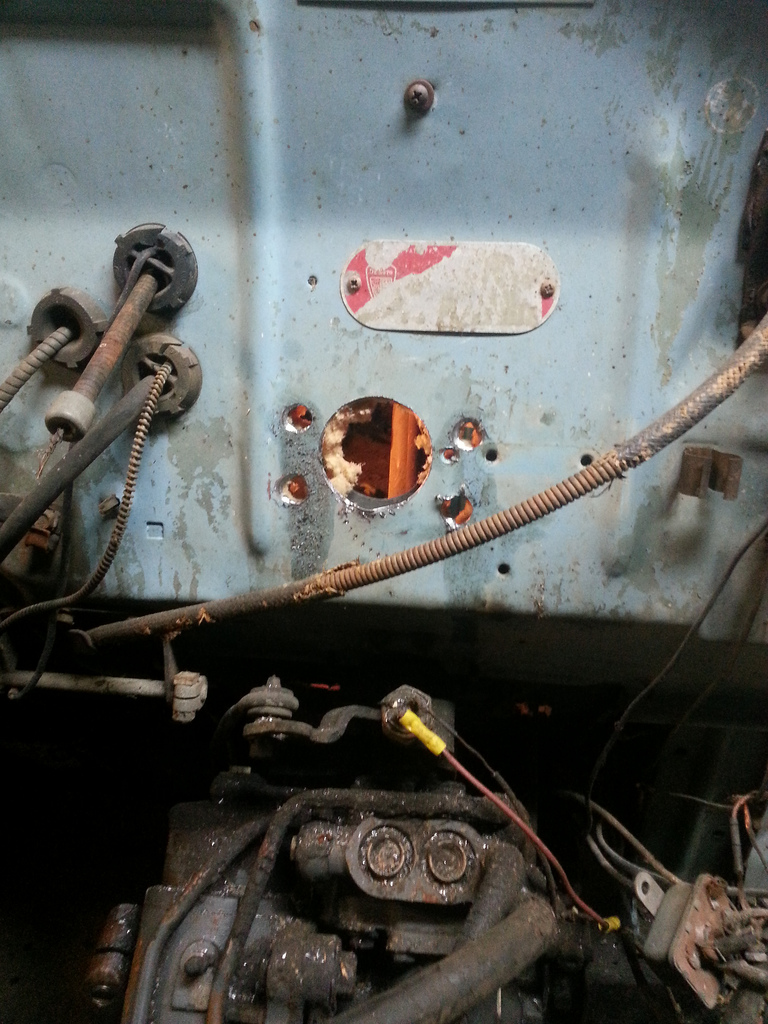

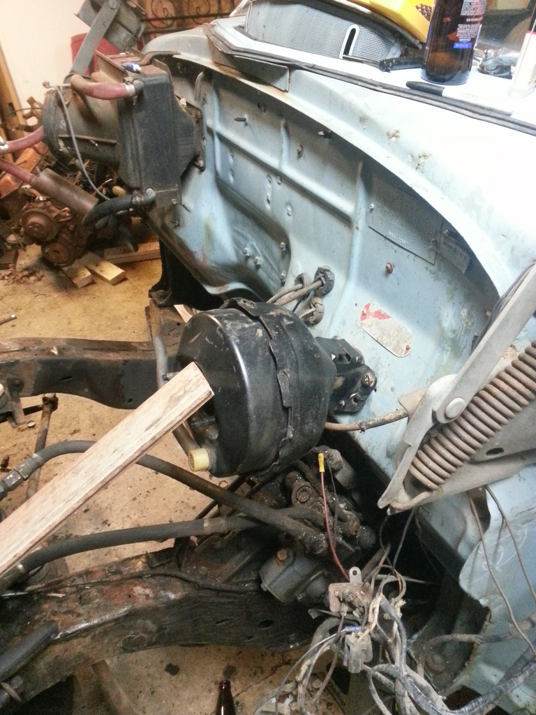

    well after not a whole lot of progress lately I got a brake booster and pedal ***embly out an 84 trans am at a local yard and have it all ready to go basically, had to cut out the original studs from the booster and need to get some longer bolts to mount it the way it needs to be, I was surprised how easy it was to drill the holes in the firewall, metal was surprisingly thin

    You might need to add a reinforcement plate to the firewall for your pedal/ booster mount. I was surprised how much the booster moved while I was bleeding my system without one on my 55. With the way your firewall is shaped it may be ok. Just watch for it once you get it all together with some pressure in the lines.

    Got the booster and pedal completely installed today for the most part, just need to get/make a little extender piece for the pushrod
