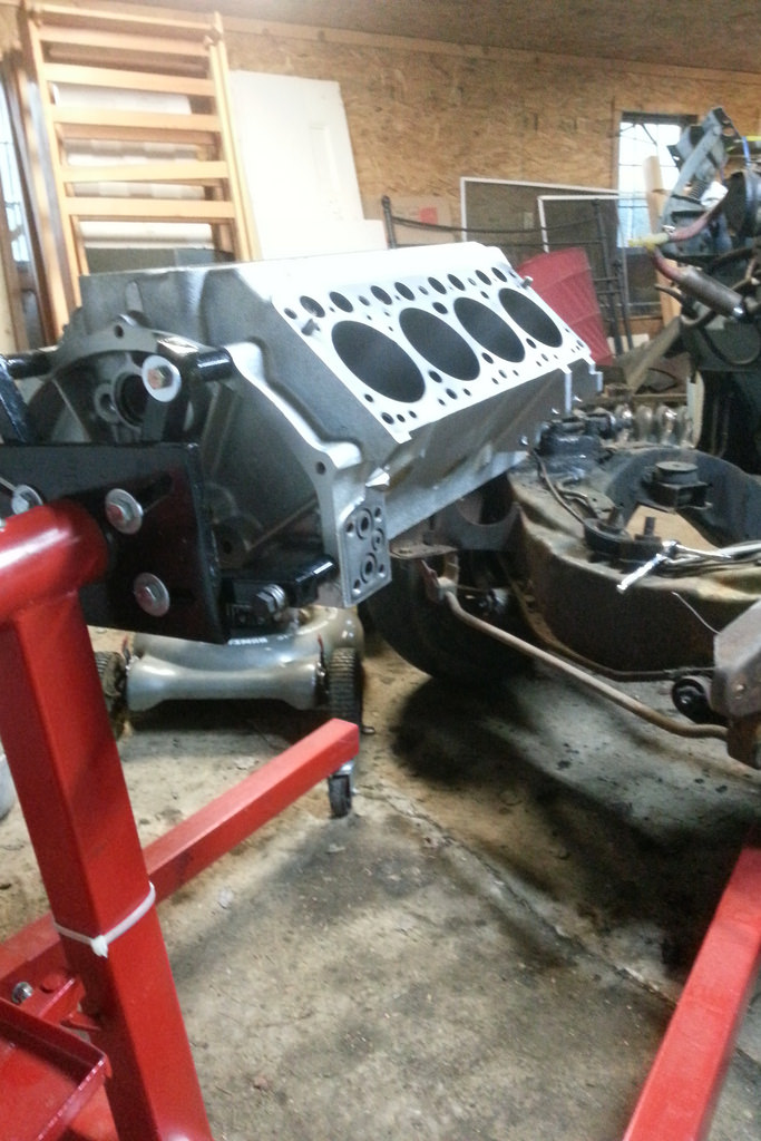

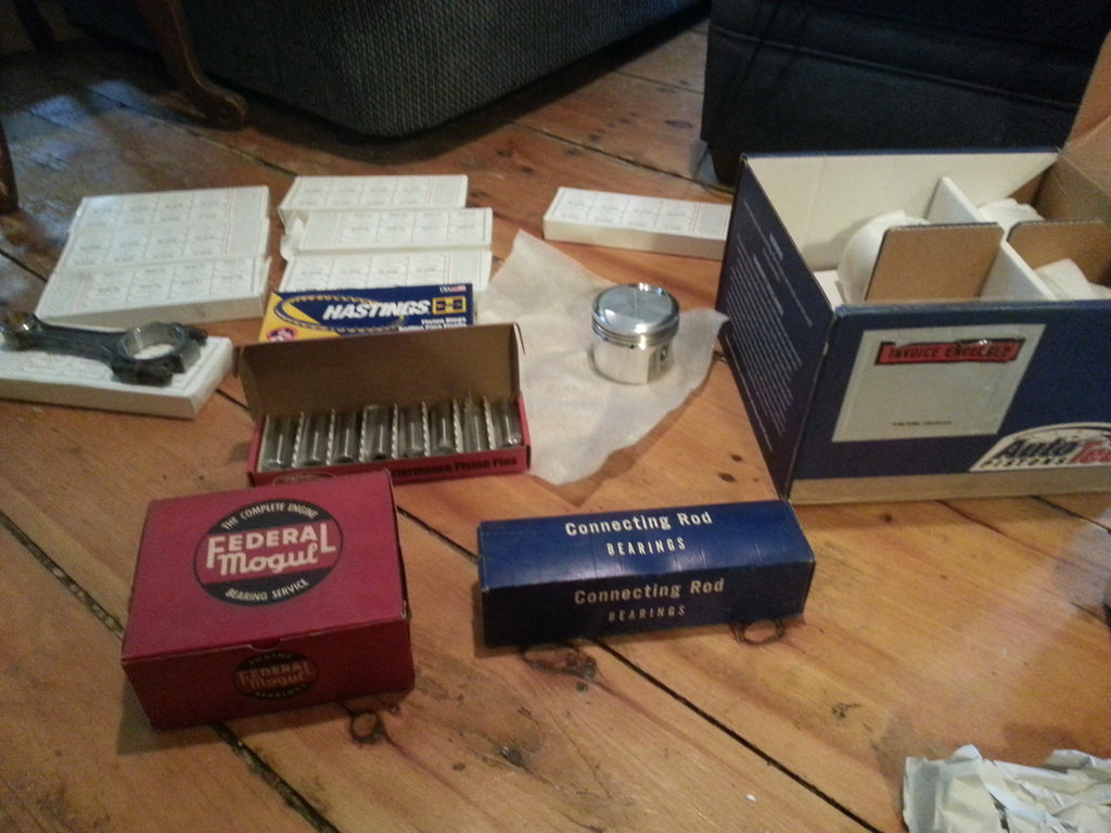

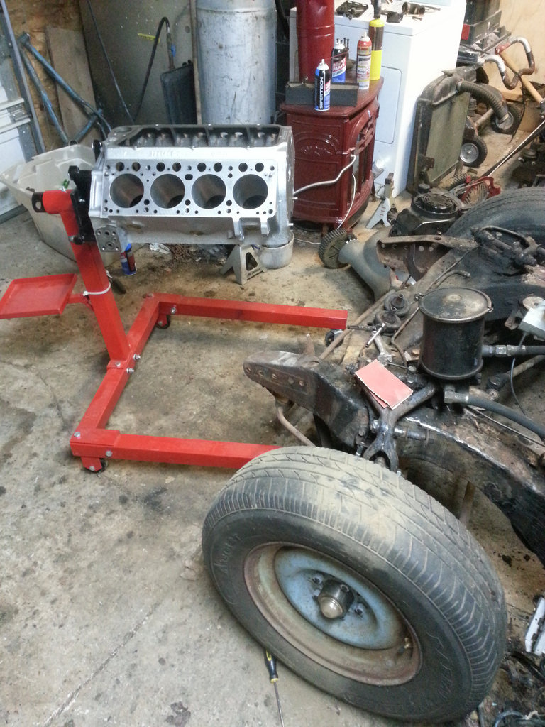

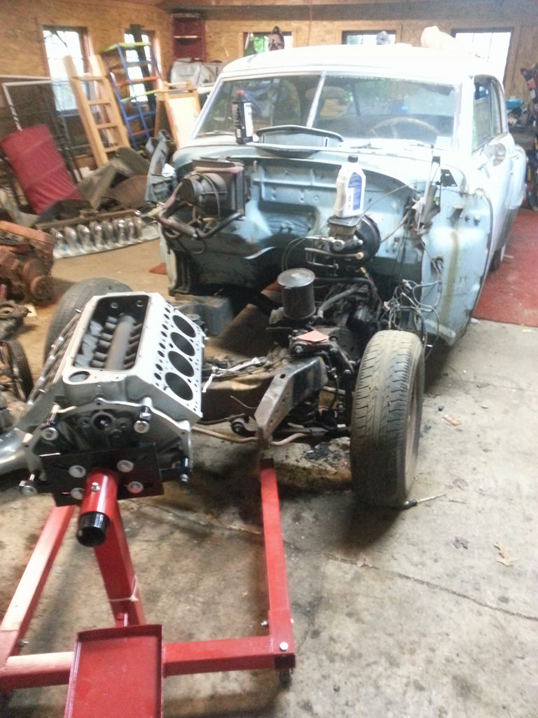

  17. BRAINS!
    Joined: Mar 11, 2013
    Posts: 276
    BRAINS!
    Got my pistons rings and rods today! Everything looks great, very happy. I will be starting to ***emble very soon, also pictured is the rebuilt trans that i picked up a few months ago, hope to have the motor and trans in it by the end of the summer
    14106607359_6e66dfe2d4_b.jpg 14106610229_5d4365fa83_b.jpg 14106649428_7d94857808_b.jpg 14291323642_7d7134c783_b.jpg
  18. BRAINS!
    Posts: 276
    BRAINS!
    Got the block up on the stand and am going to start ***embly this evening or on saturday!

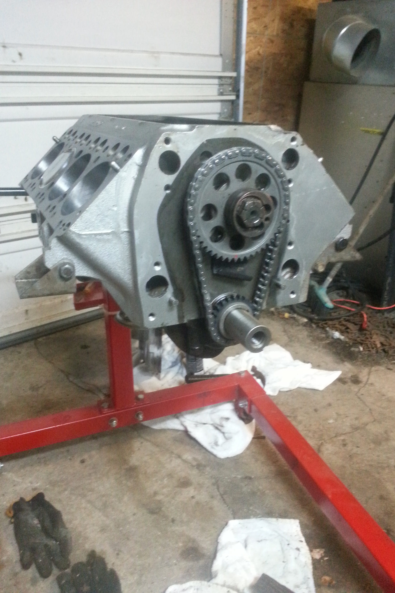

  22. BRAINS!
    Posts: 276
    BRAINS!
    Well I got the bottom end all ****oned up finally! Im getting pretty excited to get this thing going, I realized after the fact that I forgot to put the ring pictured on, it goes btwn the timing gear and balancer, Is it going to be a big deal if I leave this off? I would imagine the balancer will hold the timing gear in place just fine
    15744964066_bb5d3a939a_k.jpg 15149256943_d9b7f20191_k.jpg 15770232722_c68b025ada_k.jpg 15583503007_dea1ce31d4_k.jpg 15583505377_477f91f6d1_k.jpg

  24. lolife
    Joined: May 23, 2006
    Posts: 1,125
    lolife
    I call that an oil slinger. I think it just keeps more oil on the chain, and away from the seal.
  25. Brand Apart
    Joined: Jan 22, 2011
    Posts: 815
    Brand Apart
    from Roswell GA
    yea, I hear the oil slinger is necessary but have no first hand experience to verify either way.
  26. BRAINS!
    Posts: 276
    BRAINS!
    Yeah I ended up opening her back up and putting the slinger on
