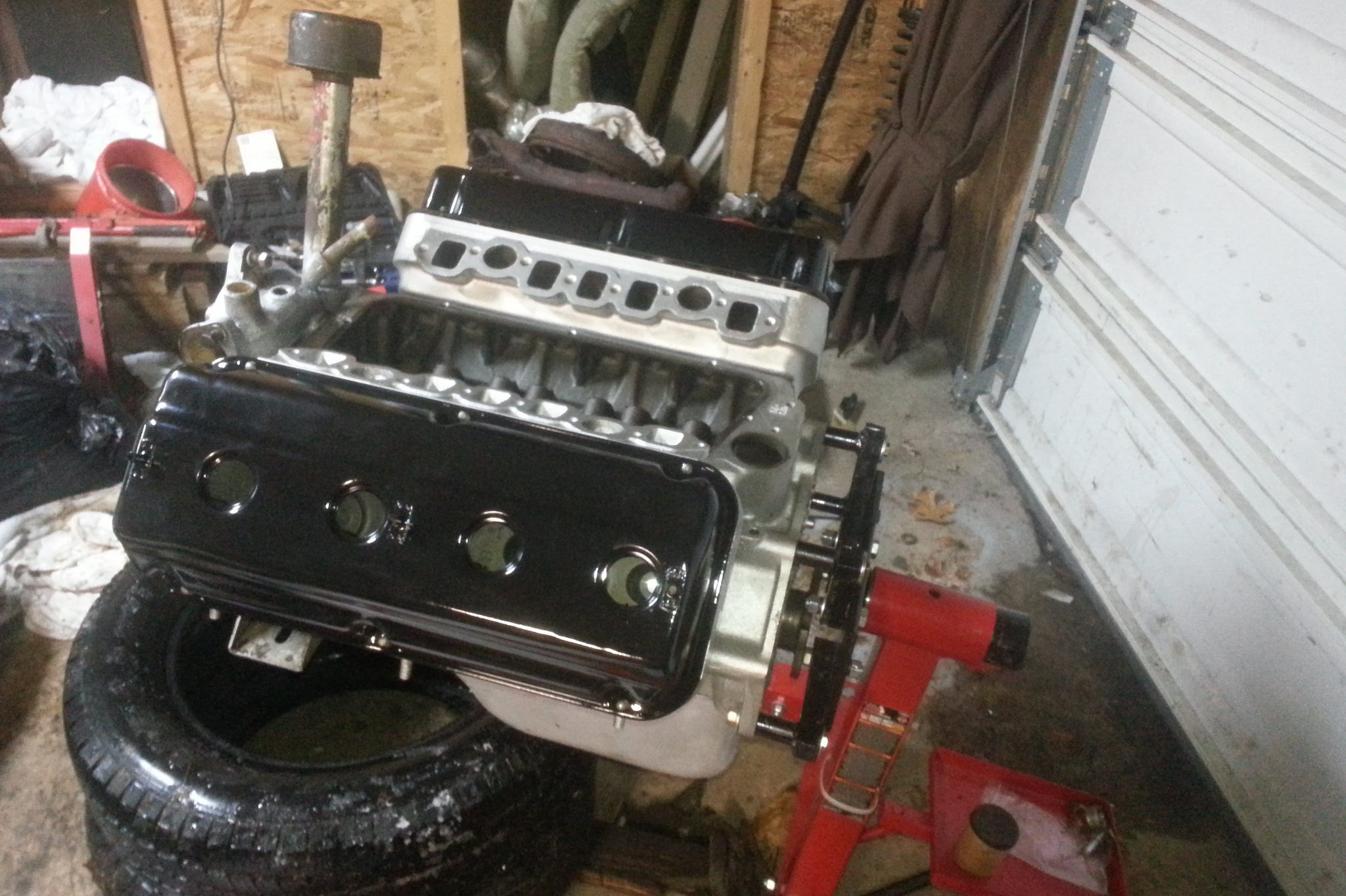

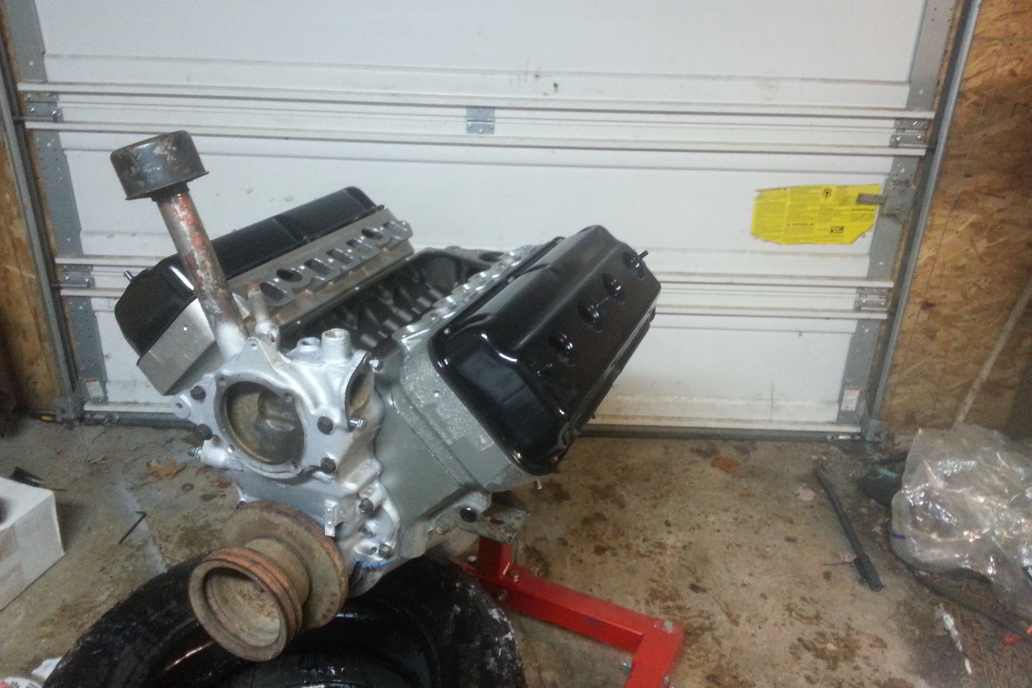

    Got me heads back and they look awesome! Only mocked up in these pics, i pulled them back off today and found the oiling holes and marked their location and put the heads back on and snugged them down, all I need now is a trans adapter and this baby is ready to go back in its home!

    Even though the stand is rated for 1250 I still put the tires under it just in case:) I would hate to come out and find my motor laying on the ground
  20. George
    Joined: Jan 1, 2005
    Posts: 7,995
    George
    Had 1 stand fold up with only an AMC 360 on it, don't recall what the rating was.

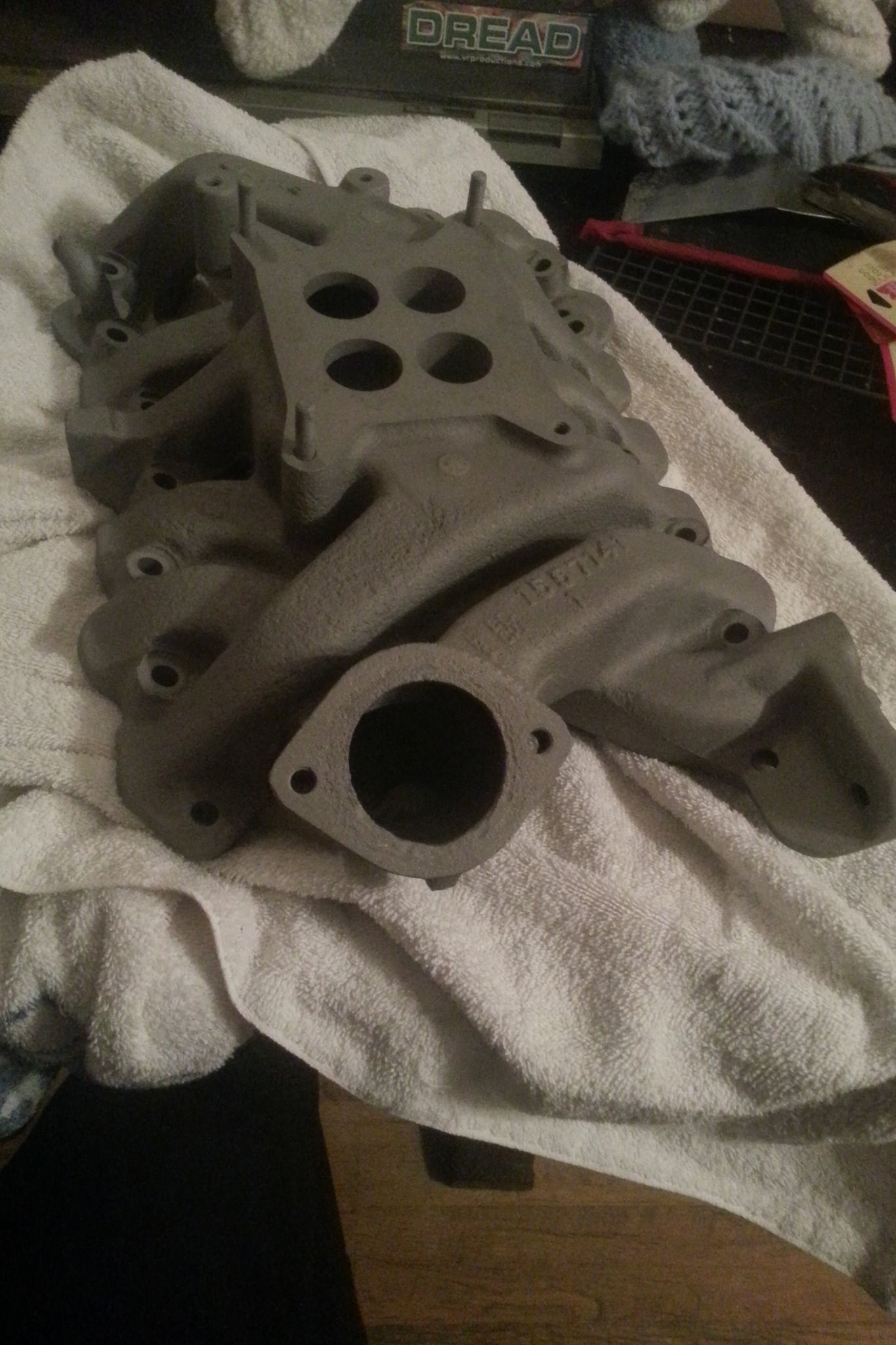

    Its looking awesome! intake back from sandblaster, headers, trans adapter and rest of gaskets came, I had to cut the corner off the motor mounts to get the headers to fit but they look great, Pretty strange the headers use black rtv for gaskets but we'll see, super pumped to put her back in the car on sat!

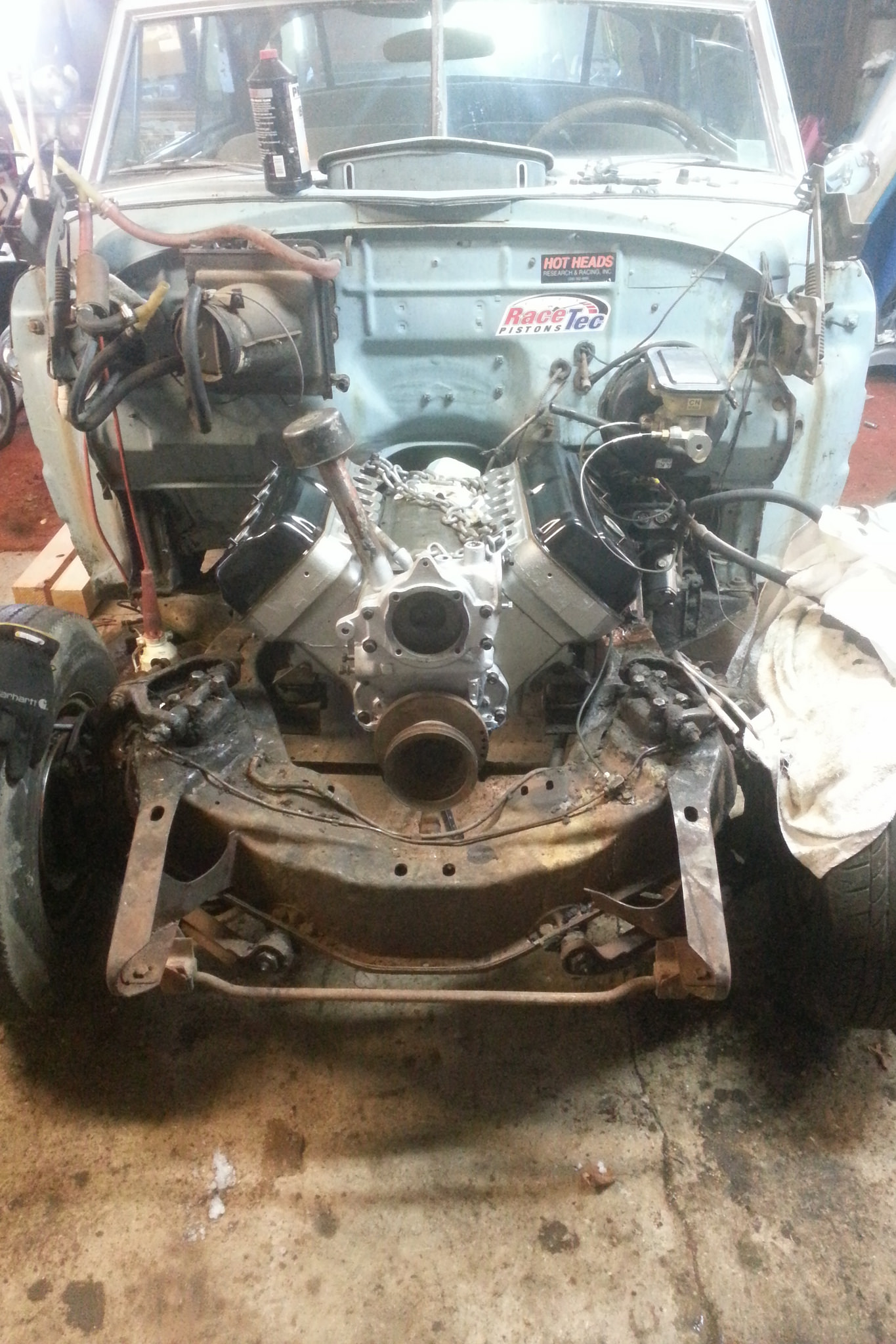

    Got the motor & ****** put in her this morning! Headers didnt fit:( didnt clear the frame rails or the steering box, guess ill have to run exhaust manifolds unless i can get the headers modified, I dont have a torch so cant do it myself

    Are those Sanderson headers that you bought?
  26. BRAINS!
    Joined: Mar 11, 2013
    Posts: 276
    BRAINS!
    Yup, they will probably be for sale if I cant get them modified or return them

    Before you bolt on the intake it would help flow a lot if you open up the bore holes to match the carb gasket holes.
  28. BRAINS!
    Posts: 276
    BRAINS!
    I will do that, thanks for the tip, I plan on running a 392 carb
