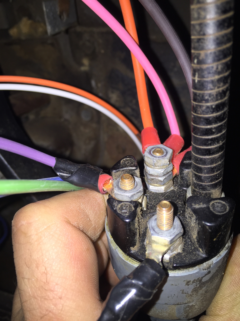

    Well I'm not sure what's up but I found out why I am not getting any spark. It keeps blowing the fuse every time I turn the key on so something isn't right. Thinking i may need a new ignition switch. Here are some pics of my wiring. Anyone I the southern NH area that knows about wiring I am offering beer and some cash for ***istance

    Anyone? I called customer service and this was how the guy told me to wire the switch. The wire at the bottom of the ignition terminal pictured is the red one and that black conduit that is coming out of the ignition goes through the firewall and there is a wire coming out the end of it, is there a wire that needs to go there? I was told that these aftermarket harnesses were idiot proof, clearly I must be an idiot bc I really have no clue, I hate wiring
