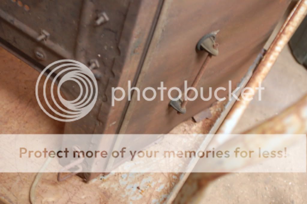

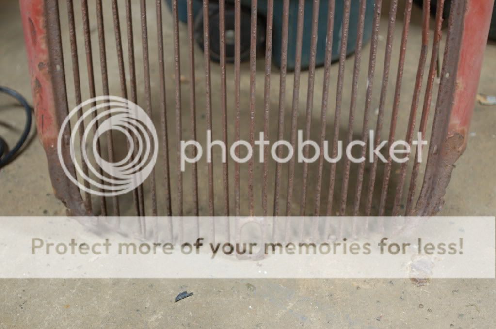

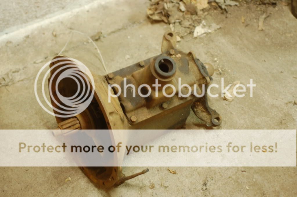

Got some more stuff today. I traded a '51 ford 3 speed to my pops for the grille. its a 33 ford model B. a little "rugged" but itll do for now at least. im not worried about chopping up this grille, it appears to have been previously cut anyway. at least the shell is solid, i'll work on straightening those bars too also brought over my trans which is a 39, and my front end, steering wheel, steering column, and steering box which are all 38. loosely set it up to start taking some measurements I took some real ****py pics of my backing plates. seems I have one large retaining bolt where the hydraulic plates have two? otherwise, the top hole (blurry pic) looks like i can modify it for wheel cylinders. any info on the bottom retaining bolt?
Moc up your car without the backing plates. Later you can find some 39-48 backing plates. Don't bother trying to convert the mechanical set up. Besides no reason to do it now in your project phase.
