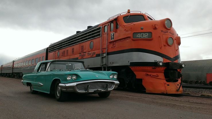

  3. Love the 59,awesome pic by the locomotive.....turquoise/white interior?

    Thank you! Yes, it has a turquoise and white interior. I think it will down the road when I redo it, too, but I'll put pleated insterts in the seats. The seat foam is so dry that every time I drive the car I have to vacuum under the seat... That'll be on the list for next winter.

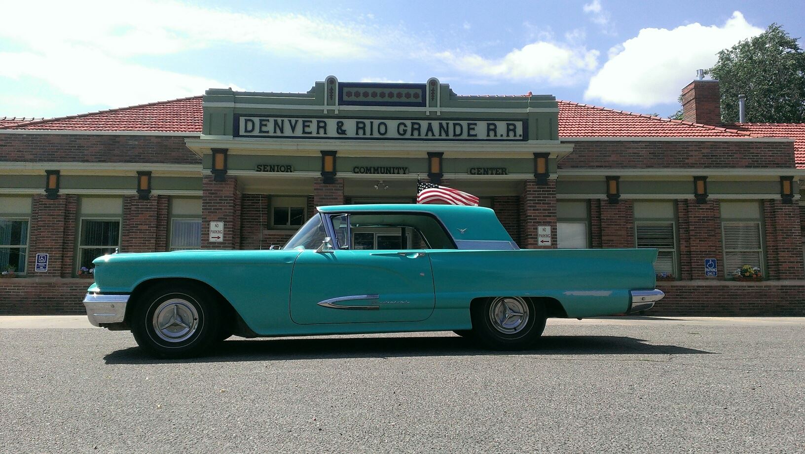

    That photo with the diesel is simply outstanding!
    Pinstriper40 likes this.

    Thank you! The Royal Gorge train is a bit of local history.

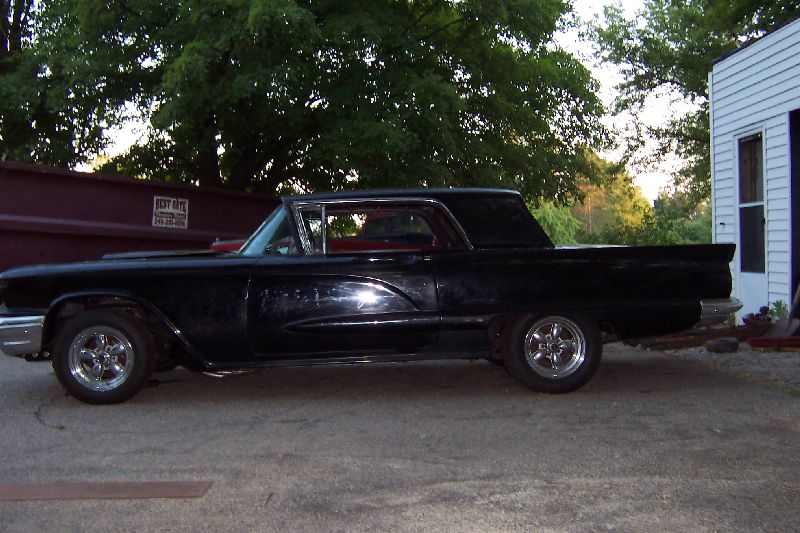

  27. I did a re-suspension in my sons 1959 Bird about a decade ago. Posted on ynottayblock's thread
    Dropped spindles with disc brakes in the front.
    In the rear I didn't like the u-shaped leaf mounts so I removed them. Took the gas tank out and bored a 1-1/4 hole thru the frame on each side so I could install a "normal" straight down shackle. I had to do a lot of measuring for the correct location of the holes front to back. Welded in a piece of 1/4 inch plate on each side of the sheetmetal frame also with a 1-1/4 hole in it. I used a piece of 1-1/4 OD DOM to line up the plates. Welded the DOM in and made shackles out of steel plate with multiple spring mount points for height adjustment. The DOM has the same ID as the rubber inserts for the bolts.
    I cut the extra off after they settled. I also drilled the main leaf centering bolt hole about 1" farther back so the rear wheels are centered in the wheel well. Used a C-6 trans which is longer so the drive shaft was OK.
    No pictures of the spring mounts, it's in Michigan . But here is a picture with the rear too high. It's been lowered since then. Notice the tire position. 59BirdSide.jpg
