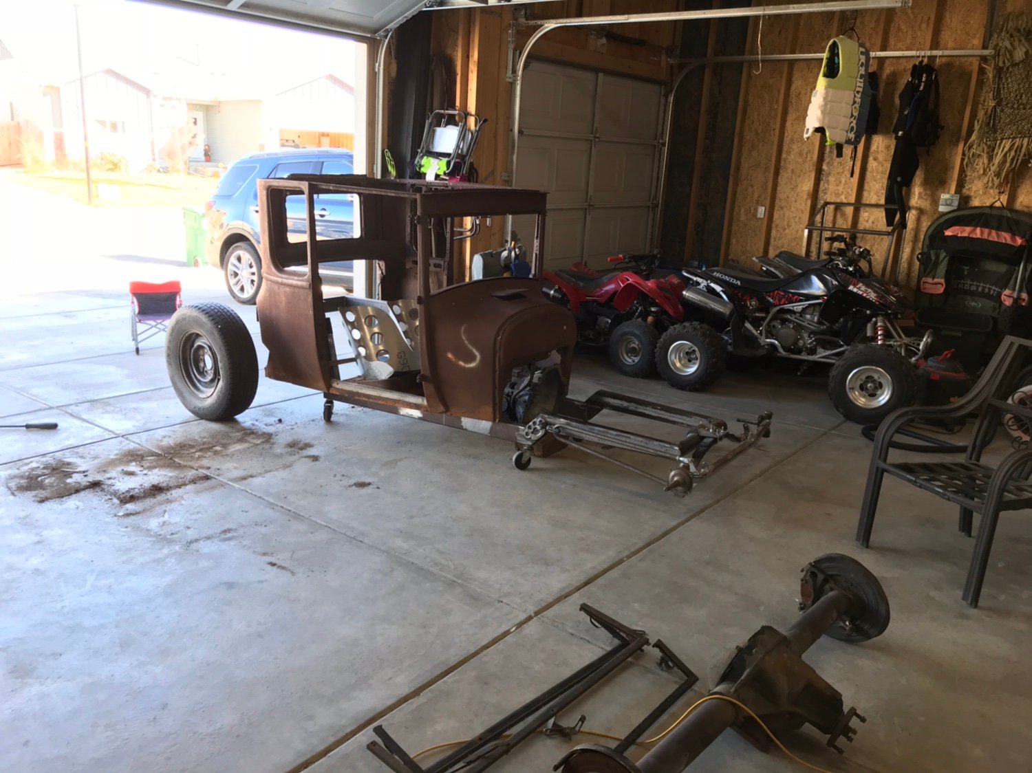

    Hopefully this is the correct place to post this, it’s definitely not a traditional hot rod, but also not going to be your typical 70’s pro street looking T bucket.
    About a year or so ago my wife convinced me to find a project to keep for myself instead of just another car to flip on the side to make a few bucks, I’ve always had a thing for T’s so I searched high and low and ended up with a fibergl*** reproduction body, a half ***ed attempt at a frame and a early olds 9.3” for a few hundred bucks [​IMG]
    The frame was almost completely square , no kick up in the back. 4” front crossmember and when I set it on the floor it was extremely twisted, so I immediately started cutting it up to reuse what metal I could, cut and stacked the frame up front [​IMG][​IMG] then decided a a 4” front crossmember just didnt look right at all so got a 3” and sectioned the front to get the look I wanted [​IMG][​IMG] it has been pretty slow going but thats only partly due to funding and mostly due to the fibergl*** body, I’ve just never been able to get excited about it, there is no character, no bullet holes, no stories to tell. A couple months ago I made up my mind that I would switch to a steel body but being low cash flow I decided to list the bucket body and just ride it out until something came along and sure enough I found a 26/27 coupe witch is what I really wanted when this all started [​IMG][​IMG][​IMG][​IMG]

    I see an extended cab T pick up in your future! Happy building, keep us posted. You will get better responses if you introduce yourself on the main page, Welcome from Va.

    What are your plans for the missing back end? Looks like a cab that I had that was used as a chicken coop.

    I posted an introduction last night, honestly I really want to bring it back to a coupe going to buy a few sheets of steel probably end up shaping my own quarters until I get somthing I’m happy with. That’s partly why I ditched the 23 body besides it being gl*** it was something to play with but I knew I would never be completely happy with it[​IMG]
    This is one of the last pics I took before changing directions

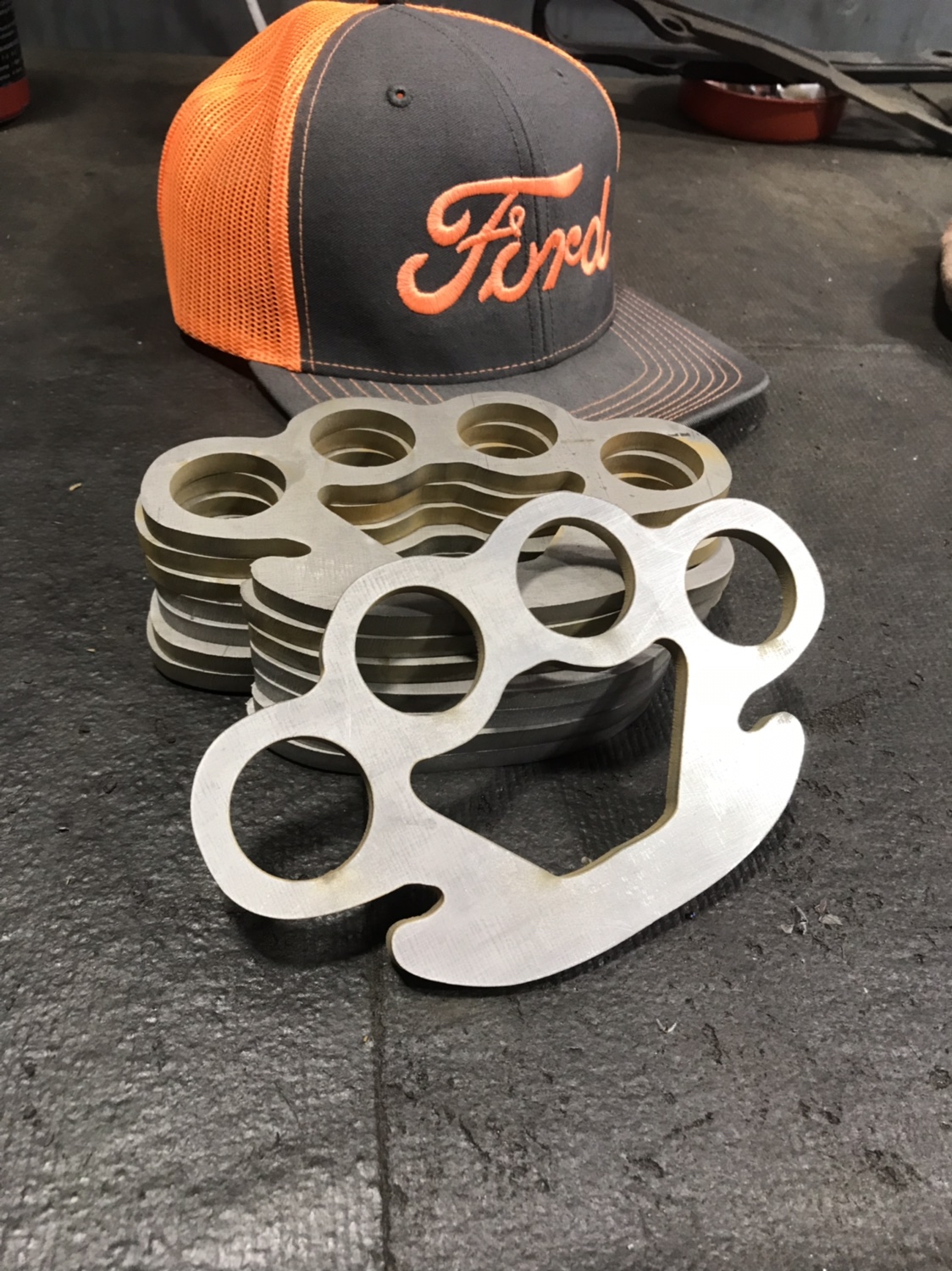

    Thanks, I sketched em up and had a local shop cut them out with a water jet [​IMG]

    Kool beans! You ought to market those! No way you could hold a patent, but a lot of guys would buy them, because it would be easier to buy than to mess with lay out and stuff.

    They are cut from 1/4” I knew I wanted to do those as soon as I Z’d the frame just to be a little different and searched all over for them with no luck. I tried making my own and they turned out decent but no 2 were 100% identical and I’m too much of a perfectionist.

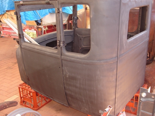

    Your project kinder reminds me of how mine started.
    Not they are exact copies or anything like that, but the cabs are close.
    Nothing wrong with a 5 window pickup cab, lots of leg room...

    Was that a common thing to cut the backs off back in the day? Yours looks really good, how hard was it to fab that rear panel and quarters? Mine looks like it was just torched and folded around the supports. Also wondering if anyone on here has successfully made quarters for these, I saw a build thread on scratch building doors but the pics won’t load for me

    Not sure how common this practice was, I'd say uncommon from what I have seen since doing mine.
    You just need to fab a lower panel that fits under the rear window panel which ain't that hard and then shape the subrails to a suitable curve and then blend the rear and side planes together.
    A little tricky but with the right advice/help should be do-able.
    I don't know of any 1/4 panels produced on here but it is possible.
    I always wondered if it was possible to use the back end of a t Tudor body to close off what you have.
    They should be much easier to locate and much cheaper to purchase.

    I'd buy a pair today !

    Hindsight I should have had more made, they did it as a favor and gave me a really good deal but they weren’t super thrilled about it when it was all said and done. I think they said they charge somewhere around 150$ an hour and these took 30 min each to cut. Plus they had to redraw them with their software. Probably why I couldn’t find any m*** produced. If I have any left over I may sell them, I really dig the look but I don’t want to go overboard with it

    8 plates, 1/2 hour, $150 per hour, thats about $10 per plate cost. If ya gave the shop some money for the next run, they would at least recover something for the time they spent to put the part into their software.
