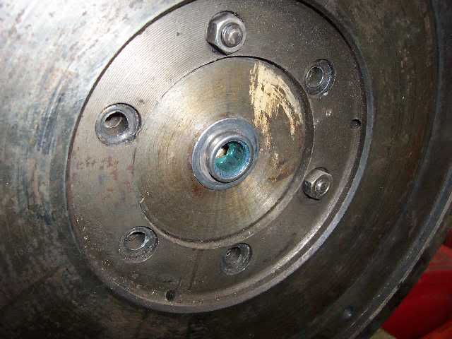

    Nice build. From the 1st page of this thread you mentioned that the ****** is a 1996 Ford T5 from my end it looks like an eighty camaro T-5. Pretty sure the newer for t-5 are a one piece unit. Well any hoot keep those pictures coming
  10. Rande
    Joined: Oct 16, 2004
    Posts: 349
    Rande
    mink, the tag number (238) sayd its a Mustang 3.8 unit. Thats how the salvage yard labelled and sold it.

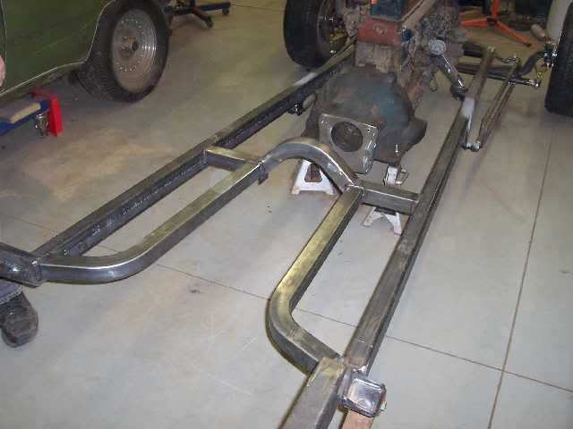

    Got out there today but still feeling lousy and didn't get a lot done. Got the cab back off and cut out some of the floor that was in the way.
    Checked out the rear shock upper mounts that my brother made and installed last weekend while I was laid up sick. I made the lowers, Gary trimmed them a bit to look better.
    Here's the ****** mount. The strap going under and holding the mount is 5/16" strap.

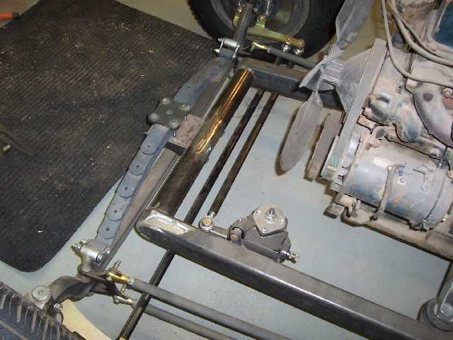

    Got the drag link and tie rod bolted in (not yet permanent) and figured out an upper mount for the front shocks. We'll fab them next week.

    Mink, there are two tabs welded on underneath the tubing where the hump meets the side pieces. Two holes in each tab allows the support strap to be bolted up on either side. If you look closely on the left side in that pic, you can just see the end of one of the bolts and the nut (look kinda white in the pic).
    In this pic, you can see one of the tabs there on the left side.
    Made a closer view.
    Mink, I just reread your post and think you were actually asking about the hump in the tubing (I'm a bit slow on the uptake). Thats a s**** piece from my brother's workplace. We cut it off a longer piece and mated it to the straight pieces. All those square sections are s**** pieces we salvaged.

  22. Roothawg
    Joined: Mar 14, 2001
    Posts: 26,094
    Roothawg
    Just how did you bend that square tubing? Did I miss that somewhere? That's cool.

    The bent tubing is s**** stuff from a manufacturing plant. We didn't do it. So Roothawg, you didn't miss anything.

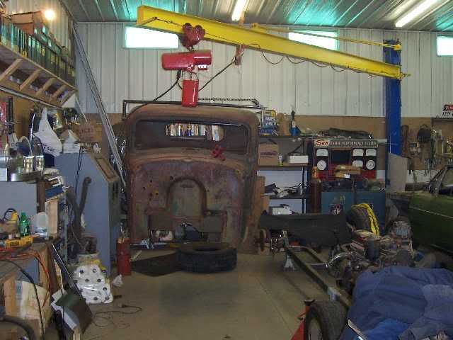

    We have been using a nylon strap to lift the cab on and off the frame as we needed but it would stretch a bit too much and we just couldn't get the cab to clear everything to move it over. We would have to take the frame off the jackstands and put it on the floor to clear the bottom of the cab. We've had enough of that.
    We made a fixture to give us a bit more height out of the lift. The problem was, the strap would stretch upward so that we could not get enough lift before the chain got to its upper limit and stopped. We took care of that. We now can lift the cab high enough to clear the frame without droppng the frame on the floor.
