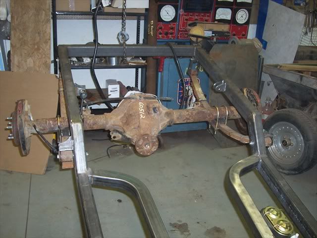

  14. Rande
    Joined: Oct 16, 2004
    Posts: 349
    Rande
    Got some work done today.
    As I readied my DD Jeep for a trip this coming weekend, my brother got the brake pedal hooked up to the booster and MC. He got the whole shebang mounted. Once I was done with my job on the Jeep, we installed the clutch disc, pressure plate and ****** to test the clutch pedal. We did have to shorten the rod leading to the clutch fork. Everything worked fine with that.
    We then set about removing the 8" rear axle and installing the 8.8". The 8.8's original spring mounts were 1" off from where we needed them to be. We torched off those original spring mounts and I set to them with a grinder. We needed new U-bolts for the new axle, so we took a lunch break and headed 20 miles into town for munchies and to get some larger U-bolts. With full bellies and the needed U-bolts, we headed back to the shop.
    We made new bolt plates for under the springs as the 8.8 axle tubes are much larger than the old 8". While working on this, we decided to remove a few of the leafs from the ScoutII spring pack I am using in back.
    Truck now sits a few inches lower. The springs now seem too soft so we will be putting one leaf back in to see how that works.
    Here is where we are at now. Its on all fours and can be rolled around but the steering is not yet hooked up.
    Next weekend, I should be in Colorado for a vacation. Meanwhile, Gary took the radiator and grille shell home to get the radiator mounted in the shell. We didn't get the steering hooked up because the U-joint I ordered for the end of the column didn't show up. Plus, we had plenty of work with everything else we were doing. Gary is also going to shorten up the column mount for the underside of the dash. It was just a bit too long.
    When I get back, plan is to install the steering column and get it all hooked up. We'll stiffen the rear springs, get to mounting the radiator and grille shell. And shorten the driveshaft we have.
    1 Day a week is not enough but has has to suffice for now. Summer is coming up fast. It'll be a bit rough and in primer but I hope to have it on the road.
