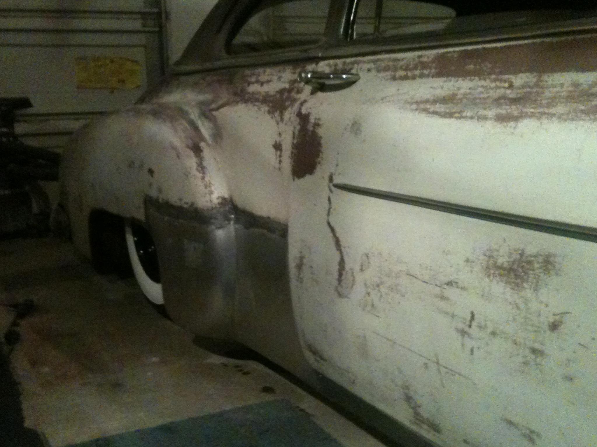

    The outer rocker panels were fine, but the front half of the rear quarter just weren't as nice as I expected: the lower lip was at LEAST an inch or two too deep (just like in the photos posted by malibu) - I had to cut them off and pound out a lip myself - AND the "bulge" area was wavy. It was exactly the same on both sides. Also, the stamping lines are not as crisp as factory: the Chevy quarters are like a crease, while yours are more like a small radius.
    Unfortunately, I cut the p***enger side fender on my car to use as much of the repair panel as possible and didn't notice the waviness or different line until it was installed. On the driver side I took the opposite approach, cutting your panel down as small as possible to repair the bad areas on my quarter. That worked much, much better.
    I am not trying to say your products are junk, only that in this case (1951 Chevy lower front half of rear quarters) the stamping does not match factory lines perfectly and does not match your own outer rocker panels, which had about the right amount of lower lip on them if I recall correctly.
    I'm sure it's hard to stamp them out perfectly, and I'd use EMS again in a heartbeat for smaller and/or structural parts like the rockers, but I might have taken a different approach to a large area like the rear quarter if I'd known beforehand that they would not be quite 100% as original.

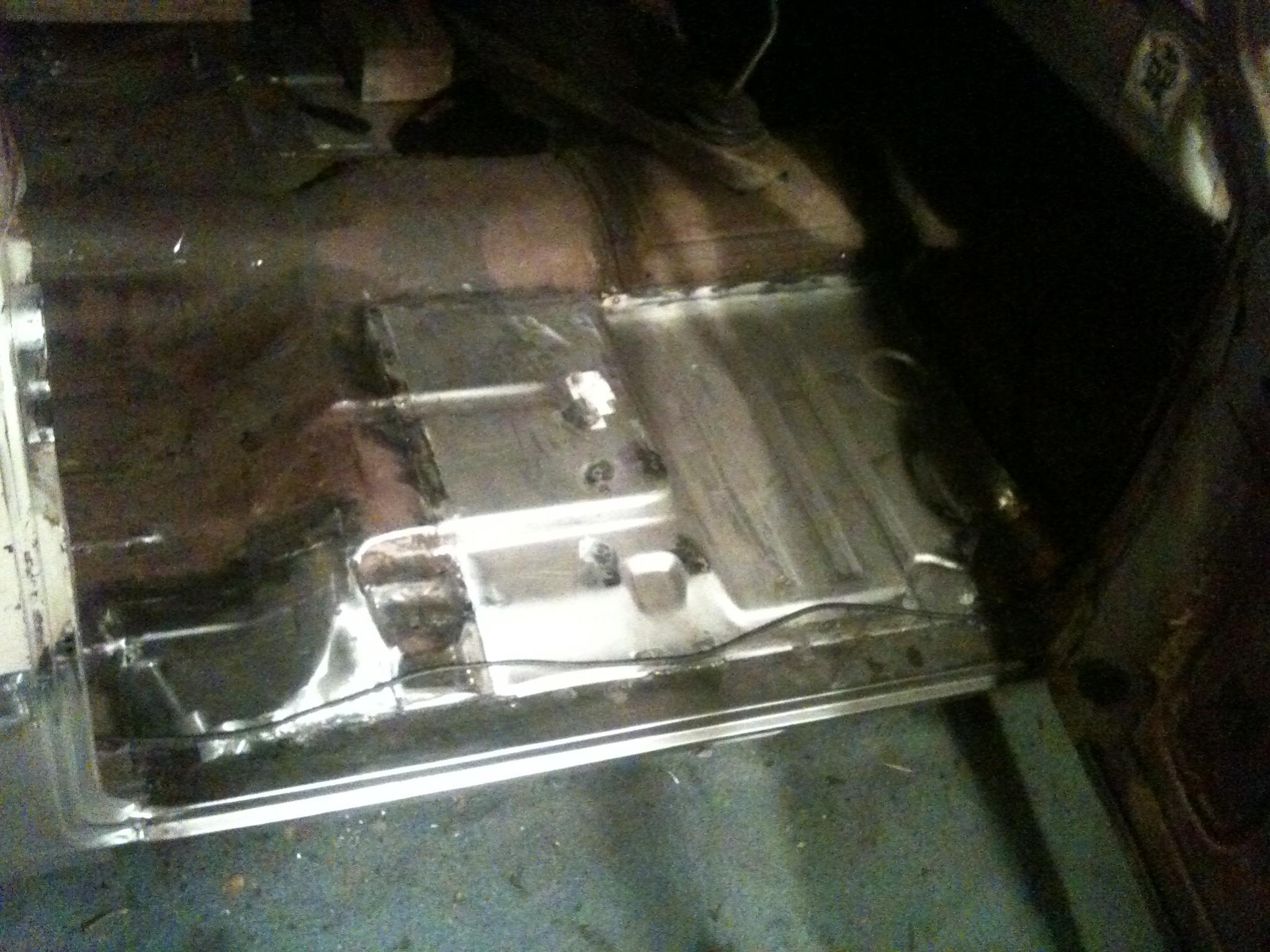

    More repairs now for the p***engers side, wont be so bad, at least I think, needed a brace to be made for the rear floor. Turned out okay, works and its a lot cheaper than buying one.
    Now to repair rear floor while I wait for the outer rocker and lower quarter.
    hope it goes as good as the drivers side, I want to get it on the road but still needs the driveline and elect. lines breaks ect.

    I finished the bracing and the floors yesterday, need to post the pics but getting them off my phone is a pain in the ***........Will try to post soon. I am happy with the choice I made to make rather than buy the pans and bracing, maybe a bit more work but I am a better welder than when I started and my wallet is happier!
    All that is left to do is paint the floors and seam seal the bottom. Some day when I have carpet nobody will know I did anything to the floors.
    Now to start on the rocker and quarter and I can finally start putting the car together, suspension engine swap and wiring, hope to drive this thing before the end of summer and go to the iron invasion in October, keep me motivated guys!

    some pics of the bracing I had to make along with the mounting locations for the seat.

    And the finished product! I am happy I chose this route and think it looks and will work just fine.
    What do you guys think about it?

    Finished the floors and painted them. Also finished the wheel opening and lower quarter patch along with the outer rocker.
