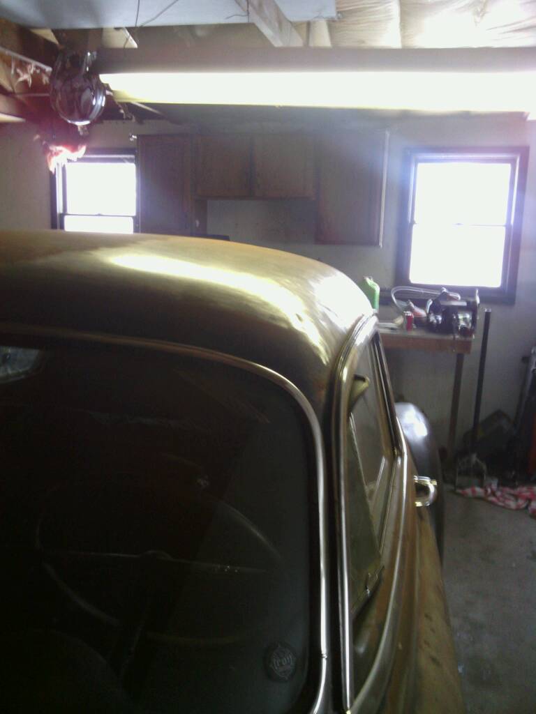

    Some pictures for anyone who might care.....been banging the roof out... still needs more, far better lines than the oak tree left in it! And one just for fun!
