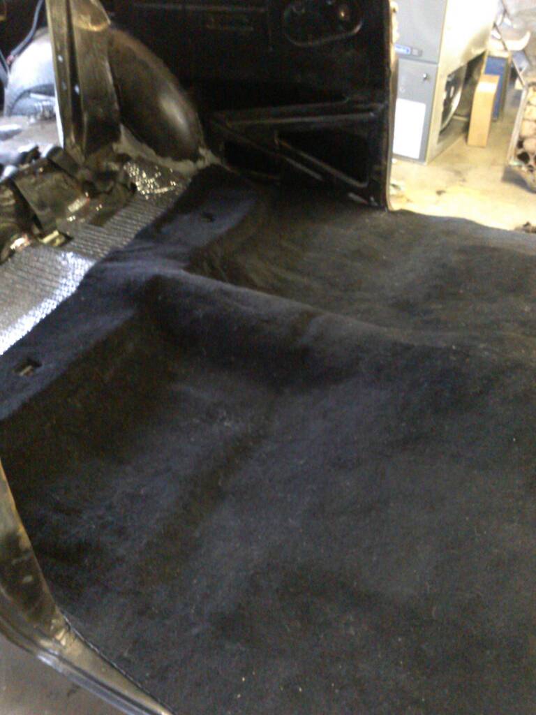

    Installed reflectix insulation (picked up from home improvement store) to floors using spray adhesive and tape. This should cut back on heat and some noise from underneath.
    Then i installed new carpet. Hopefully this will make the ride a bit more comfortable.
