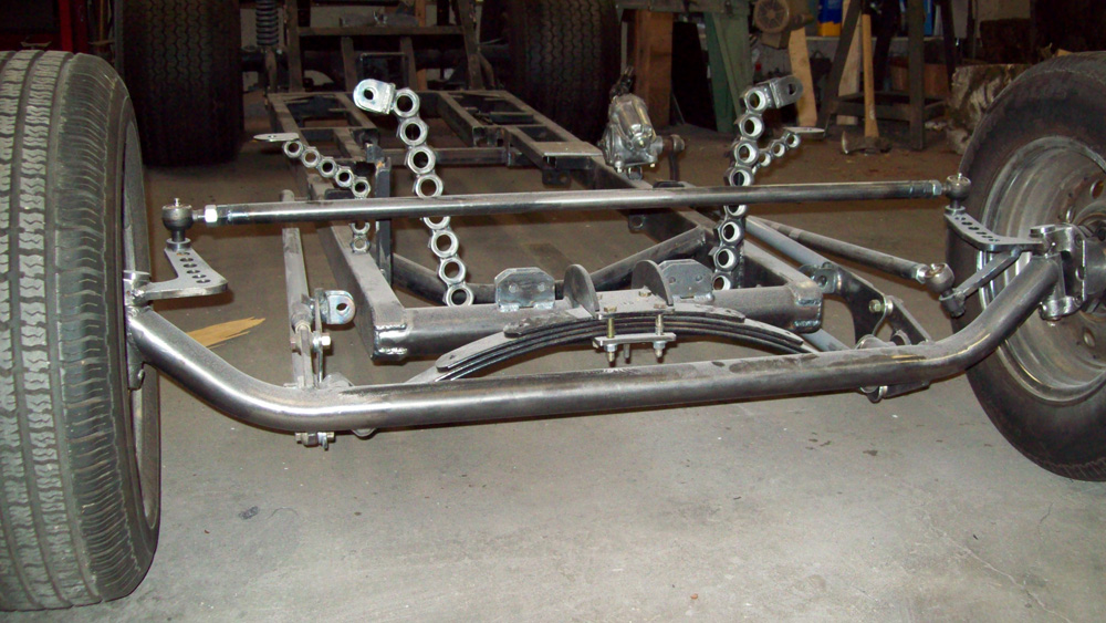

    This frame was so low we had to put the steering rod on the top side.
      260.5 KB
      165
