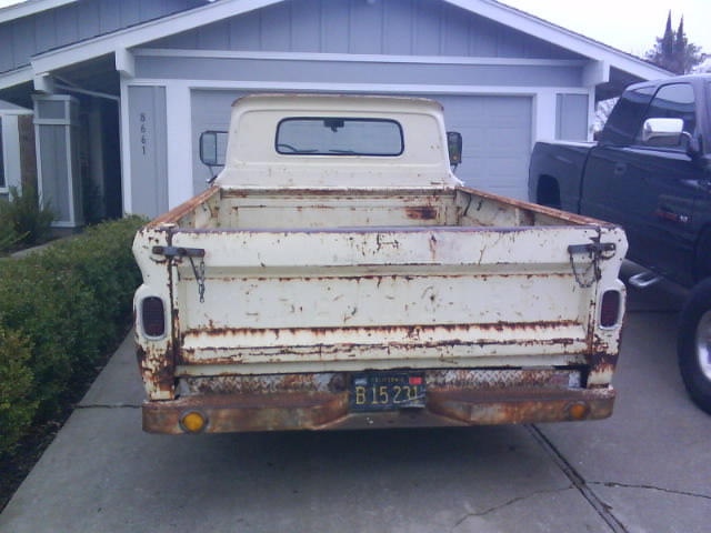

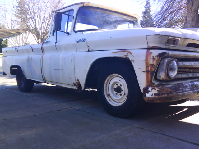

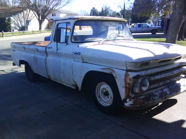

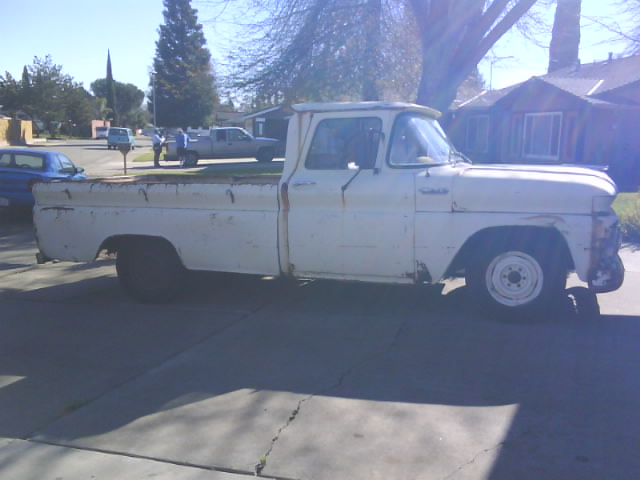

    I just brought it home about a week ago, my father in law gave it to me. my question is about lowering it cheap I already backed off the torsion bars as much as I can but I want to go lower and as for the rear can I just heat up the coils a bit, I know its not the best way. my plan is to lower it and paint the rims gloss black and put some narrow whites, What do you think?
