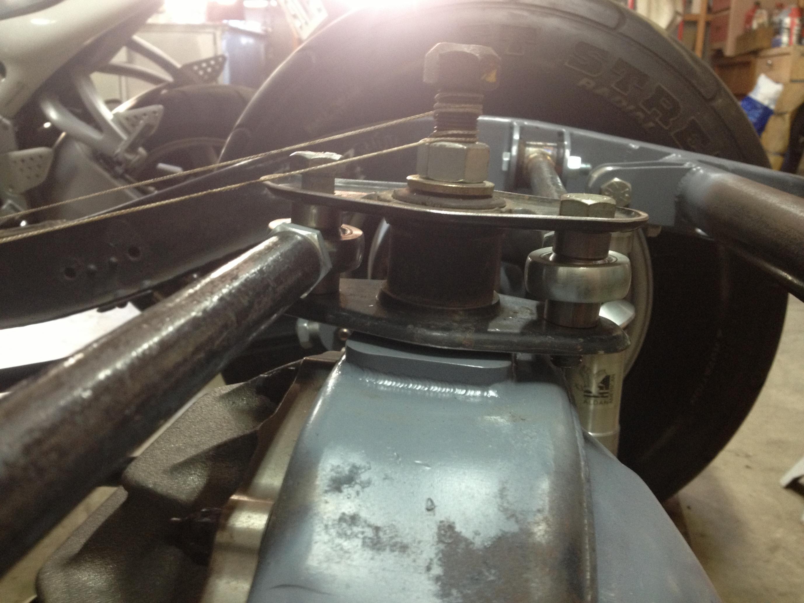

    Curious about the way the heims sit on top of the third member horizontally, rather than vertically like the frame end? I did it the same way on my build, and they work fine with the limited travel my car's axle has, but caught all sorts of hell here from HAMB members when I posted pics of my arrangement.
    Guess the same people haven't seen your build! ;)

    That pivot link is off a factory car. It looked like it would work so I got it, got a couple of heims, sat it all together and thought yeah. The heims have a spacer either side so there's lots of room for them to move throughout the full range of diff travel that my shocks allow. I've been around both speedway and offload race cars and they use heims horizontally in the steering systems, and the offload cars at least really give them a workout. I think they'll be ok here. I like double shear mounting too, and again this lends itself to that easily. Not sure about the high roll centre but apart from that I like the setup. This is my first ever ch***is build though so its a steep learning curve.
