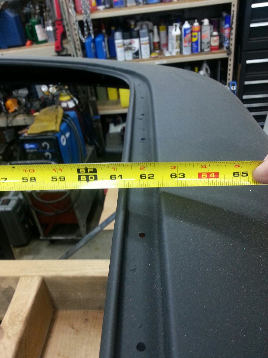

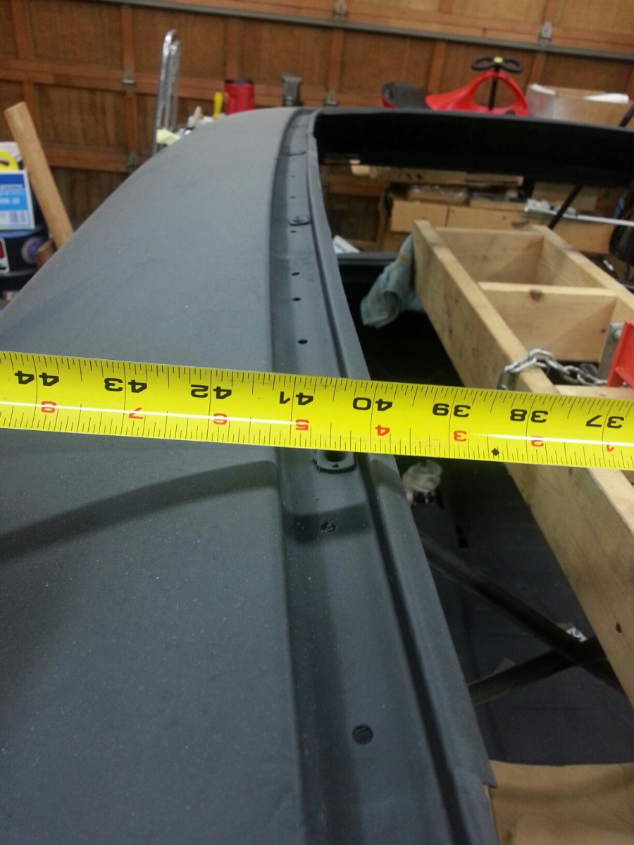

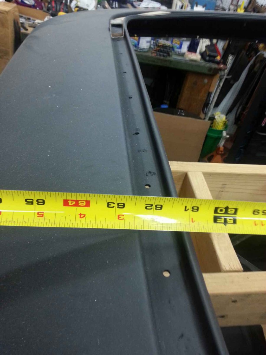

    I attempted to calm my nerves today. I went down to the garage and worked on the soft top for a couple of hours. I took lots of internet pictures with me. I have been unable to get anyone with a real 34 Tudor to give me accurate dimensions so I said F%@K it and just winged it. I measured and measured and using painters tape have it all laid out. The wife gave me a hand. Stretching the tape out over an 8 foot span is pretty tough to do alone. I used a 7" cutoff wheel to form the front corners and a 9" cookie plate to form the rear corners. I put a slight bow in either side because they didn't come straight from the factory. Then I came upstairs and remembered that I have a 1/25 scale model of a tudor sedan. I'm going to pull some dimensions and see how close I am. I kinda like it where it is so I may just start drilling holes. The nicest part was a couple hours of total bliss not thinking about anything but the car and my sweetie by my side.
  26. Johnboy34
    Joined: Jul 12, 2011
    Posts: 1,658
    Johnboy34
    from Seattle,Wa
    I don't recall you asking. Front to rear about 6" from edge, front to rear @ center, side to side at first wood bow, side to side at rear. Across the roof in front is pretty straight, rear has very slight bow. Front to rear bows quite a bit being narrower at front. Hope that helps a little. John
  27. BIG-JIM
    Joined: Jun 13, 2009
    Posts: 1,379
    BIG-JIM
    from CT
    I posted a thread on Monday and posted on 3 other sites (one pertaining strictly to model 40's) and got no response. I did not post on this thread though. http://www.jalopyjournal.com/forum/threads/34-sedan-soft-top-dimensions.1003344/#post-11317622
    I wasn't looking for the actual dimensions of the hole (though it is nice to have) I was looking for placement. Like how far from the edge of the windshield (center) does the hole start? And how far from the edge of the back window (center) to the edge of the opening and the same with the sides. I took the dimension for the sides at the hinge. Thanks for the help.
