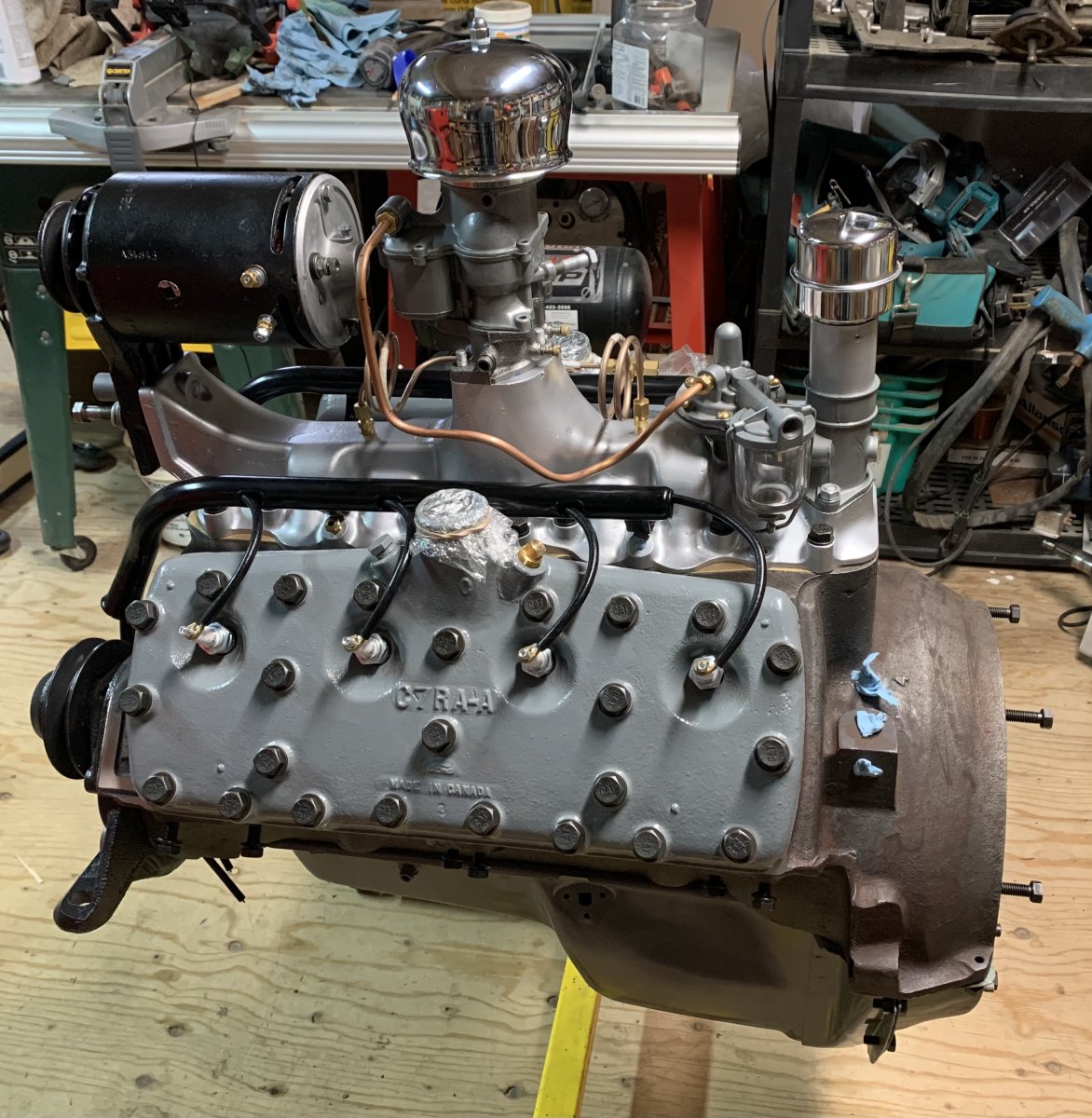

    My air filter ***y snd breather cap finally arrived yesterday from Speedway. I think they took over a month to get here. If I keep them, I likely see if I can refinish them in a copper colour. I recently saw a pic of of a carb with just a copper mesh over the carb which I thought would be cool.
    While working on my carb, I noticed I’m missing one of gaskets that goes between the centre and upper sections. I have one, but it is not for my carb. I just hope I didn’t through tbe correct one out. D’oh.

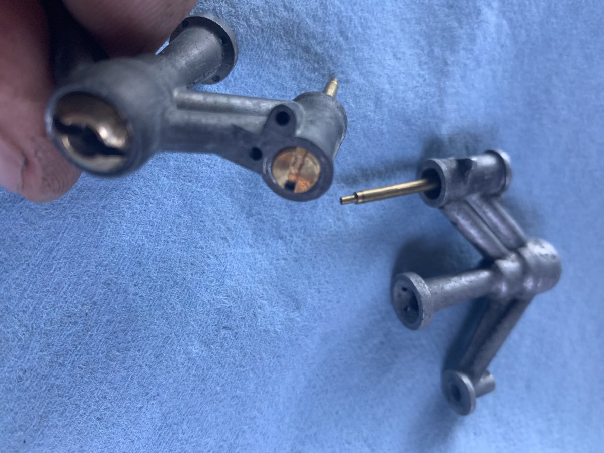

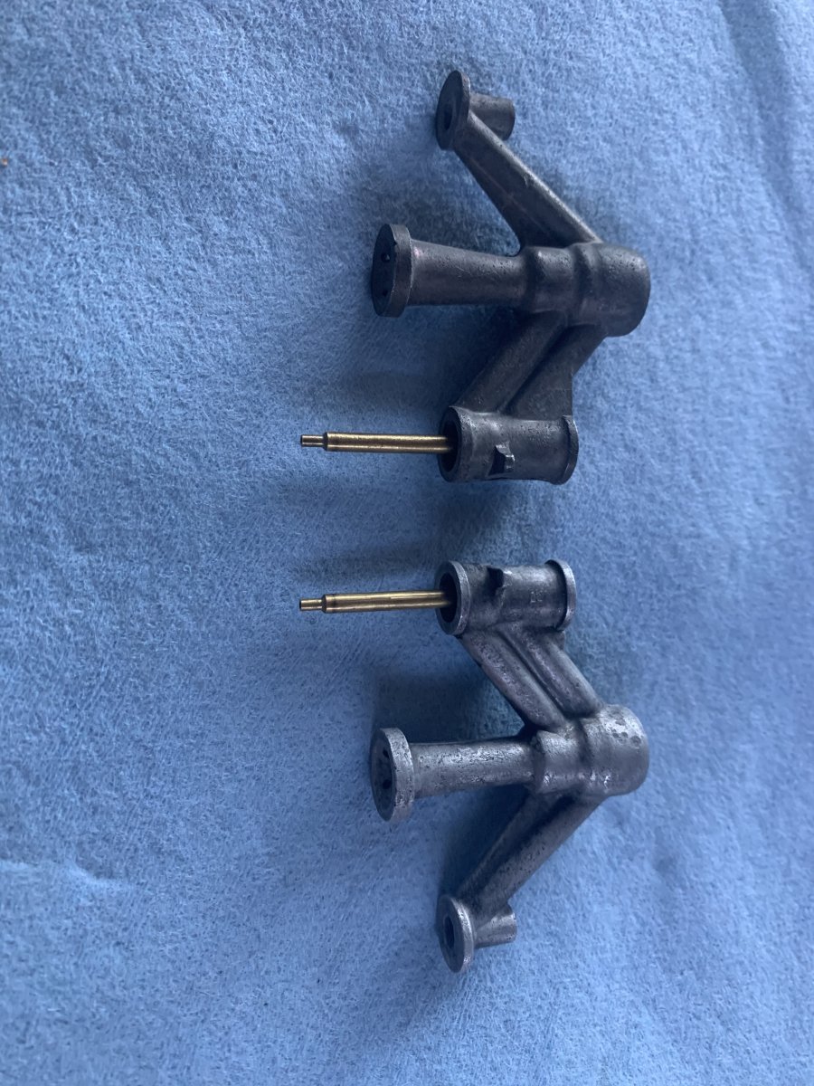

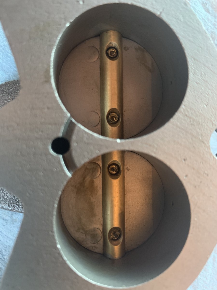

    Well, the carb rebuild started off poorly yesterday, and just went down hill. After taking forever trying to install the very tiny 6-32 screws for the throttle plates, and after watching a vid describing which way they should be installed (there is a bevelled edge on one side), I later learned that vid was incorrect, so I had to rinse and repeat. Later on in the day, I discovered the plates are still loose, so I need to rinse and repeat to see what the issue is. I also discovered that the accelerator pump circuit needle valve was actually still stuck in the body. I had to drill a hole on the top of it and use my smallest extractor to get it out. Luckily, it came out easily, but the bad news is that aside from now needing a new valve, there is a lot of crud still stuck down in the well and surrounding circuit. Also, there were a few p***ages on the nozzle bars that were plugged from walnut dust when I threw them in my ********y grinder. Had to use my welding tip cleaning tool and 0.025” welding wire to get them clean. That took a couple of hrs, so what I thought would take an hr, took the better part if a day, and I basically have to start over. The good news us that the throttle shaft moves freely now and has no play after I smeared on some moly grease onto the contact surfaces.
    Throttle plates. I think I may have installed the screws the wtong way. D’oh!
    Throttle plates with bevelled edge.
    Nozzle bars with new idle tubes.
    Offending p***age (one on top) that was plugged on both nozzle bars. Had to resort to using the welding wire, but it was still very tough to punch through.

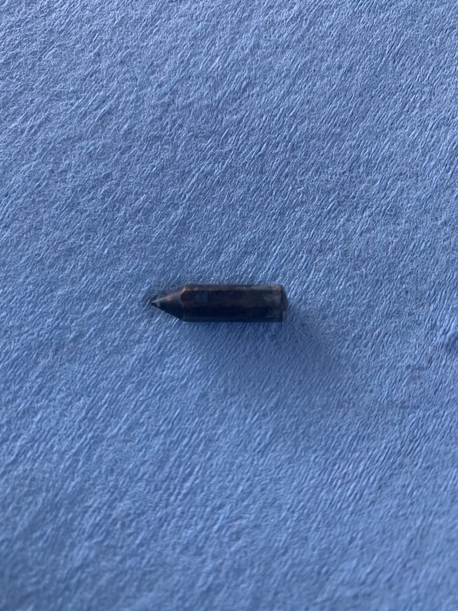

    Freed accelerator pump needle valve. I have another carb body with the same issue. I’ll see if I can get it out by heating the body up in my oven, and shaking it out.

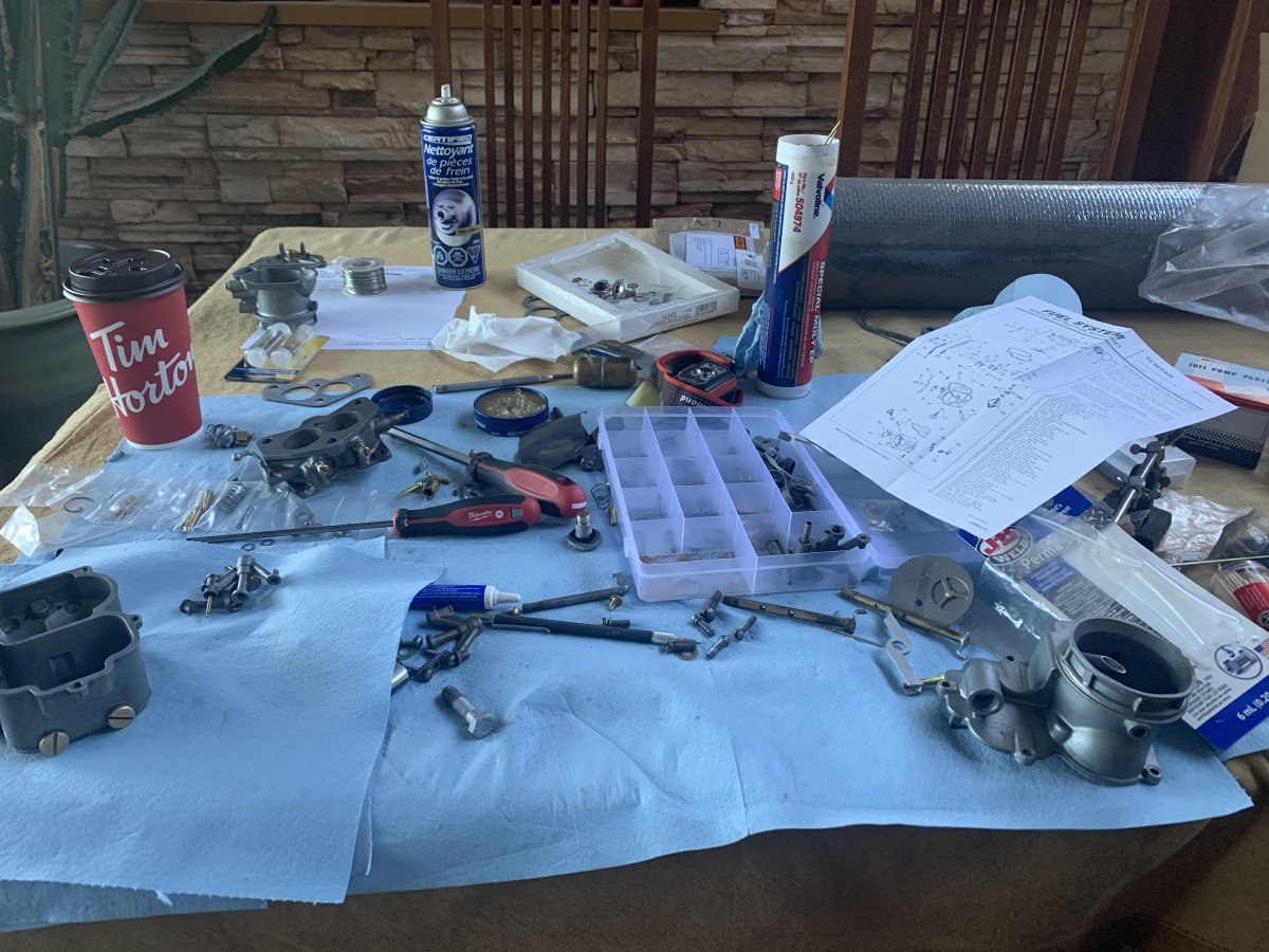

    My impromptu working area. My late wife would not have approved!

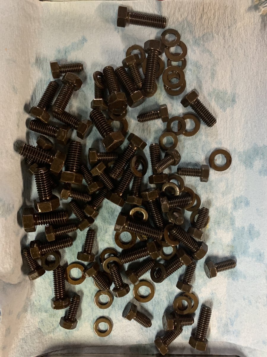

    After heating the body up in my oven at 400F for 30 minutes it came out after a few smacks. I’ll polish it up a bit with my Dremel, and pop it in. Also discovered I’m missing one of tbe acclerator piston springs. Damn...

    Were you satisfied with your blueing parts?
    Been thinking of doing some parts of my own

    I have to say yes. I think the key is getting everything into the oil immediately after heating it up (450F). Initially I was picking bits and pieces up with a tong , but with the number I had it was taking too long, and I could see a difference in the finish. The proof will be whether they start to corrode. I have a bunch more hardware to do, and I may do it on tbe exhaust flange from Hellsgate. They advertise it as being “pickled and oiled”.

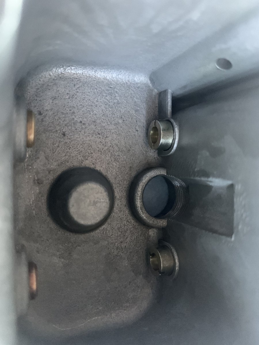

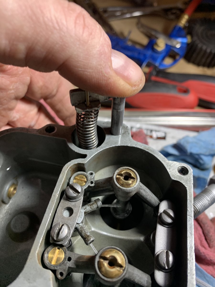

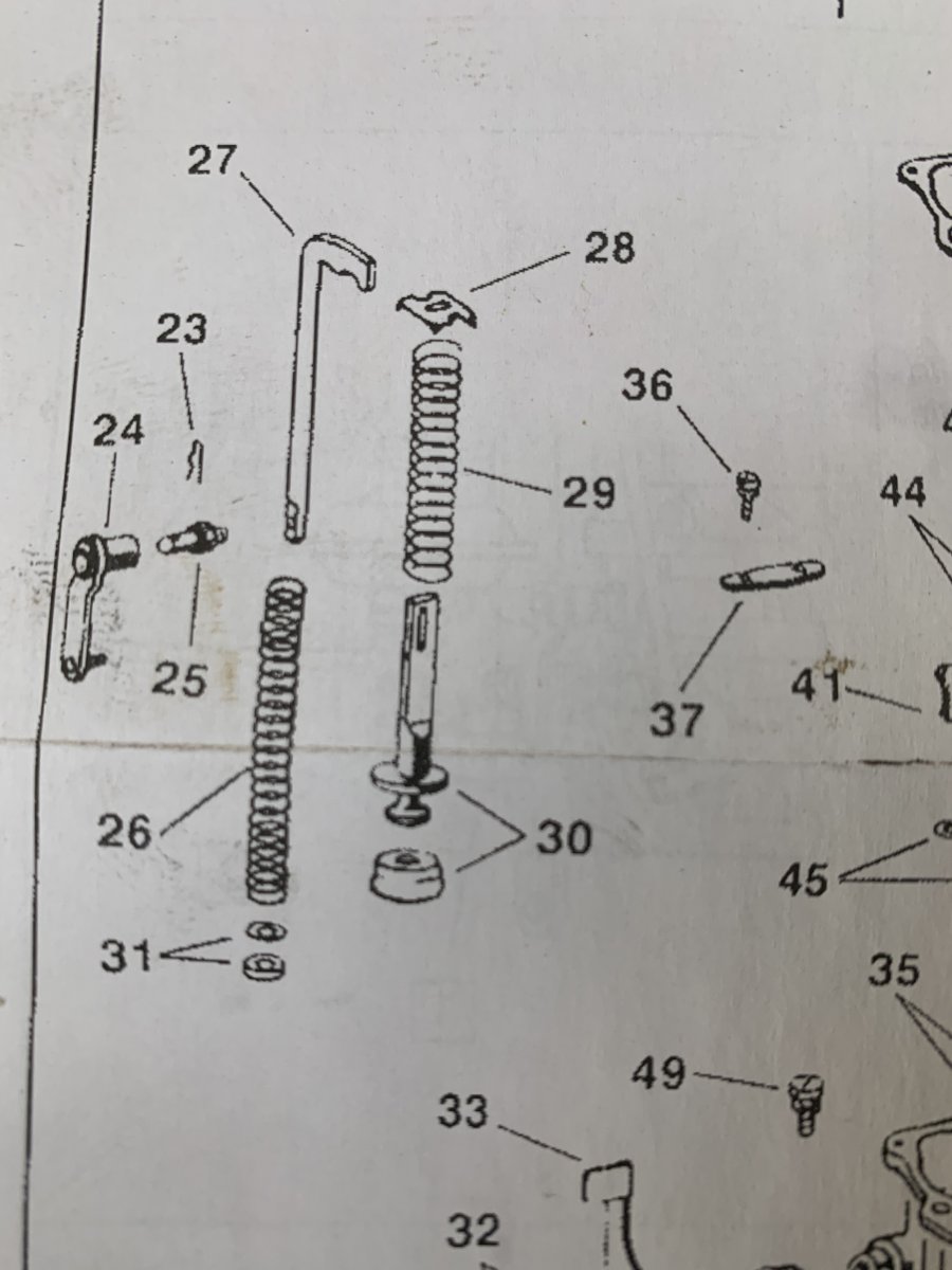

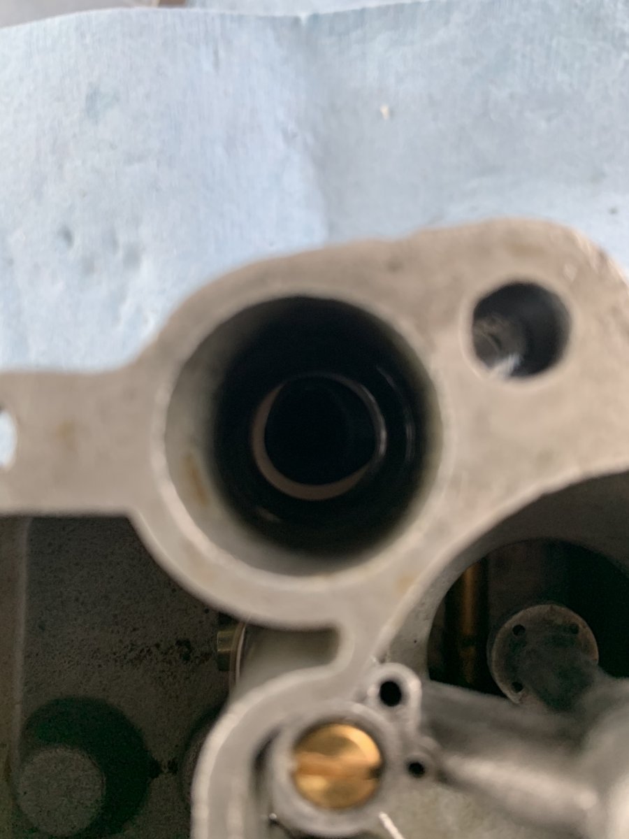

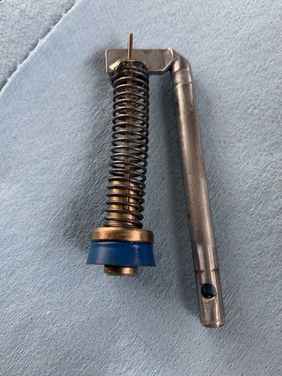

    Thought I was done with the carb rebuild yesterday, but then rediscovered that my accelerator pump operating link had been damaged during dis***embly (part of the pin had broken off in the accelerator pump rod). Also discovered, that I’m not crazy, and that some models did in fact have a spring on the accelerator pump rod. Instead, it seems you can add a spring under the accelerator pump piston/seal. I had actually purchased this spring! The other thing is the felt seal that goes on the pump rod. I have the seal and have seen rebuild vids that show the seal and some that don’t. I don’t believe mine can accept a seal as there is no room for it in the body. The exploded view also shows a washer that goes with the seal. Again, I don’t recall seeing either during dis***embly.
    The bigger problem though is tbat the accelerator pump circuit is not working. I added some paint thinner to the fuel bowl, and nothing came out of the discharge nozzle. I removed the nozzle, and still didn’t see any liquid coming out. Added some shop air from the nozzle p***age and started getting bubbles in the pump well, and then in the fuel bowl. Now I have some sediment/debris in the fuel bowl. Will still keep trying to get it cleaned out, but may just get a ultrasonic cleaner.

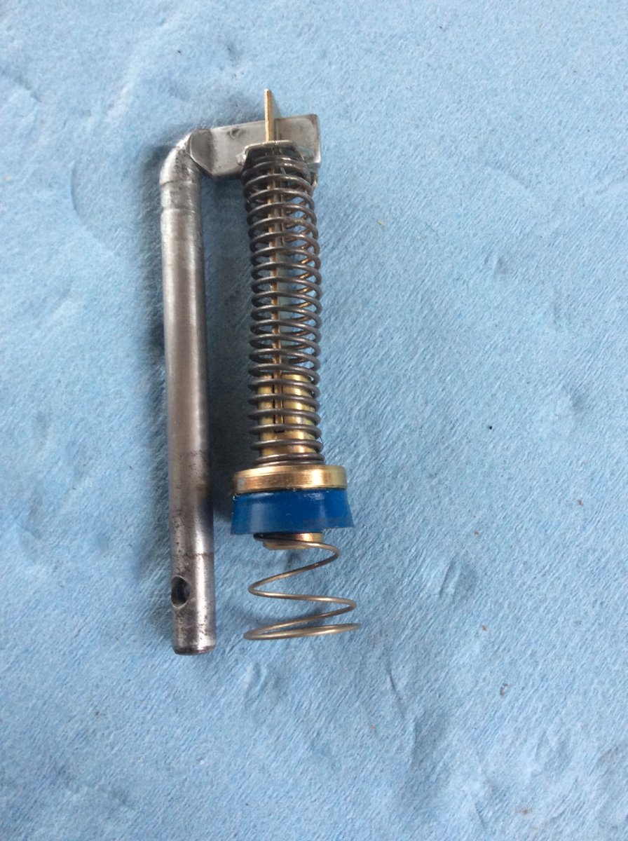

    Exploded view (came with kit) showing “extra” spring (Item 26) on accelerator rod.
    “Optional” spring that goes under the pistion/seal. My exploded view does not show this spring, or any others I could find.

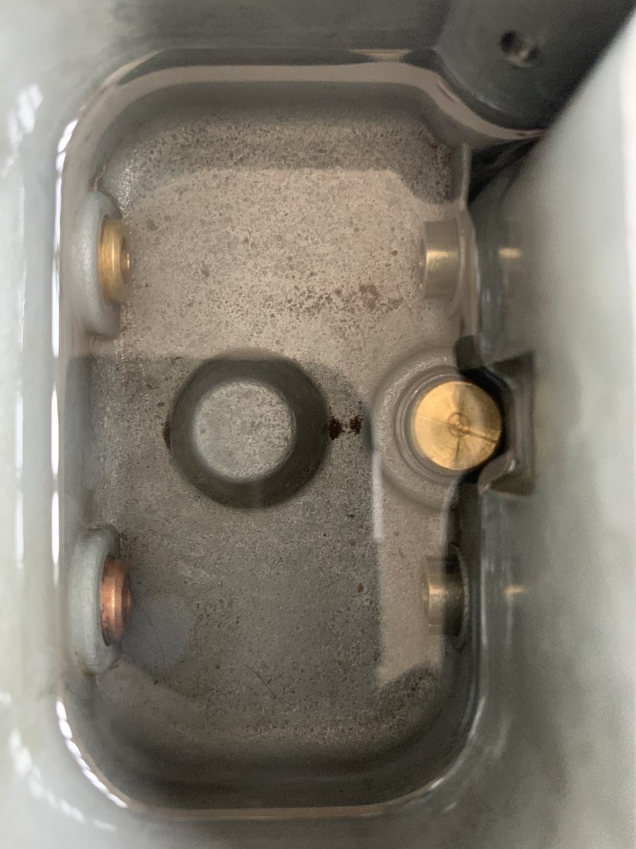

    Sediment in fuel bowl after applying shop air to discharge nozzle p***age.
    Discoloured liquid in accelerator pump well. This thing must still be filthy in these p***ages.

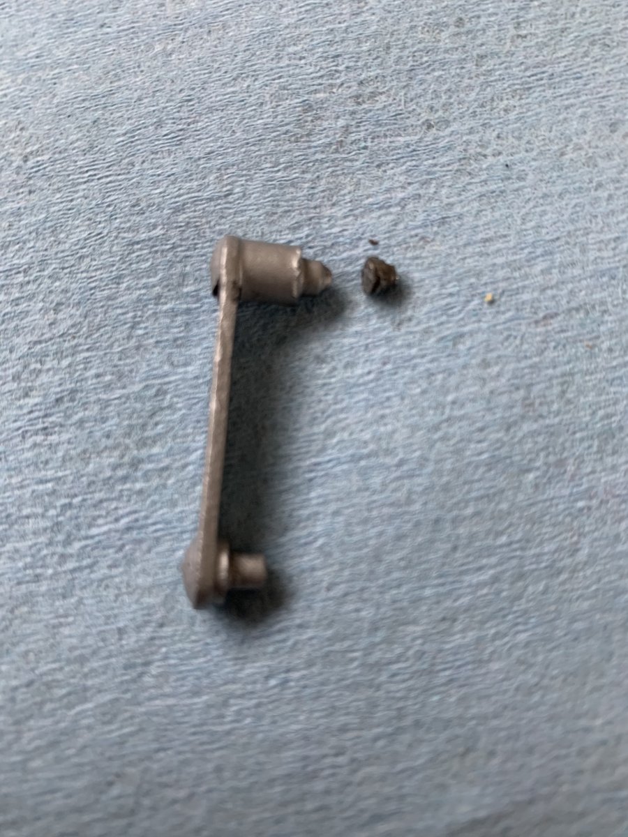

    Busted link.

    After almost giving up, I finally managed to clear the p***age of debris using alternating pulses of my shop air cranked up to 150 psi on each end of the p***age. Yes! I can finally move onto something else!

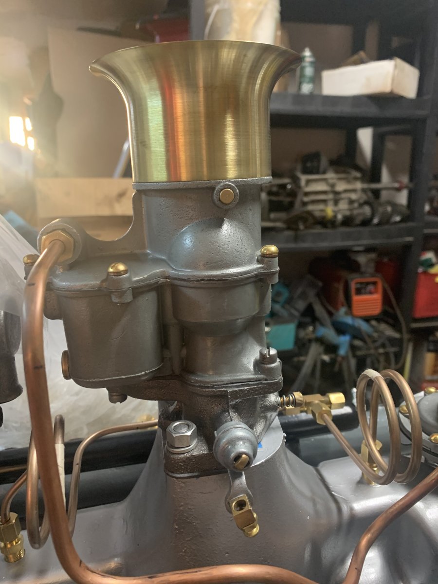

    Also picked up two larger belts (B54 & B55). I think the B54 might just barely fit with the generator adjusted all the way down. Got some engine ***embly lube as well. I’m bit worried that my machinist didn’t use any on the cam gears. Can’t remember if he said he put some on the cam, but can’t imagine he didn’t.

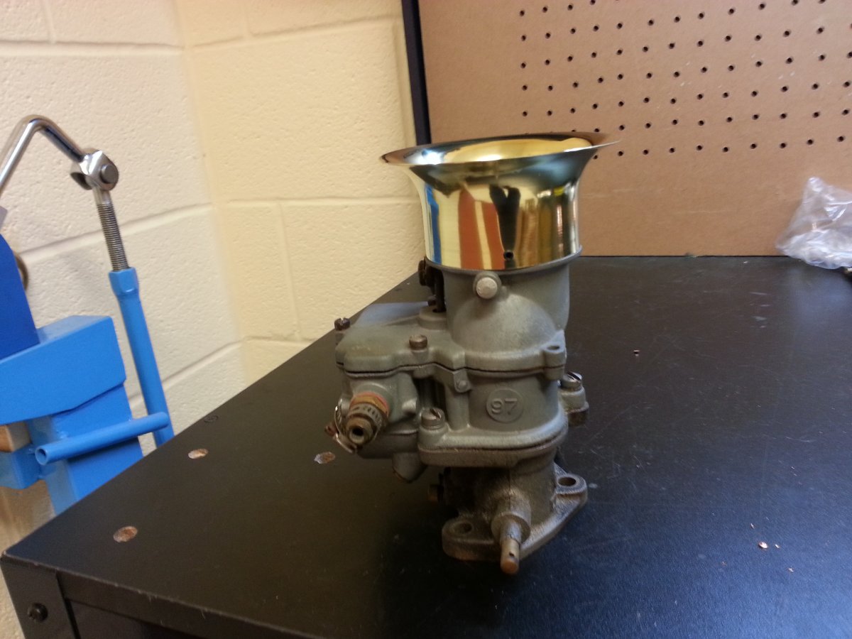

    Just found this nice br*** velocity stack. Wish I knew about it before I bought the helmet style cleaner which is said to be too restrictive.

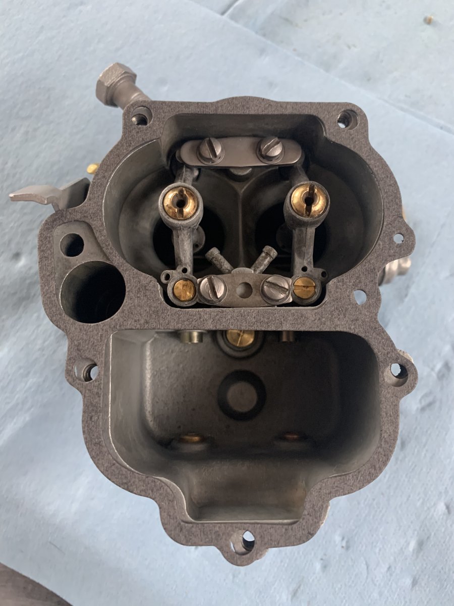

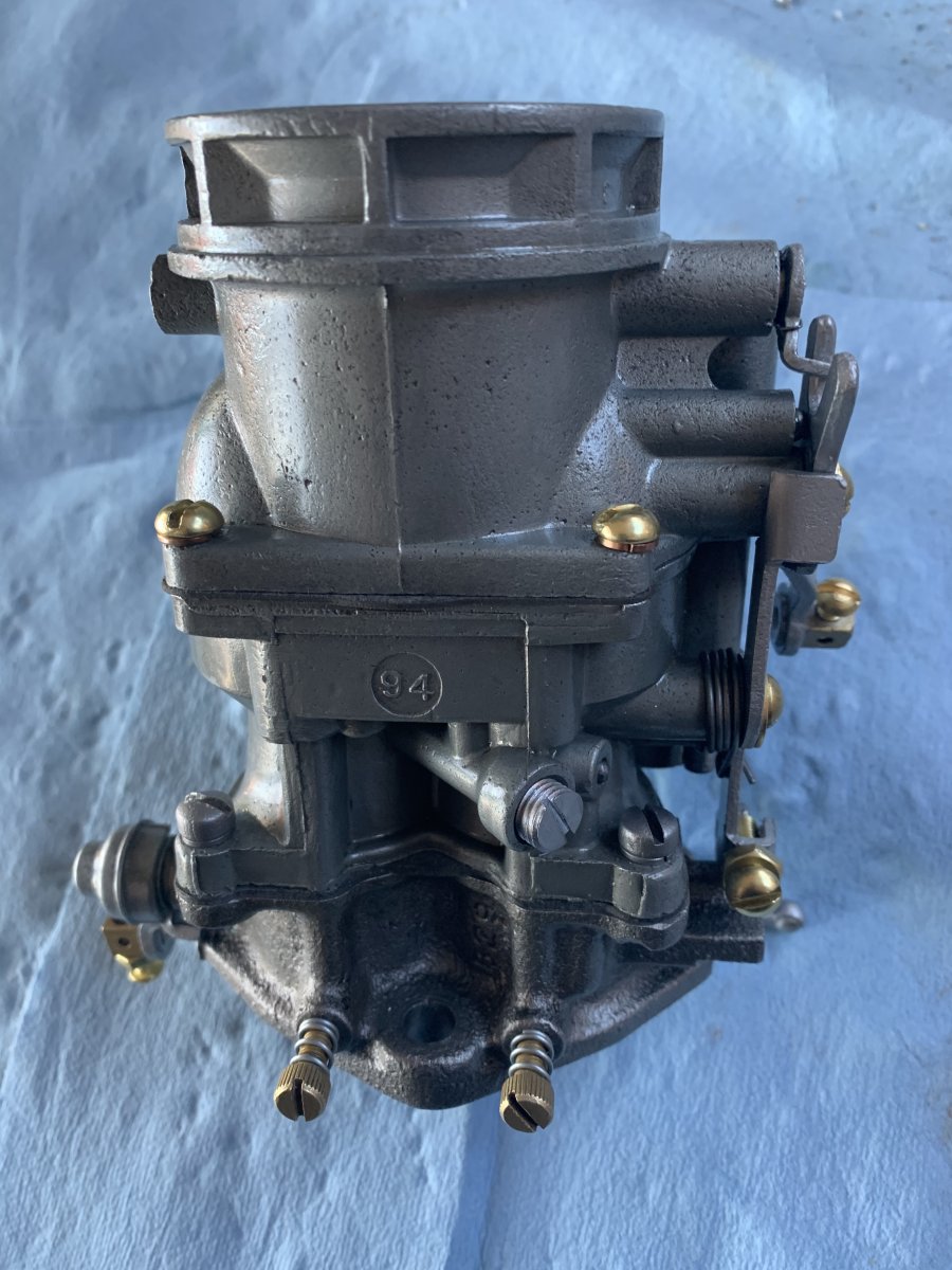

    “Finished” carb.

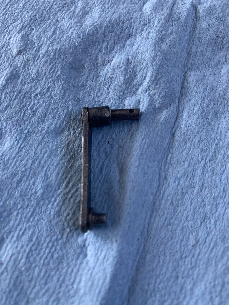

    Tried to repair the accelerator pump rod link with a new shaft, but couldn’t quite get the hole ligned up, and it is just enough out of alignment to cause a bit of binding, so I’ll just order some new ones. Also cut down the bolt that was used to close up the “ported” vacuum opening. Will order a proper br*** plug next week when I order all the br*** 45 degree flare fittings for the remote oil filter. My machinist said to run it without initially to see what the “normal” oil pressure is, as with the remote filter hsg, you require a restrictor which I think was 0.051”, but folks use a “standard” off-t******lf one which I think is 0.062”. Might be enough of a difference resulting in too low a flow/pressure to the engine. Something more to think about.

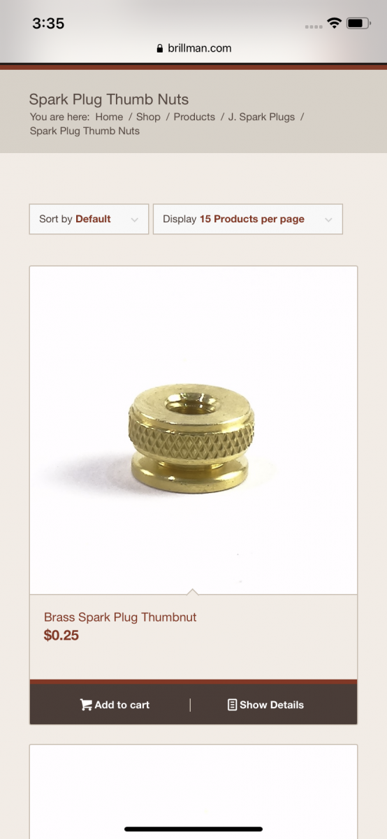

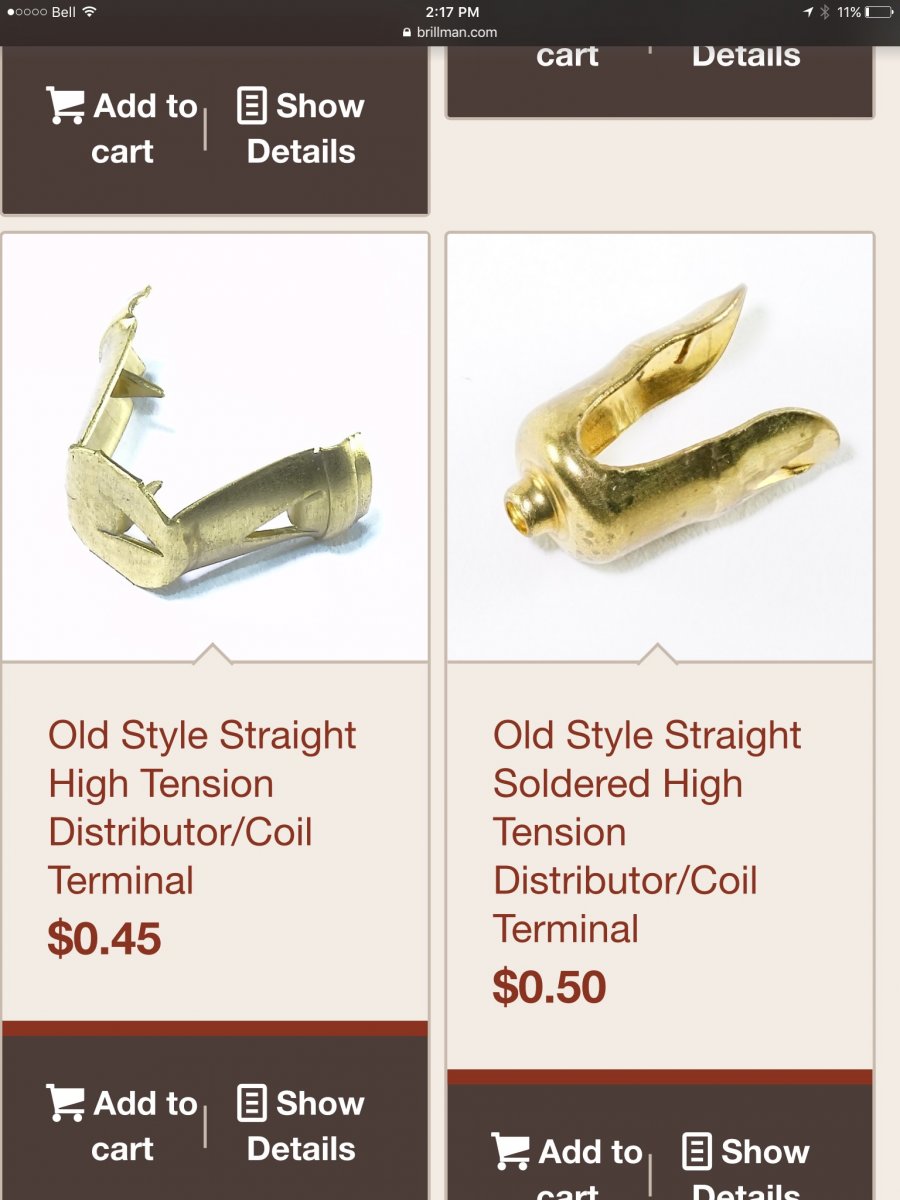

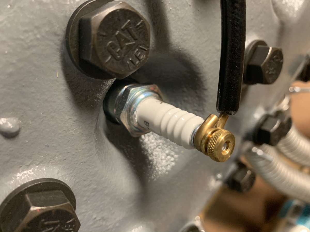

    Forgot to also mention I decided to go with the solder type terminals for the distributor cap ends on my spark plug wire leads as the “push and pinch” ones (on the left) just seem a little weak.
    I also ordered some M4 knurled nuts for the sparkplugs/loop terminals.

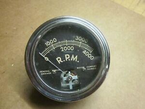

    After spending way too much time looking for a vintage tach, I finally decided to go with this odd ball. Kinda fits the character of the build or builder. Lol!
    Absolutely no info tbat I could find on the interweebs (Chicago Marine Motor Company), but price was right (US$45). We’ll see...
    Awesome summary of how to build your own electric tach drive board.

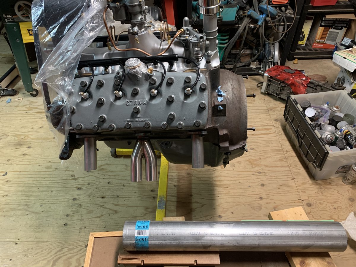

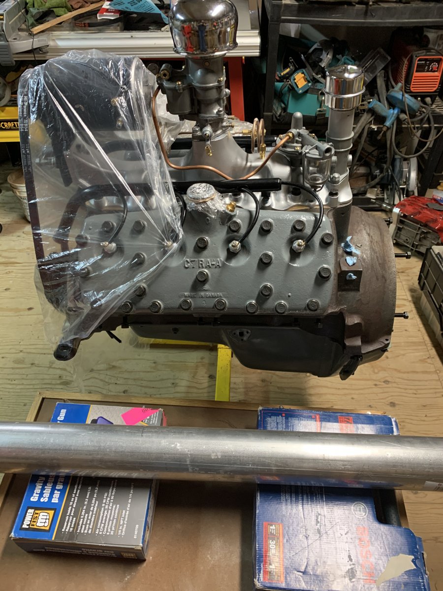

    Picked up the 4” exh pipe. The guys at CarQuest thought I was crazy when I told them what I wanted it for. Lol!

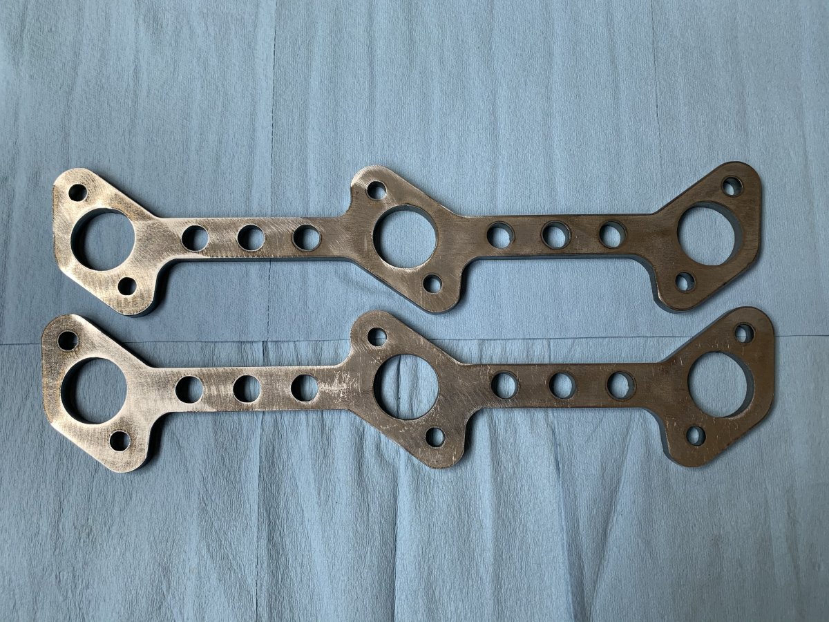

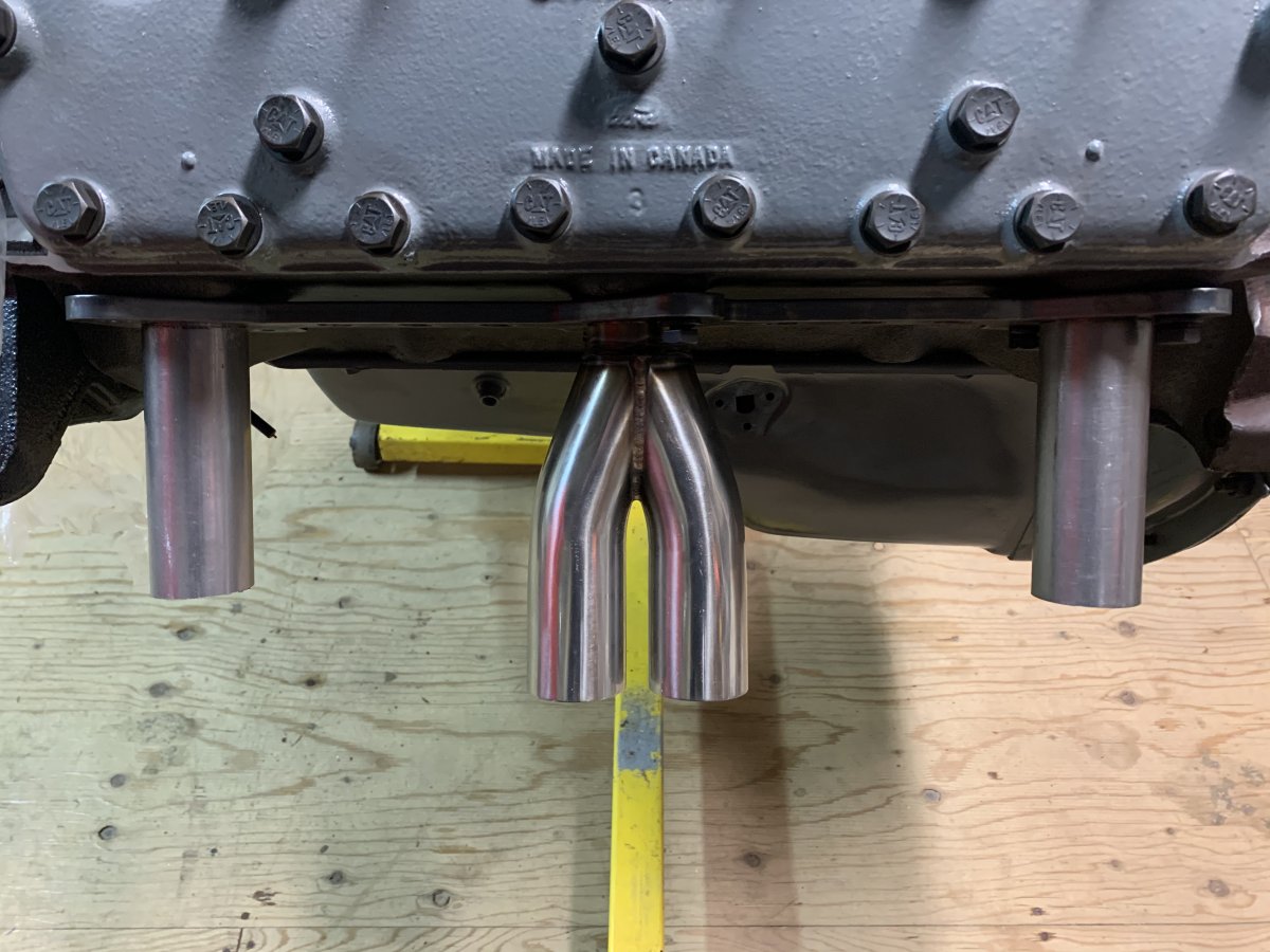

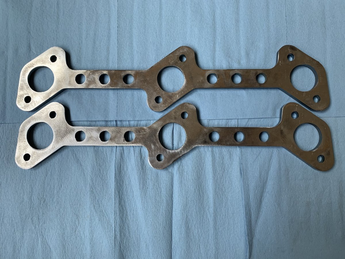

    Picked up my Hellsgate exh flanges this morning at the local convenience store (Purolator won’t delivery to our house). Don’t seem to be “pickled & oiled” as there is some slight surface rust. Backside profiles for the round cuts are slightly distorted, but that is kinda normal for plasma cuts. Was hoping the holes for the flange bolts would be sized accordingly (bolts are 3/8” for the ports up front and 7/16” for the others), but they are all the same size. The 3/8” bolts actually are slightly too big! Haha! No big deal, I’ll clean everything up with my stepped drill. Overall still a very nice product.
    Front side.
    Backside.

  22. 64 DODGE 440
    Joined: Sep 2, 2006
    Posts: 4,433
    64 DODGE 440
    from so cal
    As I recall the flatties originally had 3/8" on all the exhaust studs. I'm thinking someone must have stripped a few and re-tapped the holes 7/16".
  23. alchemy
    Joined: Sep 27, 2002
    Posts: 22,675
    alchemy
    Nope. The front four bolts are larger than all the rest.
    loudbang, Ziggster and Stogy like this.

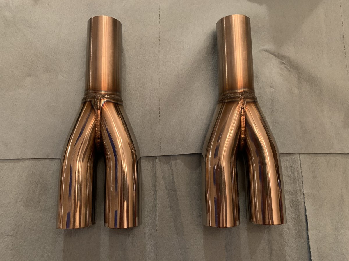

    My vintage Holley stickers arrived from Winnipeg today, but more importantly, the exh splitters arrived. Such beautiful workmanship. Too bad I will have to make them shorter and blast them for paint. Couldn’t find anything like them in USA. Can’t wait to get started on the exh, but first I need to find some 1 5/8” OD exh pipe as I’ve decided not to bore out the exh flanges to 1.75”. The smaller pipe “should” fit inside the larger pipe (with some sanding and persuasion).

    Found some 1 5/8” OD exhaust “couplers” at ****pyTire yesterday. They fit both the flange and ID of the 1 3/4” OD pipe. Will need to complete a quick layout to scale if the GN JAP exhaust before any cutting begins. I also will likely buy a 45 degree section of mandrel bent oval exhaust for the tip. Making the transition from the 4” pipe to the oval will be tricky in a sharp 90 degree bend. Looking back at pics of the GN JAP, it seems the exhaust went through stages of evolution from short straight individual sections to a collector exiting straight through the rear to the current collector with oval exit at 90 degrees. The first two systems just don’t do the car justice IMHO, and the current exhaust (10 yrs old now?) really brings out the character of the car. The exhaust can really influence the way the car is percieved. Hoping I can get it “right”.

    A bunch of stuff was waiting in our mailbox, including the M4 nuts for the sparkplugs.

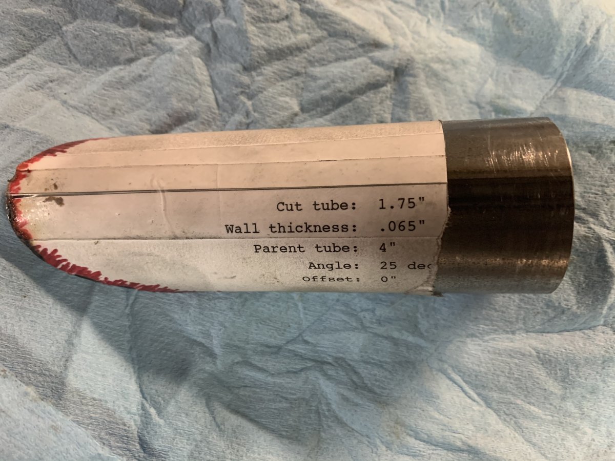

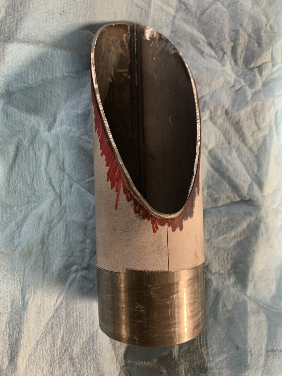

    Ziggster

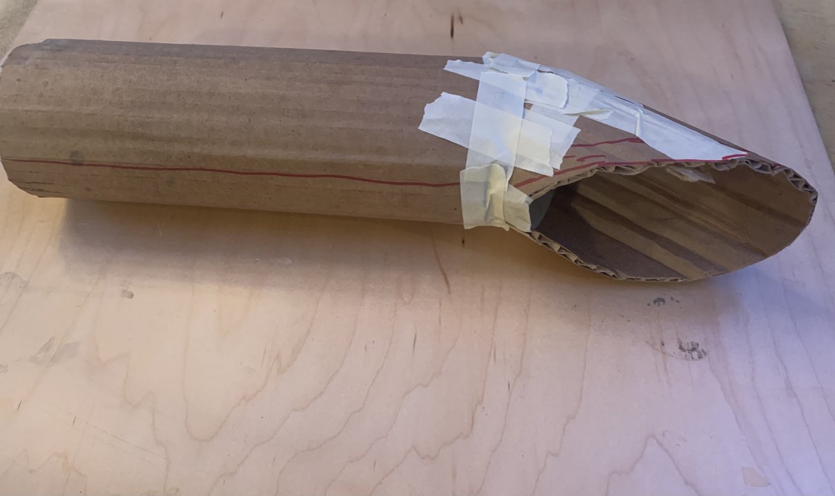

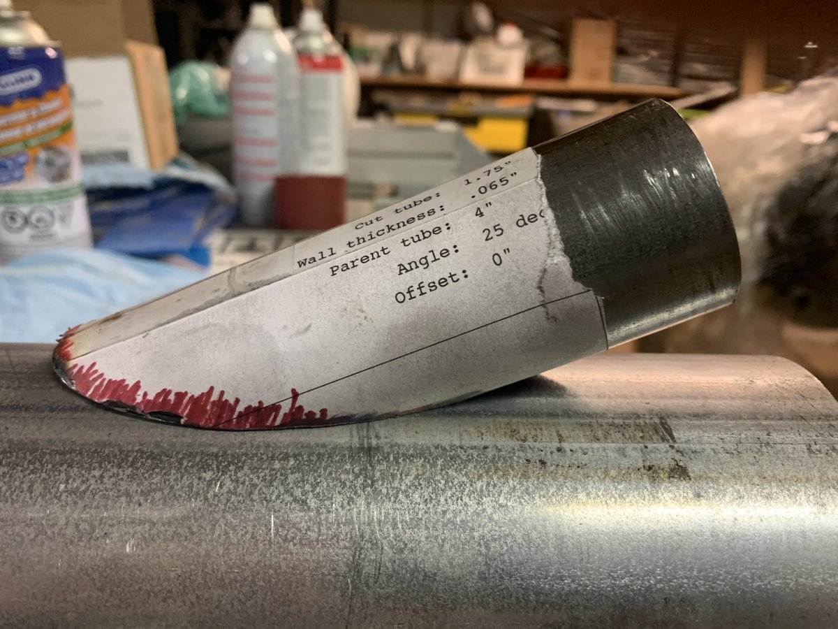

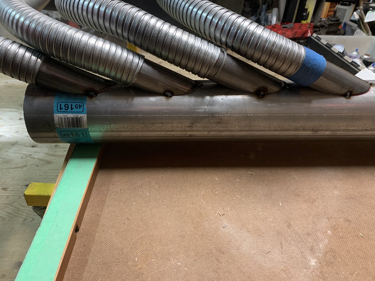

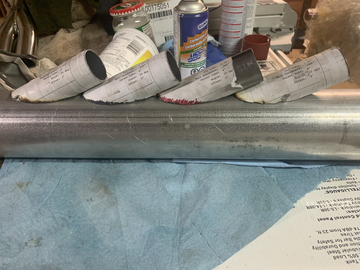

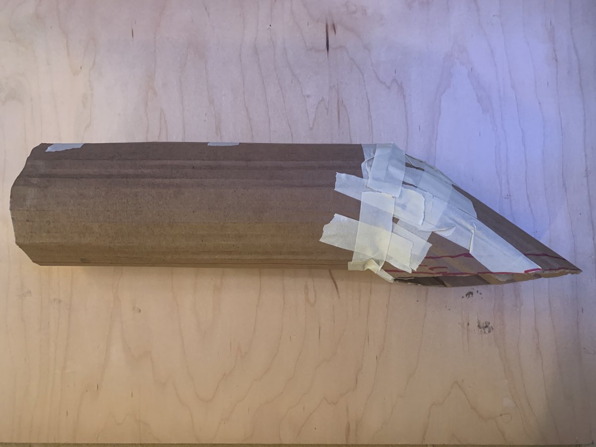

    Decided to try to cut a piece to connect the flex pipe to the collector. Used the metalgeek coping software. Printed templates for 20, 25, and 30 degrees. Went with the 25 degree one. Cut it using a cutting disc in my grinder with a little touch up with my die grinder. I’m really surprised at how well it fit. Now I just need to cut another 7. Lol!
    Link to metalgeek site.
    https://metalgeek.com/static/cope.pcgi

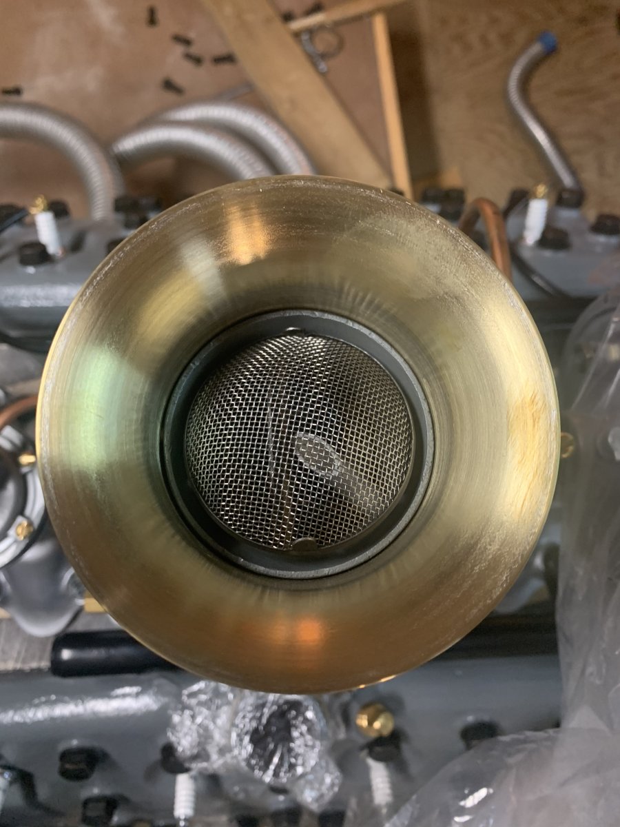

    My br*** velocity stacks and mesh filters arrived today.

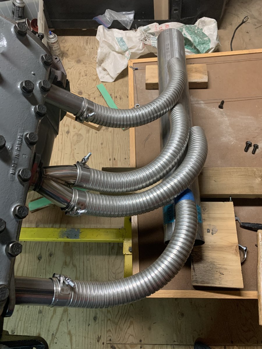

    Trying to wrap my head around tbe exhaust collector and the oval exit. Usually I’m pretty good with these things but this has me a bit stumped. I created this crude cardboard model which helped a bit, but it would be nice to model it in 3D.
    Finished making the flex pipe connectors for one side and was hoping to tack things up for a mock-up, but that will have to wait until tomorrow.

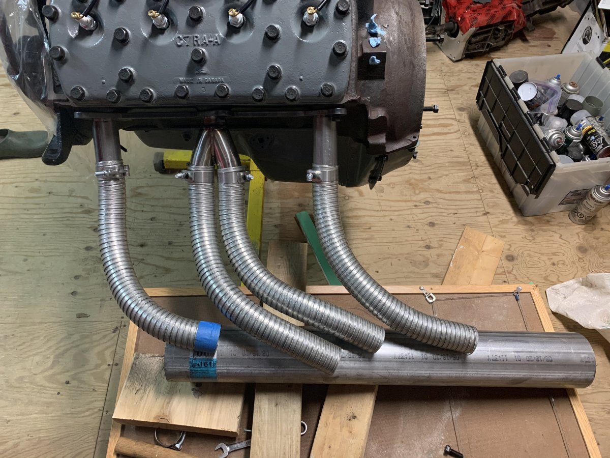

  30. Ziggster
    Joined: Aug 27, 2018
    Posts: 2,947

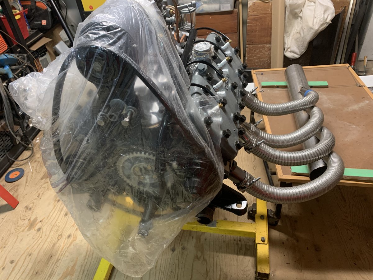

    Ziggster

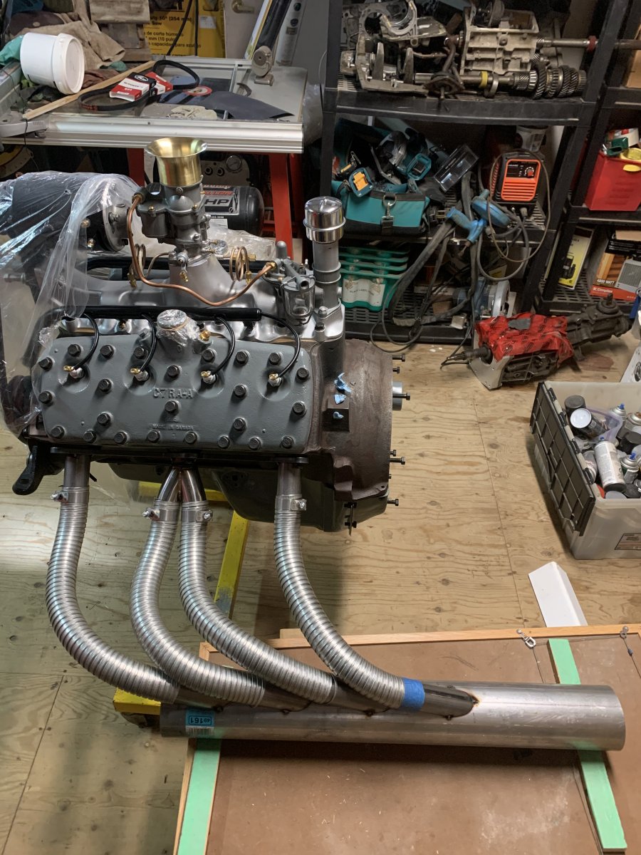

    Got things tacked up this morning, but will need further adjustment. All flex pipe is cut same length, but number 3 barely reaches the connector to the collector. Centre to centre distance between numbers 1 & 4 are the same as port distances, but again the flex pipe is a little short. Will move number 3 & 4 connectors a little further forward to see what happens. I’m sure there will be many iterations. Lol!
