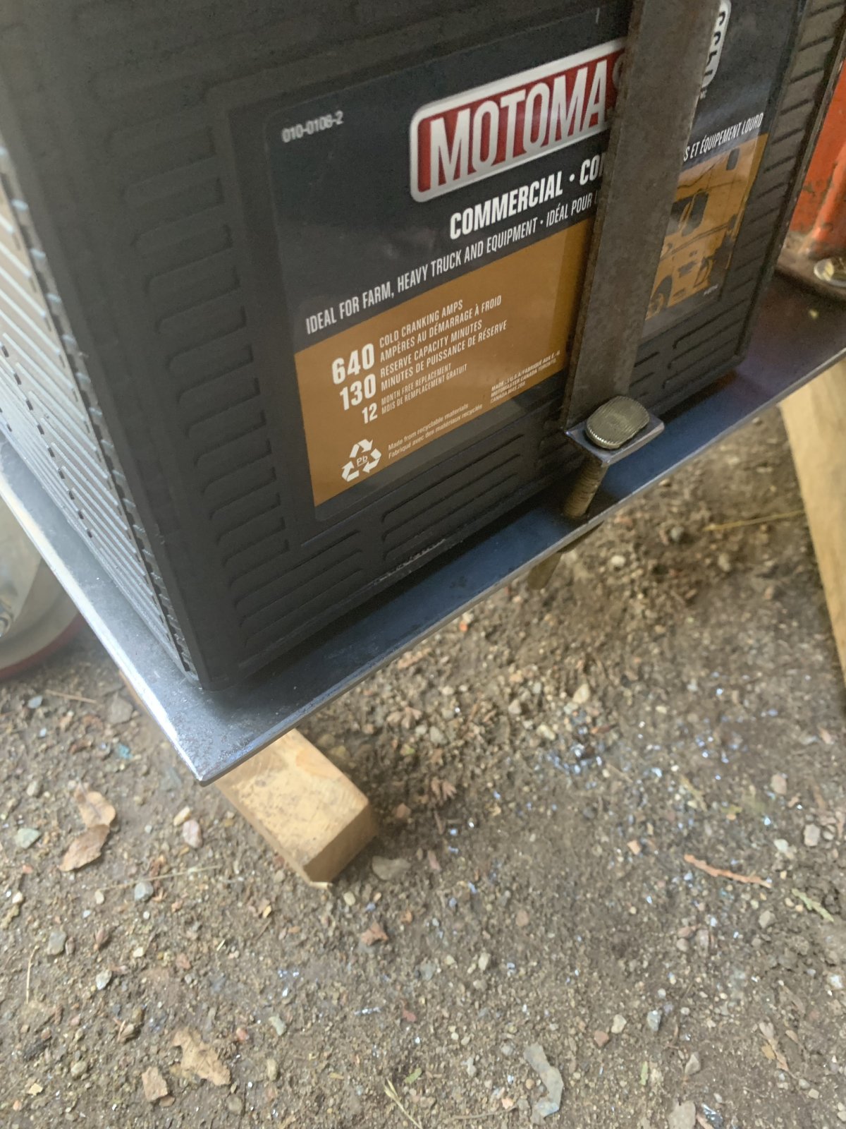

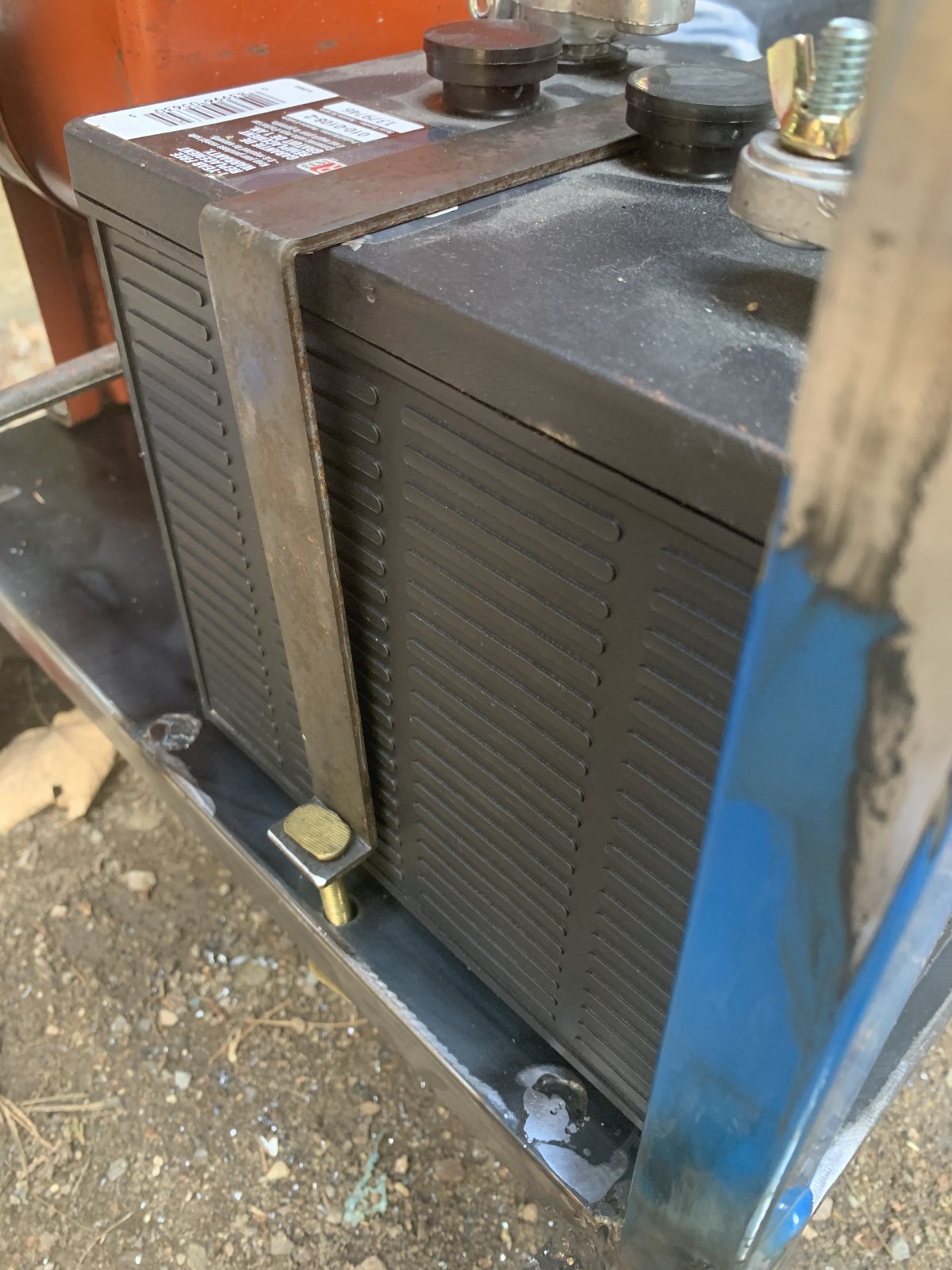

    Battery strap done. I knew those those toilet hold down bolts would come in handy one day. Lol!

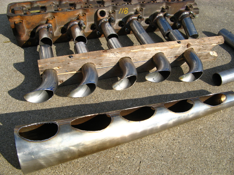

    Started on the exhaust. Tried to make the small transition piece (first two pics) by making a paper template while still in place, but it didn’t work out. Fiddled a bit more, and still no luck. Had to cut the two pieces off the main collector and now hopefully I can get it correct. Tic tok..

    Haha! I swapped out the commode in the girls bathroom downstairs a few months ago, and the hardware that came with it didn’t fit the flange so I just reused the originals.
    Finally, I managed to cut the transition pieces so that they fit reasonably well. Even using “exact” paper templates of the pieces I cut last year, they still needed some m***aging. For the life of me, I can’t remember how I managed to cut the first two. I don’t recall going through the nightmare I just endured. Maybe I used my metal saw instead of my grinder and the tube coping software I used for the smaller tubes into the collector.

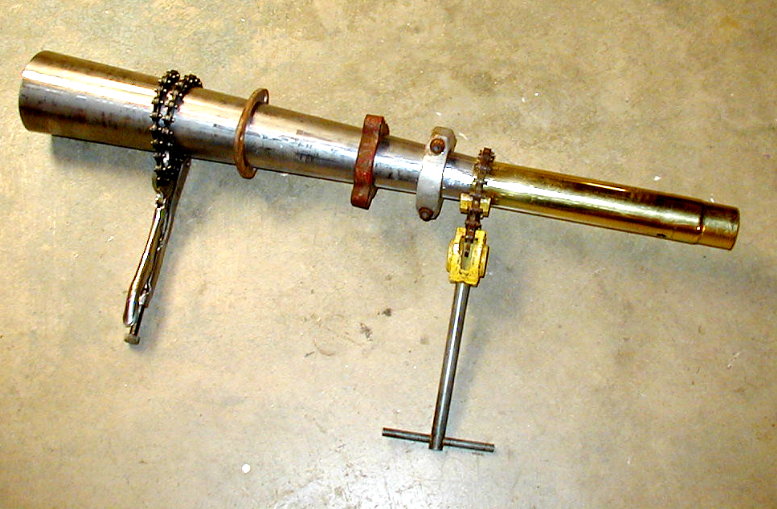

    If you want the header pipe tapered try clamping it around a tapered table leg.

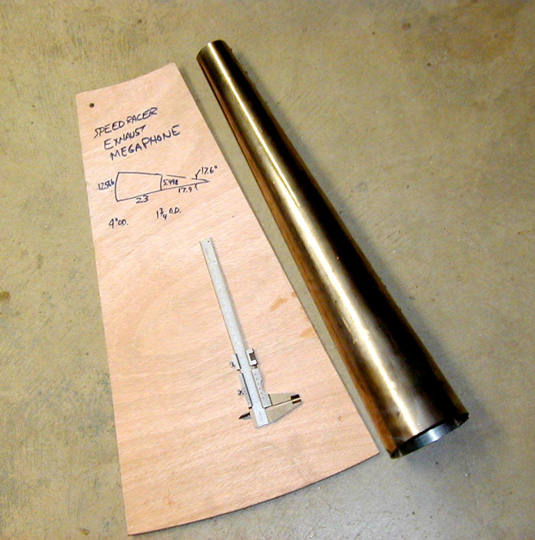

    I need to make a cone for the front of the collector. I don’t have a slip roller so I was looking into ways of doing it. I found this vid from Ron Covell where he did something very similar.

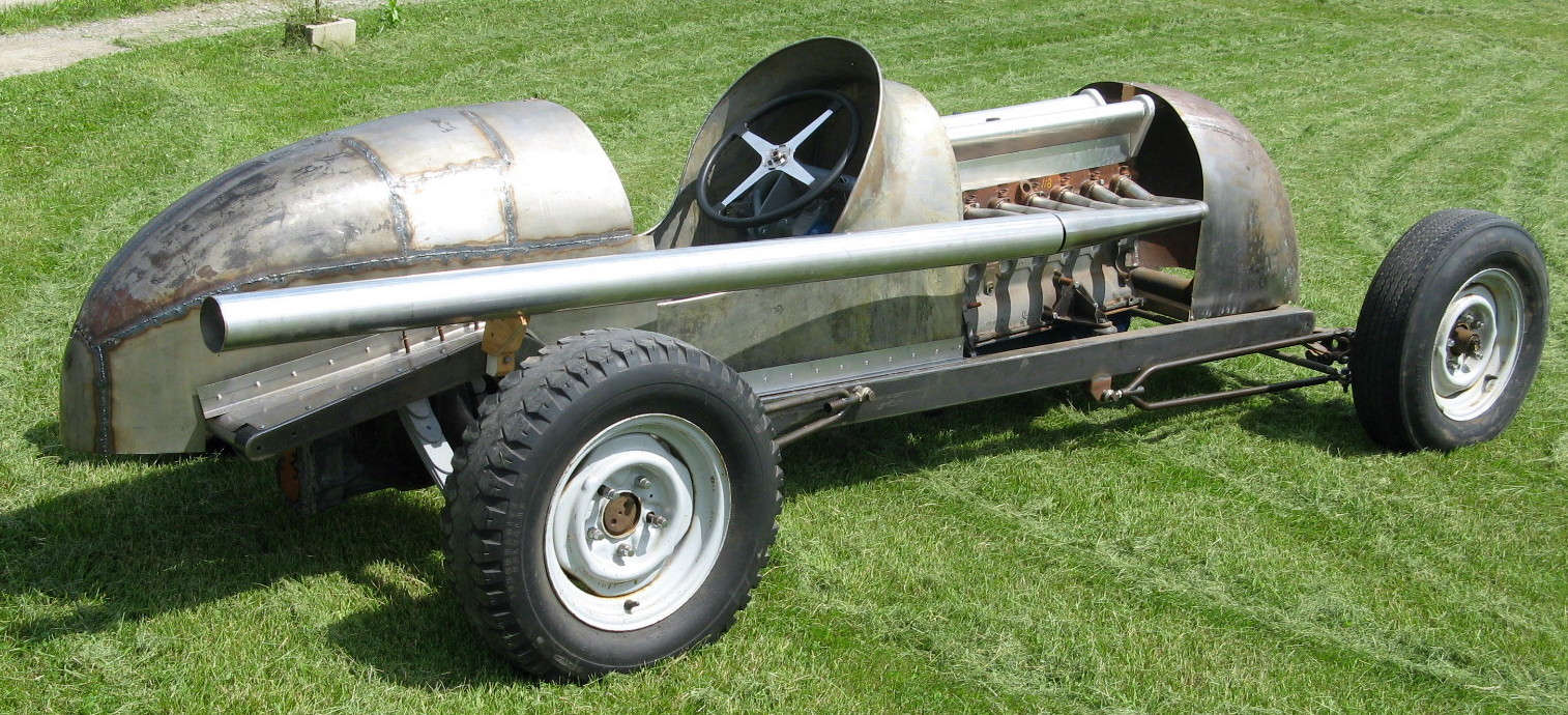

    Looks like there were at least three iterations on the exhaust pipes
    Likely started with just straight pipes.
    Then a rear exit collector.
    And finally the current setup in Petro Shekhter’s 3D model. I believe the current exhaust setup is a really important component of the overall character of the vehicle. I feel it is very important to replicate as closely as possible.
