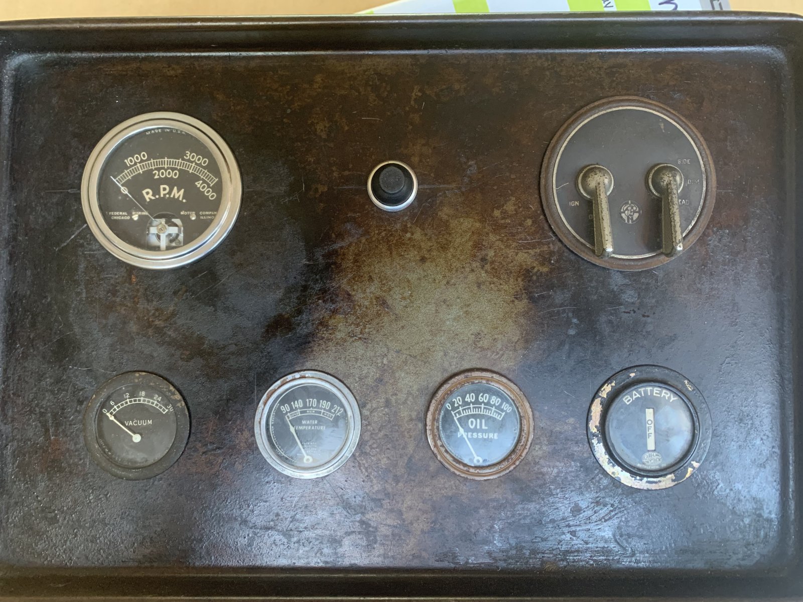

  4. 41 GMC K-18
    Joined: Jun 27, 2019
    Posts: 4,921
    41 GMC K-18
    That is a cool, rare BOSCH ignition switch, it has the vintage logo of the racers face on it.
