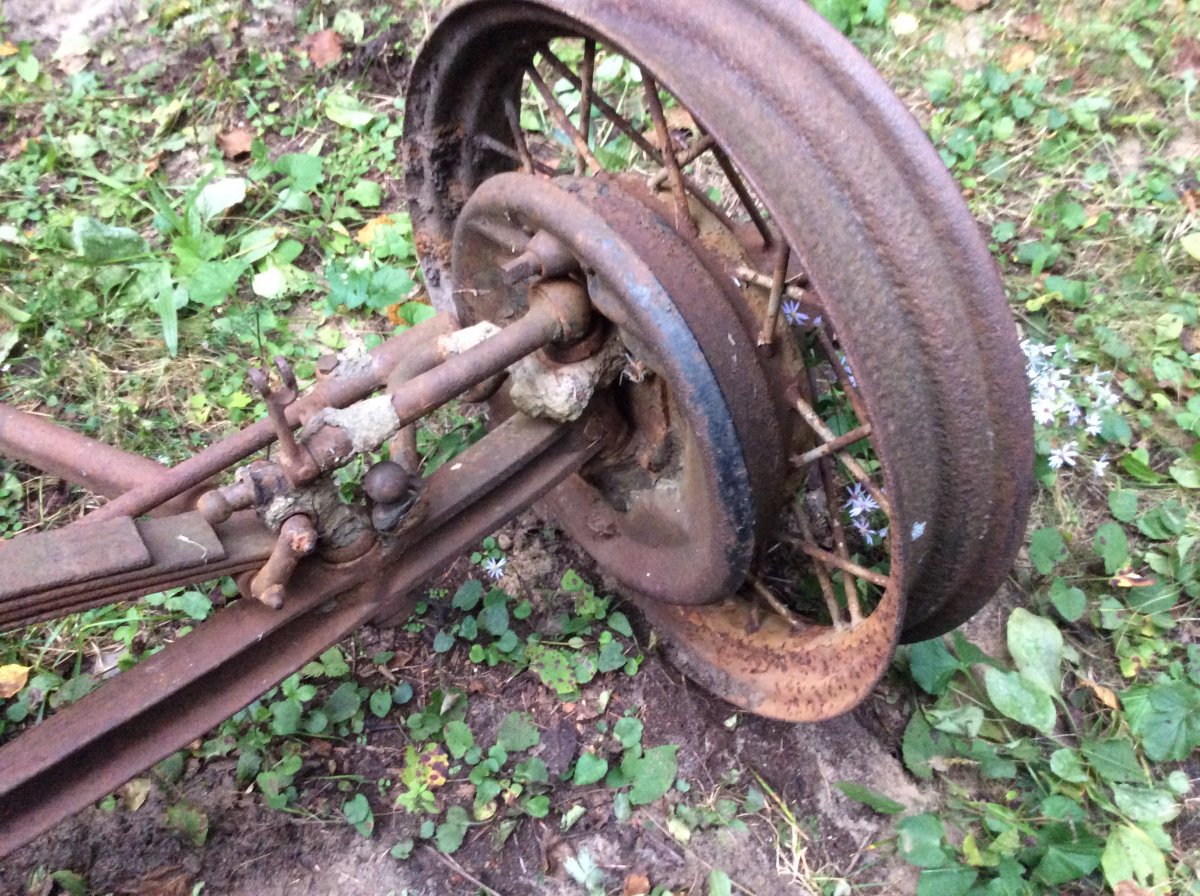

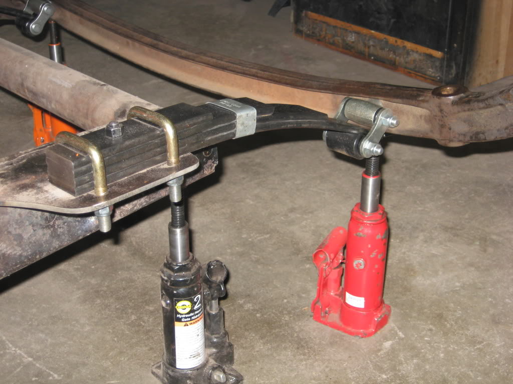

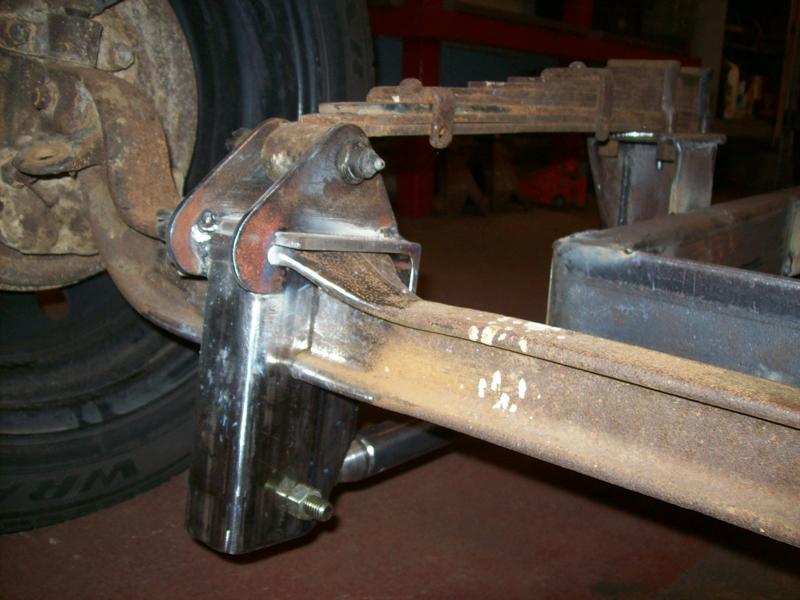

    Agree on it being more difficult. All depends what will be permitted. I don't think welding brackets to the rear axle would be a problem, but because the front is a forging, they may not like that, but need to confirm. I may have to keep the original mounting if I decide to keep the mechanical brakes, as it seems the spring mounting, wishbone mounting, and mechanical brake lever are all combined, plus it is outside my intended frame width. Simplest is just to drill a hole and install a tee type fitting from Posies or other. Some rather interesting designs out there, and this is what I like as there is just not one solution.
    My original setup.
    Simple solution.
    Tougher solution.

    Seems like inducing change would be minimal considering the length of the arms and any unequal bump movement of the front wheels would try and twist the front axle. You can make it as complicated as you want, but remember you are building a replica of a 1920s vehicle. "It ain't rocket surgery".

    The "simple solution" works well. You will find though after drilling your 3/4" holes through the web of the axle that there isn't much meat there. I contoured bushing and welded the to better support the T fitting. This is the system I used on my avatar car

    The" simple soloution" works well... I used it on my T in the avatar

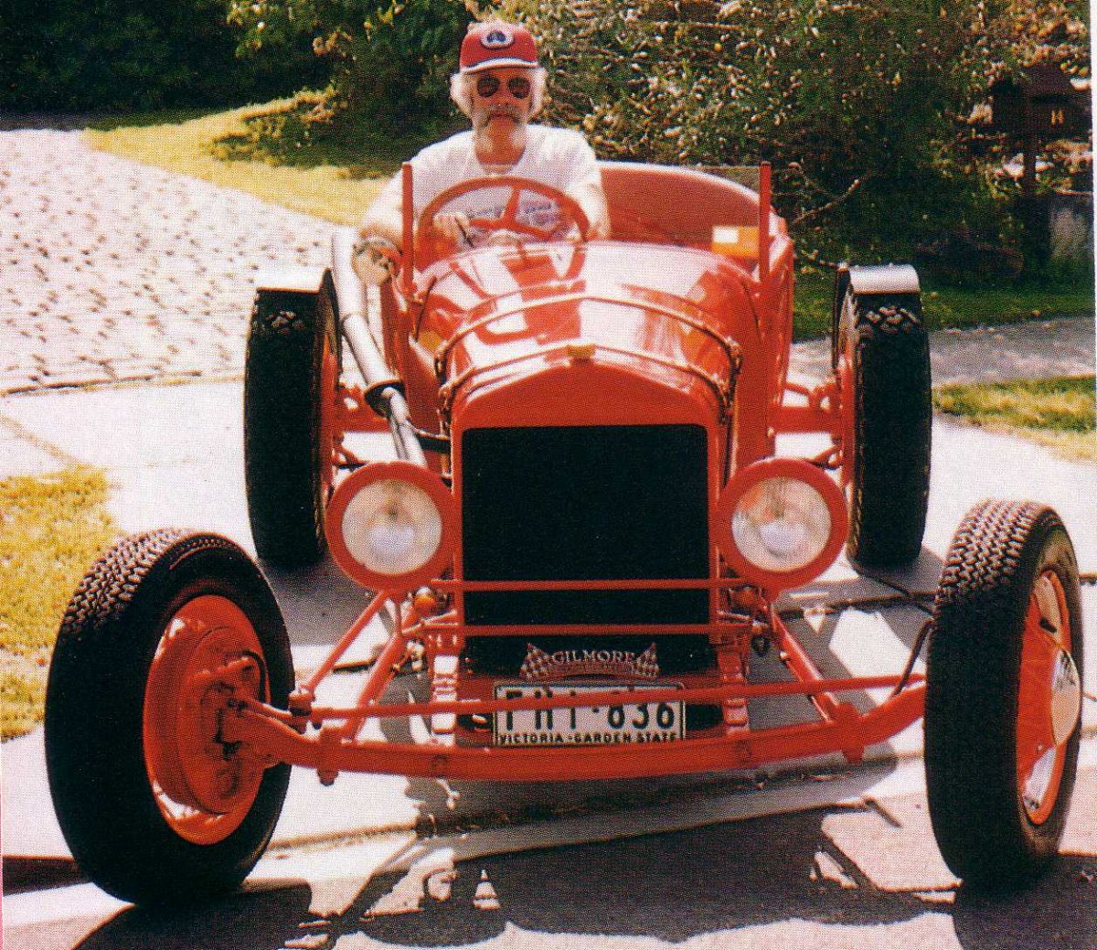

    Buggy spring on front axle worked well on this car..I made my own lever friction shocks 4 Banger c.jpg

    Very nice. Do you mind if I ask how wide the body is at it's widest point? I plan on making the friction shocks as well.

    Hi Ziggster..I can't remember.I built this car 0ver 30 years ago..I can tell you that I narrowed the cowl by removing the flapper in the centre...I think it was 11 inches.. I used standard doors and the rear section and tub are hand made..it has a full length belly pan I hand formed....I just built it from a lot of junk from around behind the shed...I havent got many photos as this was pre digital time for me putting together.JPG Measuring up.jpg

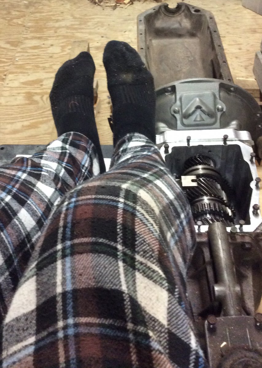

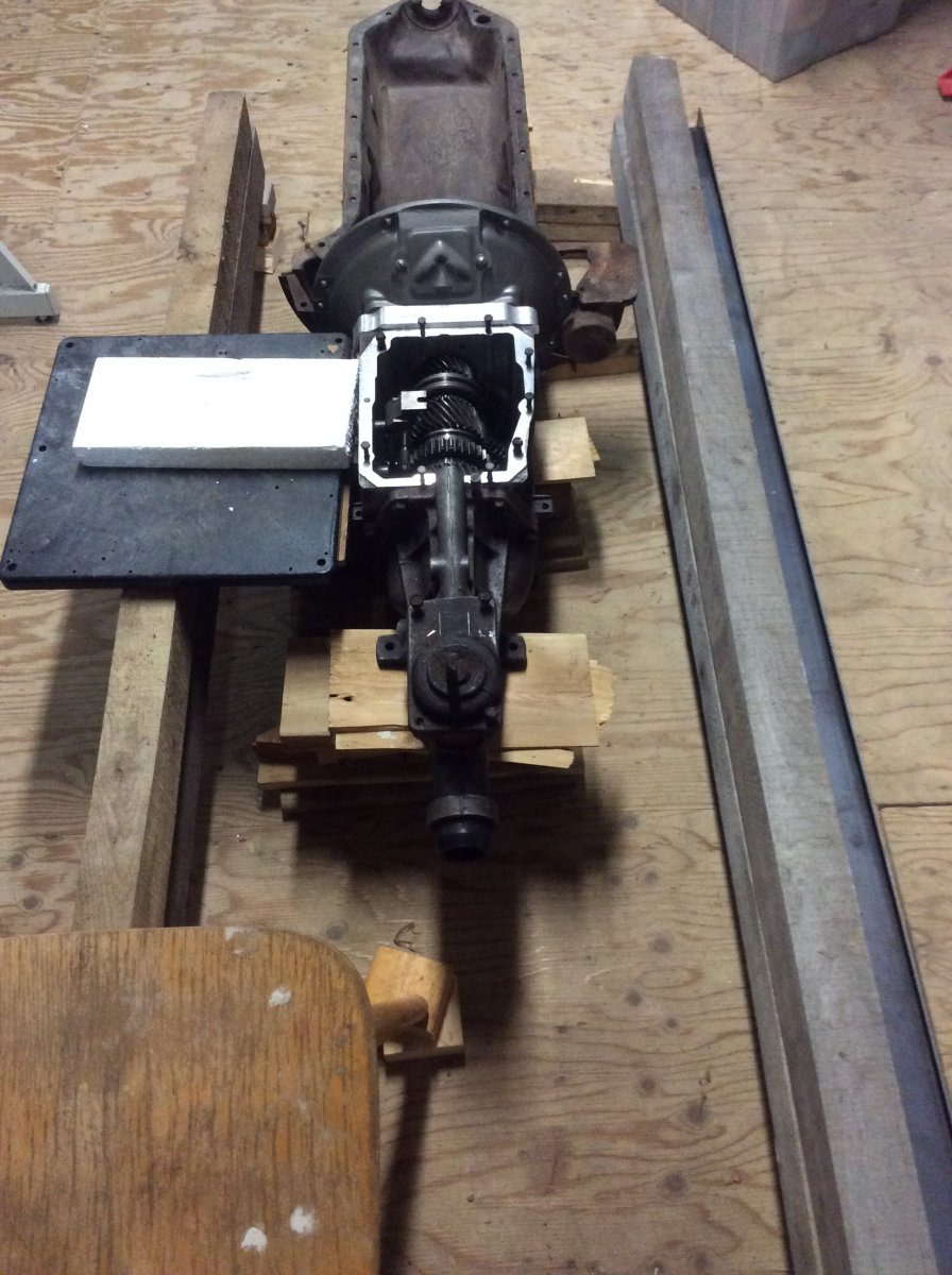

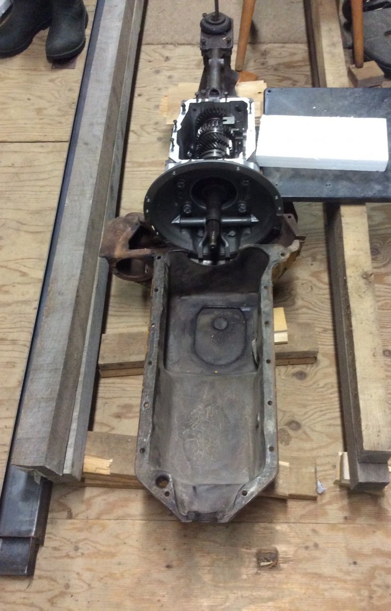

    Other duties have kept me away more than I wished. Looks like steering might be a slight issue as I had to move the centreline inboard to avoid having it protruding outside the body. Also, foot room is going to be really tight as the T5 is about 9" wide at its widest point leaving me with only approximately 8" width for pedals. I'm probably going to have to widen the body a bit at the cowl. Makes me wonder how they managed this on the GN JAP as I believe the frame/ body is even narrower with the frame measuring 24" outside width from best I can determine. I know he didn't have to deal with a traditional trans in the traditional location, but there still is the driveshaft tunnel. If I keep my seat 10" off the floor, the trans tunnel will be approximately 7" above the floor. The rectangle just left of center is main body of T5 with adapter, hogs head, and engine bell hsg in front. Even if I widen the body, at most I have is 9". Not good when my feet are 5" wide.
    His set-up below. On some pics you can actually see that he took a hammer to the driveshaft tunnel to give him just that little extra room for his left foot on the clutch. I somehow have to get the accelerator pedal moved over the hogs head adapter. Perhaps by raising the floor a bit and lowering the engine I can achieve the room I need. Damn...
    Outback, motoklas and Okie Pete like this.

  19. Ziggster
    Joined: Aug 27, 2018
    Posts: 2,359
    Ziggster

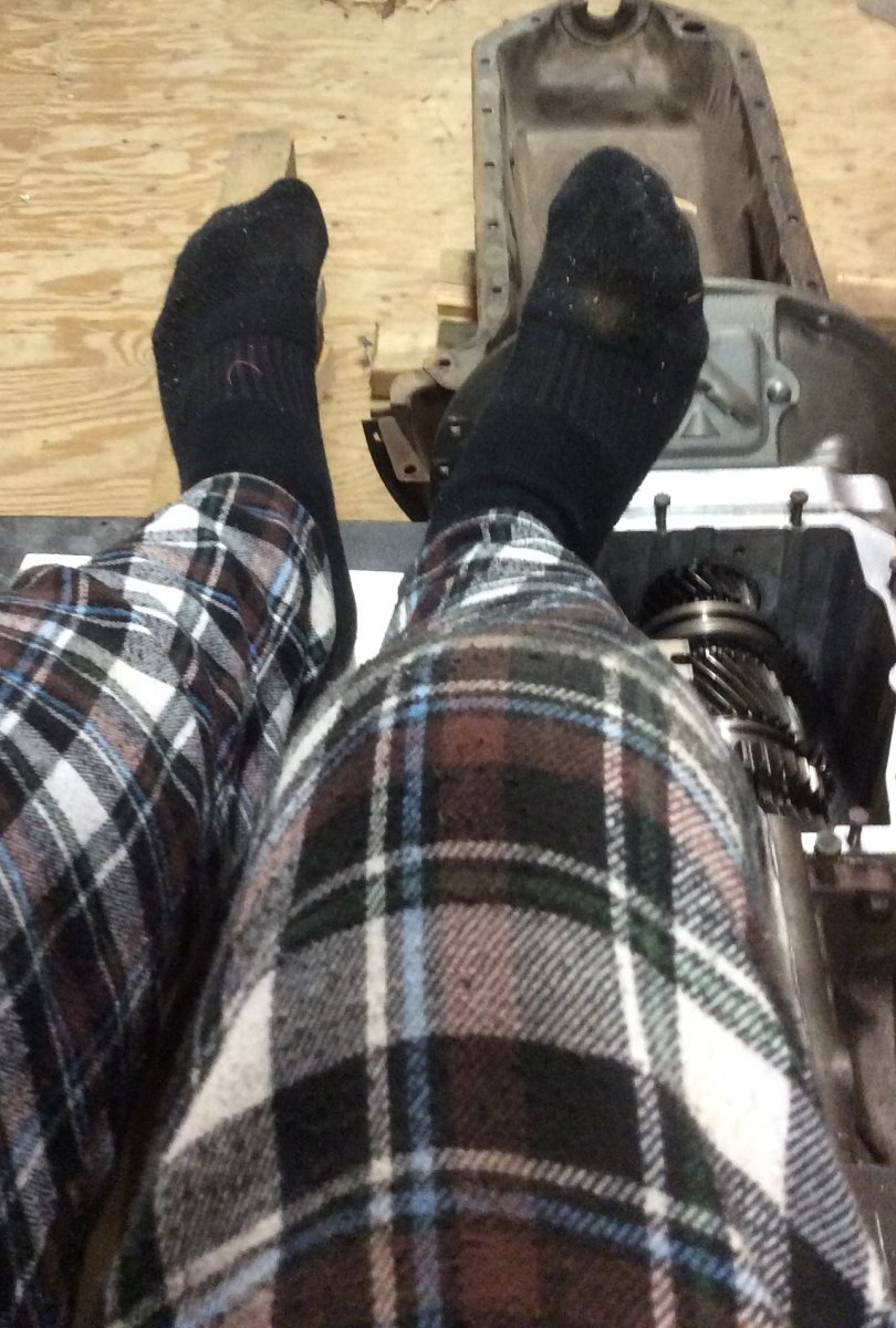

    This may take some creative out of the box thinking, but surely others have encountered something similar. Appears he switched the clutch and brake pedals around at some point. It would seem the pedal with notch was to allow room for the left foot on the clutch, but who knows. His daughter also drives/races the car.
    Relief in driveshaft tunnel. Also pedals are switched from pic in my previous post.
    You gotta love the accelerator pedal, and what appears to be tool boxes used to raise up the floor.
    I'm going to crudely mock something up today just to get a better idea of what I'm dealing with.

    Seems like raising the floor to be flush with the trans is the way to go. Seated position is almost as per my layout, but some adjustment will be required. When seated you can tell right away what works and doesn't. I still may have to move the seat back an inch or two, but I'll need to do a better and more realistic mockup first. My under floor pedal idea will have to be changed though. Don't mind my pyjamas...

    Moved the seat back about as far as I could and still have room to clear the driveshaft and diff. Also extended the cockpit by about 4" and moved the engine 1.5" forward. The wheelbase is now 106". This gives me the legroom I need, but now the proportions are way off. I'm going to have to play with the body lines to see if I can make the cockpit look a bit shorter compared to the rest of the body. Damn. This is not easy.
