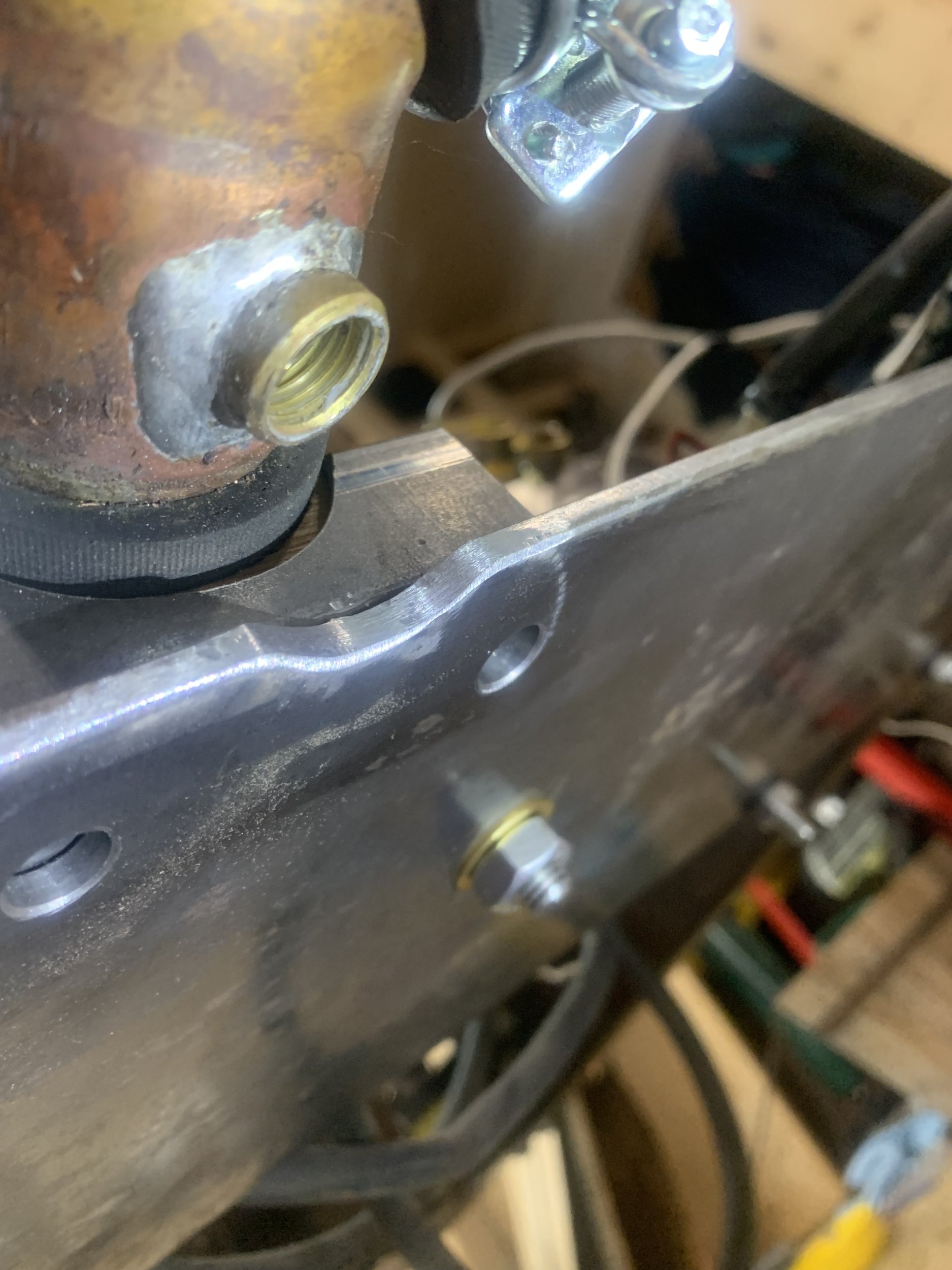

    Used the die grinder to cut a relief in the battery crossmember for the drain petcock. You gotta love lying on your back with hot steel flying in your face on a Sunday morning. lol!

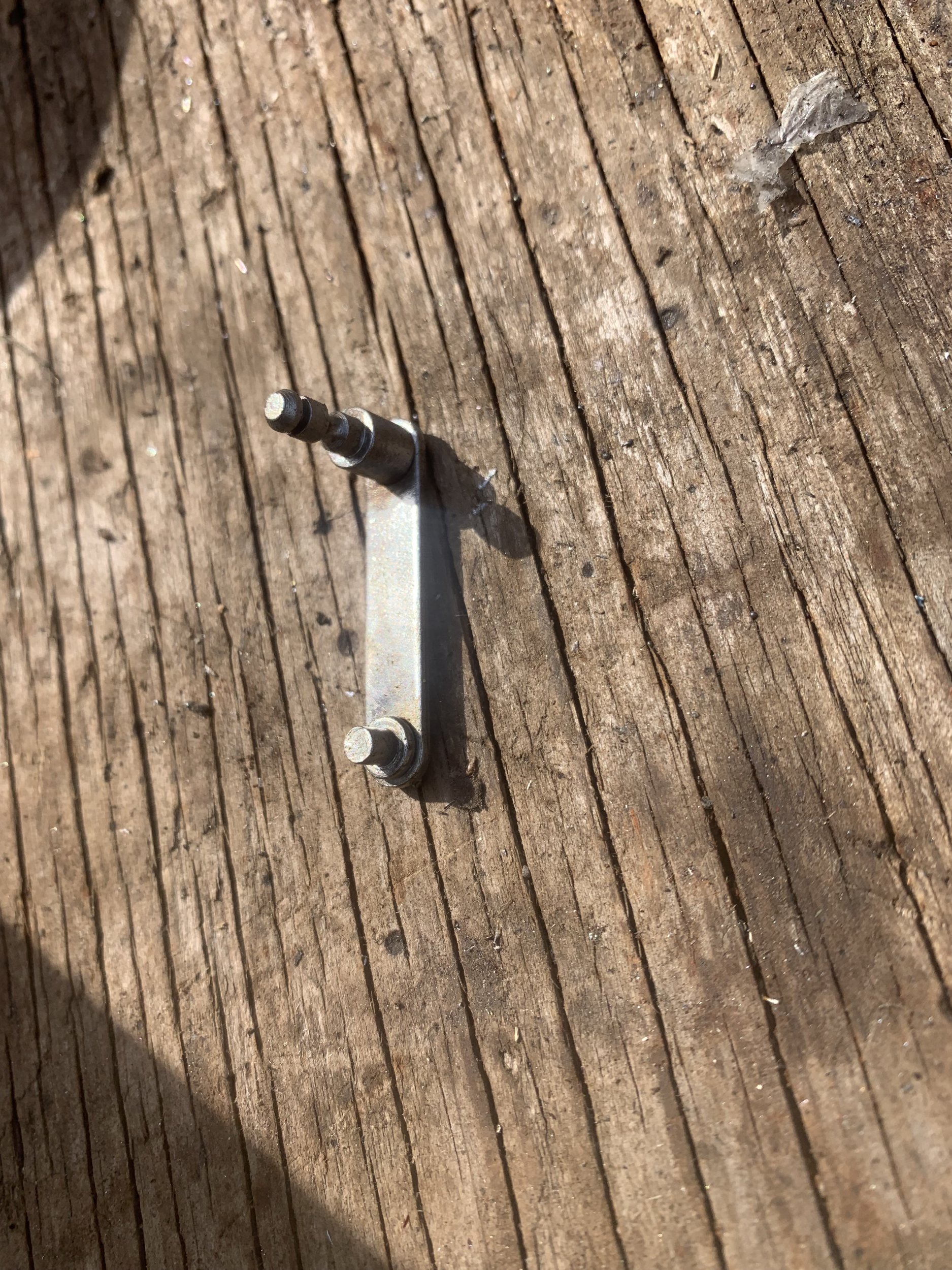

    So after going through almost every page of my build thread, I realized that I’m missing a link from the throttle plate linkage to the accelerator pump. The two I had from the original carbs were NS. I swear I ordered a new one from Vintage Speed, but it seems somehow I forgot. I also need the spacer that goes under the fuel filter bowl. Just have an old nut in there now.

    Found the two NS links, but can’t find the carb or fuel pump. I’m sure I put them somewhere “safe”. Story of my life.

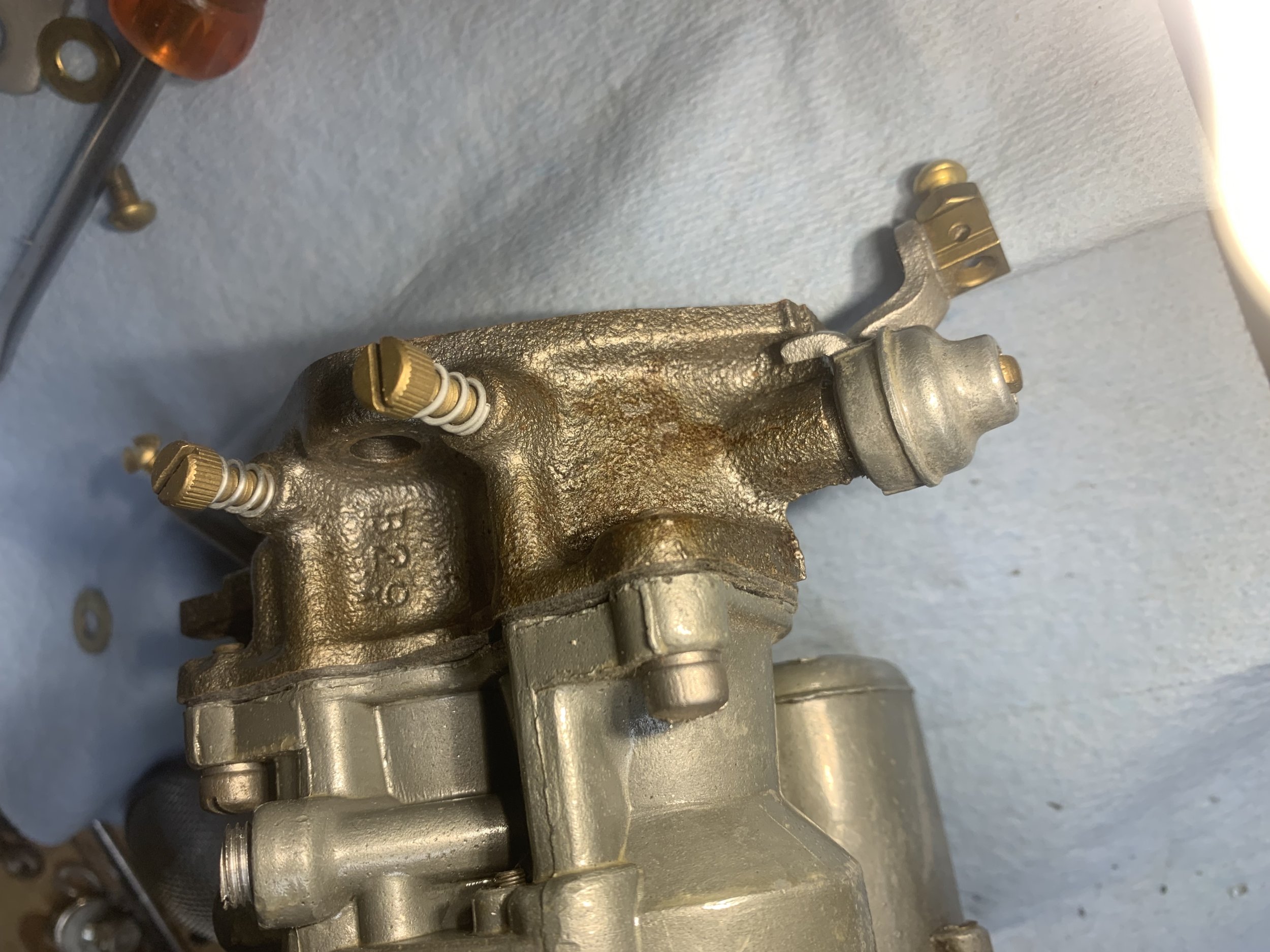

    Carb came apart way too easily. I think with a thorough cleaning and new gaskets it would be good to go.
    Finally managed to get the link off. After removing the “circlip”, I thought it would just fall out. It was stuck pretty good. Was wondering if the tip was threaded on as it looked a bit larger in dia. Managed to get it off with this forked screwdriver.

    That threaded nut under the fuel bowl looked nasty. Thought it would require some heat to loosen, but after letting it soak with some PB Blaster came loose with some vice grips. The problem is that the nut and cup/spacer are held captive. Think I’ll cut the threaded stud and remove the cup. The wire clip is pretty corroded. Not worth saving this piece as a whole.

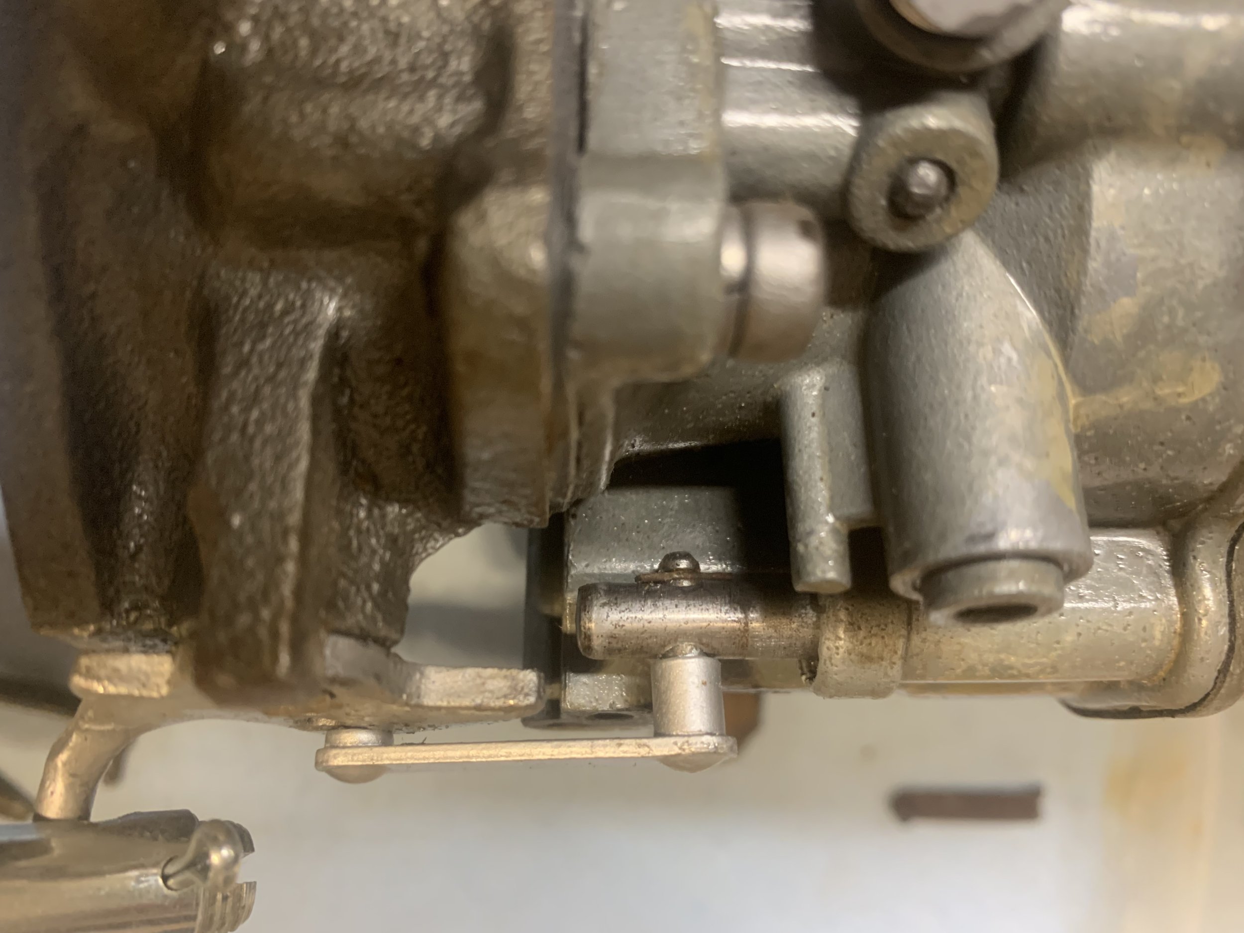

    There was what looked like some kind of pin passing into the thru hole in the accelerator pump rod. Managed to push the pin on the link through the hole in the accelerator pump rod despite that other “pin” protruding into the hole. Was also a pain to install that tiny circlip.
    Okie Pete likes this.

    Surprised at the amount of corrosion. Was all bead blasted, painted and clear coated, except for mating surfaces, and the interior bits.
