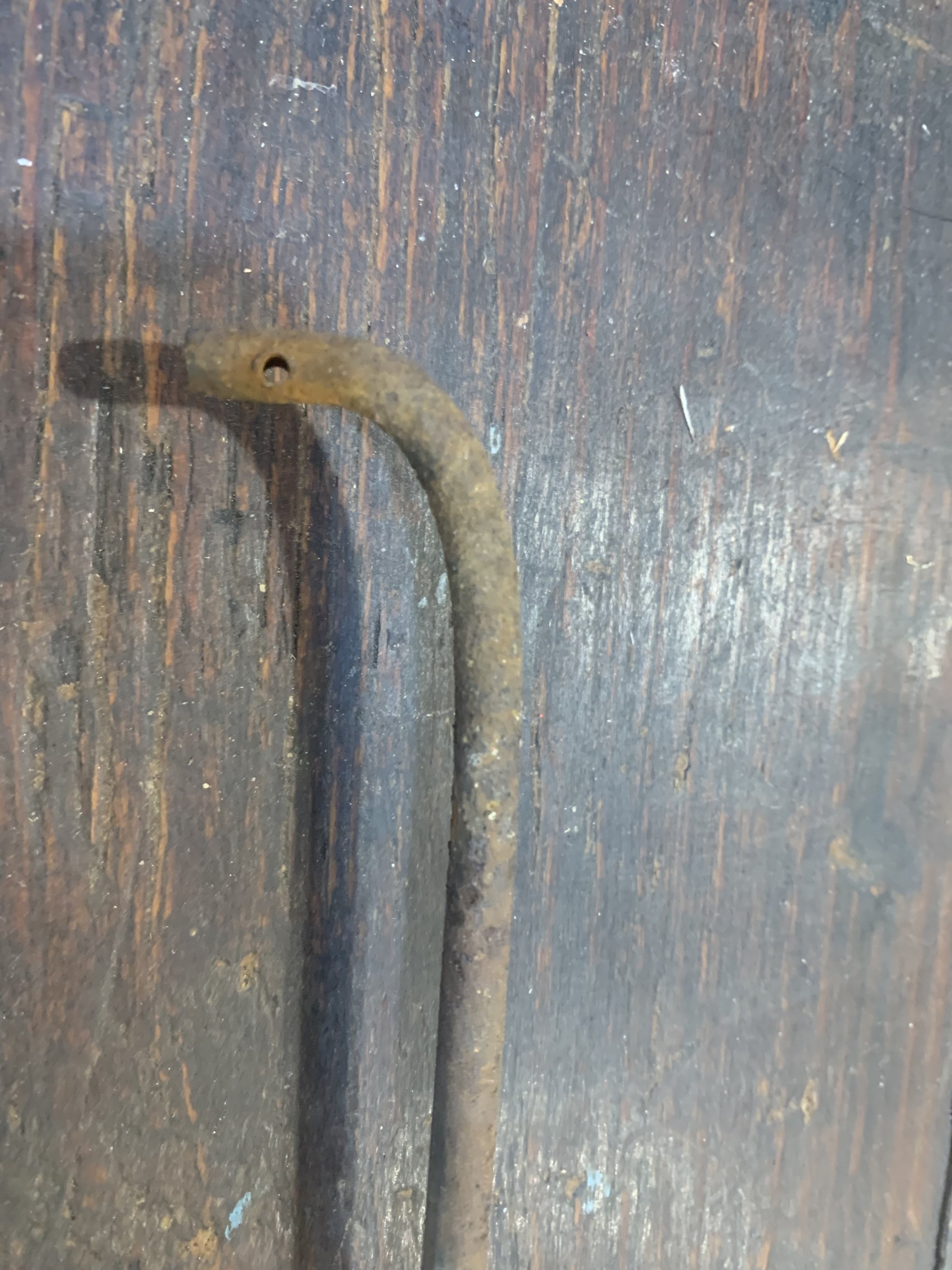

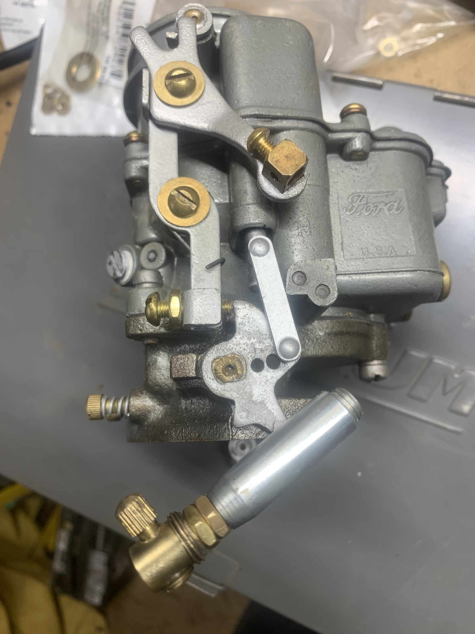

    Found the old throttle linkage from the flathead I got last year. Has a similar “bullet” nose connector but is seized of course. Just a hole in the other end of the rod for the cable, so will mimic the same somehow.

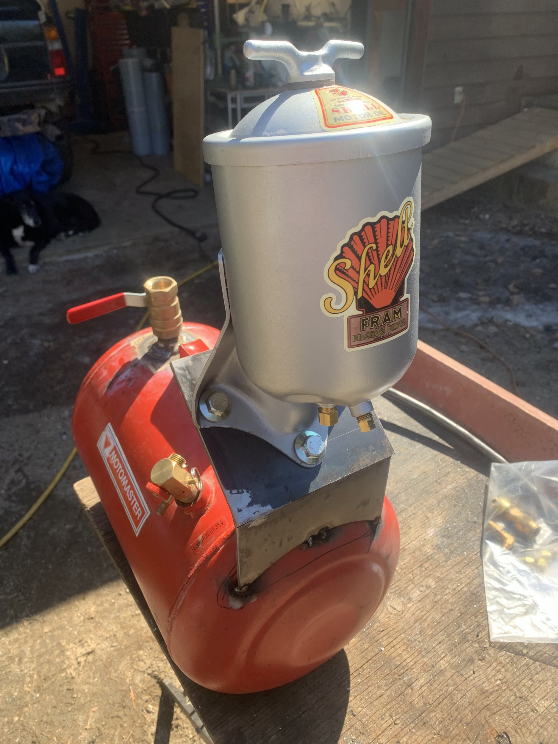

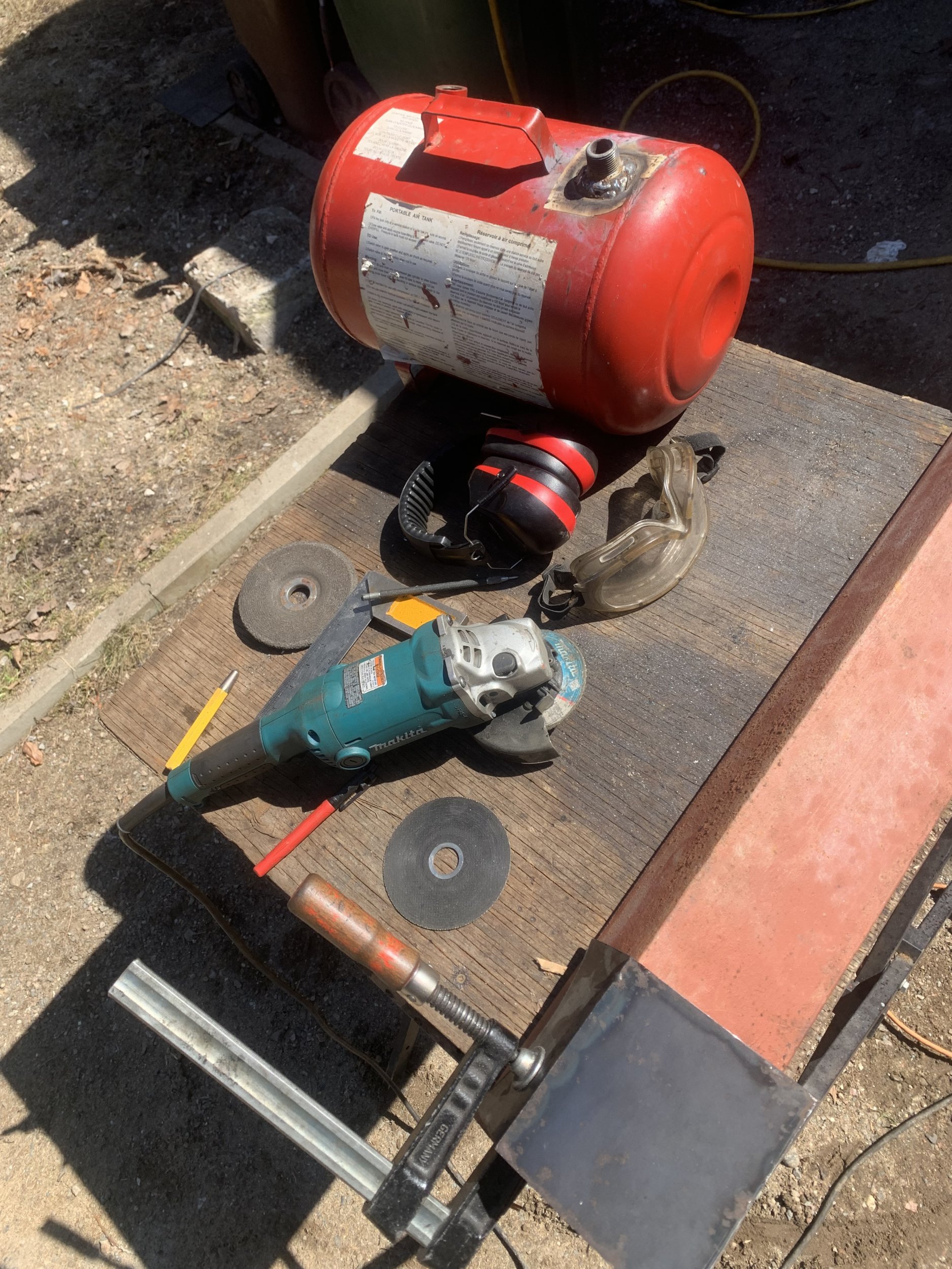

    Still working on the pre-oiler. Need some fittings still to attach the pressured gauge. Will fab up a brkt to mount the remote oil filter hsg.

    Work continues on the pre-oiler tank. Fabbing up the brkt for the remote filter hsg. Was able to salvage it from the other failed project thingy. Also picked up a ten-speed? bike my neighbour threw out the other day. Who knows what I could use. Was wondering if I could mod the pedals for pedals on the speedster. lol!

    Brkt tacked into position. Will need to add some feet/extensions so the elbow and 1/4” copper line coming out of the bottom of the tank will clear.

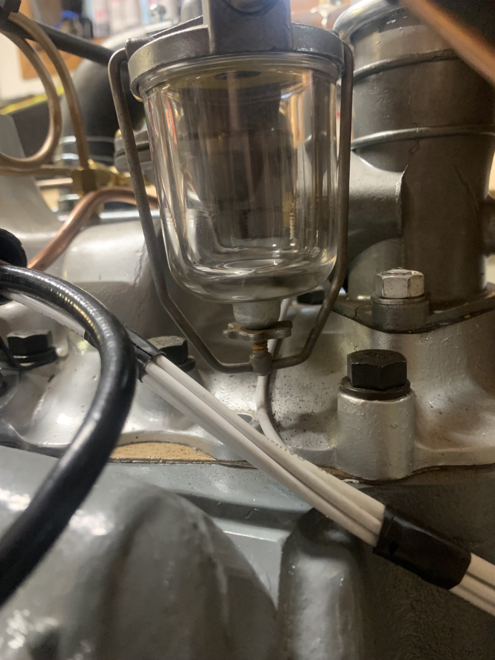

    Got a new battery the other day. Same as the oil one. Was CAN$170! I think I pair around $100 for the other one. Sales guy said it just arrived the day before and blamed the tariffs. Got the scavenged fuel bowl spacer installed.

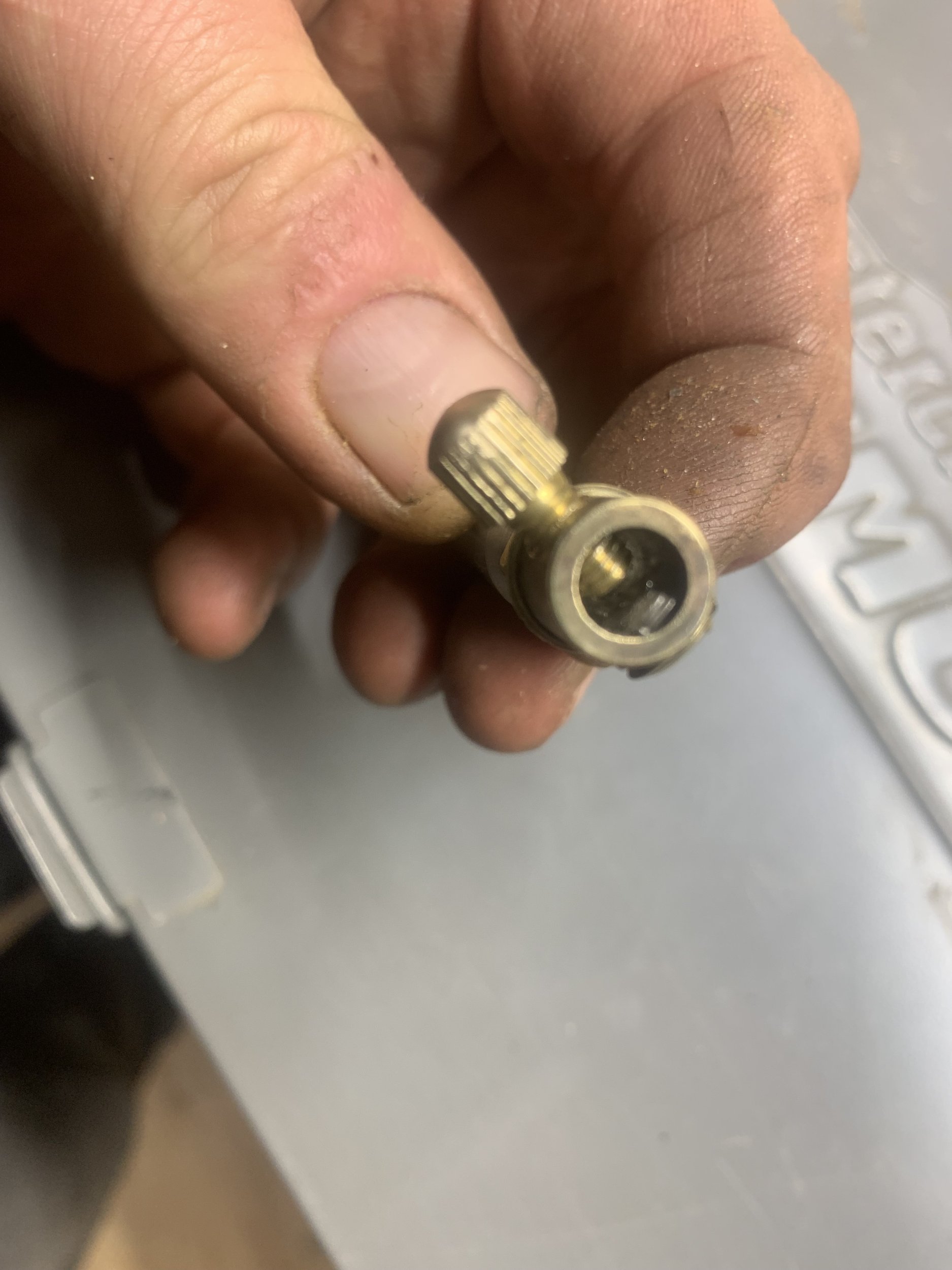

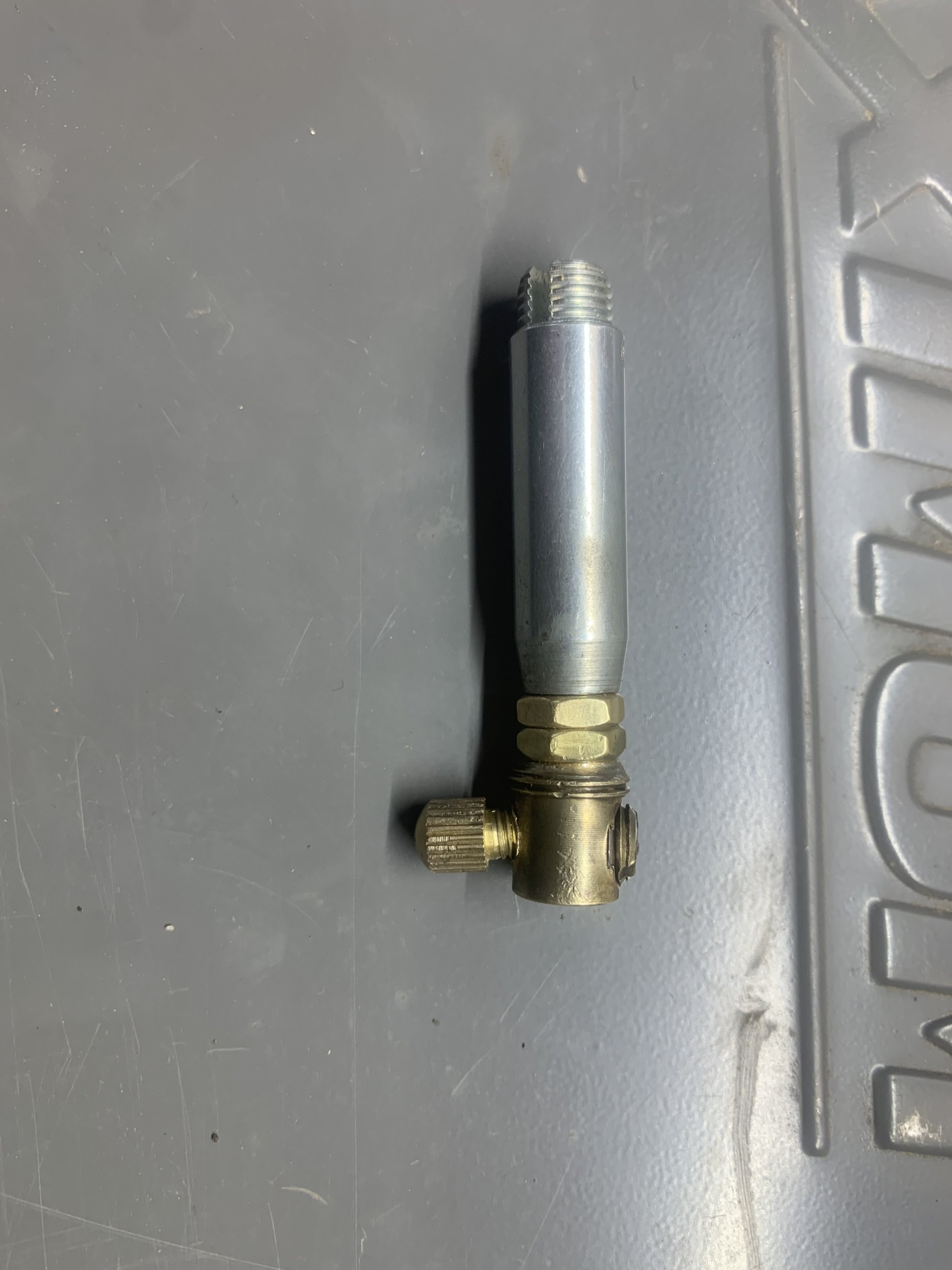

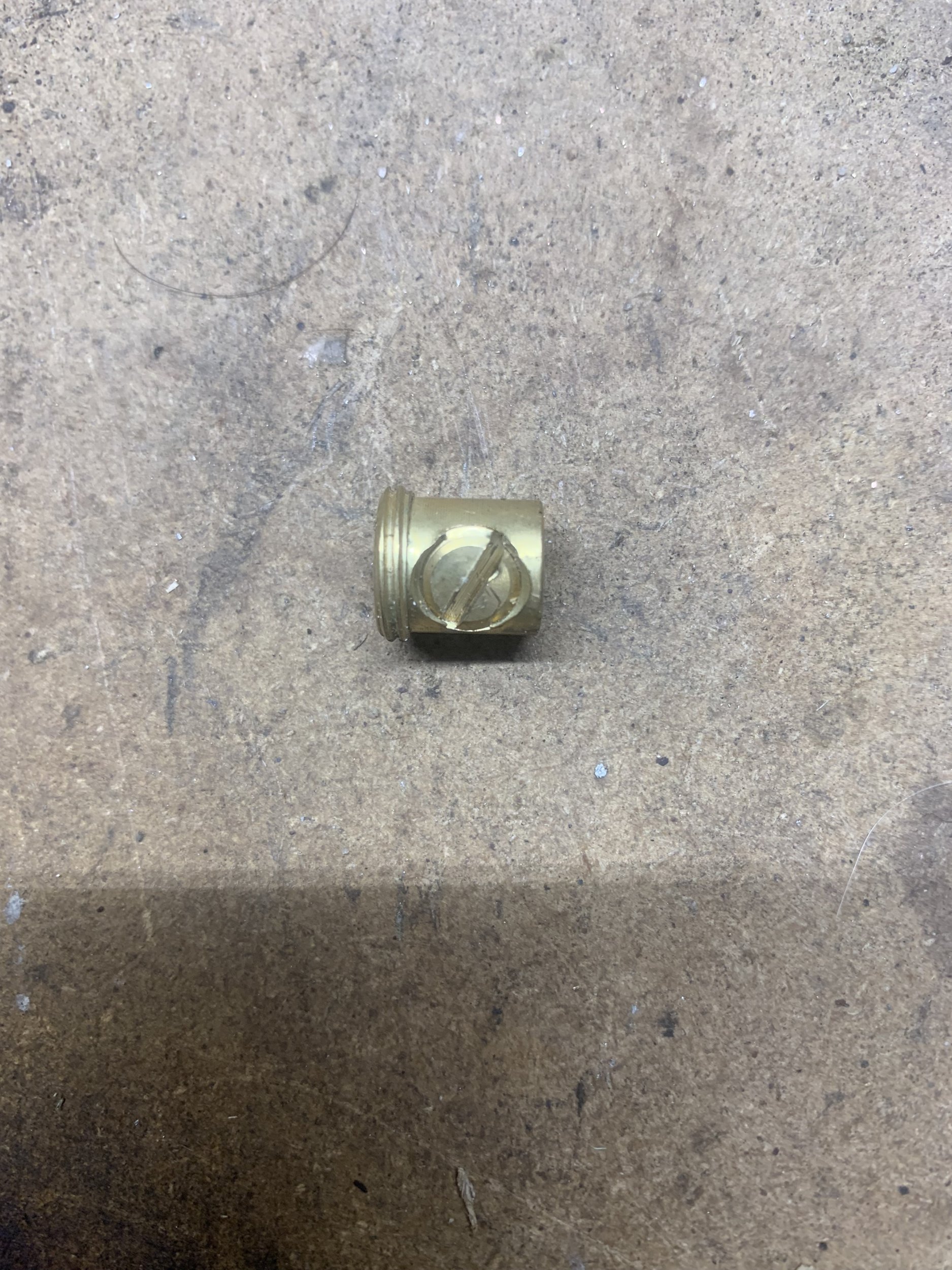

    Decided instead to work on modding up something to adapt from the bullet connector to the wire on the throttle cable. Took me way longer than I care to admit, and not as nice as I would have liked it to be, but should serve the purpose for now. Made from what i believe is the innards of a residential bayonet connector and some random brass thumbscrew, and a 10-32 brass screw and nuts.

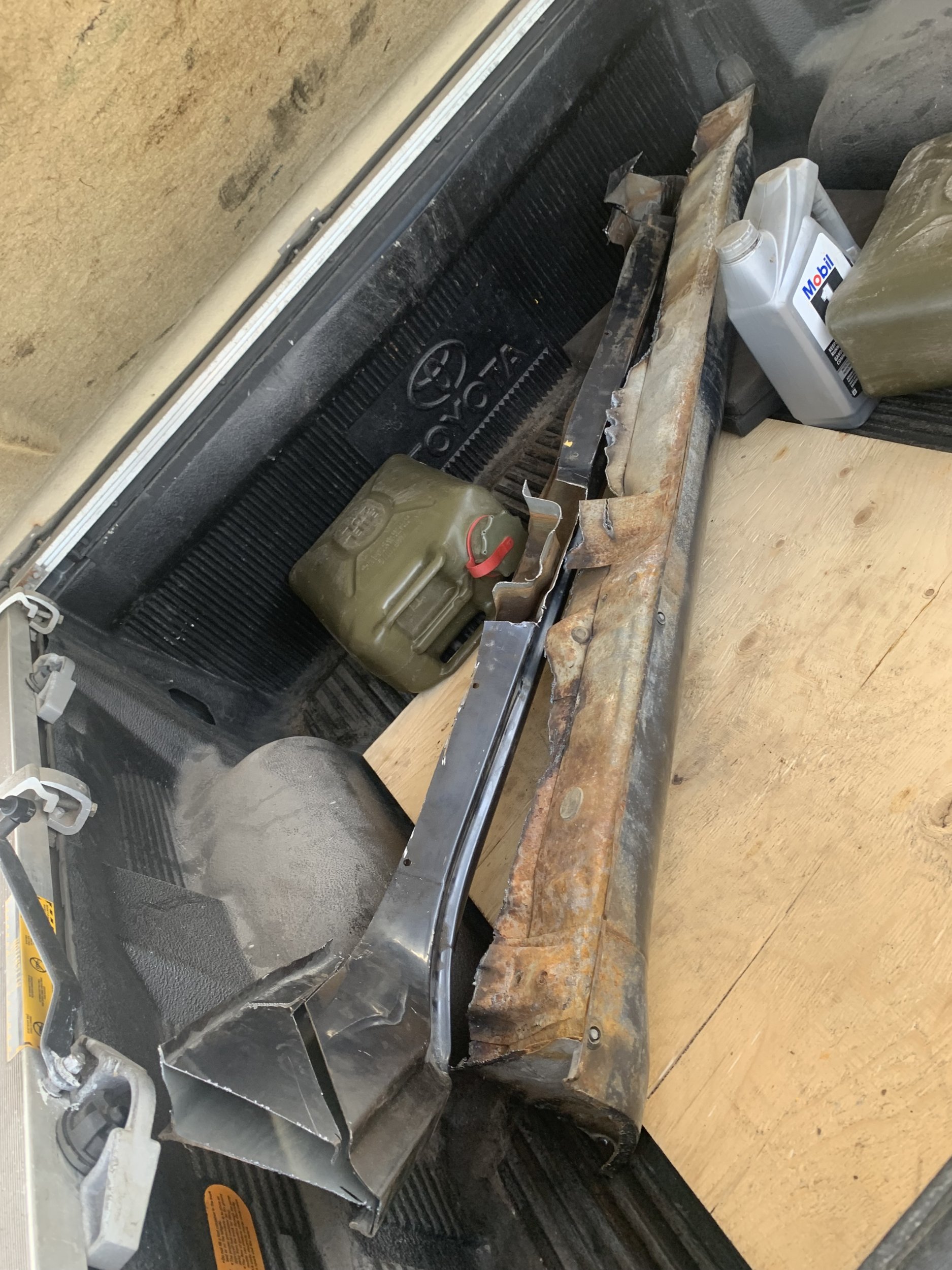

    Also, ran out of time harvesting the body parts from the donor vehicle. Seller was super nice, and even cut out one of the rockers for me with his plasma. Says he’ll cut out the rest of the stuff and ship it to me. IMG_6841.jpeg

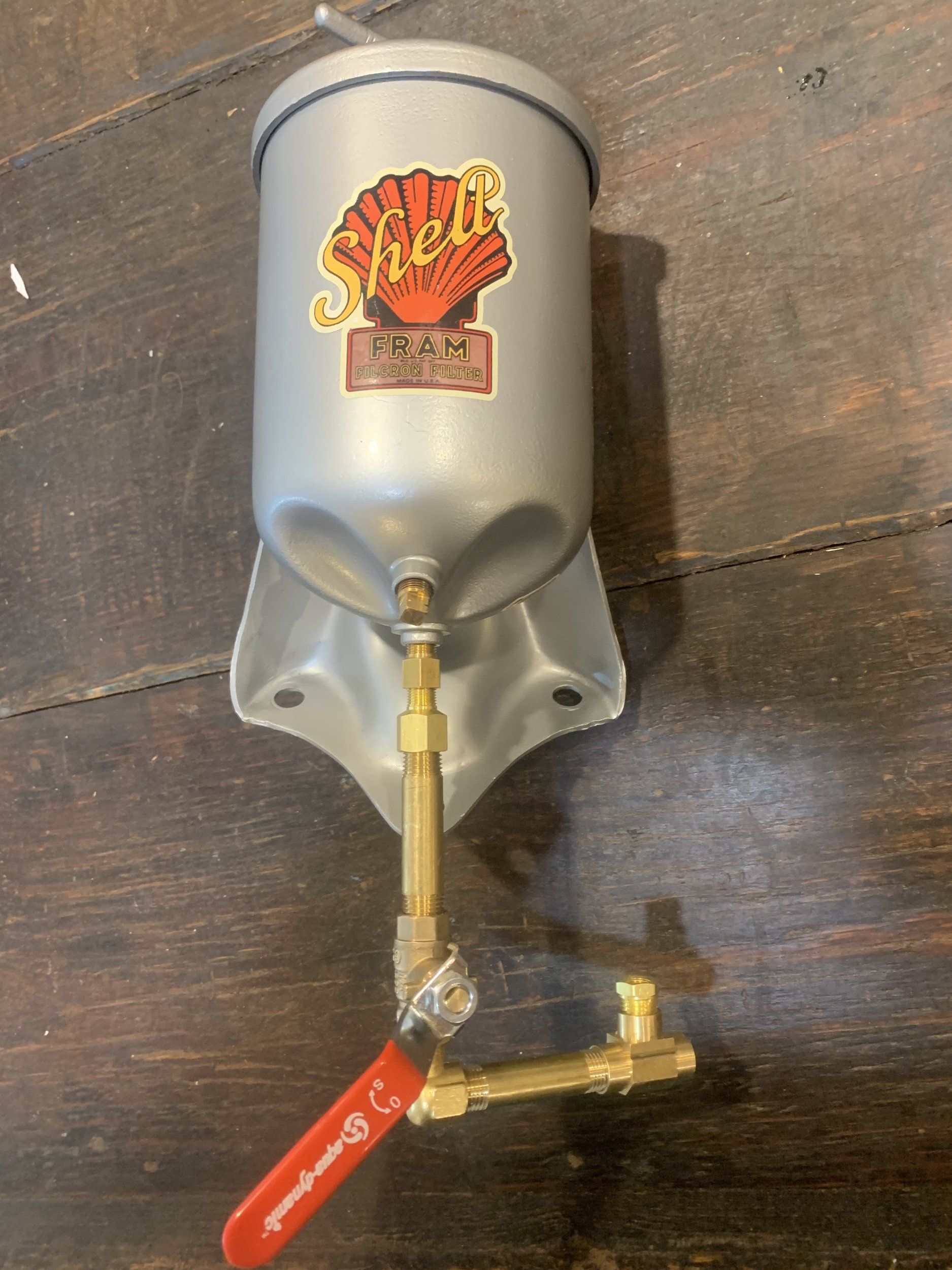

    Been pondering the pre-oiler dilemma, and probably won’t use the hand pump style sprayer. Not comfortable with it being able to push oil all throughout the system. So, will re-examine the pressure tank style one in more detail.
