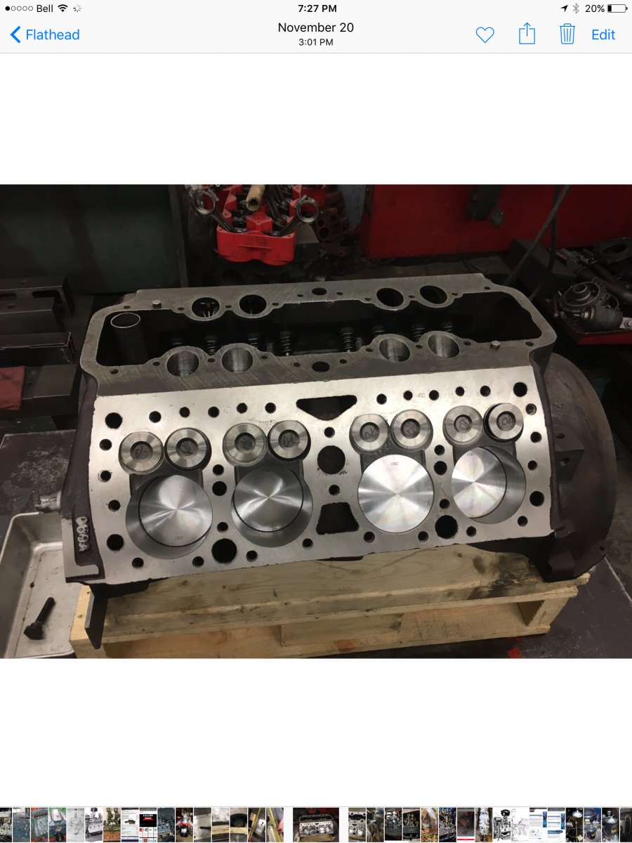

    Just in case some haven't seen my other thread on transporting an engine, the short block is back at home finally in my workshop. The machinist blasted the stock heads and intake as well which is nice as I want to ****on it up a bit temporarily. I've started cleaning out the workshop to make more space, and I also need to build a simple gantry system to move the m***ive chunk of iron about.

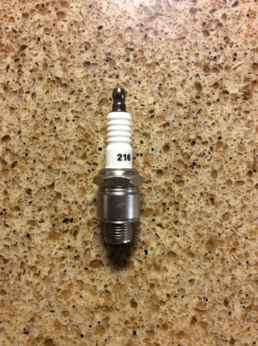

    Picked up some Autolite spark plugs I ordered before Christmas from the local NAPA store. Only reason I ordered these was I had read the base was black. As you can see from the pic, it is not black, but I decided to keep them anyways as NAPA was willing to take them back. While there, I asked if they had any engine paint, and they had a decent selection, so I decided I'd try the New Ford Grey Engine enamel from Dupli-Color (CDE1611).

    You could always try using gun bluing solution on the spark plugs as an alternative. Either that or mask the insulators and paint them black. Hell, you could just use a black sharpie pen and nobody would know.
