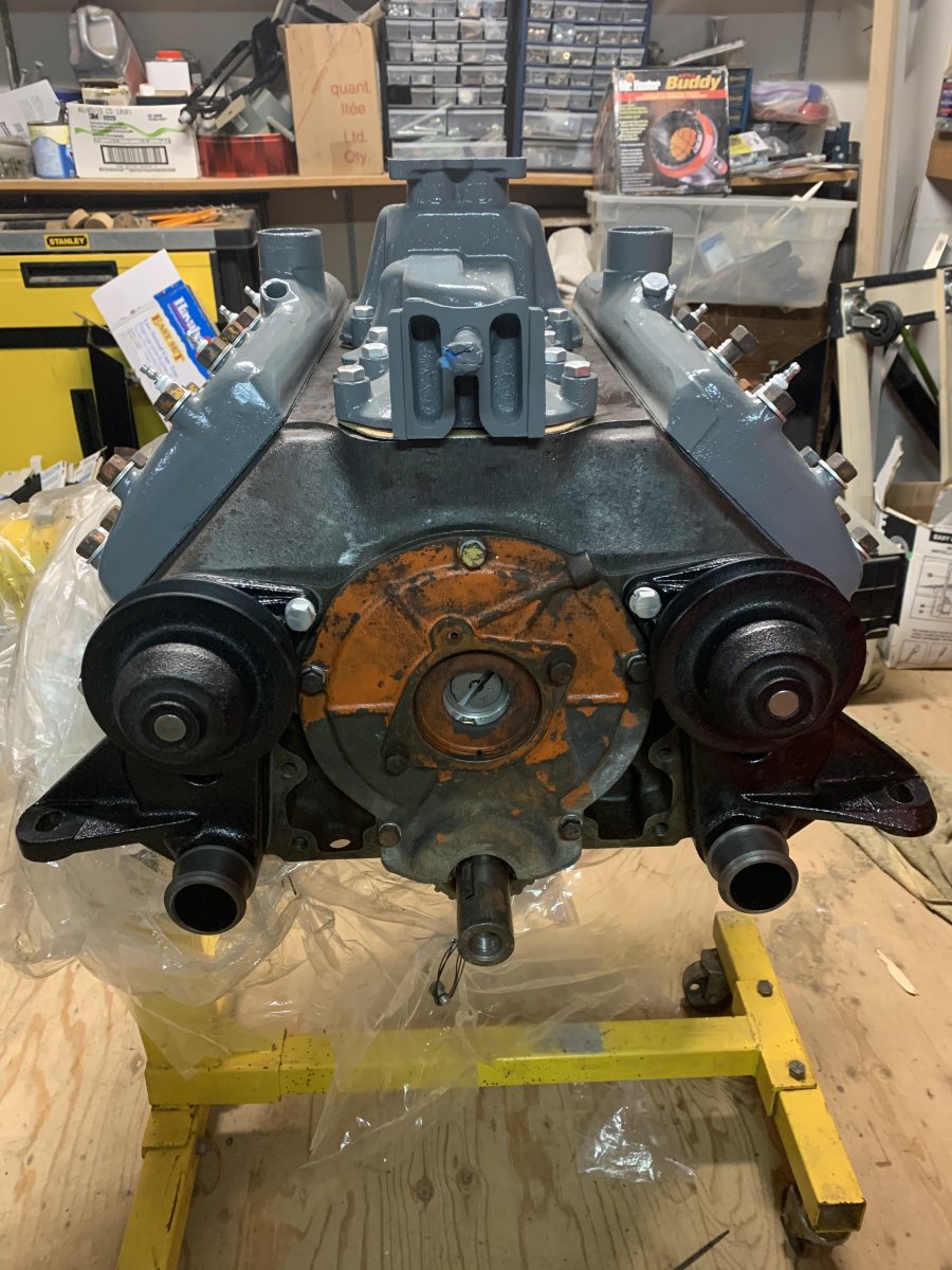

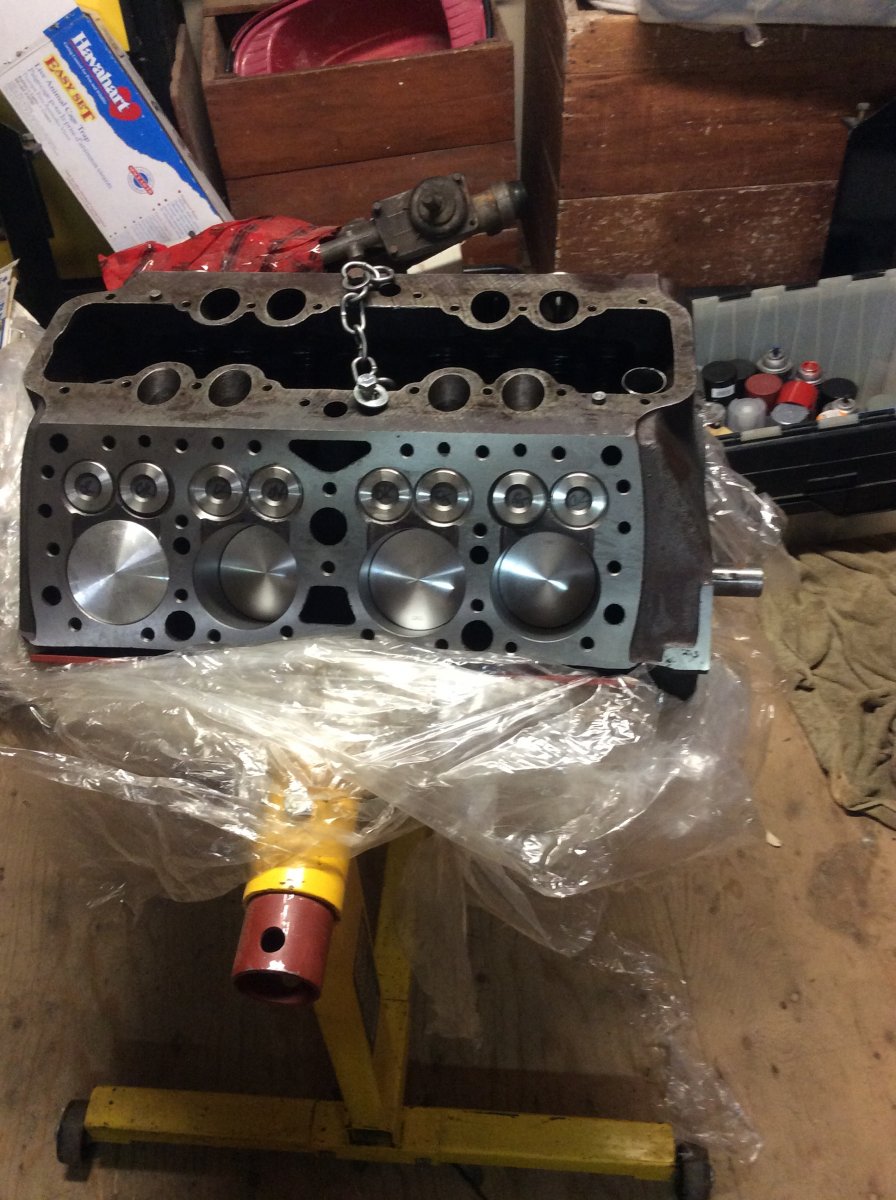

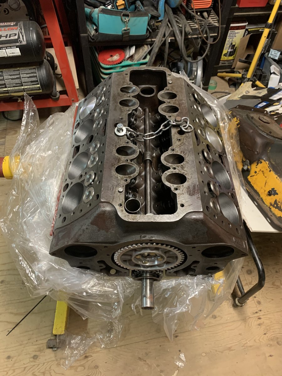

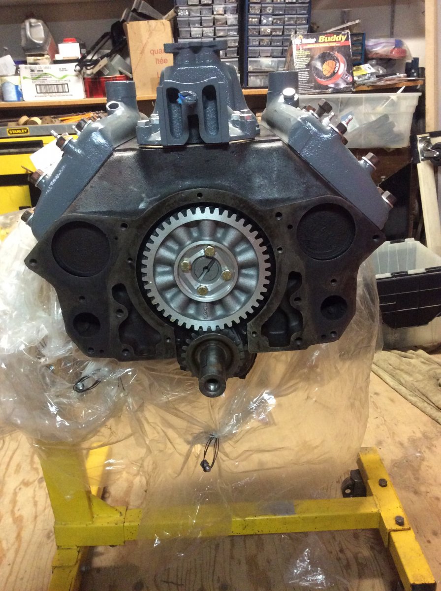

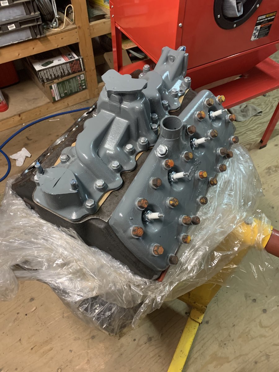

    I was just putting the finishing touches on my sand blast cabinet which I had purchased back in Feb just before my wife p***ed away, and I decided to start “loosely” ***embling some parts on my flathead. So nice to start back at it again. It had been a tough year so far and I need to get back at doing “normal” stuff. I was able to hand tighten all the original head bolts except one. I’ve got to finally decide what to do for attaching the heads.
    Block still looks good after over a year under wrap.
    Heads on. Guessing doesn’t matter which one goes where. Lol!
    Water pumps and orig dizzy installed. Couldn’t find the cover I had purchased fir my helmet dist. Lol!

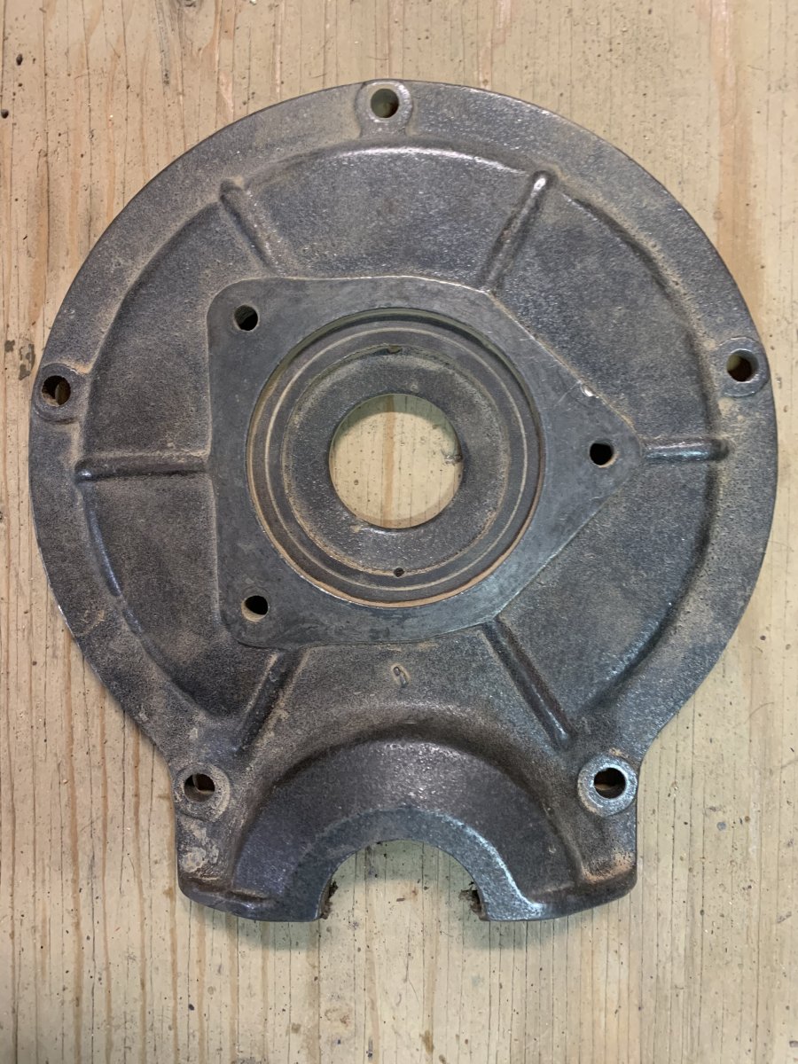

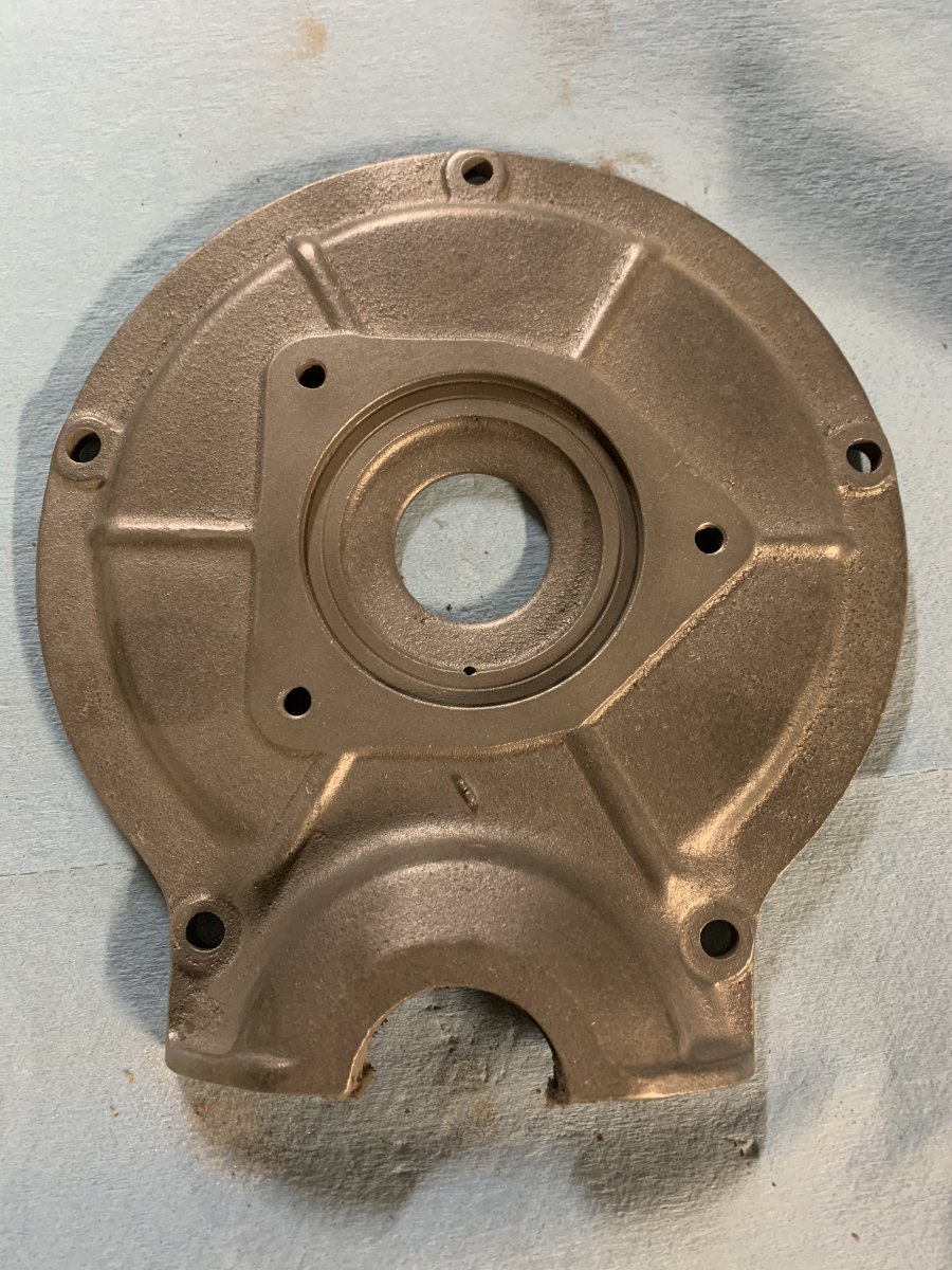

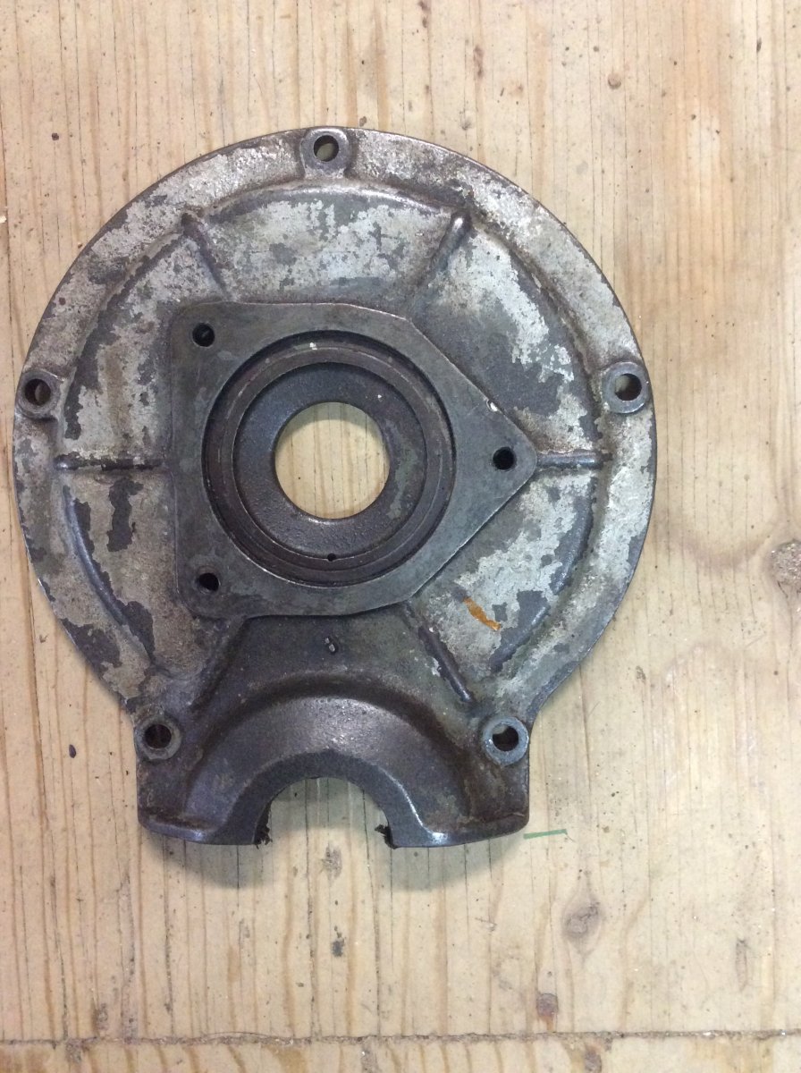

    Cleaned up the timing cover for my helmet dizzy in my blast cabinet. Can’t believe I’ve done without one for so long. It cleaned up in a matter of minutes. Got the dizzy dis***embled and ready for blasting tomorrow.
    Before.
    After.

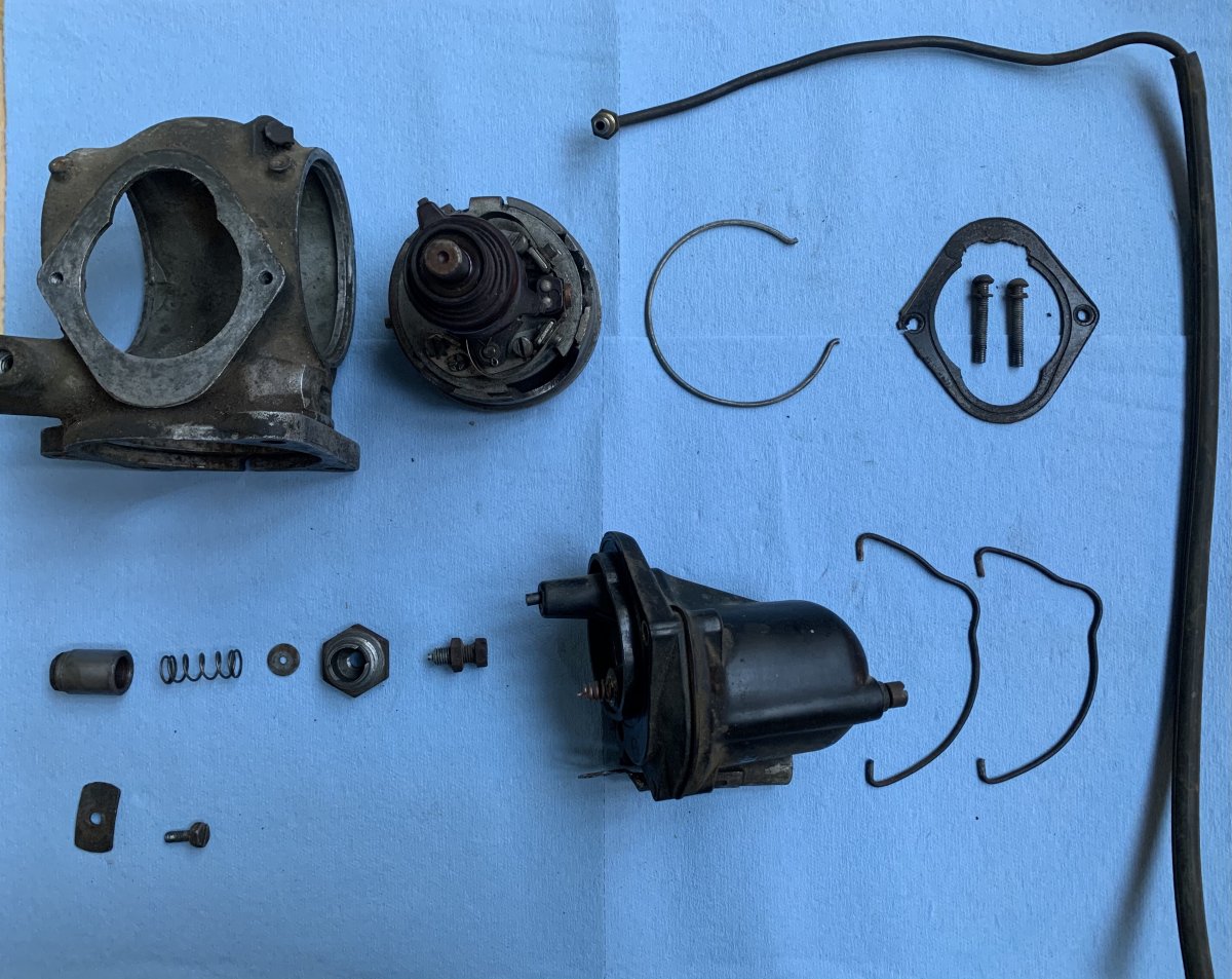

    The dizzy disabblemed. Will be ordering new parts for it today, as well for the fuel pump and carb.

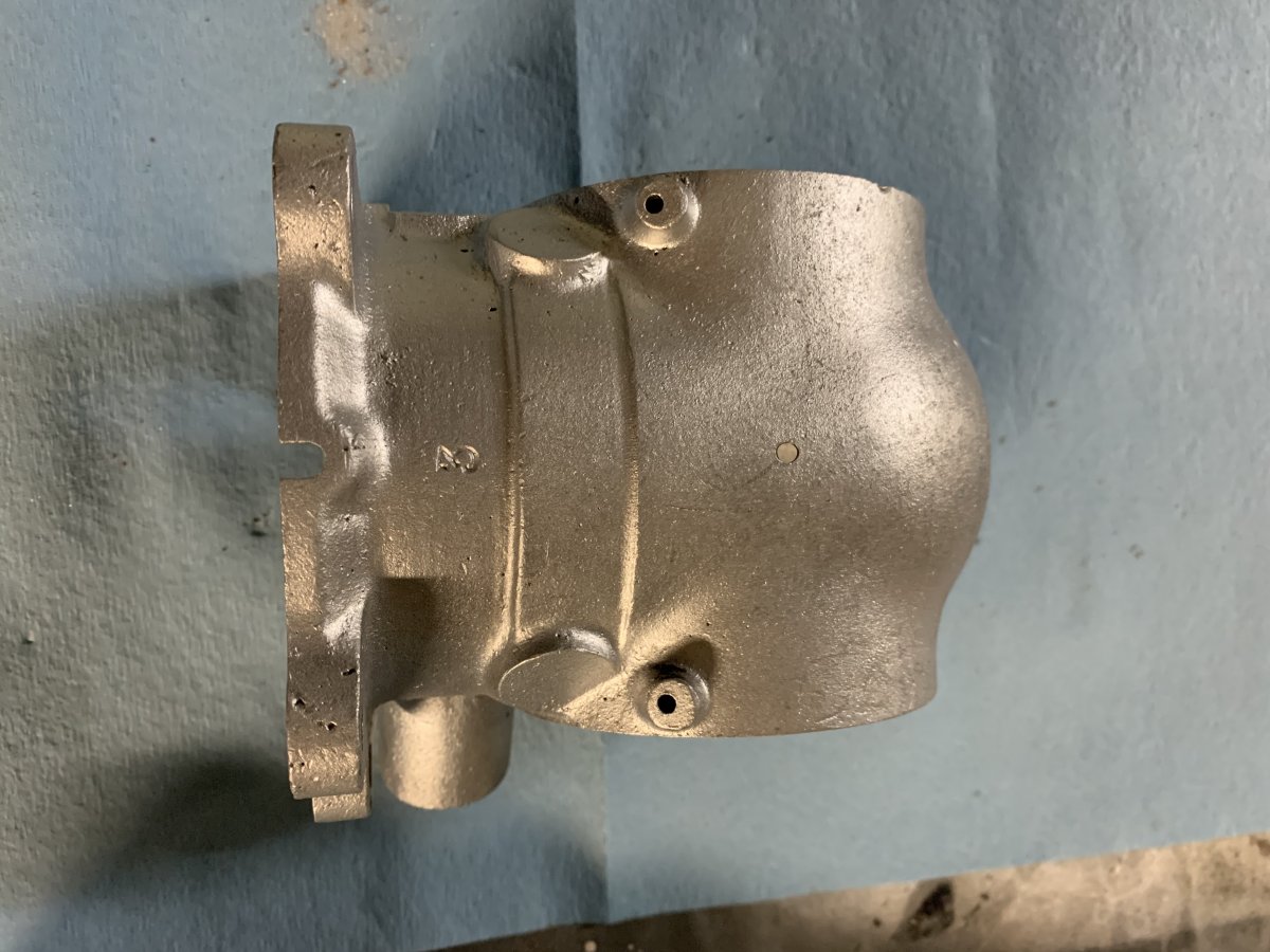

    Got some gl*** bead and tried it out on a few things. The cabinet still leaks a bit around the gl*** window and one of the hand openings.
    Helmet dizzy housing.
    Early aluminum manifold. Just started in the middle section.
    94 carb housing.

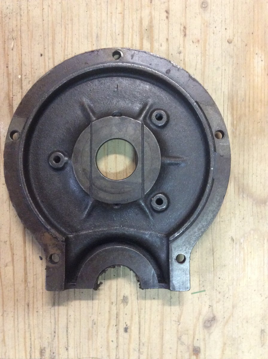

    Re-blasted 3-bolt dizzy cover. The gl*** bead cleaned it up better than the walnut shells.

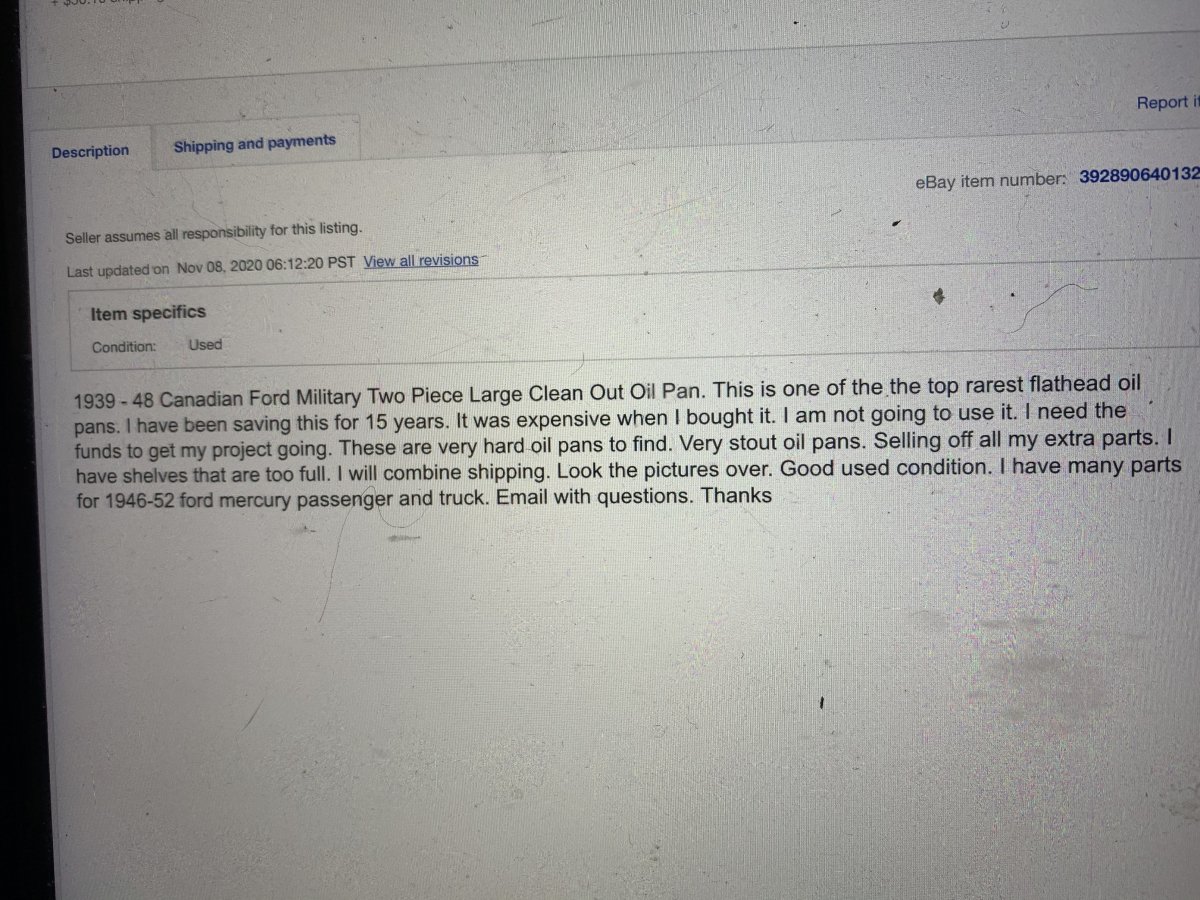

    Was looking for a new oil pan drain plug for my heavy duty oil pan and came across this ad for one. Damn US$700.00! I think the CAN$100.00 I spent on my flathead has been the best “investment” of my life. Lol!

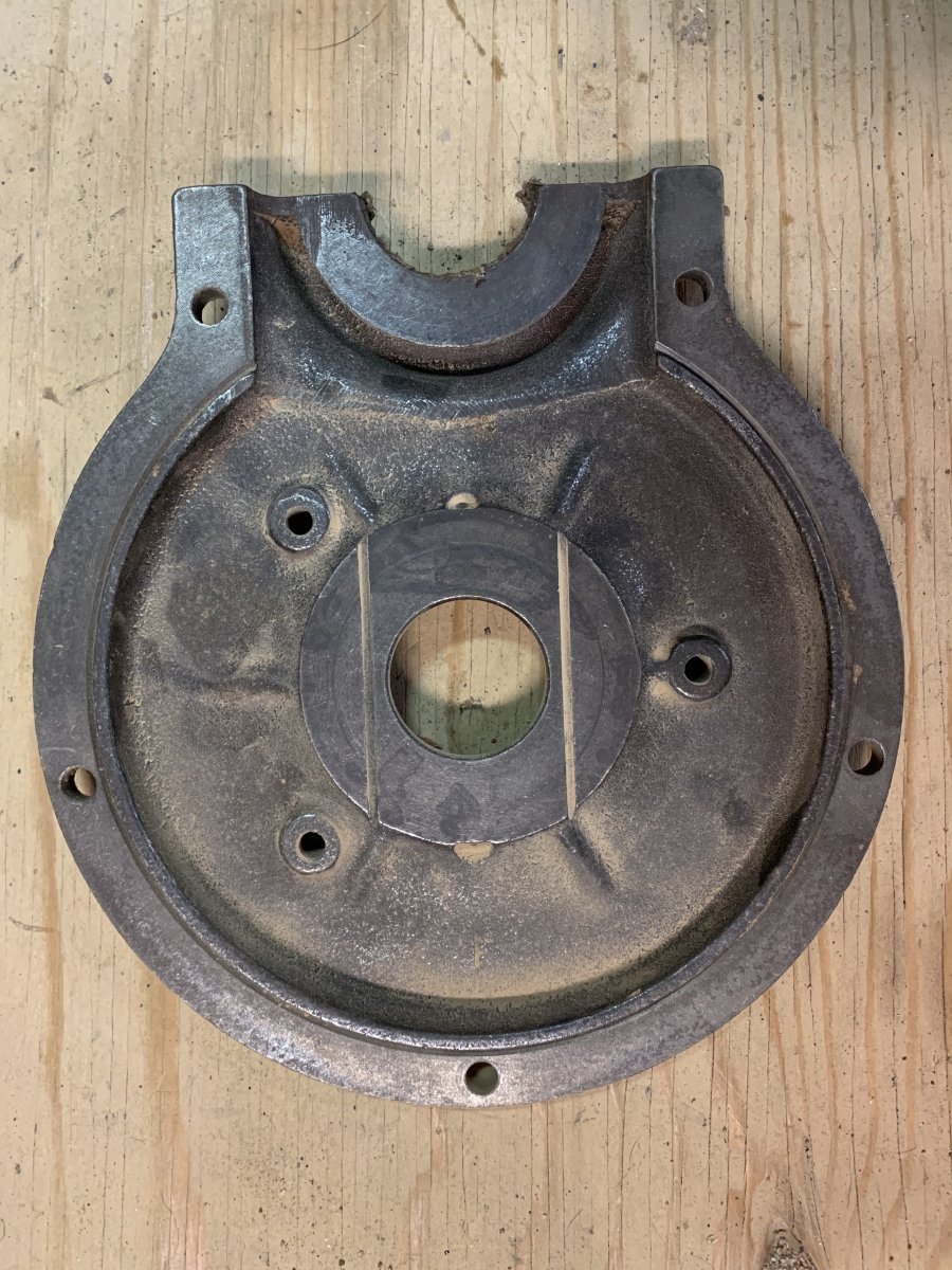

    Got the dizzy cover painted. Used same paint as rest of engine, but was thinking of going black to match the water pumps, but decided that would be too much black up front.
    Have a thread going over on Ford Barn about my helmet. Painted it with some Tremclad high-heat paint. Will use same on my aluminum intake.

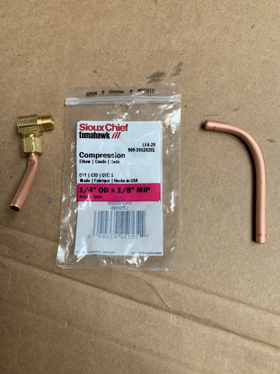

    Turns out the compression fittings won’t work, and upon further reading aren’t recommended. Seems double flare is way to go with Cu-Ni or copper tubing for fuel. There is lots of debate on use of copper, but I did purchase some from Roy Nacewizc last year that I’ll try first. Still have a bit of blasting to do, but should be done today. Need to order the large drain plug for my oil pan as misg threads are destroyed, and upon a closrr look at my dipstick, it may also need to be replaced, that us even if one is available.

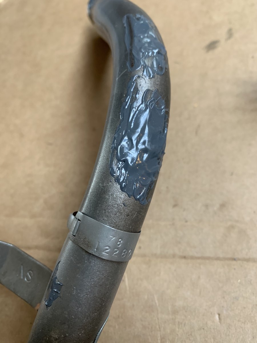

    Spark plug wire tubes. Both had numerous dents, but one was worse than the other. For it I decided to use some JB Weld, while I used some spot putty on the other.
    C124F51F-19E2-4FE6-8E13-49AF8655EE44.jpeg 1693E9A6-83A3-4344-AC29-09EB81EB528A.jpeg
    Compression fitting and attempt bending eith simple bending tool. The copper was crushed slightly around the bend. I’m thinking it’s too soft. The compression fitting is supposed to work on copper, but the ferrule was really loose.

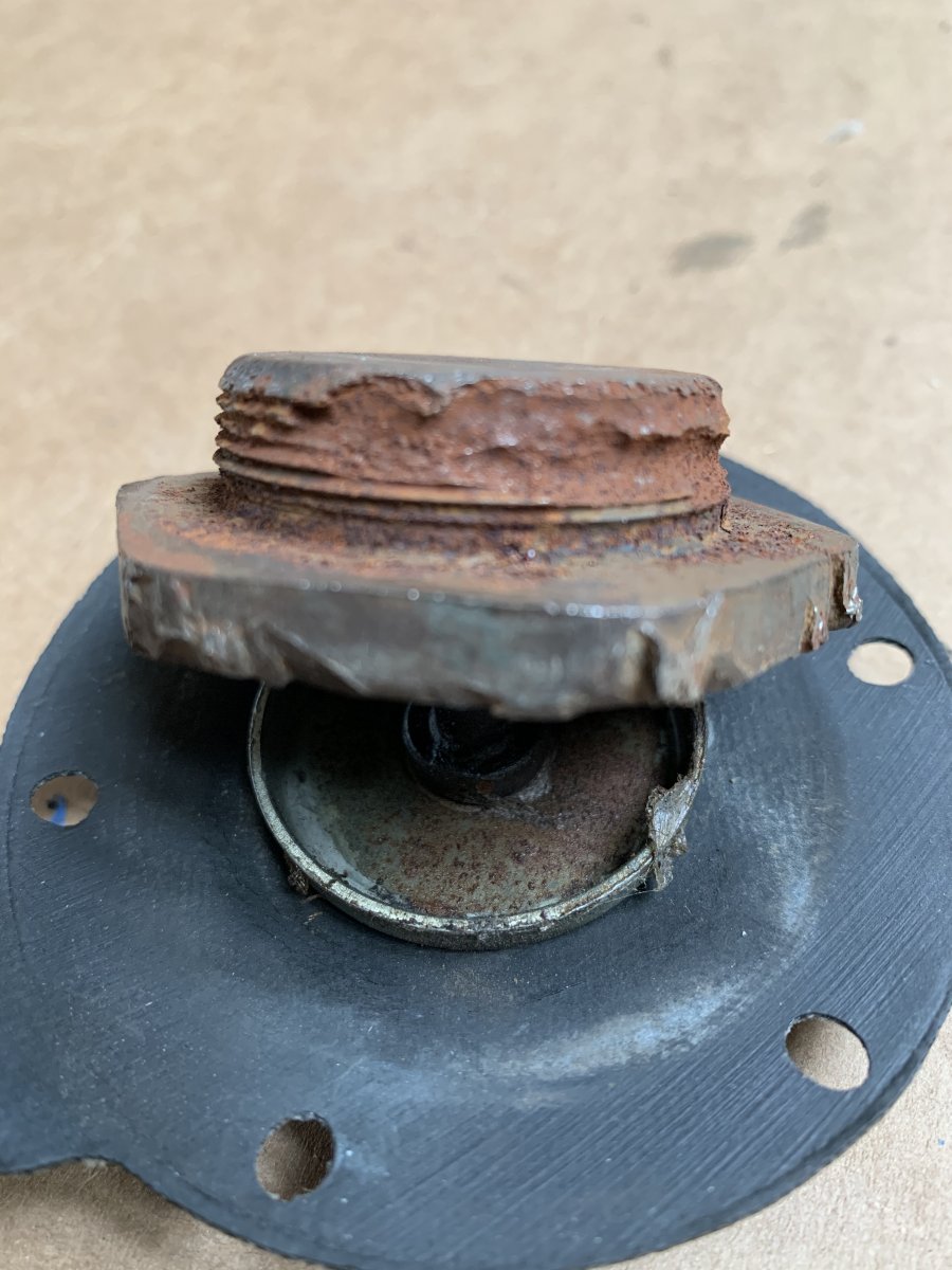

    Forgot to include pics of dipstick and drain plug...
    0498B52D-D4C2-4262-A6B6-84E382DC6517.jpeg 1635EFE3-5B9B-4454-8D66-BD0CFF56291C.jpeg

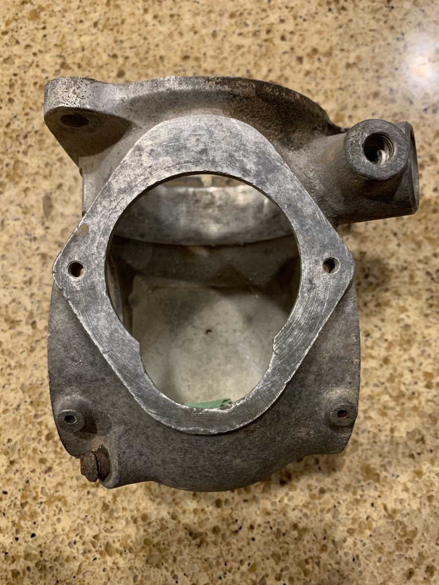

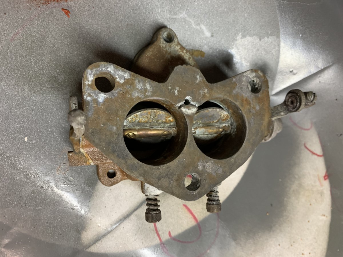

    Some pics of the misc carb bodies that I have to deal with.
    Blasted, but seized.
    Acid dipped awaiting diss***embly and blasting.
    Acid dipped, awaiting blasting, not seized.
    motoklas and Stogy like this.

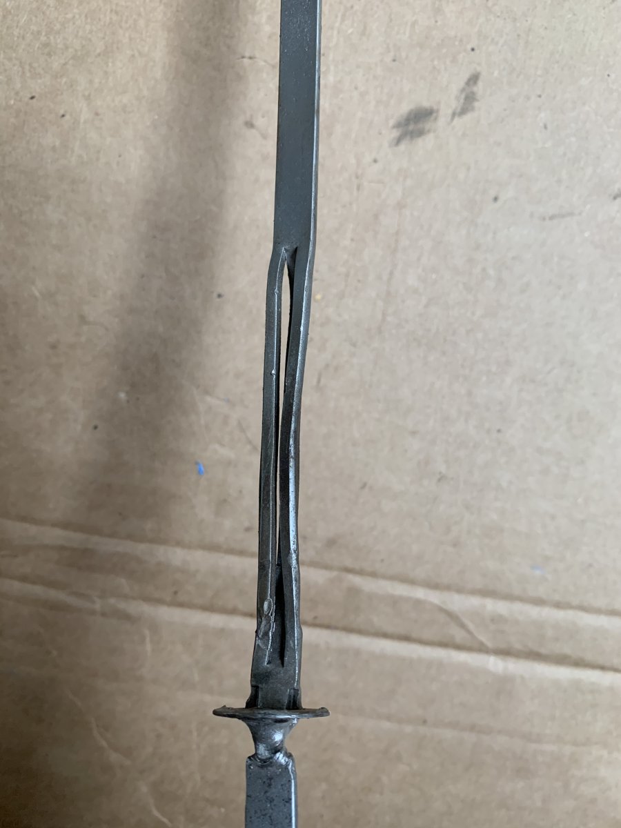

    Decided to give it a go and see what I could do to try and salvage the dip stick. I was really surprised it turned out as good as it did. Took only about 15 mins to straighten things out. The single tang did break off though at the lowet end. I’ll braze it back on as well as brazing a bit more material around tbe sealing disc. The disc/dip stick was repaired at some point and welded on crooked. Not sure how the dip stick was supposed to seal against the top of thetibe, but I’m guessing there was a rubber seal of some sort

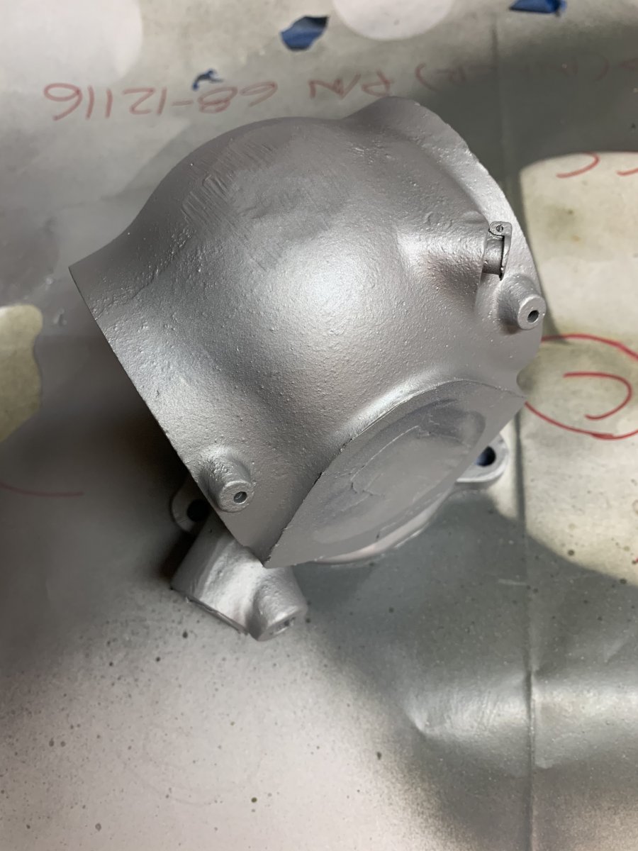

    Also got the first coat of paint on my intake manifold. I used my gas powered pressure washer this morning for over 5 mins to get the remmants of a wasp nest and some dirt out. Will clean again before installation to make sure nothing else is left. When the paint goes on wet it actually looks identical to the natural cast aluminum.
