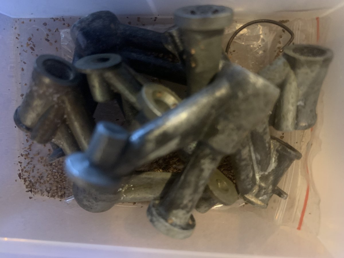

    Ordered my carb filter hsg and breather cap from Speedway. Not my first choice, but I need to order parts ASAP.
    Also finished up the last of my blasting using glass bead. Will switch to crushed glass for the steel parts starting with my oil pan assuming it fits.
    Oil gallery splash shields.
    Pizza anyone? Lol!
    Misc hardware from the carbs.
    loudbang and Stogy like this.

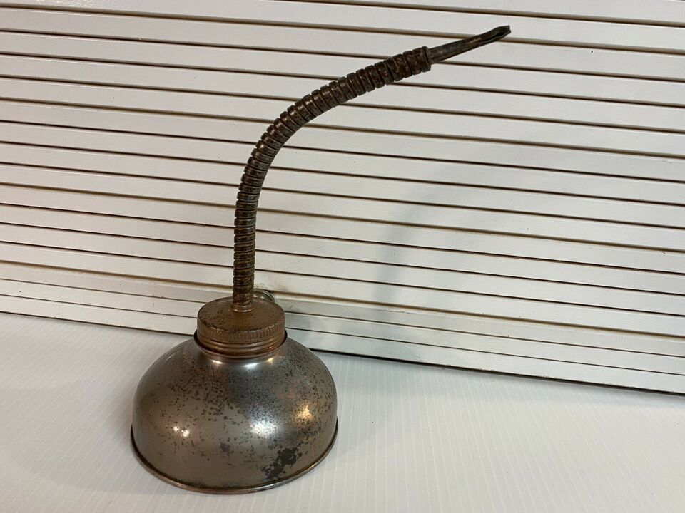

    Also found this gem locally on kijiji.
    Got the idea after coming across this pic on the interweeb last year.
    Can actually use it to oil the dist shaft. Lol!

    Ole Squeaky will be happy as the Tinman...you got the deluxe version...did it contain any period oil...I mean it's a close second to Vintage Tire air and of course barn find dirt...:D

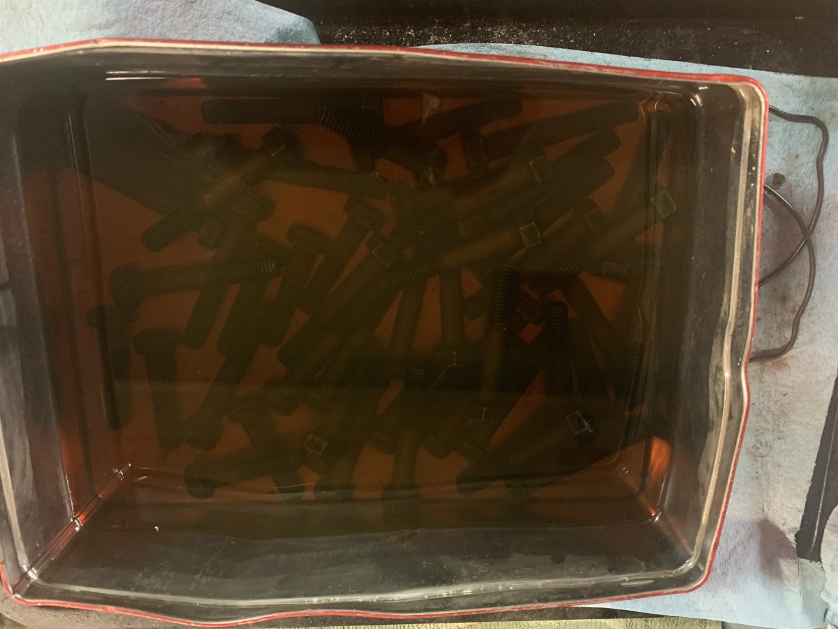

    Merry Christmas! Because we are once again under the Covid-19 lockdown, and essentially no one can visit, I’ve decided to carry-on with my projectz. Seems like I’m running a small production fscility. Dissassembly, inspection, clean, paint, etc. I’ve focused in on the carb rebuild, and I have come to the conclusion that I’ll buy all new internal fuel passage parts. Not sure what they are all called, but after some acid dipping, and overnight in my vivratory tumbler filled with walnut shells, I feel the parts are not up to new or rebuild standards. I’m slso missing several parts from the carb kit I inherited like jets and correct style power valve (mine has the very slight radiused shoulder that prevents the gasket from seating properly). Also, it likely doesn’t have the correct vacuum rating. I believe standard fir sea level is 7.5, and running my Isky 1007B cam will likely require perhaps a 6.5. Any thoughts ln this would be much appreciated.
    Misc parts after “cleaning”.
    To make matters worse I just noticed this nice handy hole that someone had drilled into the housing after removing the choke plate.
    Parts production facility...
    Oil dipped head bolts after heating up in oven to 500F for 30 mins. Watched a vid and guy said it should be prevent rusting. We’ll see...Lol!

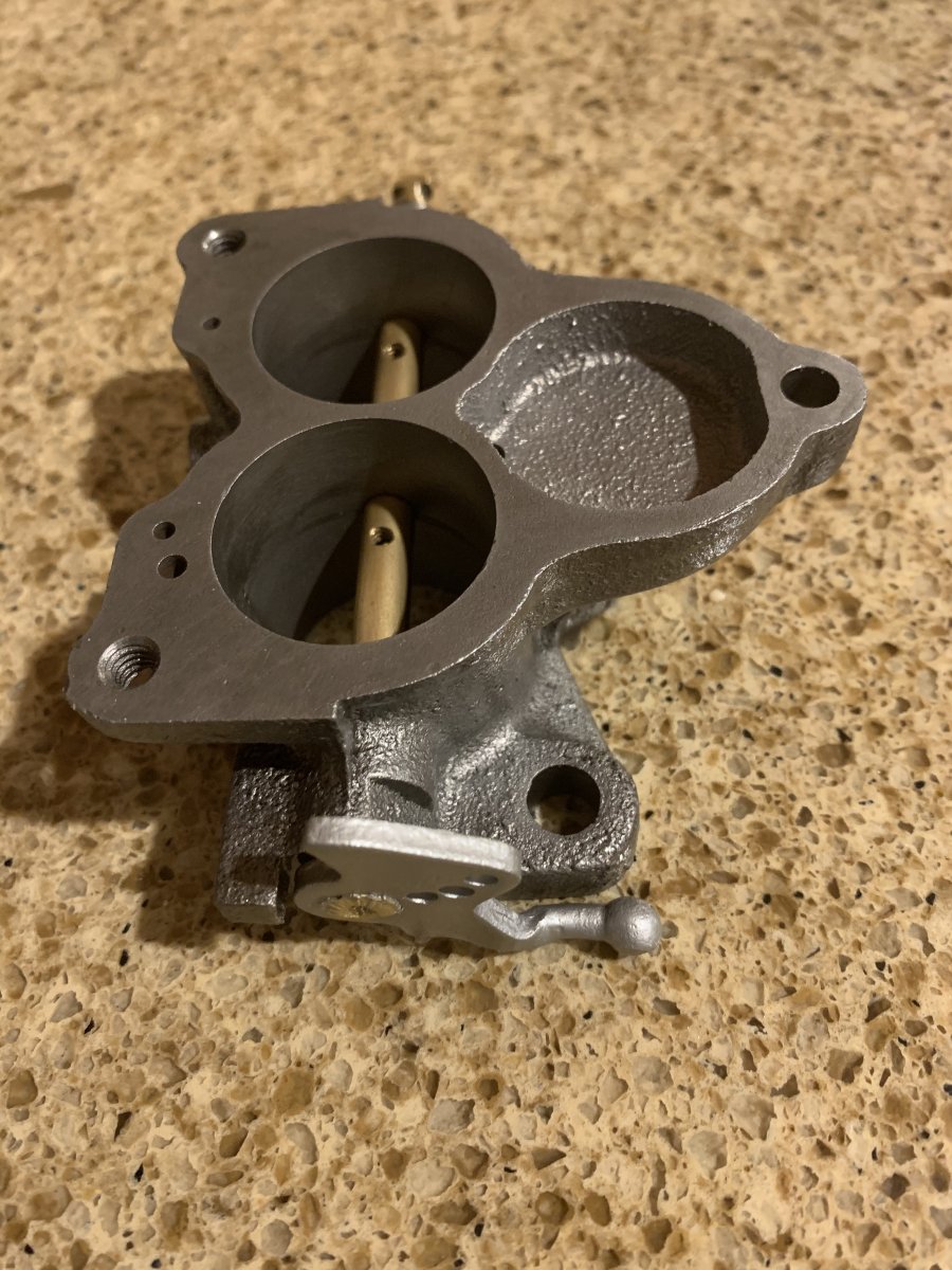

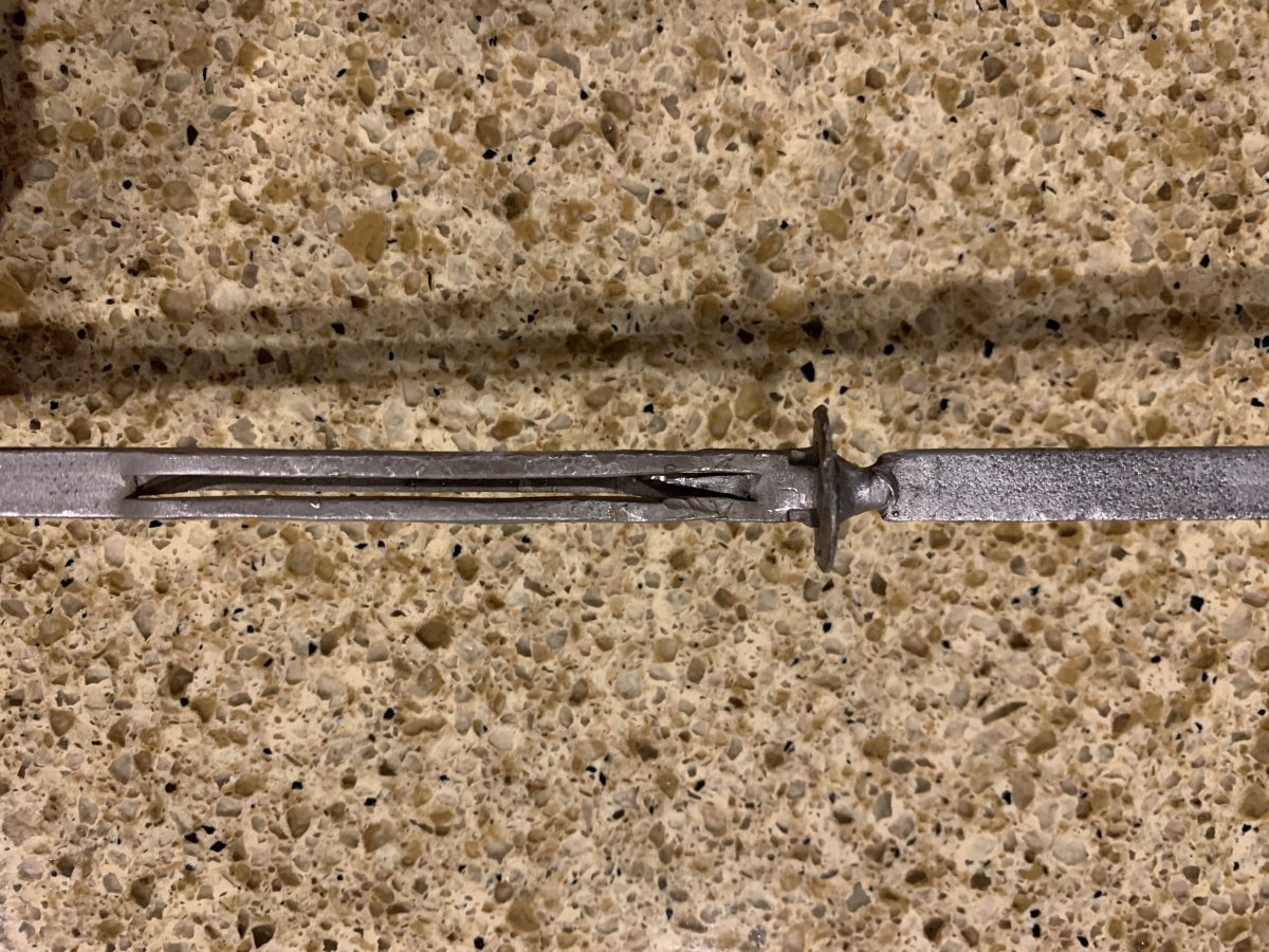

    Disassembled the throttle plates and shaft from the base, cleaned things up, and applied some hi-heat clear. Upon reassembly, I noticed the shaft has a bit of play on the throttle lever linkage end. I also noticed the throttle lever linkage with the ball end had been bent. Damn! I even painted the bugger.
    This is becoming a bit tedious. I have another base with a good throttle position plate, but that shaft is corroded solid. I haven’t been able to get it to budge even after a few days of soaking it in some SeaFoam DeepCreep.
    The “good” base with the loose shaft and bent throttle lever.
    Crusty/rusty base with seized shaft but good lever.

    I was at a swap a couple years ago now and there was a local Speedster guy that had a couple of 94s for sale...Perhaps I can send one of the CC members an email to see if I can track him down...94s aren't terribly hard to find...

    Thanks @Stogy for the offer. I’ll let you know how it all this goes later today or tomorrow depending on whether I start blasting my steel parts. My oil pan fits in the cabinet and I was hoping to have that completed yesterday, but with all the carb nonsense it was delayed. I have seen both 94’s and 97’s come up for sale on kijiji, but nothing locally, and prices seem way too high to me for what essentially becomes a complete rebuild. My “good” carb is probably the one I actually paid $50 for last year, but it had its issues as well. I’m still hopeful that I can cob one up from these parts. I checked parts on Vintage Speed, and the parts I mentioned with all the internal passages are just rebuilds, so I’ll probably try to salvage what I can, but I’ll still need to buy stuff.
    A close-up of the radius on the power valve and corresponding gap between the seal. This area is under vacuum which makes achieving the seal really important. I wonder how many folks just slap it together and then wonder why things don’t work as they should?

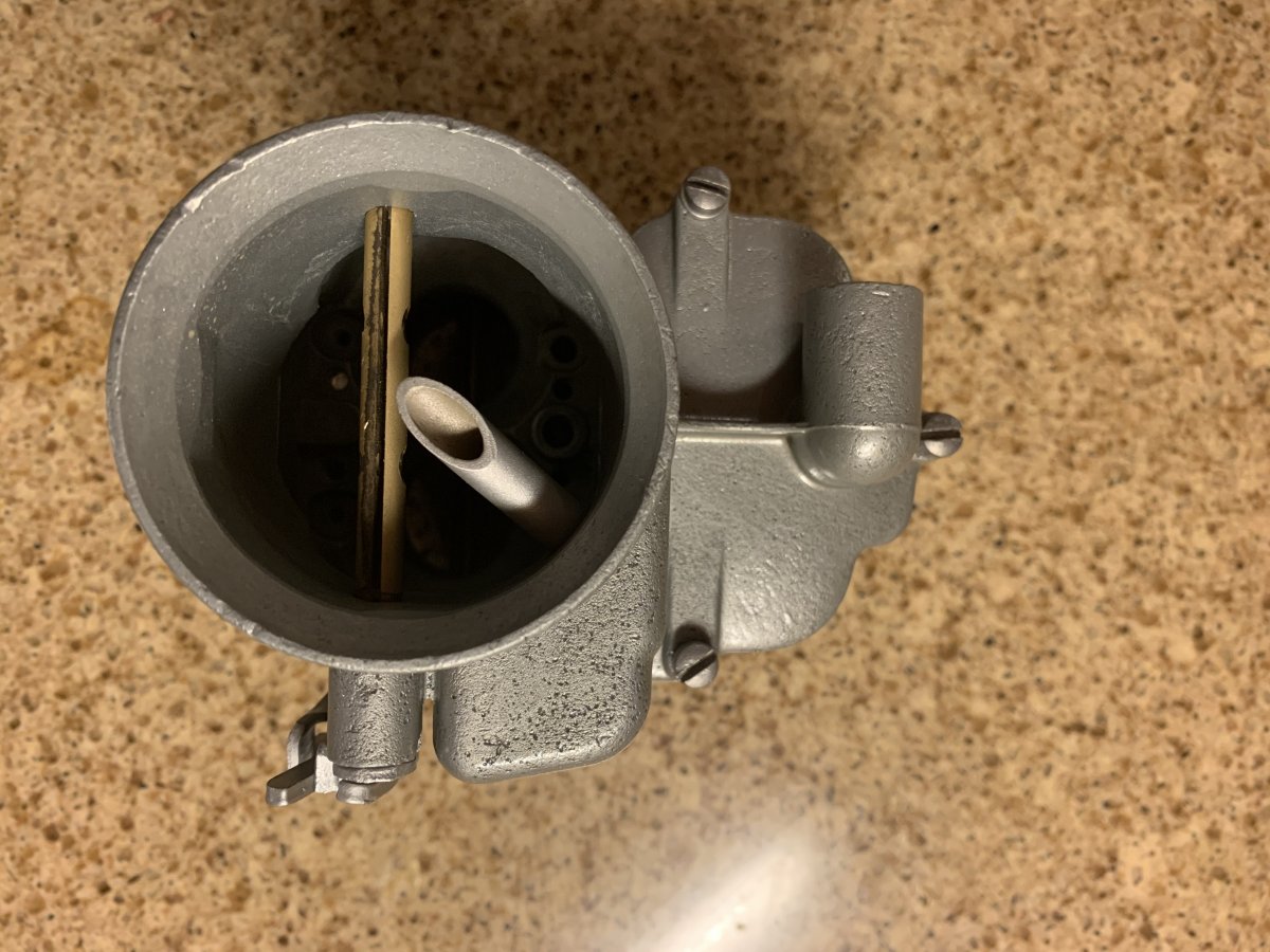

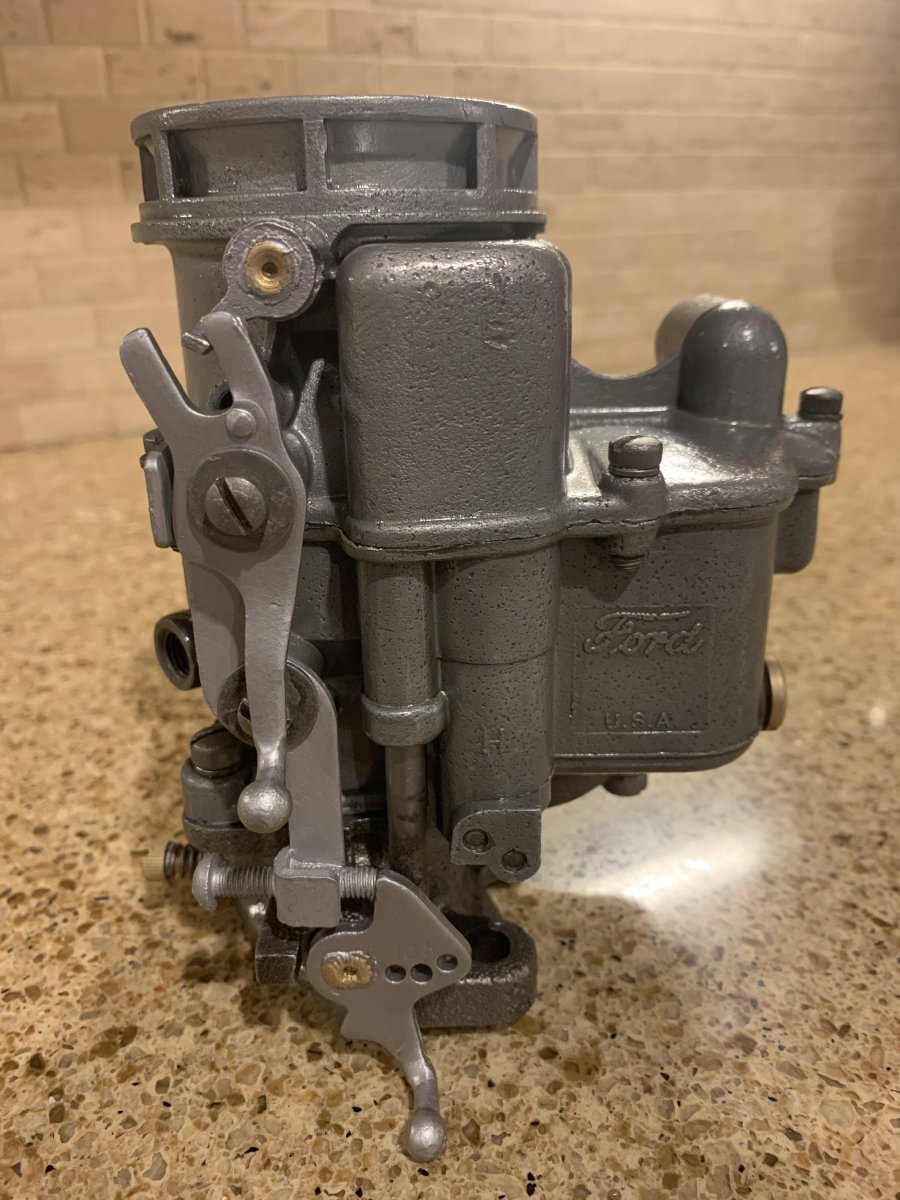

    After what seemed like an eternity, I managed to finish up getting enough of the good parts together so I could mock up the carb. Also discovered that the throttle plate shaft is worn. Another was also worn, and the third was destroyed as I tried peening the shaft end over the throttle position adjustment plate as it had come loose while trying to remove it from the base. Both were actually a real bugger to get loose, and required a fair bit of heat. I would have preferred a flat gloss, but I’m guessing it will dull over with time. I just hope it dosen’t yellow.
    motoklas, loudbang and Stogy like this.

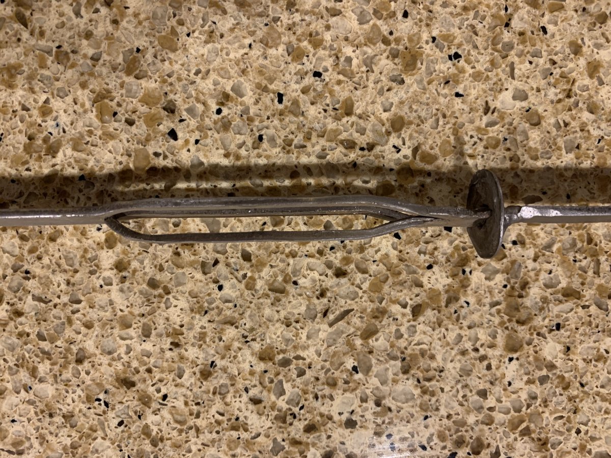

    You are missing an item on that carb...It is a pump rod that runs from the throttle linkage with the 3 open holes to the pump rod which is resting behind the linkage...You can see it just below the brass choke cable lock on my center carb...there is also a vacuum line opening similar to the carb to the right of my center carb...If you are not using that for a line you may have to block it off...
    You may have it and haven't installed it but I noticed that at first glance...The 3 positions are for adjusting that pump operation...
    So many types of 94s...

    Good eye @Stogy. Yes, I know it is missing as it too was bent and I couldn’t install it. Nothing is installed either inside the carb. I still need to touch up some of the hardware in the vibratory grinder and perhaps with a wire wheel. What I’ve realized as well is that I’ll need a manual choke cable, and if I wish a hand throttle cable. Haha! Even at my age, I’ve never had a vehicle with a manual choke. More stuff to buy. Lol!

    That looks really sharp @Ziggster...one other observation I failed to mention that may be ok as is is the fwd tang on the choke open/close lever is bent...if you look at the lever on your rustier carb it seems fine and if you look at my carbs they are similar to your rusty one as well...
    I guess you can do the actuation to see if it fully opens and closes.
    I noticed a rivet near that tang in some and not others...I wonder what that is there for?
    I got a choke cable attach bracket from @dickster27
    and the Cable was just a Napa or CT item...

    Good eye @Stogy. Yes, I noticed the choke lever was bent once I installed everything. I’ll need to straighten it out along with the accelerator pump link, and do a bit of touch-up paint.
    Geeze, did I write all that?! Typing away on my phone, I can only see a portion of what is written. I’ll have to keep things shorter in tbe future. Lol!
    I was looking at getting an “Edmunds” cable brkt to dress things up a bit, but at USD$40, I’ll pass. Even the stamped steel stuff is approx USD$20. As such, I’ve decided I’ll fab up whatever I need from some brass flatbar stock as it will help give a more prewar look.
    Also, I noticed on the other multi-carb pic you posted, the mishmash of componentry on the carbs. The one stud on the middle carb is slightly crooked (same stud actually as on mine). I don’t feel so bad now. Lol!

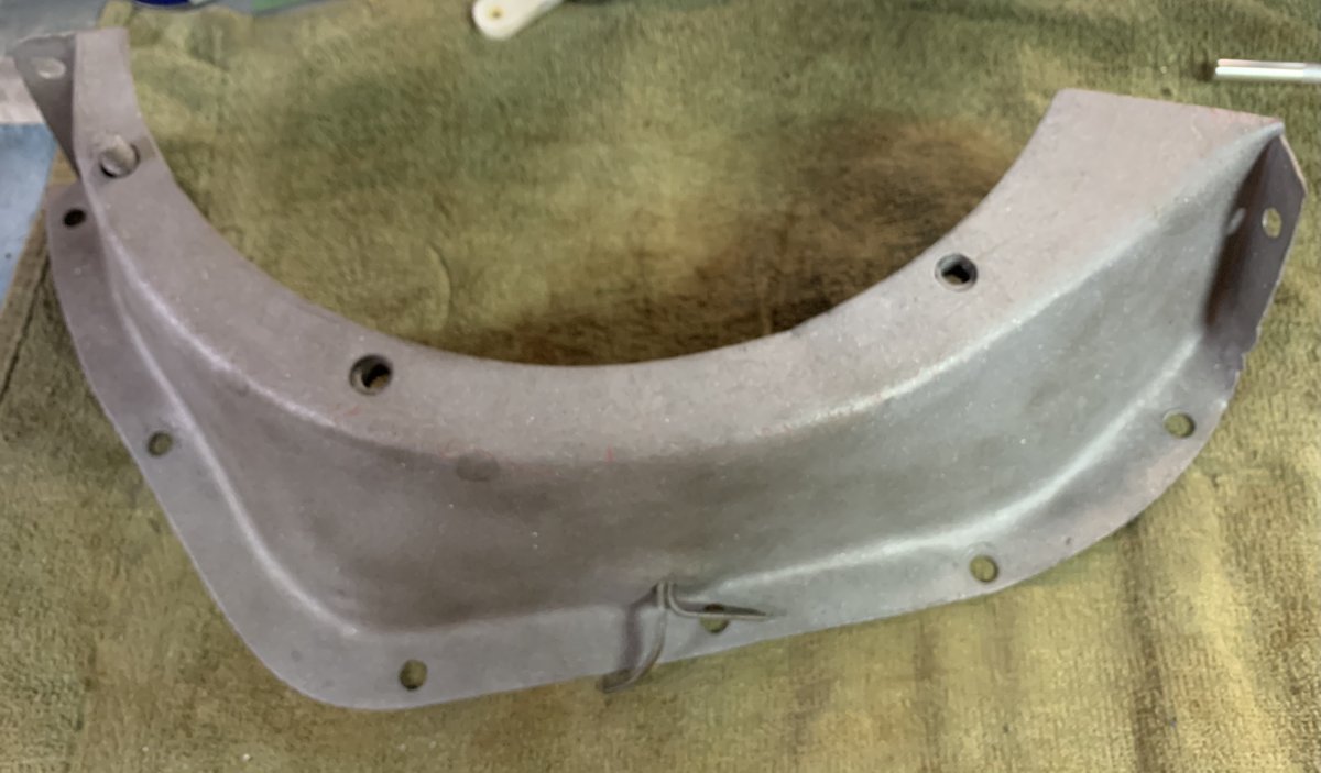

    Pics of the oil filter hsg lid and clutch inspection cover. I’m 99% sure there is glass embedded in the steel.

    Would paint encapsulate the impurities...or just a scuff with sandpaper...I mean sandblast is like glass isn't it?...
    Maybe a molasses bath or vinegar is a better solution for this dilemma...
