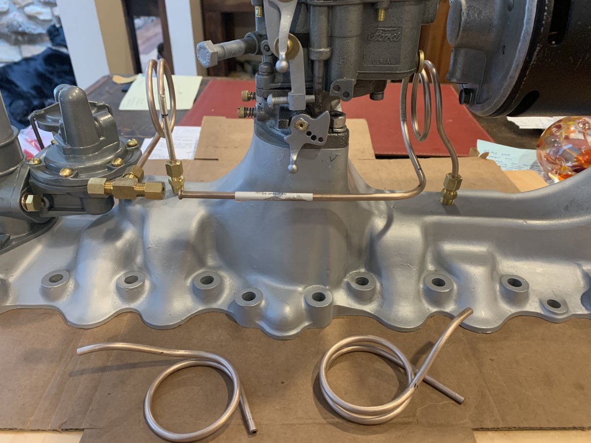

    Well after two failed attempts to bend up a piece of vacuum line for my vacuum gauge, I get it right on the third attempt but I’m a 1/2” too short. I don’t know what I was thinking when I bent up the first two pieces as I didn’t add the “extra” length to make it to the T fitting. $hit!
  12. It's good practice and not the end of the world. Next time make the woop-ti-doos and the 90, cut the final length after the fancy bending is done, and only then do the flare as the last step......... and don't forget to slide the female fitting on before you add the flare.
    Stogy, Ziggster and loudbang like this.
  13. Ziggster
    Joined: Aug 27, 2018
    Posts: 2,989
    Ziggster
    Yep. Did the first loop using the entire 8’ length, but had one of my kids helping me. Of course, they were still sleeping this morning, so no helping hands. No big deal. I’ll pick up another length next week, and will have one bent up again in 10 mins.

    Decided to take a bit of a break and bent up the fuel line from the pump to the carb. Not sure if this will be the final configuration yet.

    Also picked up another length of 3/16” Cu-Ni brake line and reconfigcured the vacuum line a bit. Ordered some Gr 8 hardware from Battlefield/ Cat for my intake manifold and timing cover so it matches the phosphate headbolts.
