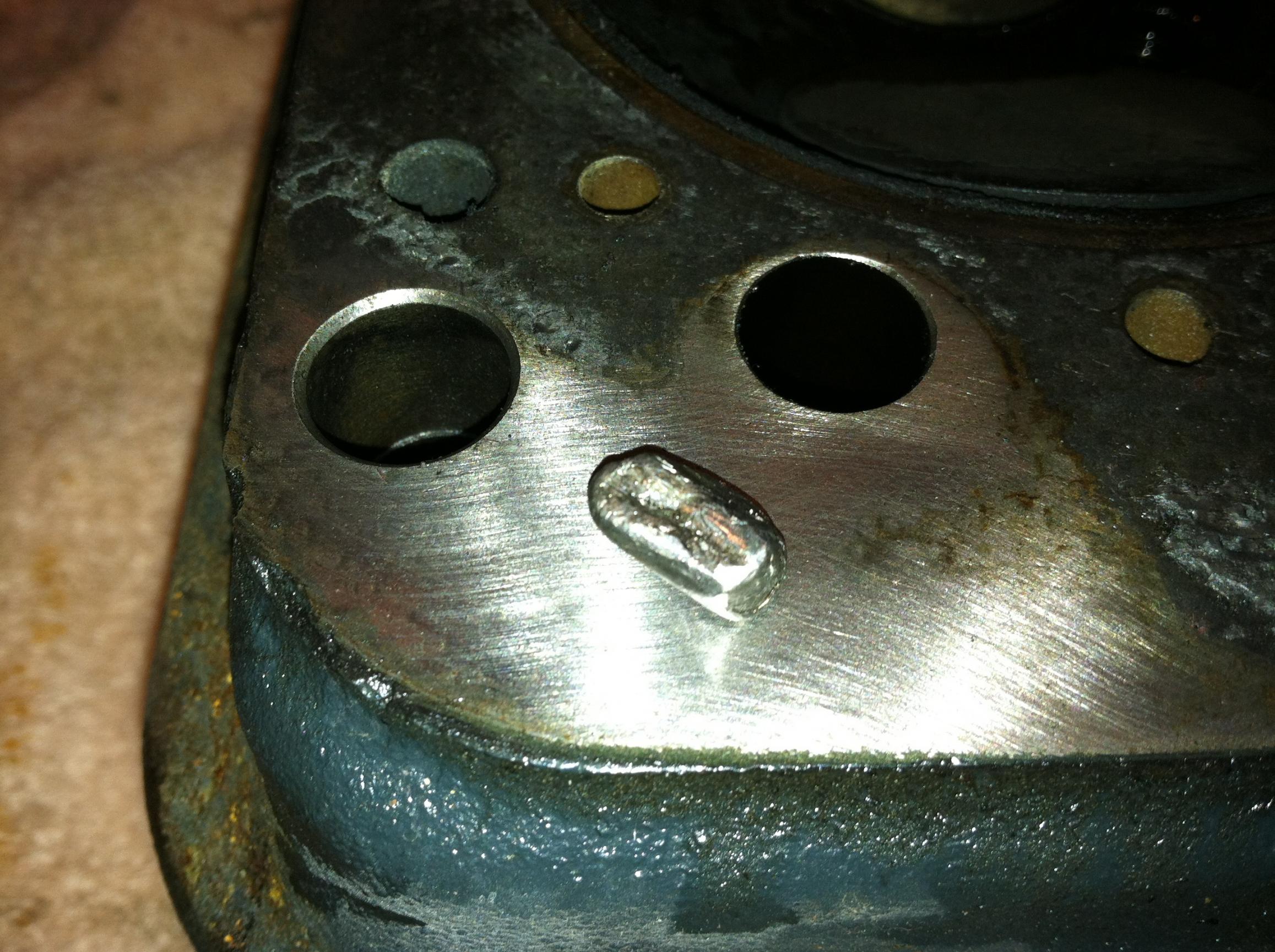

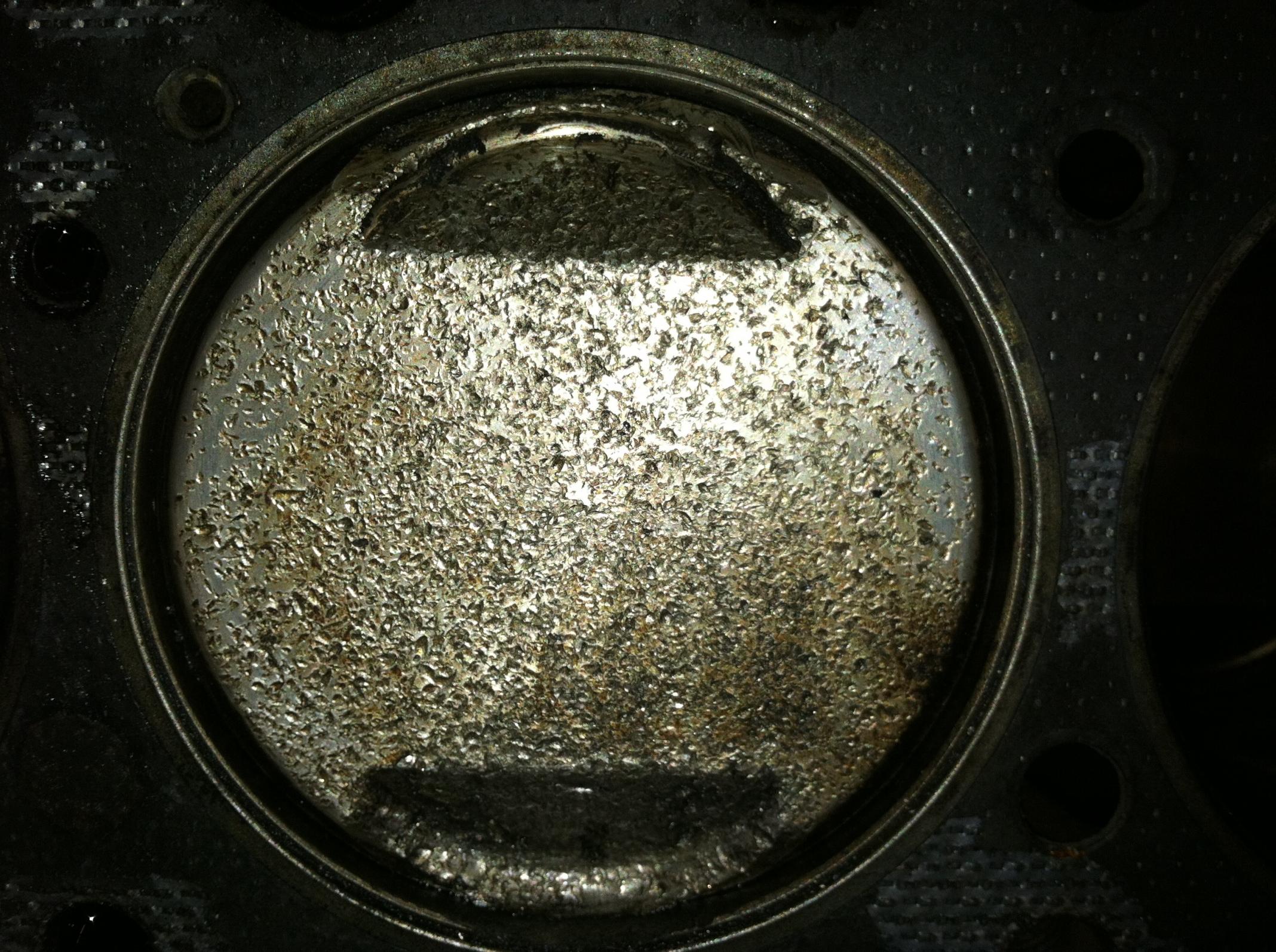

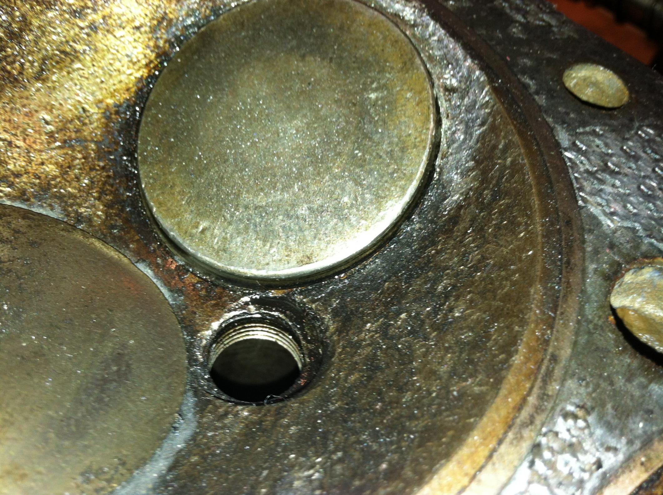

    So the head is off, and it was very obvious what was wrong. Clueless as to how this got inside my motor. Looks like it used to be a nut. Cylinder wall is still fine, piston got munched but is not cracked or broken. Bent a valve. Taking the head tomorrow to the machine shop.

  23. scootermcrad
    Joined: Sep 20, 2005
    Posts: 12,383
    scootermcrad
    Awww man! Bummer. :( Well, at least the machine shop can take care of the head and valve portion with a few bucks thrown at it.
    What are your thoughts on the piston? Wondering if all those craters are going to cause you some undesired stress risers around the perimeter that might lead to a failure down the road.
    Anything metallic squeak by to the pan?

  26. d2_willys
    Joined: Sep 8, 2007
    Posts: 4,343
    d2_willys
    from Kansas
    In pic #1 it looks like the object is near the end of the head. Is that where it was when the head was removed? Seems weird it was there and not near the actual cylinder in question.
    I would take the carb apart and make sure that it isn't coming aparton it's own.

    Just sitting there for the pic , it has a shadow ...
    For what it's worth , that nut may have been jammed somewhere and only recently worked its way free .
    Many nuts and places to hide ...
