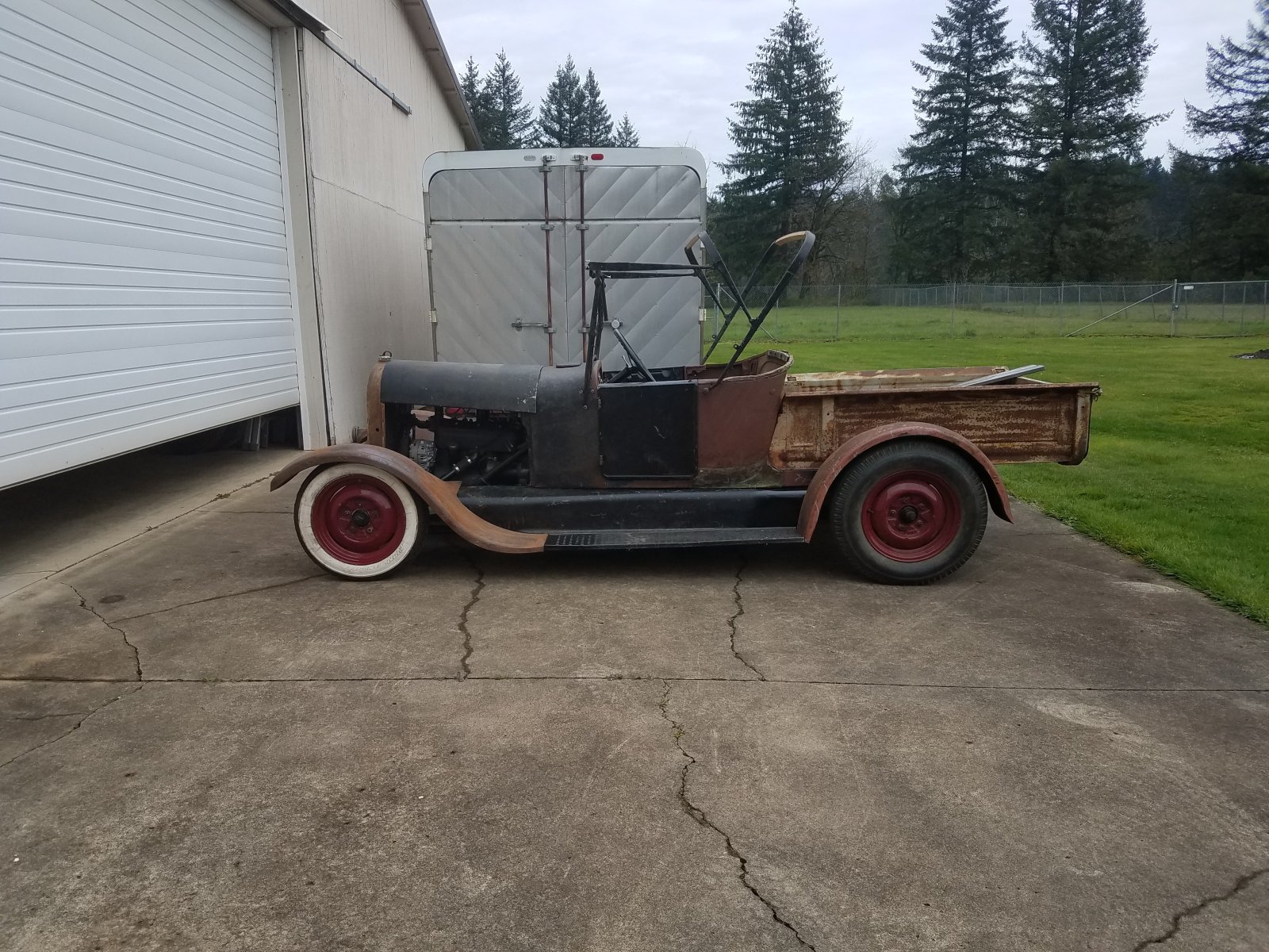

    Hands are starting to get better to where I can mess with stuff... got a question for the "T" wizards... if you move the spring mount forward like the car in the pic, would you just split the bone??? and would you have to make the cross steer longer??? what else might I be missing???
    I like how they heated the rear spring...
    also, the front spring is still on top of the axel...right???

    anyway... started cleaning, probley 50 yrs of baked on grease,.. when I do this I usually roll out old carpet or area rugs from yard sales.. it keeps the mess to a minim, then it don't get tracked into the house and all the grease ****s into the rug.... I then spray everything with pro easyoff... takes the grease, and all the layers of paint off , with the rug down you can then paint with out ruining your concrete
    this was just one spray with easy off... usually takes a couple times and then the spot touch up i used to sand blast years ago.... horrible mess in the yard and a pissed off wife
