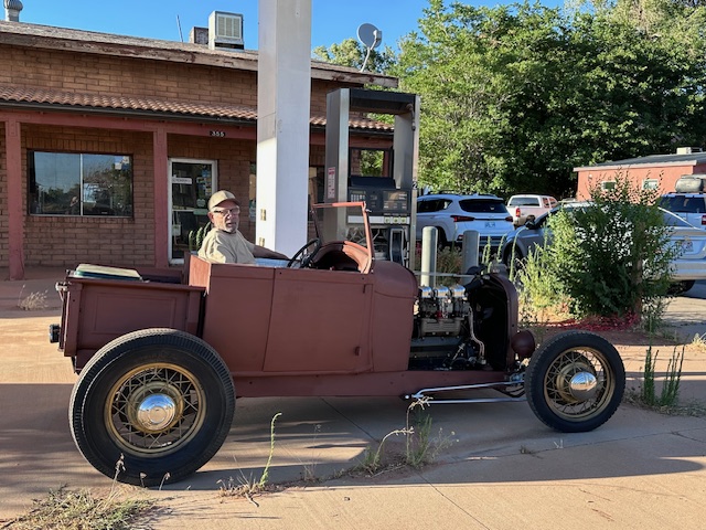

    damn... could have just bought this one and been done... wonder what size the wires are???
    the dog says...."aint no body gonna steal the car... it's out of gas.., but I'll wait here till you get back"

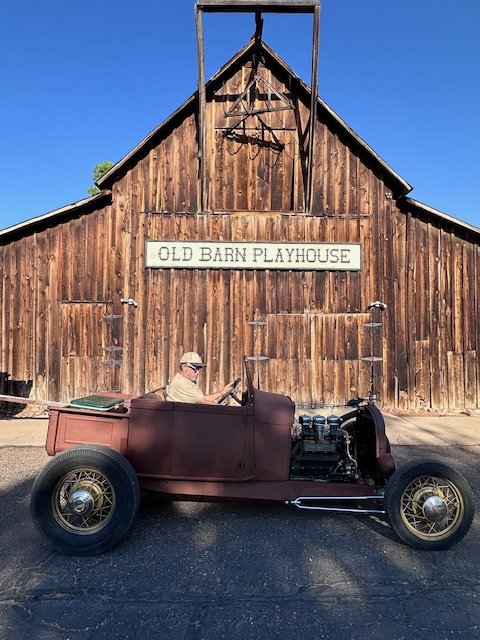

    I really like that primered bucket you have.

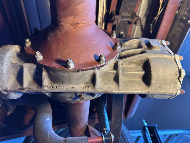

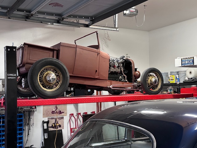

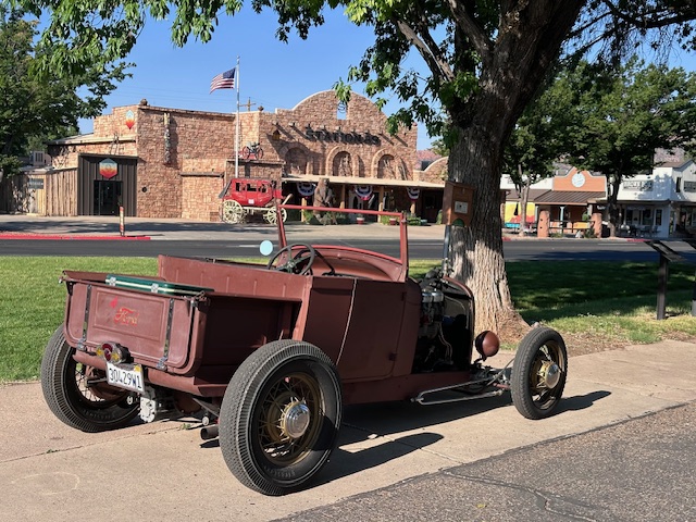

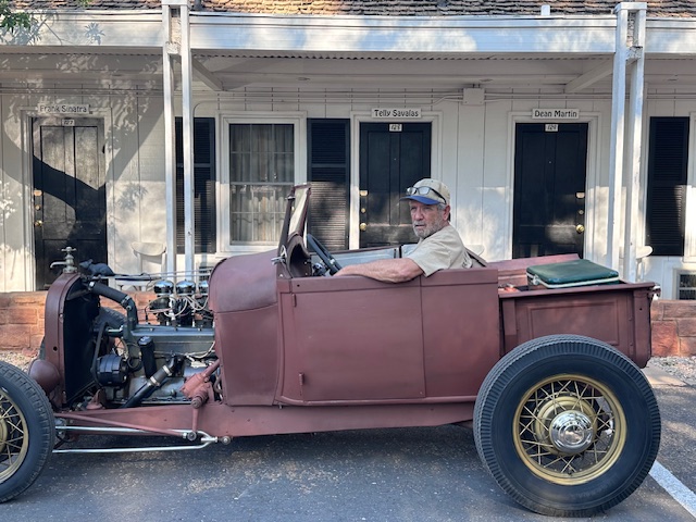

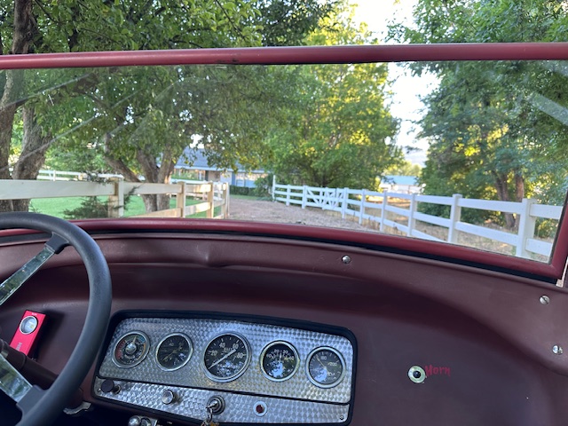

    this one? alburn dash, halibrand quick change, banger w/ winfield 7.1 head.. 17'' wires

    Those are 30'/31' Model A wires. T's fit really well on A Ch***is.

    so 19's??

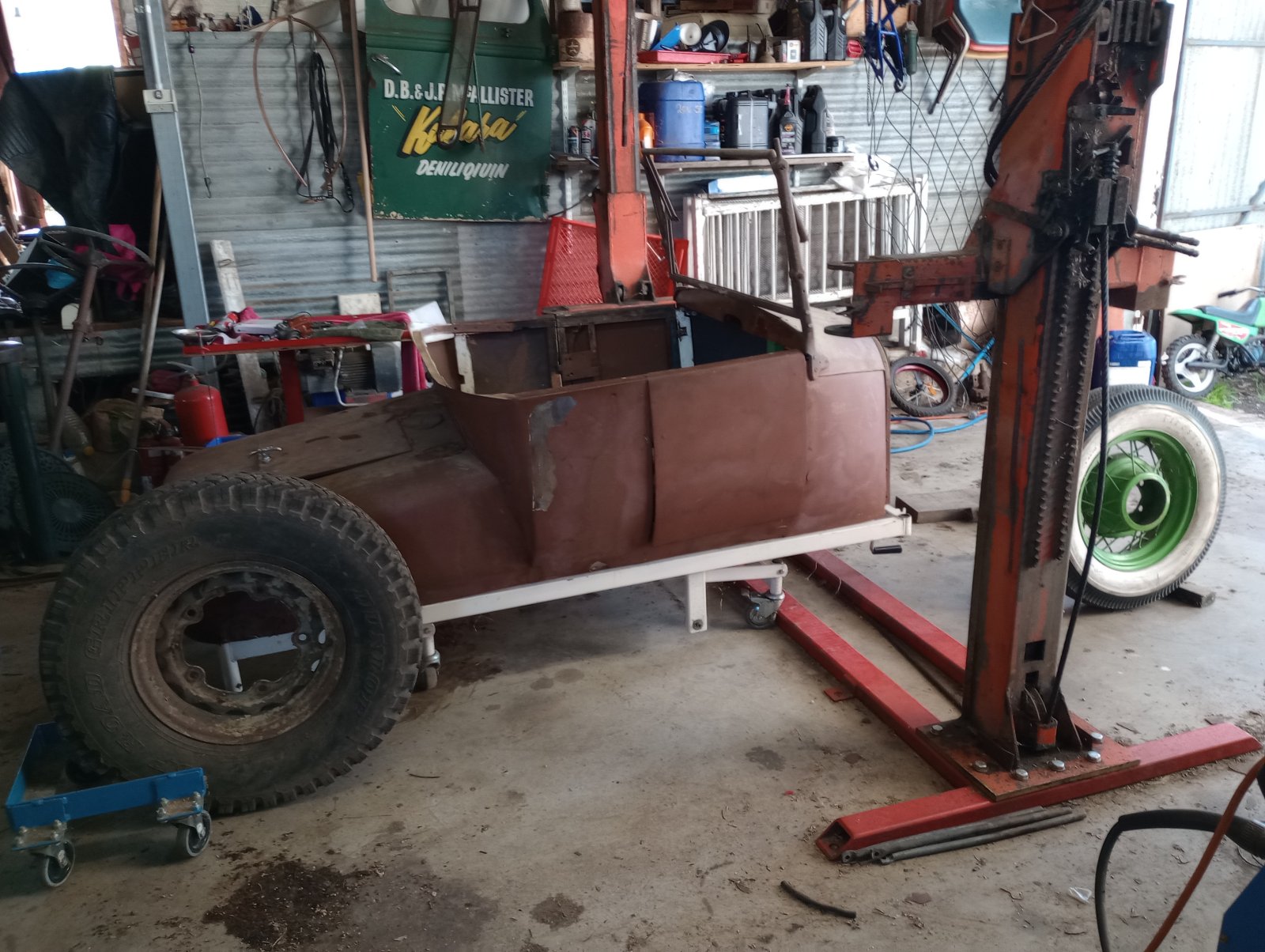

    The rear is uniquely Australian, not as pretty as a US built T, the best I can tell it's a 25

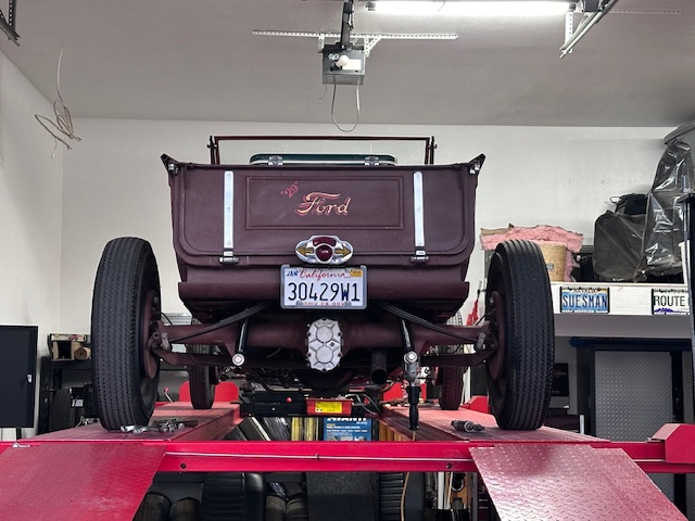

    I'd like to find a deck like that... fit my plan perfect.... and the doors??? home grown???
    they look like chevy doors...

    so back at the cross roads.....the T roadster pick up... the bed is way to nice to cut up, and no way do I want that long bed hanging out the back... to me the whole truck bed on a T was a mistake, and not engineered to begin with...then add Z'n the frame to a "that'll never work" idea.. the "T''s have sub rails and little to no frame in the rear.... that why when you look at old pics... there always bent from someone try'n to haul too much weight rear of the axel... the sub rails stick out past the rear cross member... then the bed hangs out even further, so that when you Z the frame, you have to cut the sub rails off... now the real only place the bed is hooked on to solid frame is the front 2 bolts... so the fix is to bob off all that bed thats sticking out... for me.. I already have 2 model A RPU's ,a model T RPU, and 2 model T hack depot's in the barn, and only one model T coupe... so I'd like to have a trunk back bucket (roadster) dirt track type gowed up skinny tire T with model A power... so I'm on the hunt for a turtle deck for a 1927 T roadster.... might have to build one...???? also.... just a though, but I have this idea that I think might work, the aprons on the T;s I was thinking that I was gonna flip the aprons upside down, and side to side to give the illusion that the car has a belly pan , all with the Idea that a couple good ol boys working in the barn didn't have sheet metal rollers , or even sheet metal to roll and worked with what they had..
    any way... if you think up some thing that actually works.... google it and someone already did it

    The bodies were built by 1 of a few body builders so they aren't standardized like a factory one. I did well with the body, I happened to get chatting with a local restorer about T parts, was just hoping for a cowl & maybe doors or something & mentioned that I would love a roadster but that I didn't expect to find one easily. He gave me a funny smile & told me about this one, he wanted to keep the running gear as spares for his tourer.
    When I picked it up he said to his wife, 'do you know what He's going to do with it? He's going to build a hot rod out of it! & She got very excited saying "Oh I love hot rods!" :cool::cool::cool::cool::cool:
