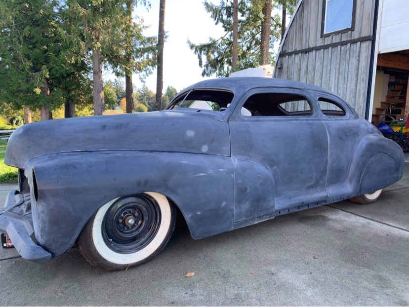

    Since I no longer participate in social media i.e. FB, instagram etc I thought I would post a few pics of my -48 Chevy coupe “my last build” for anyone that might find it interesting.
    I bought this project a few years back with the chop already done, the fenders molded to the body and a pancaked hood so part of the heavy lifting was done. upload_2025-1-23_17-30-26.jpeg

    Looks great. Sets perfectly.

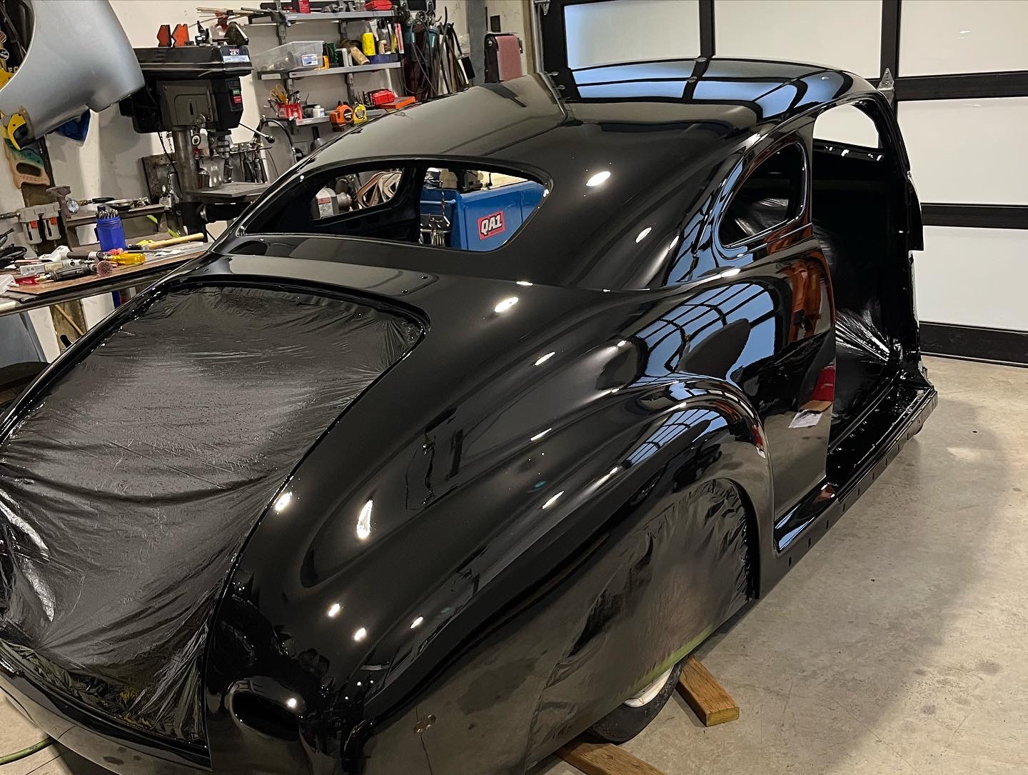

    Black, it was painted in my drive way, single stage.

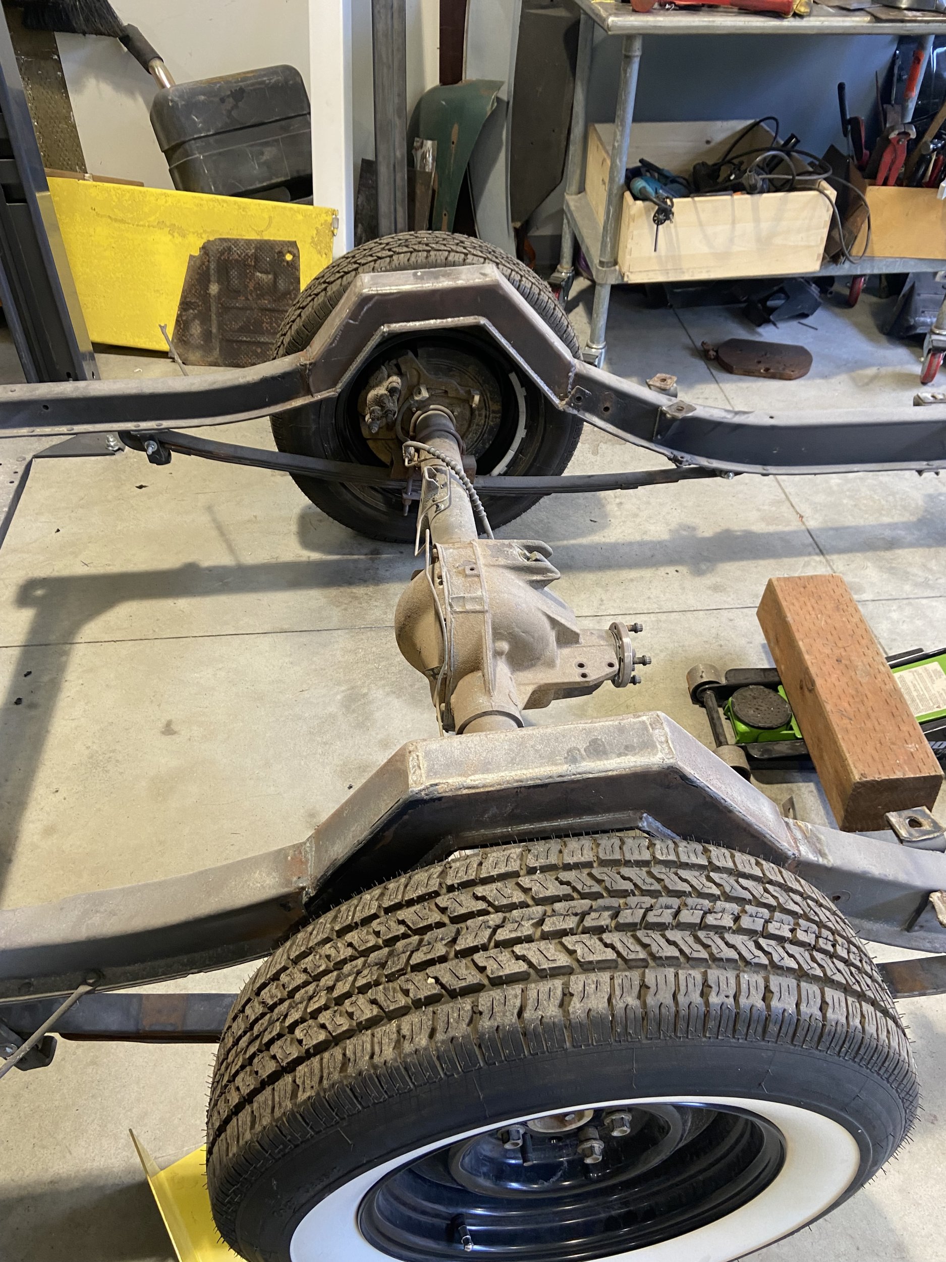

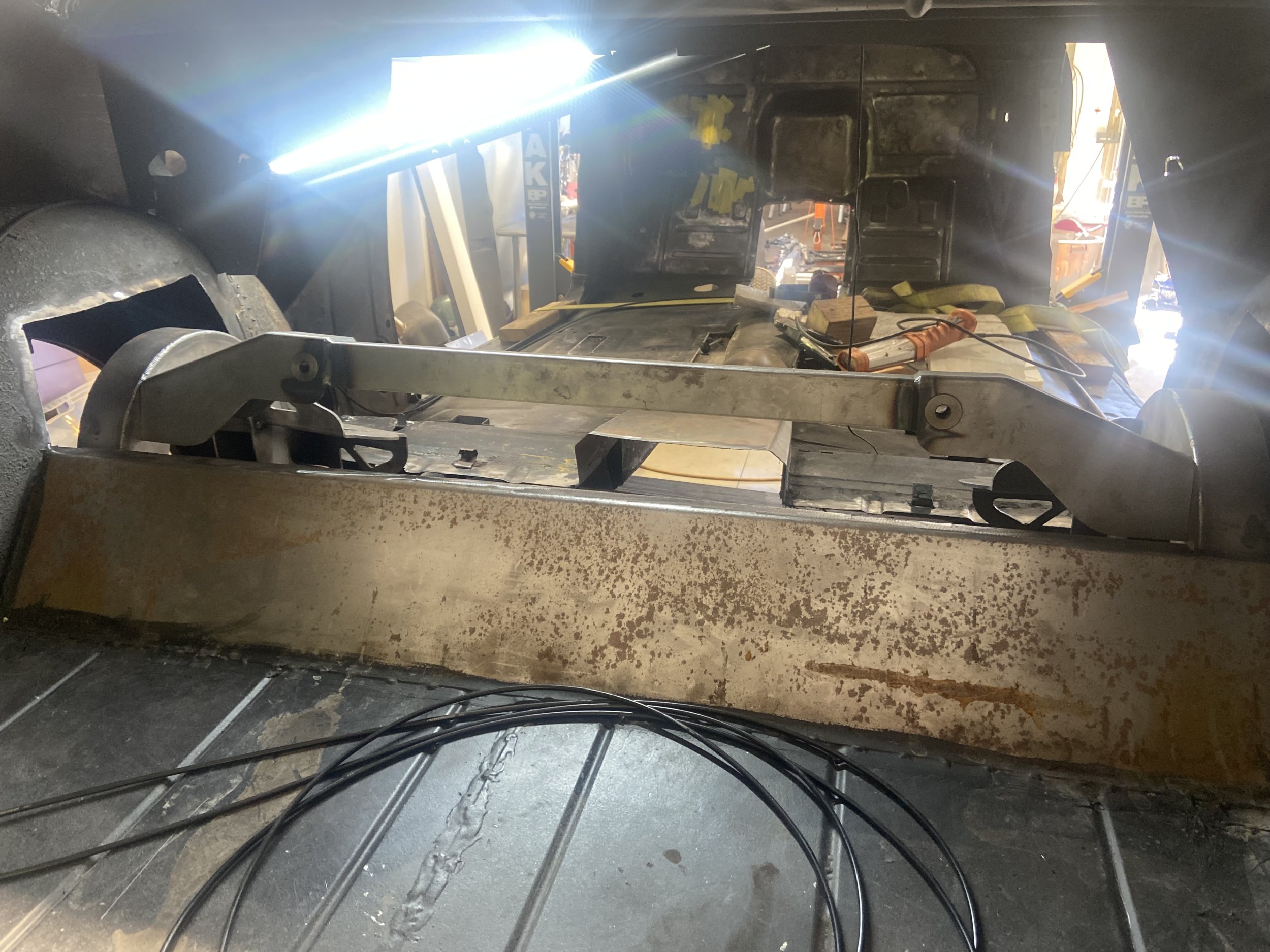

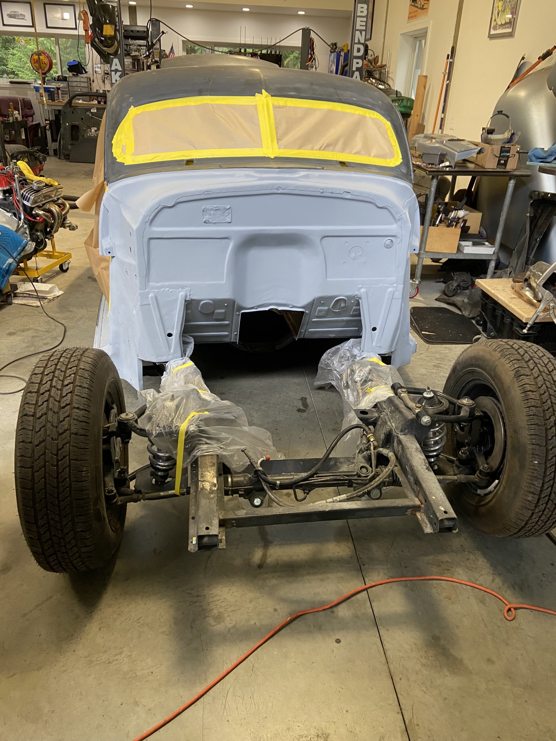

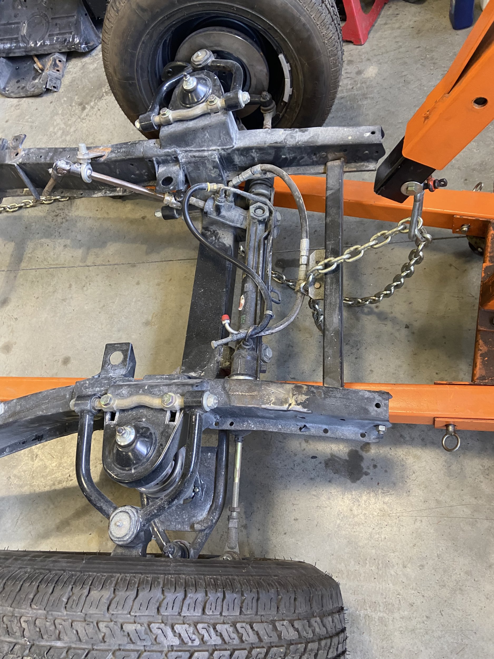

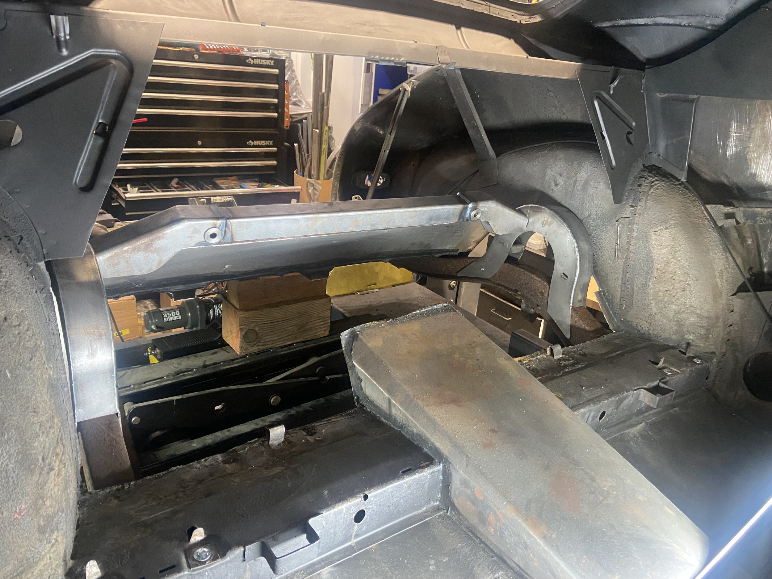

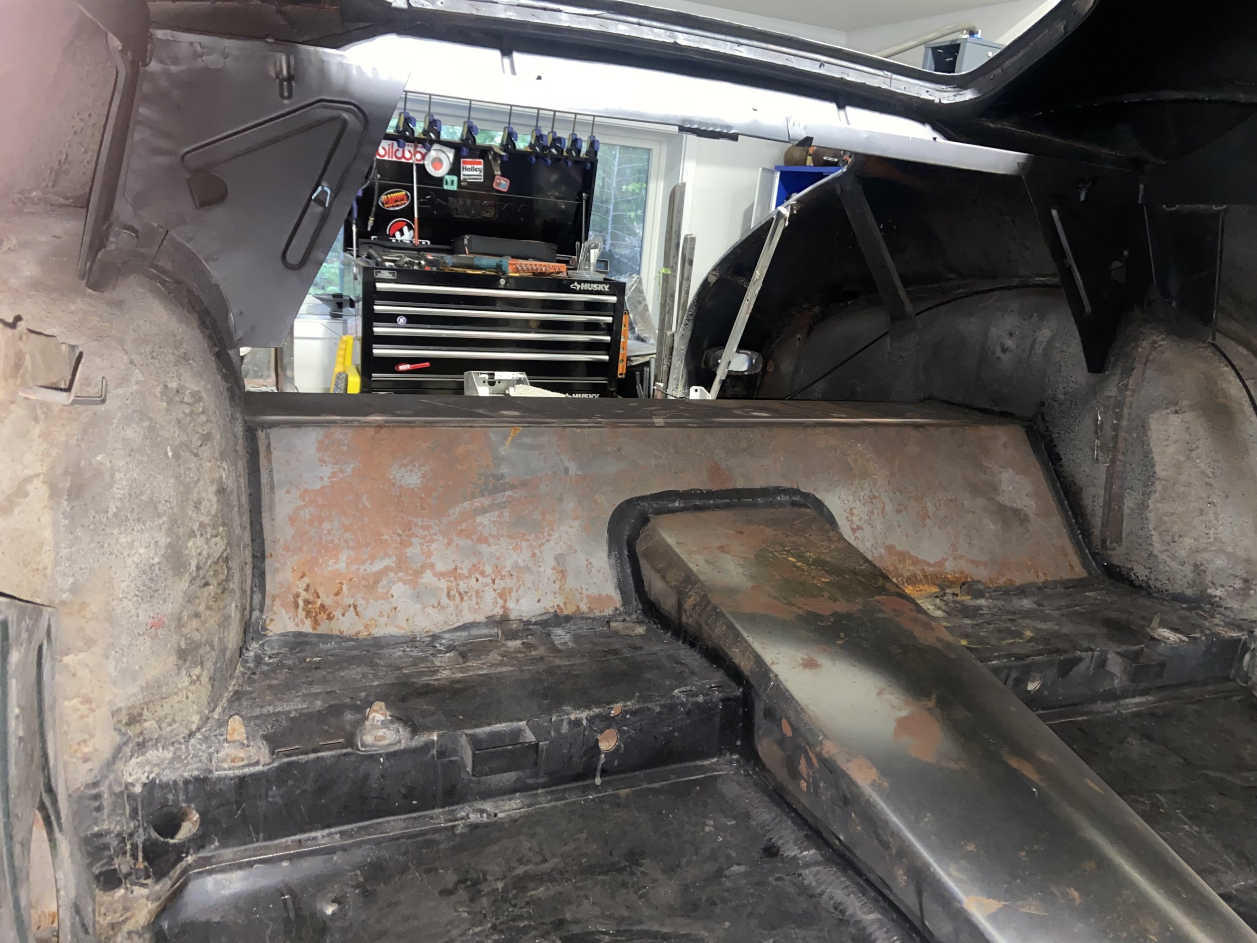

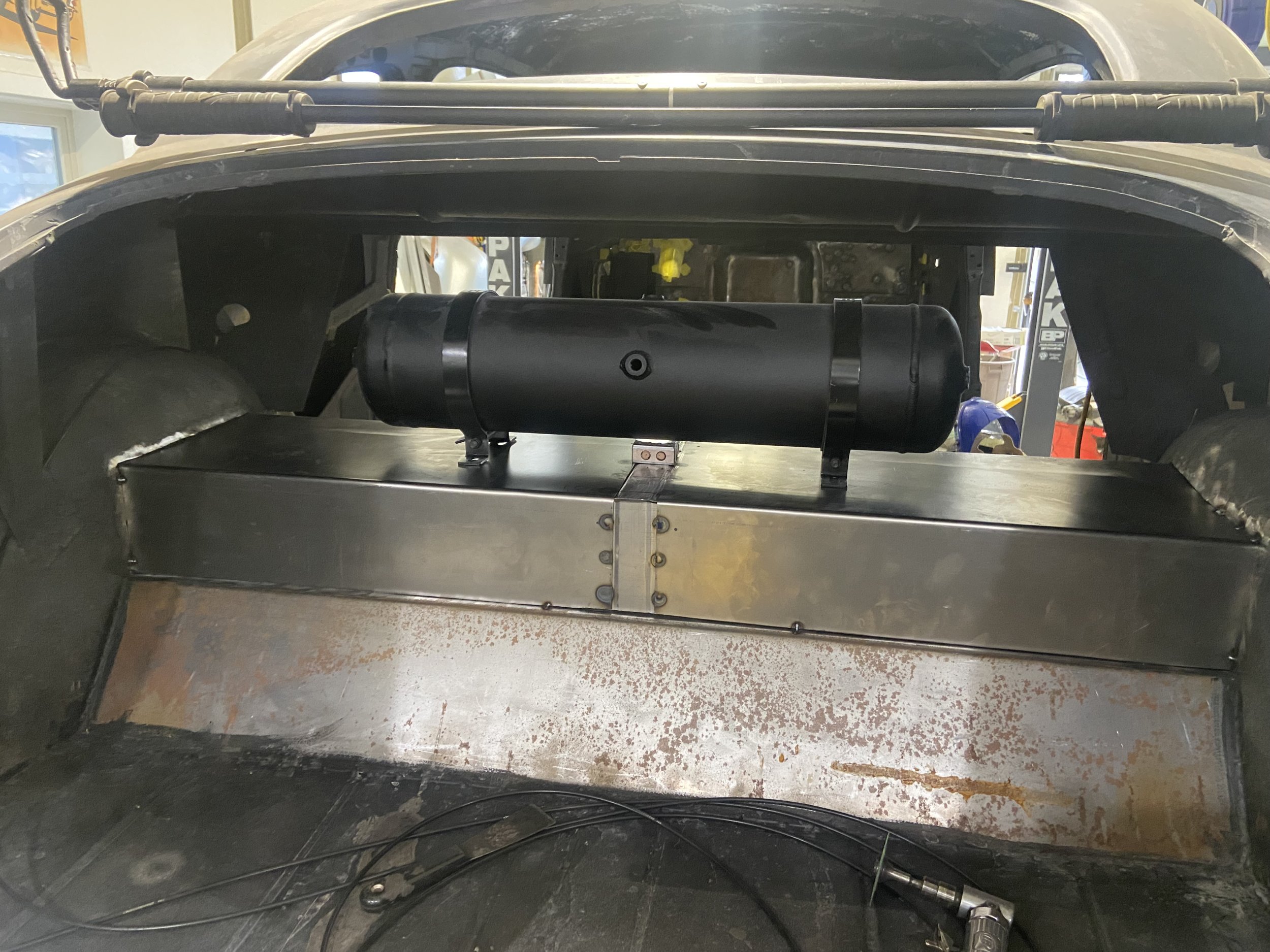

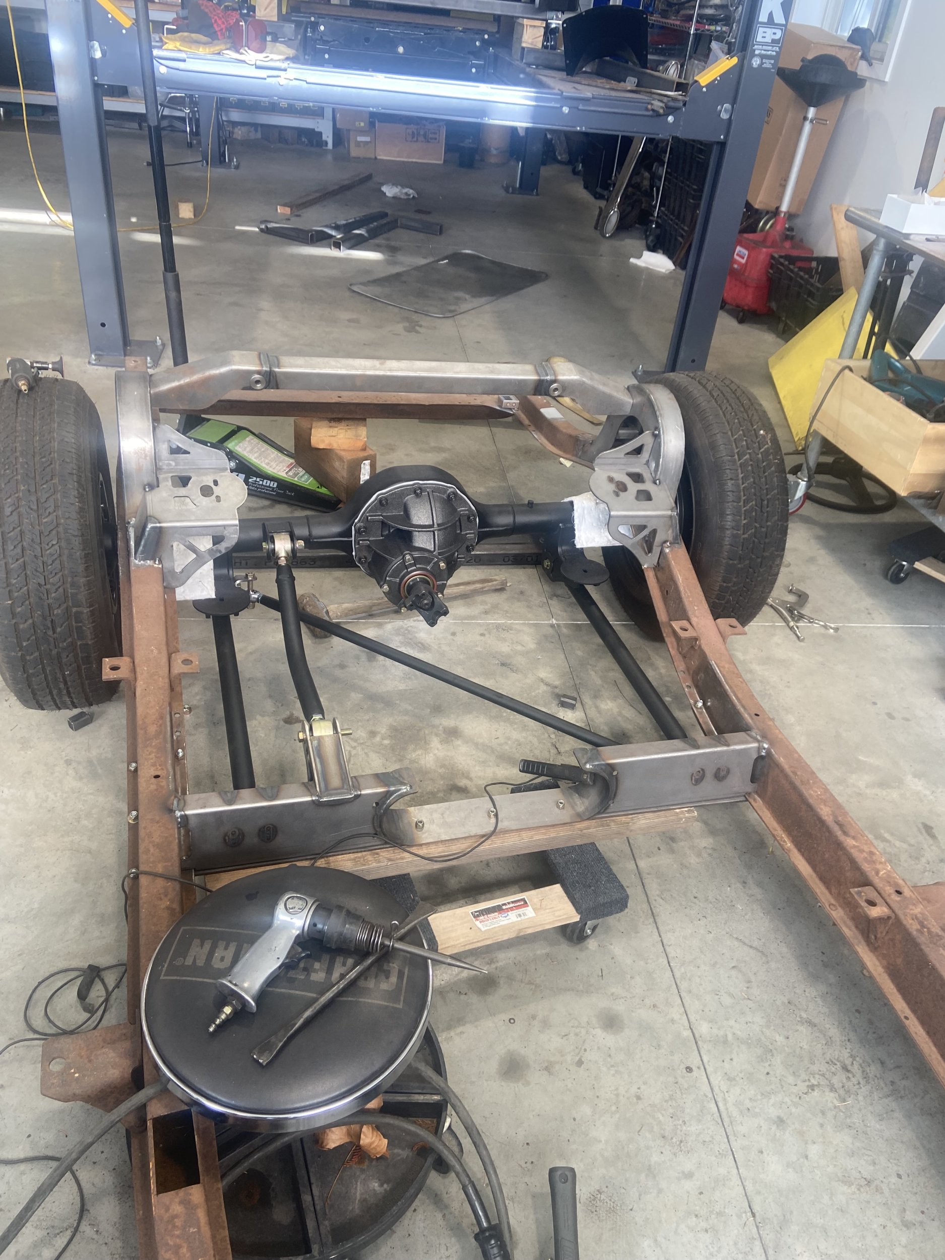

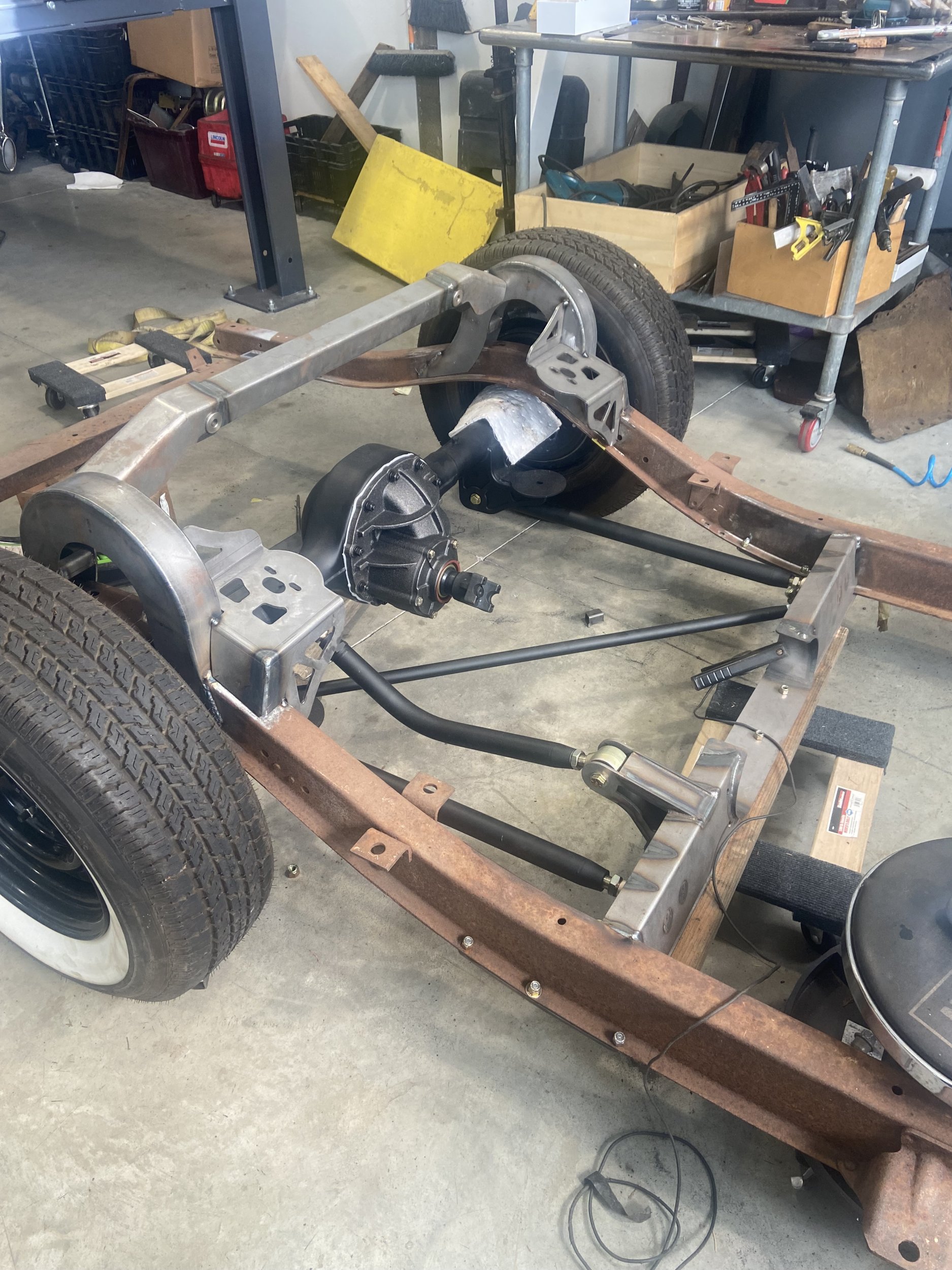

    IMG_3074.jpeg IMG_3188.jpeg IMG_3191.jpeg IMG_3260.jpeg IMG_3266.jpeg 65395174957__BDDFB8F6-8CCB-4914-8C26-75C605C0DD96.jpeg IMG_3453.jpeg IMG_3454.jpeg IMG_3286.jpeg
    I bought the car without seeing it in person, which I previously told myself not to do again (so much for that). I’m not sure it would have mattered or that I would have noticed the bent frame and the crocked installation of the MII.
    Started to fill holes in the firewall, and found a replacement frame.
    I never had a bagged car before and since this is the direction I took, the floor had to be modified to fit the more aggressive C-notch

  25. Russ B
    Joined: Jun 13, 2010
    Posts: 1,626
    Russ B
    I see two different rear notches in the photos. Which one are you using?

    The rounded ones. The square set came with the car (and the bent frame).

  28. 392_33
    Joined: Nov 30, 2010
    Posts: 219
    392_33
    This is how separated the frame from the body with a 4 post lift.
