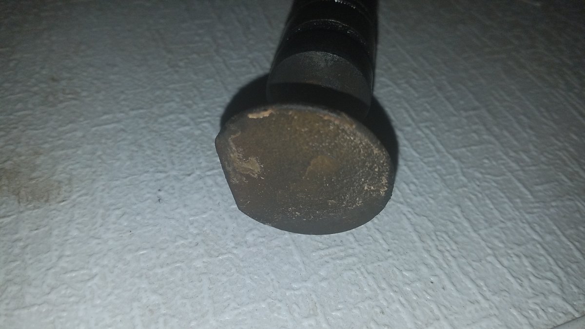

    I think I am going to go ahead and pull the driver side head and see why that hole has no compression. I expect a burnt valve. Better to do it now before I get all the goodies bolted back on and antifreeze, etc. Which of course means intake too if valve is bad. Ohhh Please be just a valve!!

    Today I pulled the drivers side head to see if I was correct in that the exhaust valve on the 3rd cylinder back was burnt. Here are some pics of the valve. Whatta ya think? Just a little grinding and it outta be good huh?
    Tomorrow I am going to see if I can find the valves and guides and stuff I pulled out of a freeze cracked engine some one had completely rebuilt then let it freeze. All new everything. Cam and all. It was from a '51 Ford moredoor I bought that had another rebuilt flatty already in it and they gave me the broken engine too. Ton of good pieces!
    This '48 engine in the '29 Tudor has the later valves and 1 piece guides. I am going to pull the intake valve on that same cylinder so I can clean it up too. The engine has a slight ring ridge but didn't seem to smoke so I am just doing this burnt valve and putting it all back together. I checked clearances on all the other valves and they are fine.
