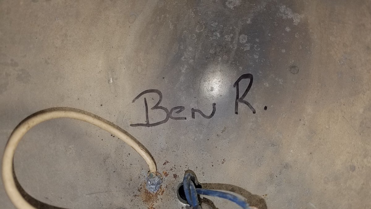

    I finally found another turn signal lens for the BLC 904a headlights on this car! It is chipped and crusty pretty much like the one the car already had so a good match. These lenses were held in with a small spring that wrapped around the base of the lens but those are missing so I went looking for a solution. I thought a nice fat rubber o-ring might work so off to Ace Hardware to find some. No luck. All that were thick enough were too big around. Back to the truck to decide where to try next when I had an epiphany ! I had recently bought a bag of garden hose gaskets and I prefer the o-ring type vs the flat washers and it just so happened I still had them in the truck. Dug them out and shoved one on the lens. PERFECT! They are now installed back in the headlights and the rubber o-ring seals them to the housing as a bonus. Didn't think to take pics installing them but I did find a cool thing while in there. Remember Gordon's friend Ben Rodriguez that owned the car for awhile before trading it back to Gordon, the original builder? He had the headlights chromed and I just found "Ben R." written inside both lights!

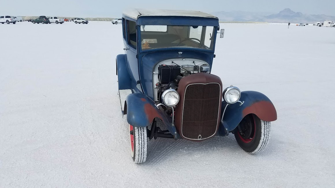

    Made it to Bonneville Speedweek 2018! Took the '29 AV8 this year. Here are some pics from there.
    20180810_151339.jpg 20180812_135835.jpg 20180812_135846.jpg 20180812_135906.jpg 20180812_135915.jpg 20180812_135924.jpg 20180813_105918.jpg 20180813_105939.jpg
    Car ran great except for a few times it boiled the carb over which floods it and makes it not start until it cools off a bit. Wish I would have put the phenolic spacer under the carb BEFORE I went! It was plenty hot there this year.
    Four bucks at the car wash got all the salt off easily. I kept the speed down when driving on the salt and the fenders did their job well. A quick inspection on my lift verified it.

    Damn that thing just looks like it is right at home on the salt! Salt looks awesome, nowhere near as wet and sticky as in recent years. Shoulda woulda coulda , been there myself.
