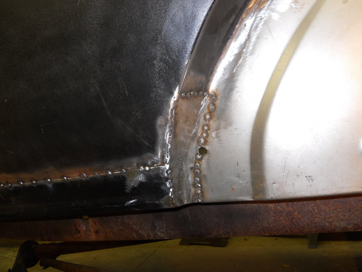

    A little more work done before I have to go to my real job! Welded in the dogleg I fabbed and a lower patch panel on the quarterpanel. nothing finer than flat black primer! jalopy 002.JPG jalopy 003.JPG jalopy 006.JPG

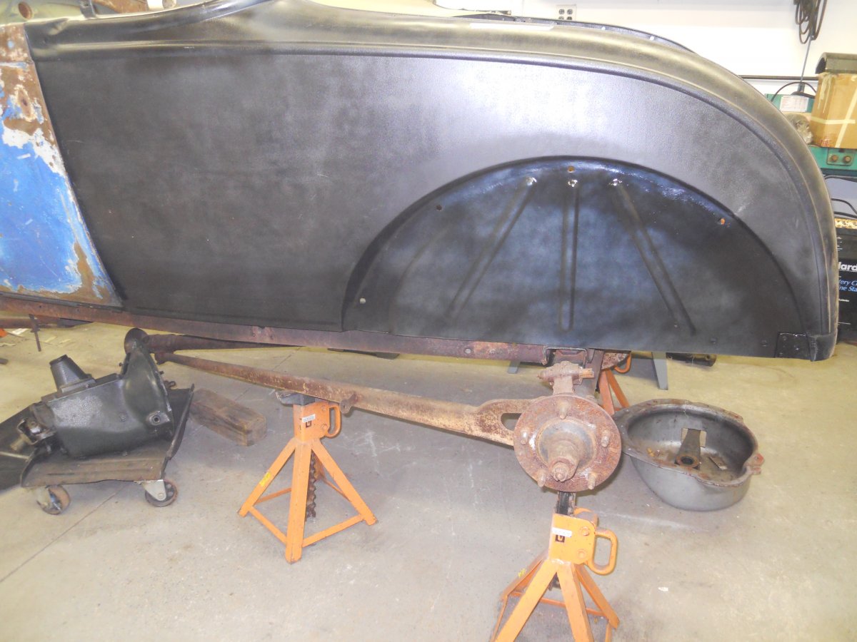

    Here's some long delayed updates..Soo much to list..Took body off frame..blasted everything and painted frame/Suspension components. Had to re-bend my steering arms/drag link ***embly for clearance..De-arched and reversed rear leaf spring..fabbed lower rear sock mounts from some old AMC steering arms..finished putting my Flathead back together,had some clutch fitment issues with the 34 trans I was going to use..I resolved to rebuilding a broken 39 box I had,swapped in a full ge****t from a sideshift box..Once all mounted in,fabbed up the clutch arm..Built a emergency brake bracket to use a 34 brake setup..Plumbed all brakes..re-skinned the drivers side door...Remounted body today,had to modify the firewall for slight interference with p***enger side Offy cylinder head..Body is now bolted down tight.Powder coated wheels added new skins..Building a column drop and chopping the windshield..More to come..TROG Deadline is coming!! modela 003.JPG modela 004.JPG modela 005.JPG

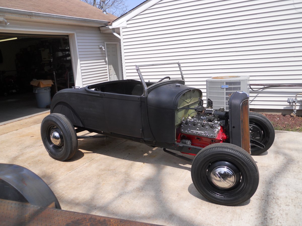

    I was able to get the windshield done..Chopped 2" and leaned back..Add a 32 Shell and its beginning to look like a real hot rod! modela 002.JPG modela 003.JPG

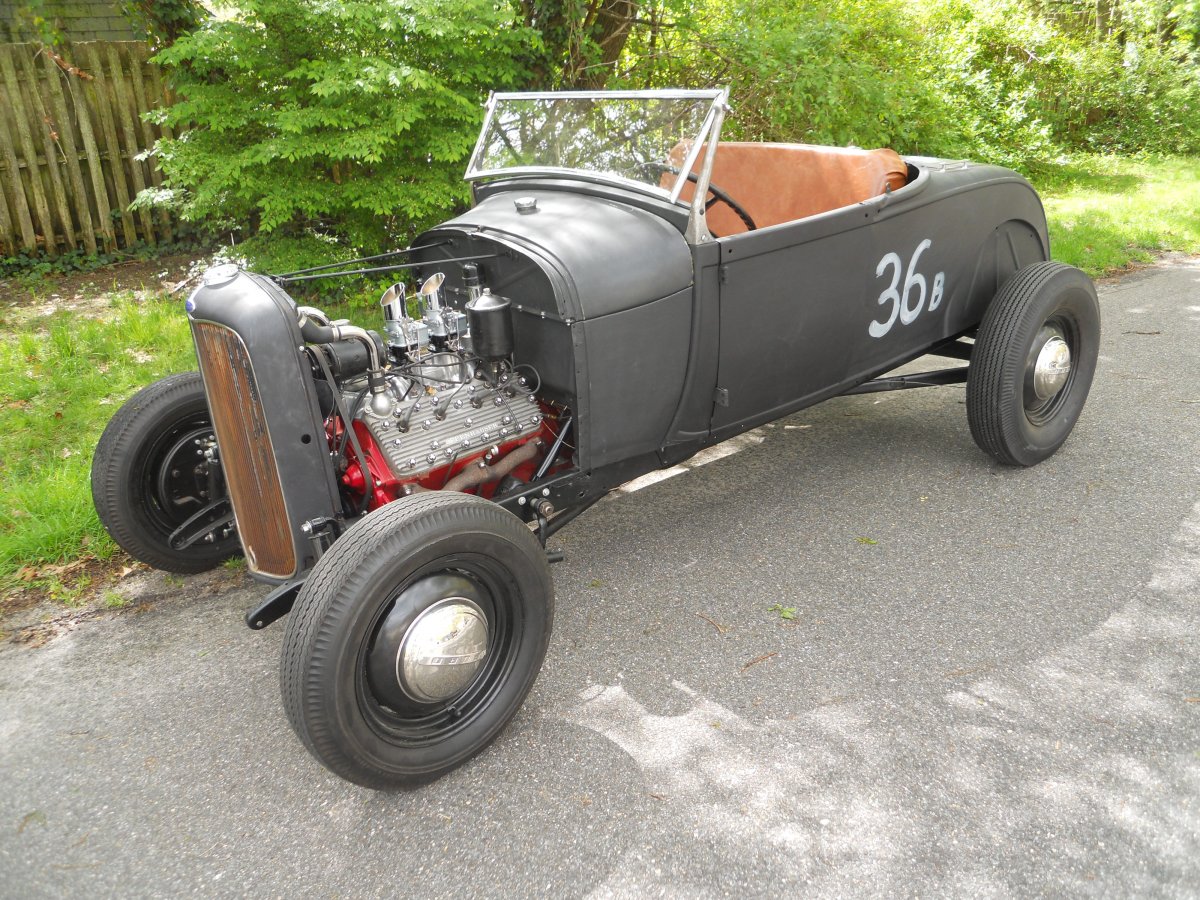

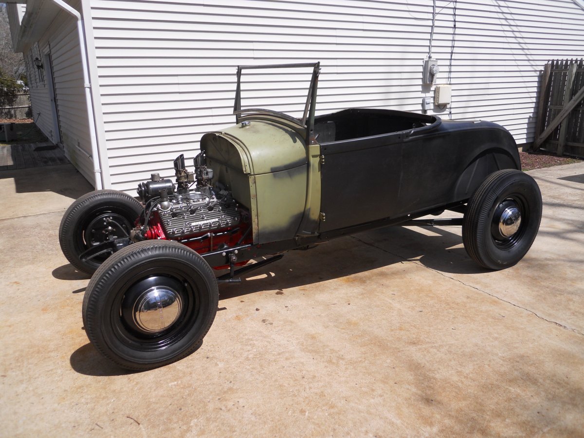

    Spent the day building a custom column drop out of aluminum..I don't have any machining equipment,it was all with a band saw and a drill press..Also built some radiator mounts. .Pushed it outside for some shots for my TROG entry photo..Fingers crossed! drop 001.JPG modella 002.JPG

    It will Wyatt..Didn't have time today to paint numbers on it..

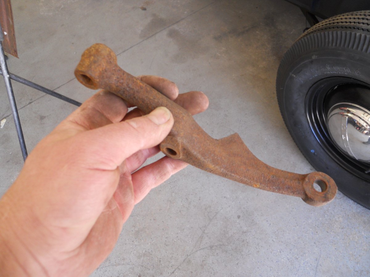

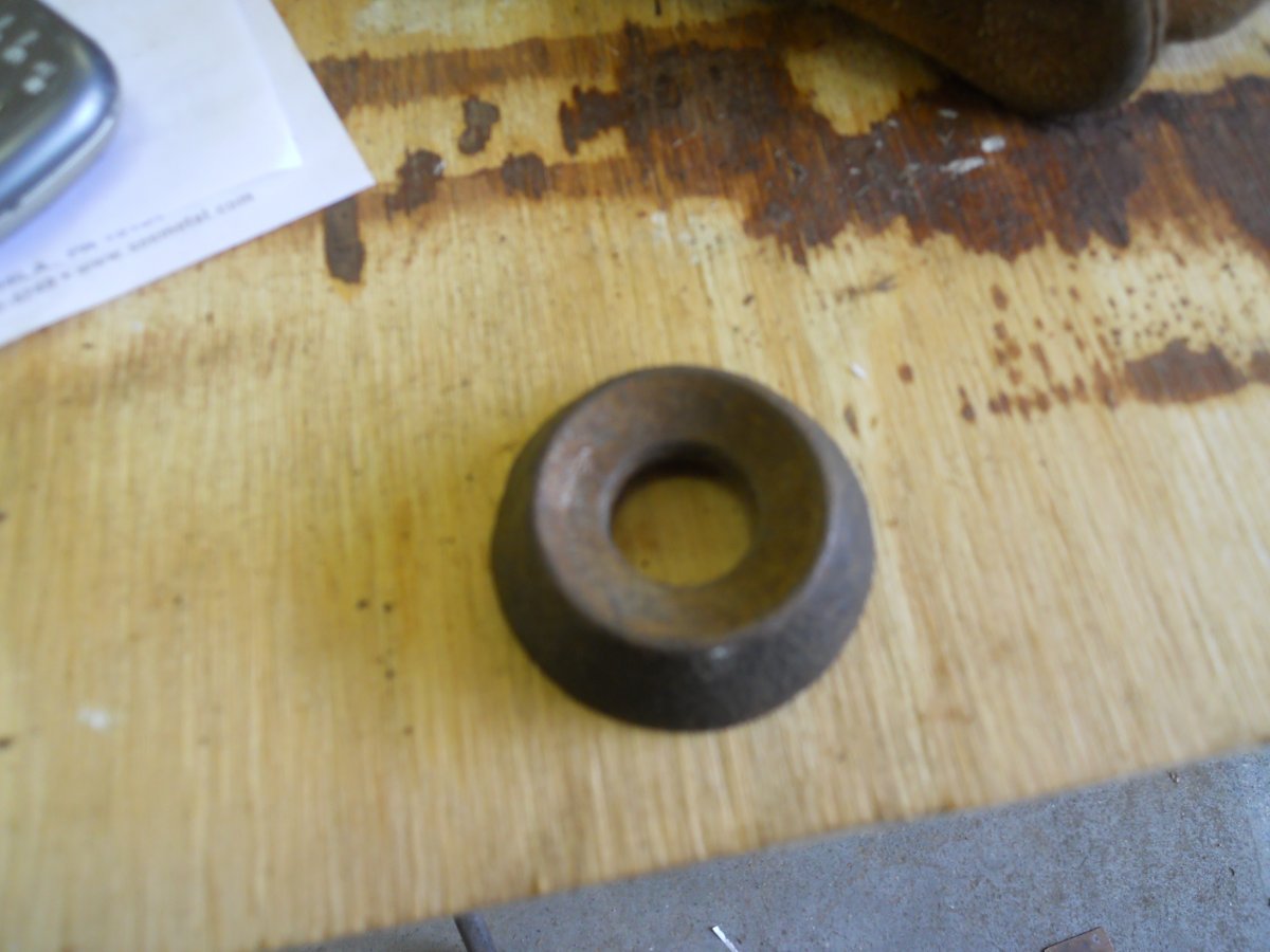

    Like most car guys,I have a hard time throwing any old car junk away. Here's a good reason why I hoard all kinds of leftover bits from previous jobs and projects. First, I was looking for a set of lower shock mounts for the rear of the car. I very nearly bought a set from a few sources but after awhile I started looking around to see what I could make a set. These were a set of steering arms from an AMC Rambler..Cut down,reshaped and added some shock studs..Got a set of shocks coming that will work just fine. modellaa 005.JPG modellaa 007.JPG

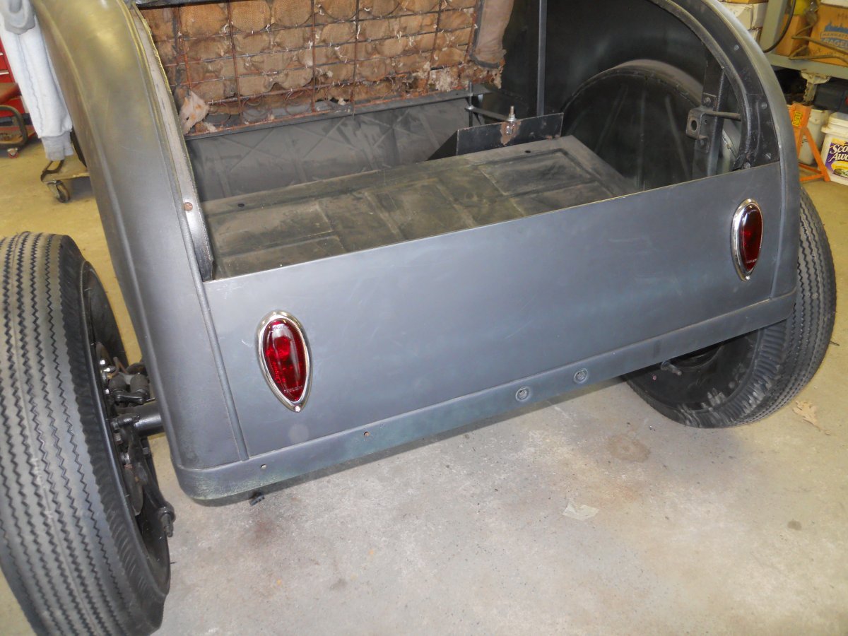

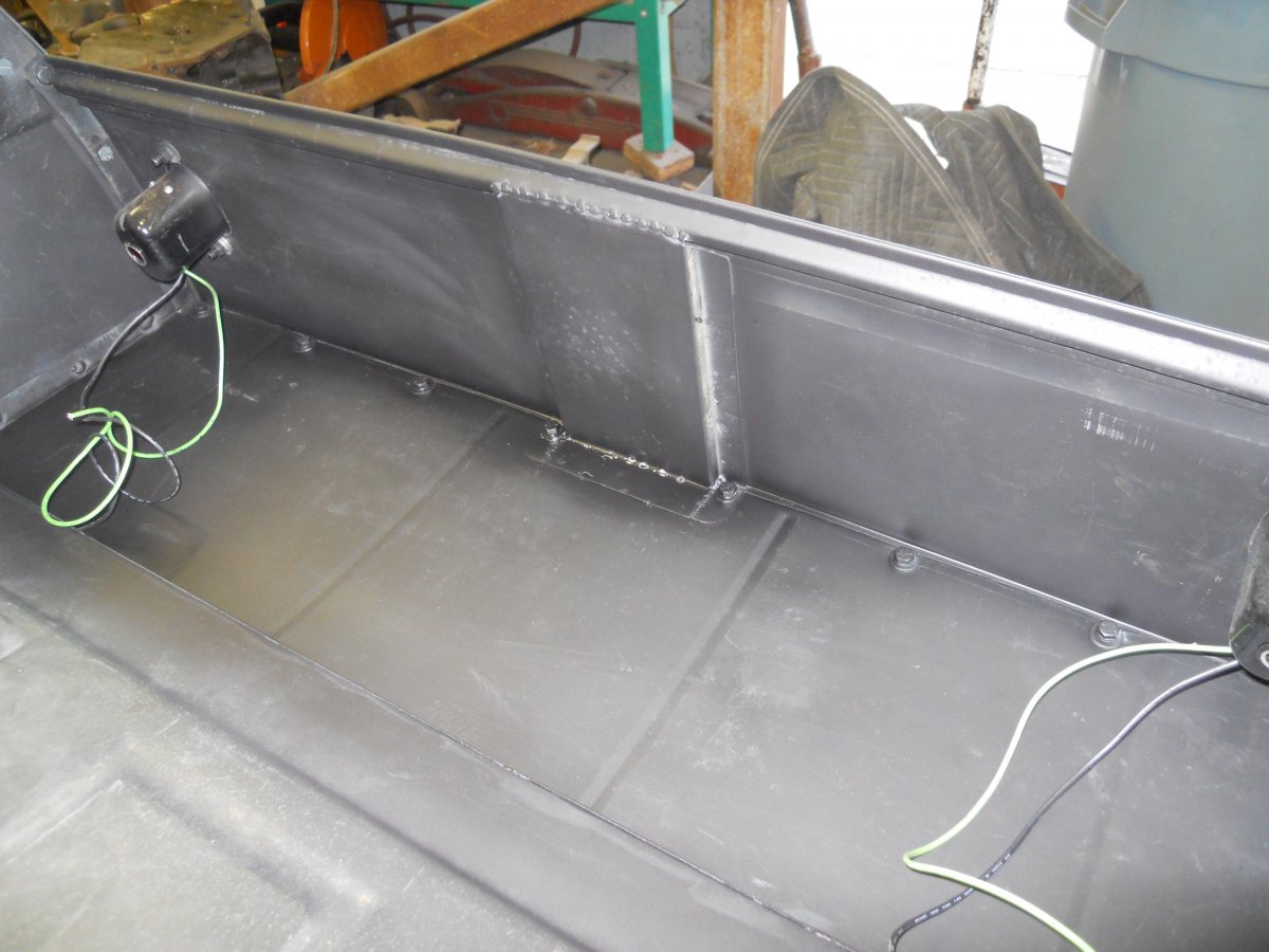

    Went with a set of 39 teardrop lights..Kinda cliche' but I always liked the look of them..Also, they were leftovers from another project so I used them..Couldn't use the original curved inner trunk pan with the lights so I fabbed up a rear pan and lower panel brace. modellaa 002.JPG modellaa 001.JPG

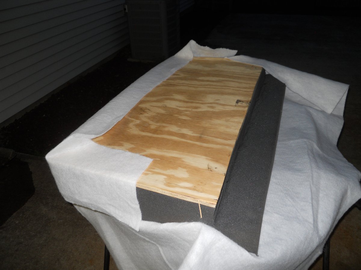

    Got some woodworking done on the little roadster..Made some cardboard templates and cut some floorboards out of 1/2" plywood..Little polyurethane and stain to seal them up..Also,made some seat bottom and back from same plywood..Bought 5" high density foam off epay for 20 bucks and shaped some seat pads..Cut it with a common serrated knife and shaped with a hand grinder..Nice and comfy!..Looking for an old leather couch to cover them with..If not,Mexican blankets will suffice! modela1 002.JPG modela1 003.JPG

    Nothing to show, Wyatt..it was something I've had at least 20 years and never used...Its a speedway item and it fit perfectly..I couldn't get a Ford throttle to work so this one is getting used FINALLY!

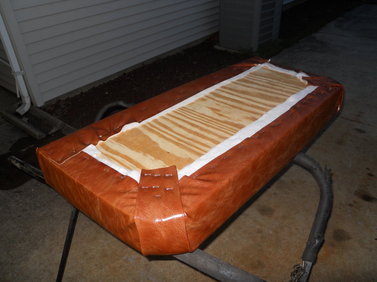

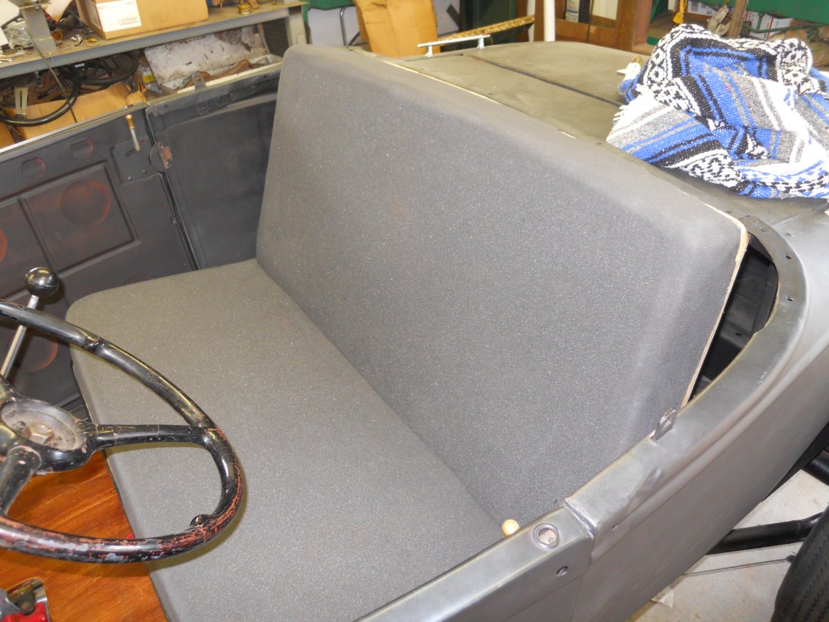

    Got some material to cover my home made seats..Let me just state right now,I'm no upholsterer! I picked up some cotton batting to soften the edges.. started the cutting and slicing.. seat 004.JPG seat 002.JPG seat 006.JPG

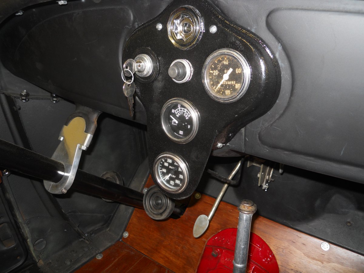

    Some more updates..Got the motor fired up and actually moved under its own power!! The brakes unfortunately are a little spongy so I have to bleed them out some more and re-adjust. I modified the stock 29 dash cluster so I could mount some SW gauges..Added a "chin" to it so I could have the three essentials,Oil Pressure,Water Temp and Volts..Fuel gauge is a stocker. 009.JPG

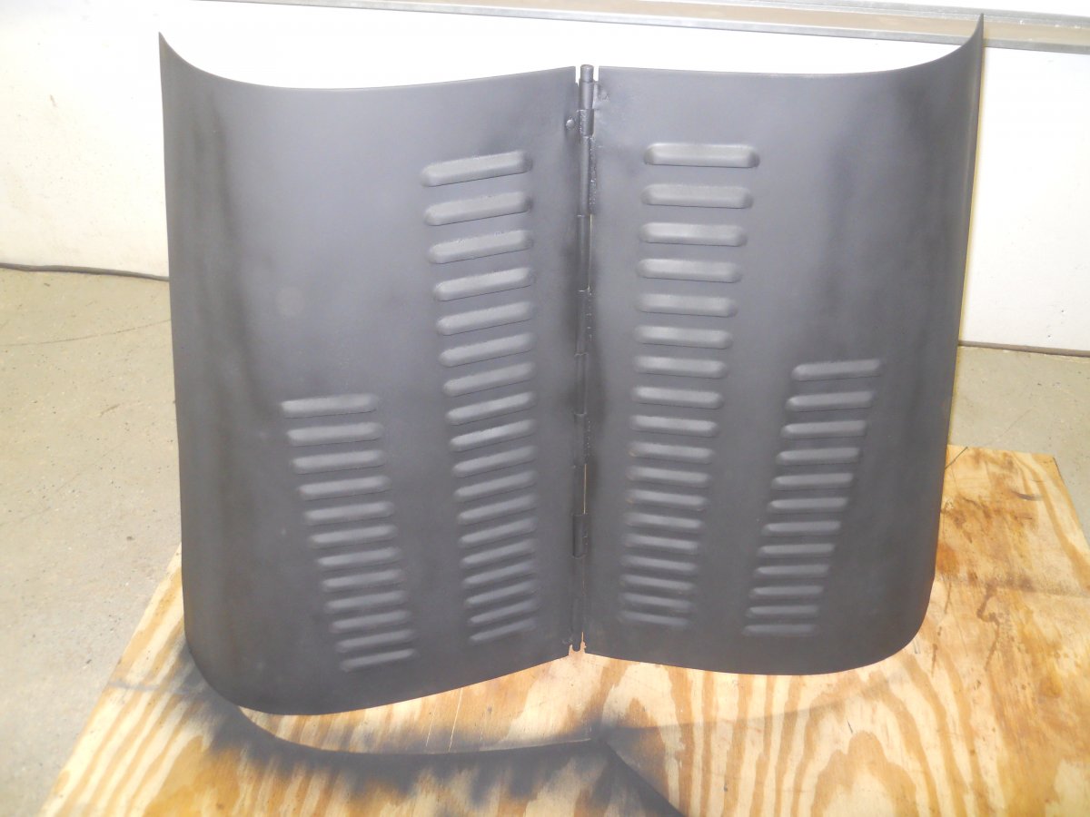

    I really want to run a full hood so I started looking at making the stock 29 hood fit..It took some cutting and t******* along the rear edge because the 32 grille is slightly higher than the 29 cowl.Its a little off but not bad so I'm going to run with it..As I was stripping the old paint off I came across some writing on it..The Bush'man...This car was an old hot rod so I can only wonder who the Bush man was..I'm thinking about putting the lettering back on as a tribute to the cars previous owner..
    Oh, and I punched some louvers in it for some hot rod flavor. Gonna work on the side panels tomorrow ..Got my number for TROG! and see if I can get them to fit. 001.JPG 004.JPG 008.JPG trogracer 001.JPG
