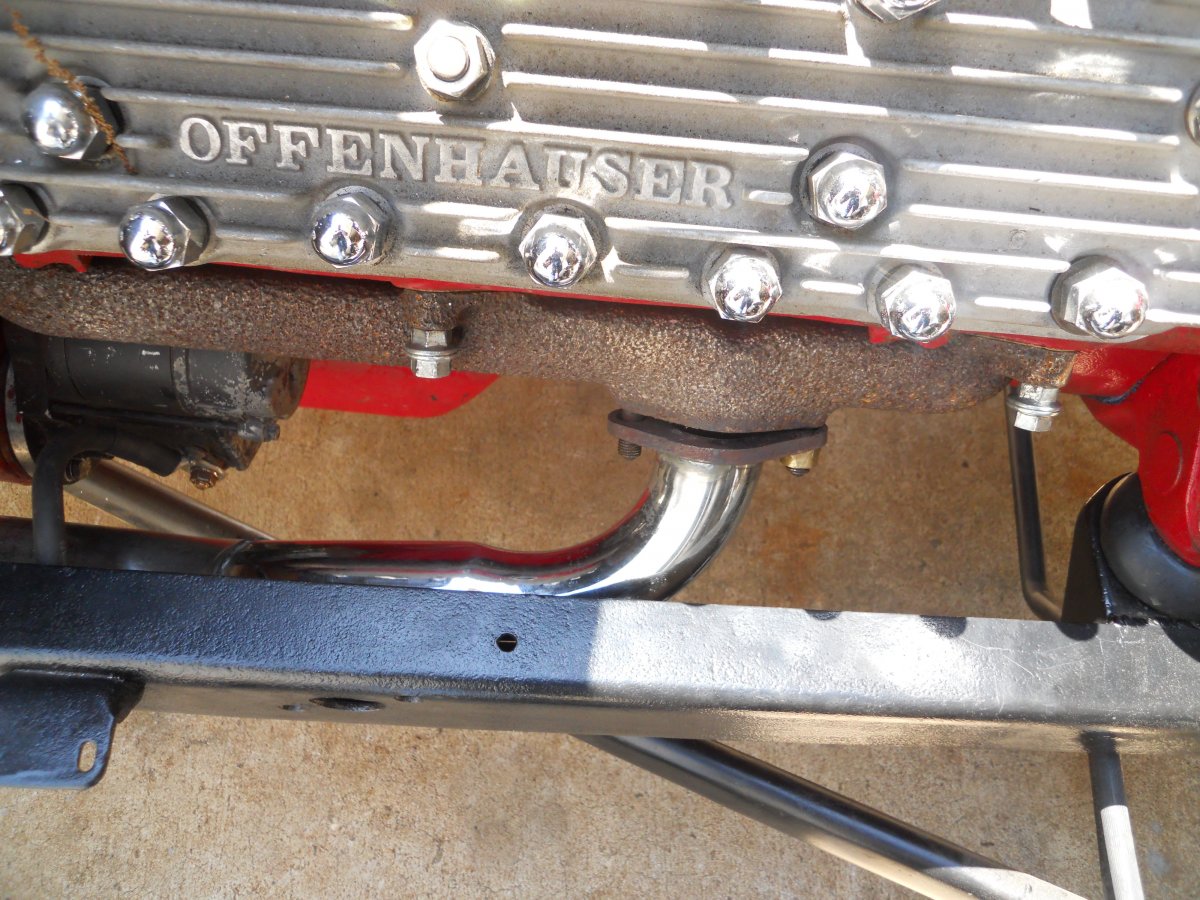

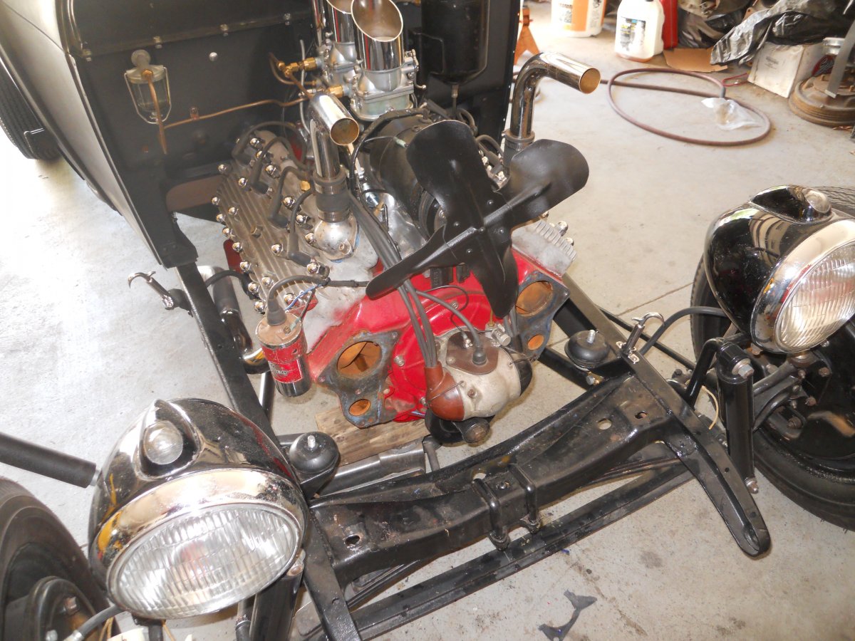

    Progress continues..Got my radiator back from the shop and it should be leak free..Turns out,a stock 32 rad has rivets in the lower tank that attaches to the lower brace.. Those rivets were all leaking underneath so major surgery was needed..Cut the brace out,repair the whole lower tank and replace the brace..
    I decided to run a full hood,like a lot of the salt racers did for less wind resistance. So,to that end,I'm going to stick with stock manifolds for now and added a set of exhaust dumps. Once again,in my pile-o'-junk ,I used the s****s of the Corvette chrome exhaust pipes to make some shiny head pipes.. manifolds will get painted with high temp paint...
    After playing with about 4 different generators,I was able to put one together that works. As a result I could finish wiring up the voltage regulator. All under the seat to hide it because I'm not sophisticated enough to get cloth covered wiring yet.

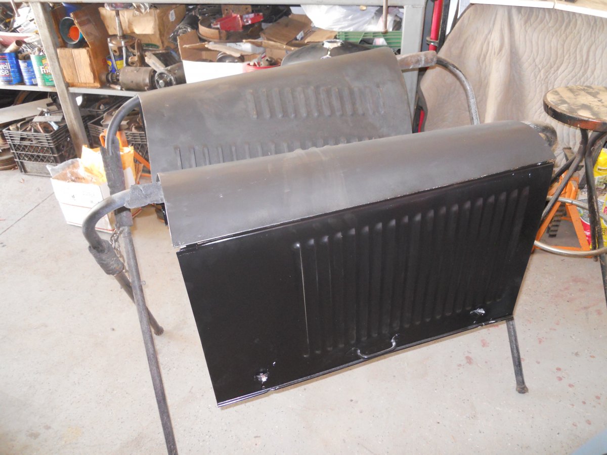

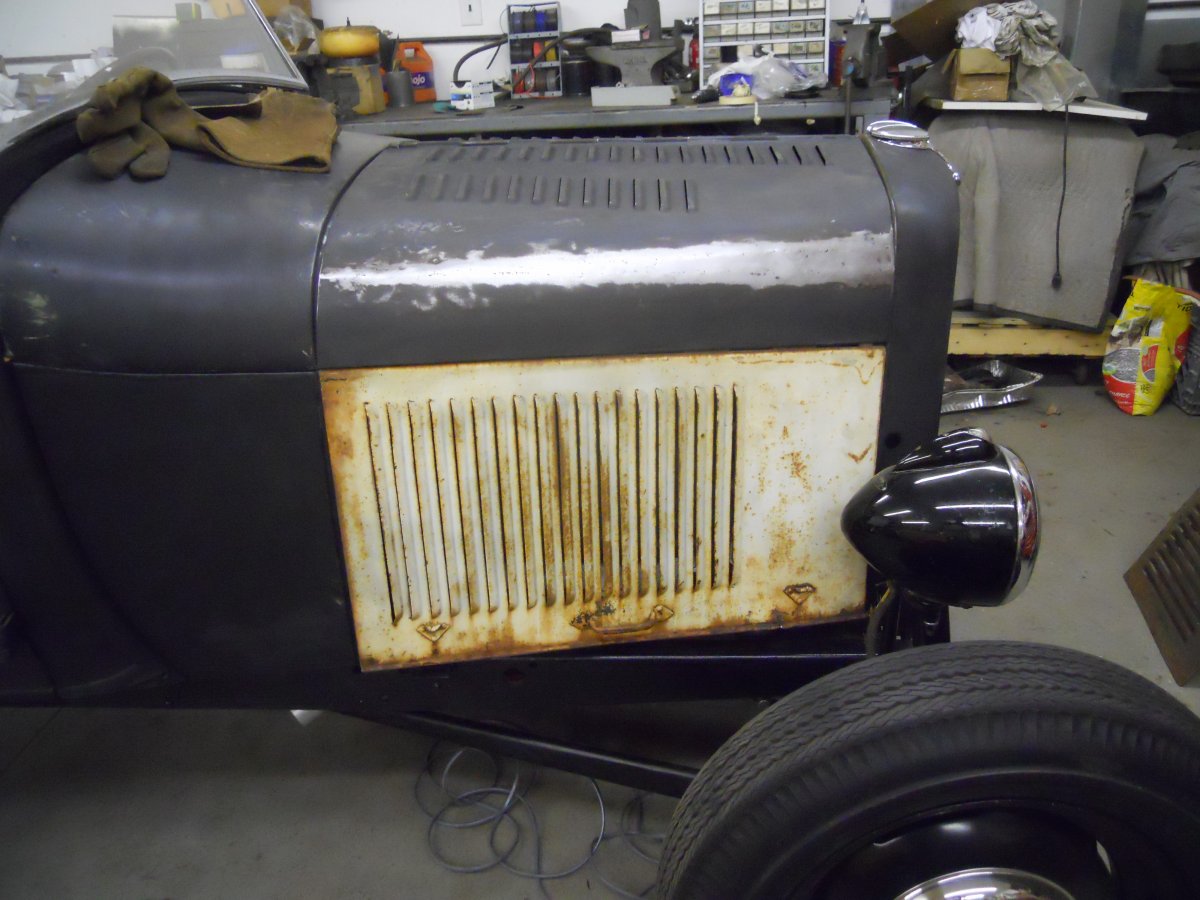

    Cutting and splicing the hood today. The hood sides just didn't look right with the slight uphill slope of my hood. There was just no way to make them fit so out with the sawzall and pie slice the hood! Added a filler piece,ground smooth. radster 002.JPG radster 005.JPG radster 006.JPG radster 007.JPG

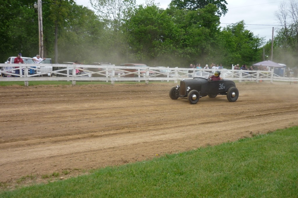

    More shots at speed..I'm very happy with how she runs and looks considering it was put together in such a short time..
