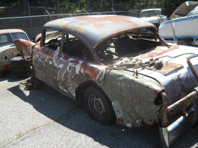

    DSCN6172.JPG ya doin' good - saw a project today that should make you very proud of yours
  18. 4psi
    Joined: Nov 30, 2011
    Posts: 298
    4psi
    Ouch....poor car!!

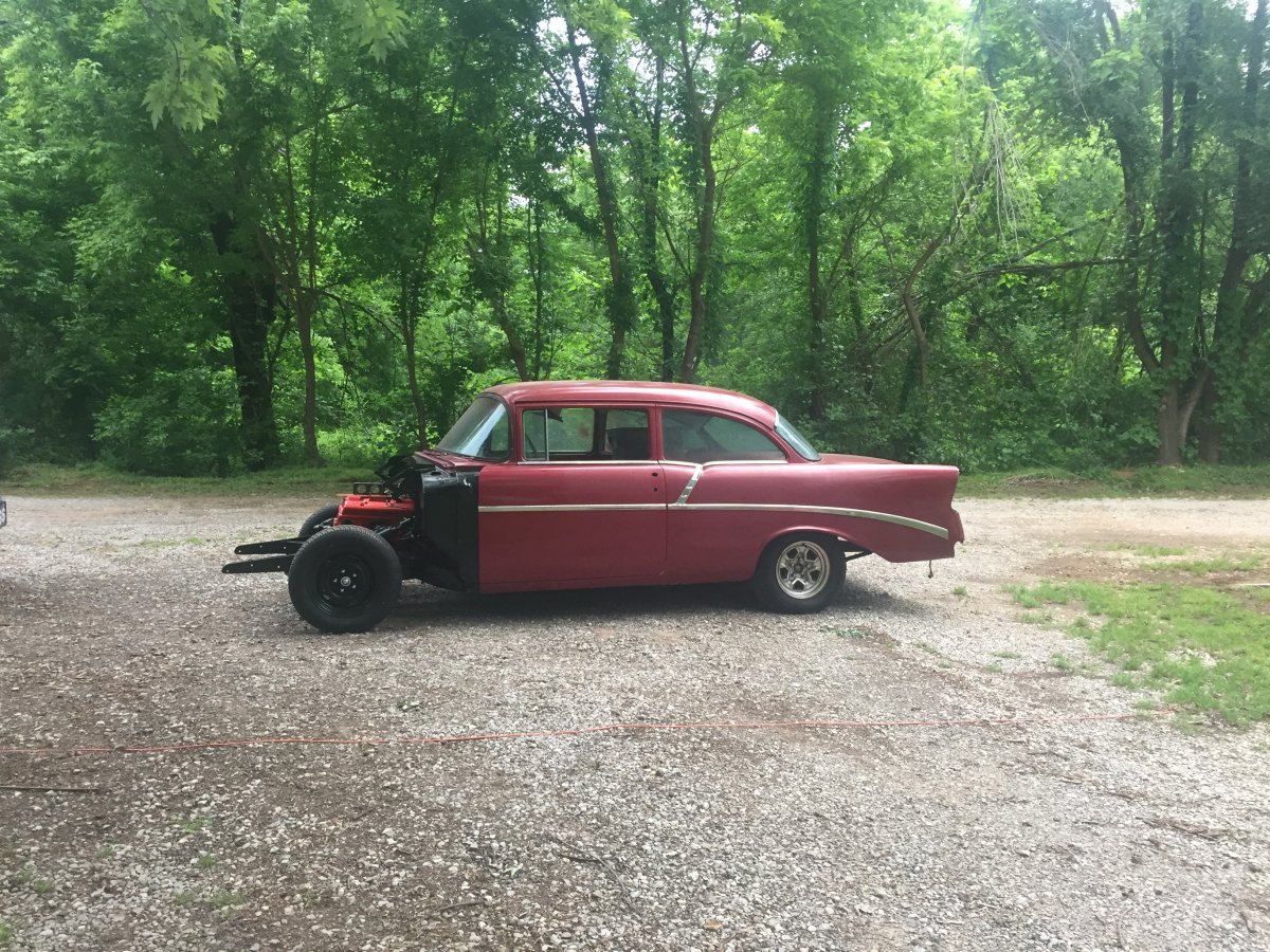

    This is supposed to be 3.5 " lower in the front. It has 2inch spindles and 1.5" springs now. The rear springs are posie super slide 3 inch lowering springs.
    It looks like a 4x4 to me. Gonna have to do something about this.

    Once you get all the front end sheet metal on it you'll change your opinion about the stance. You're missing the battery, coolant, radiator, etc and all the will weigh the front end down. Same goes for the rear of the car, get the interior in there and it'll look better. Those front benches aren't exactly light.
    Don't do anything until you get all of the finished car's weight on the suspension. You might be short by 800 pounds at this point, according to your picture.

    Just stand 3 buddies on them frame horns and 1 big guy on the back, that'll be more like how it will sit. :D

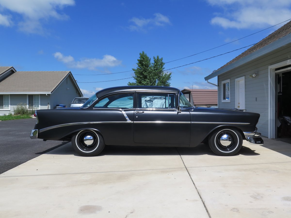

    Draggin GTO is right, get it all together before you spend too much time getting the height right. My '56 has the same stuff you have spindle and spring wise. It had 2" blocks in the back with the Posie's springs, it looked good but it pushed the driveshaft yoke into the trans til it bottomed out. I have 1" blocks in there now and only 1/2" of yoke stroke. My motor is mounted on the stock front mounts, when I swap motors I will put in side mounts and when I'm all done I'll check to see if I need to shorten the driveshaft some. Also my Posie's springs are wimpy, I'm going to add 1 or 2 long leaves to it to stiffen up the rear some. Put anything besides the car cover in the trunk and it hits the ground.
    Mine had 17" wheels and 45 series tires when I got it. Sorry, just not me. I'll keep playing with tire sizes and suspension til I get it the way I want it. It's a little high right now but it has to be due to the driveshaft. Also those are 75 series tires on 15" wheels. I'm shooting for a 1962-64 look for mine in the end. It'll be all red eventually with the engine dressed up like a Corvette 340 hp 327, white headliner and factory style black and white upholstery.

    I will take your advice....but just so you know, I am dying to make it lower immediately lol.
    That has already been done! Notice the shoe prints on the front frame rail in one of the photos above? I was bouncing on it while commanding it to go lower.
    Thanks for the info on your drive shaft. I wonder if I am going to run into a similar ordeal. I have a m21 4 speed. I will make sure to pay attention the drive shaft length. Your car looks great. My plan is to run 15in original style wheels with the 56 small caps. I think that will look nice with a low stance. I am not sure what year or what time period this style of build would be considered. I am just kind of winging it here. My preference is stock appearance, stock interior, but way low. I really like the idea of 340 hp 327.

    Cut the stock coils. One wrap is roughly 2". Sneak up on 2 wraps.
