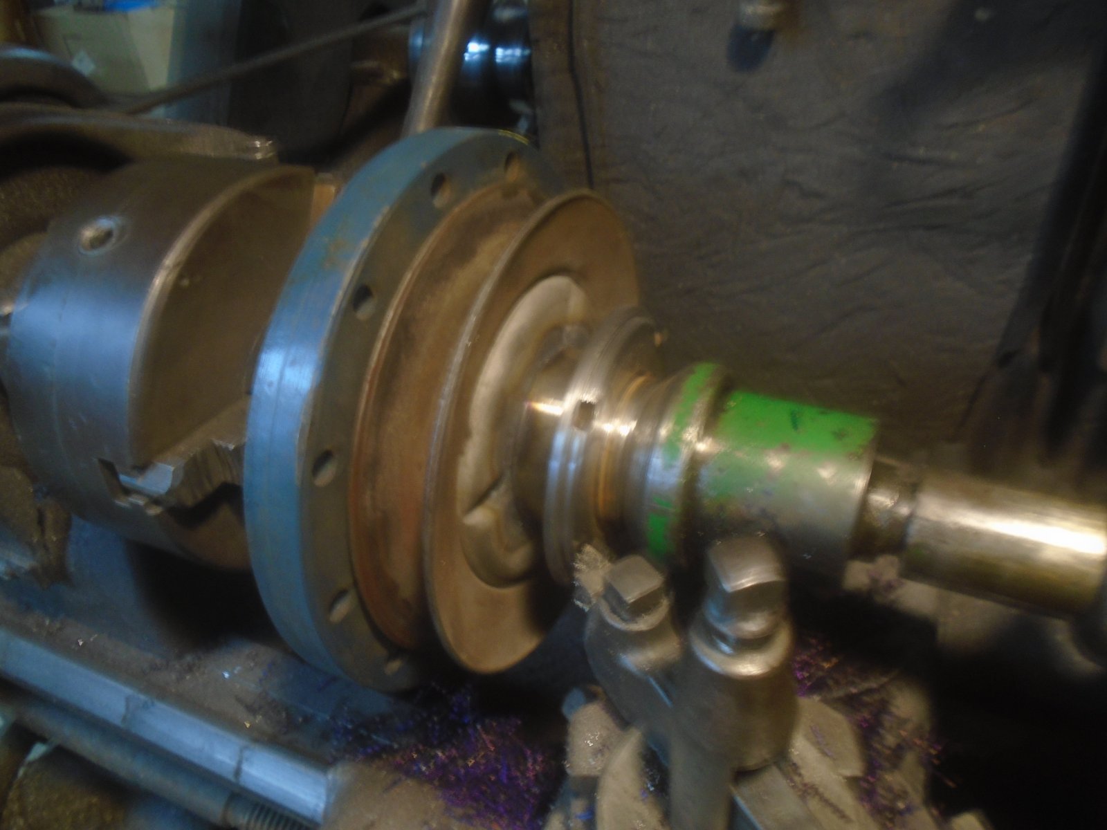

    The piece of aluminum for the crank adapter came in so I started working on that.
    The one side is faced off and a counterbore is machined into it so it will fit over the end of the crankshaft.
    Then it is turned around and a boss is turned down for the Chevy flex plate to fit onto. A counterbore is cut into the center for the torque converter to fit into.
    Checking the fit on the torque converter.
    And on the flex plate.
    The adapter is put back on the lathe and a hole is bored thru the center.
    This bored hole in the adapter is the same size as the pilot hole in the Ford flywheel.
    The flywheel is set on top of the adapter and a pin is pushed down thru it and into the adapter to line the two parts up.
    Then the four mounting holes are marked in the adapter with a center punch.
    With the mounting holes marked on the adapter, I can now drill them out.

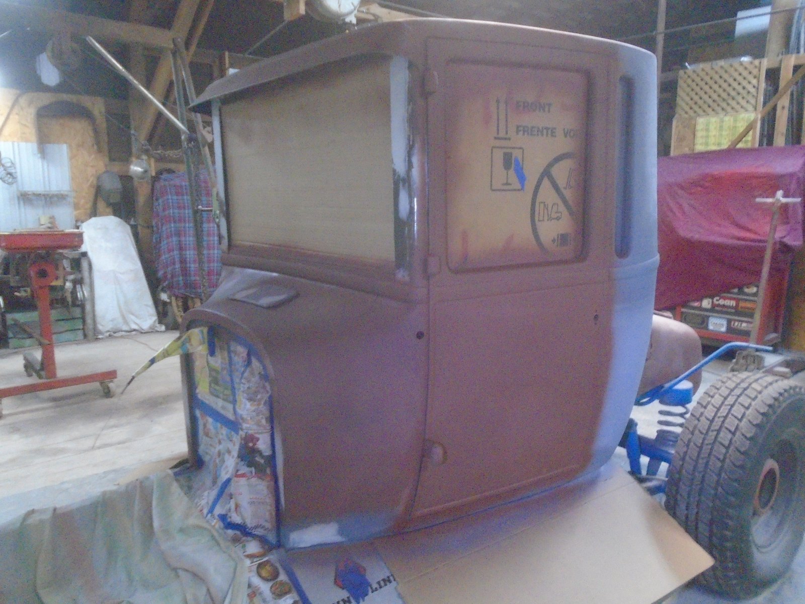

    Working with old metal ( in this case, almost 100 years old ) I like to use Rust-Oleum red oxide primer for the base cote. This is an oil base paint and I have learned that body fill doesn't like to stick to it.
    Glazing putty is a lacquer base and trying to use that directly on the red oxide primer will imediantly soften the primer.
    I let the red oxide primer dry good ( usually overnight ) then I spray regular lacquer gray primer over it and the gray primer sticks really well to the red oxide primer.
    I let the gray primer dry for a couple of hours and I've found that I can then put body fill over it and use glazing putty with no problems.

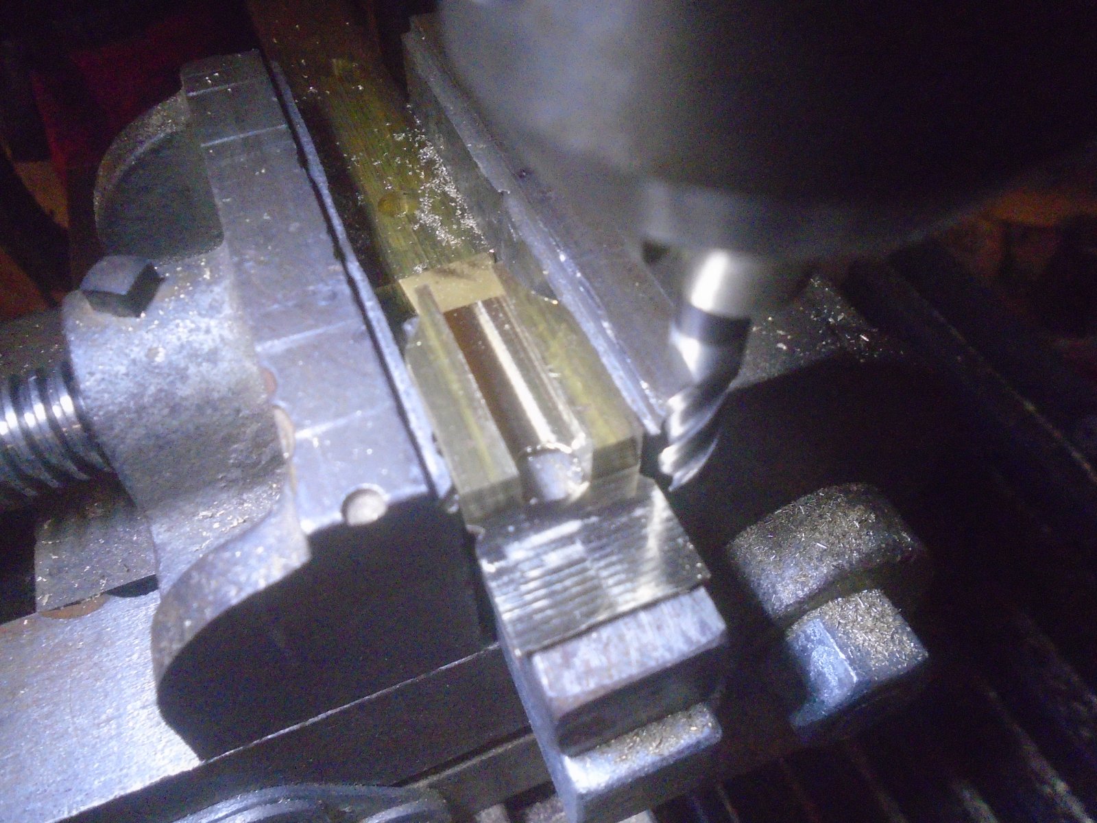

    It will be made out of this piece of brass stock that is just the right width and thickness.
    After the pattern is scribd on the brass, it is set up on the mill and the outside curve is milled into one side.
    Turn it around and mill the other curve.
    Using a Dremel tool to smooth the sides and check my measurements.
    Back on the mill and start cutting the center out.
    The center is milled down to the correct thickness and the flat end is finished.
    Then I start milling out the rest of the center area.
    Finished.
    And painted.

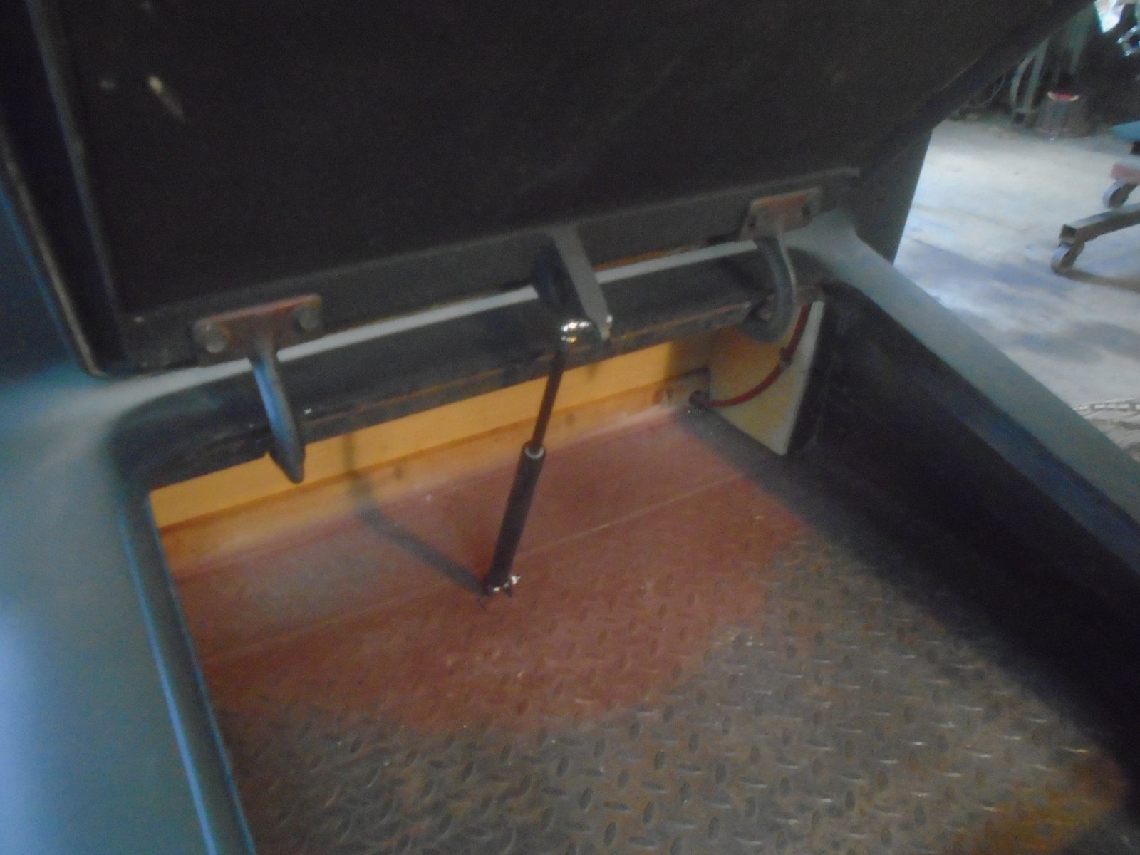

    The handle is mounted on the trunk.
    And the gas spring is mounted inside to control the trunk lid.

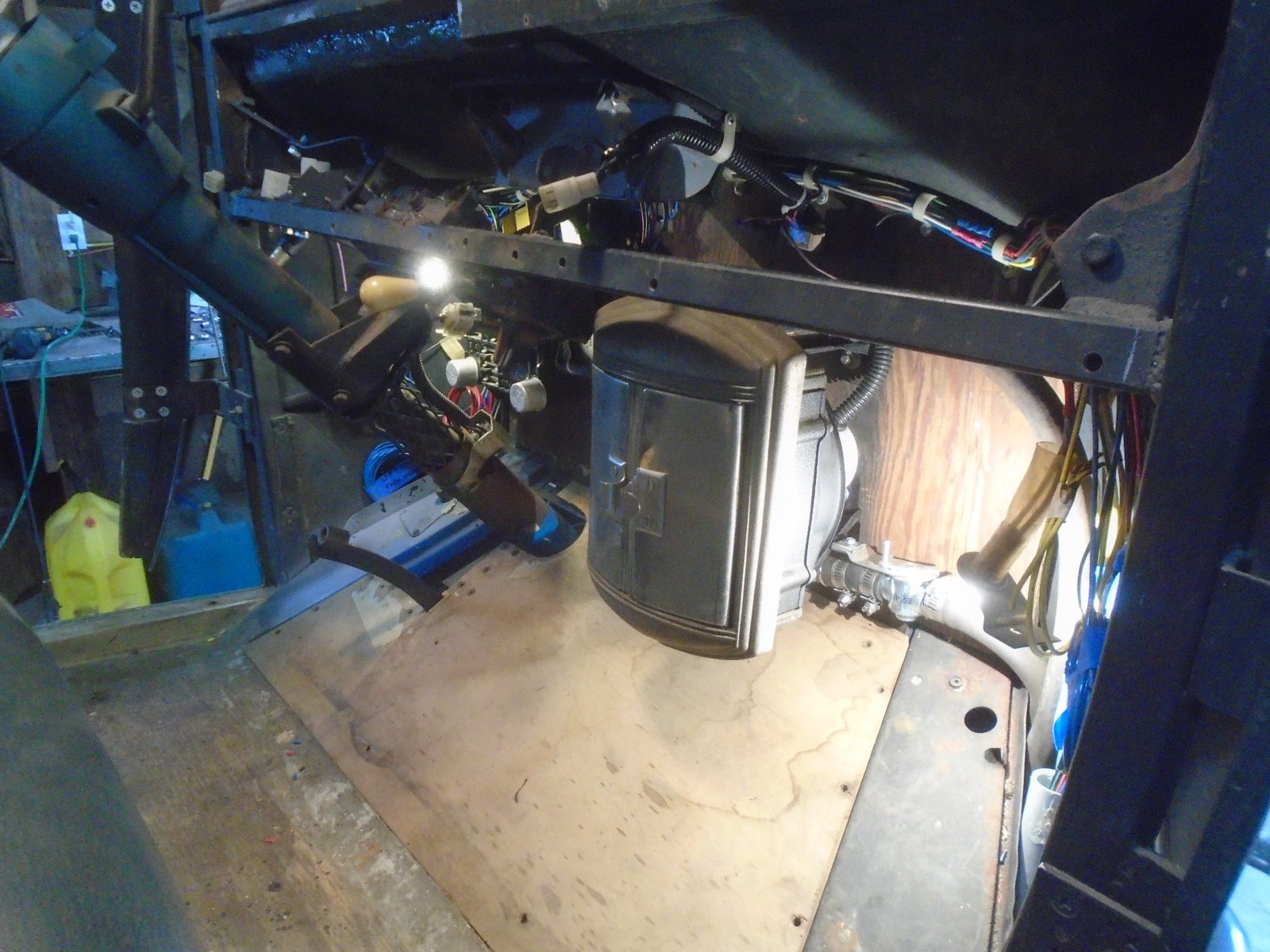

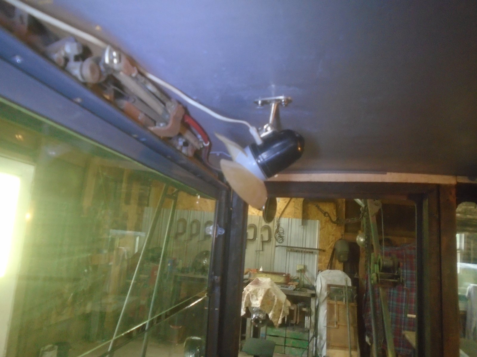

    This is the old 1930's heater that is mounted under the dash. It doesn't have any provision for the windshield defroster.
    So I have mounted a small fan with rubber blades up to blow air down onto the windshield for the defroster.

    Here I'm removing the sprocket from the pulley sleeve that fits onto the front of the crankshaft.
    I have a harmonic balancer with a nice clear timing mark that I'm going to mount on this sleeve.
    The seal sleeve is removed and the balancer is bored out to fit onto the flathead pulley sleeve.
    Before I mount the balancer, I need to put a pulley on the sleeve to line up with the water pumps and the alternator.
    This pulley is tack welded onto the sleeve and put back on the lathe to make sure that the pulley is running true before I finish welding it.

    The header panel over the windshield is fastened back in place. It has the sun visors and the rear view mirror mounted to it.
    The windshield defroster fan is wired up and working. I don't see this being used very much but it's nice to have when it is needed.
