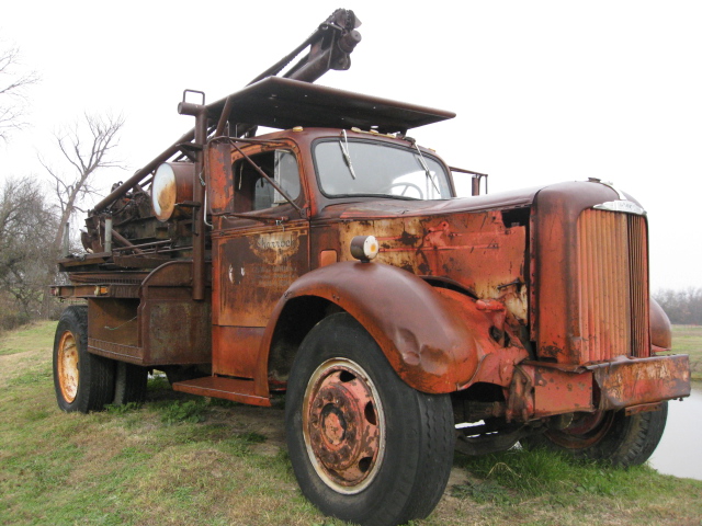

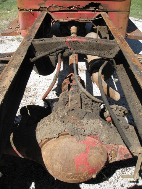

    I have been a little hesitant to post this because I didn't know how it would be received. But it seems that there have been some discussions on here about these old trucks, so I decided to proceed.
    I bought this 1952 Mack A54 a few months ago. It was sitting in a pasture and was likely destined for the s**** yard. I watched it on Craigslist for a few months, but it never sold. I had contacted the guy at one point just to ask a few questions. At the time, I didn't have the money to pay what he was asking. After hid ad expired, I waited about a month and then contacted him again to see if he sold it. He told me that it was still available and that he really needed to move it. I went and looked at it, we negotiated a price and I bought it from him.
    The story that I got is that it was used by an electrical contractor out of Dallas to install traffic poles many years ago. The pressure digger on the back was pretty well rusted and coming apart. The flathead 6 that was powering it had been rained in and was stuck. This is how the truck looked when I bought it.

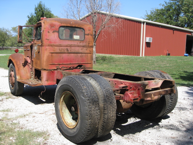

    The next step was figuring out how I was going to get it home. The tires were definitely not fit for pulling the truck down the road. I was going to s**** the entire bed anyway, so I was given the ok to start working on it there in the pasture. This was until I could get enough weight and height off of it to get a roll back in there. I finally got to the point where I could get it moved. For the next month or so, I spent my extra time cutting and hauling s**** from the truck. I hauled the last 1250 lbs of s**** on Saturday. Here is what the truck looks like now.

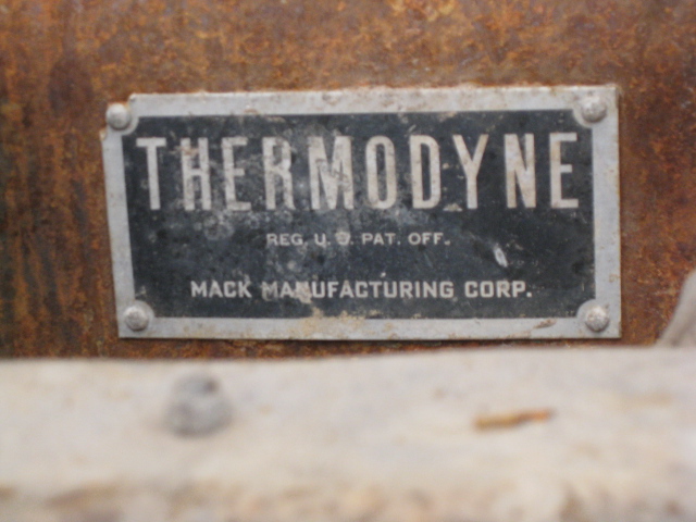

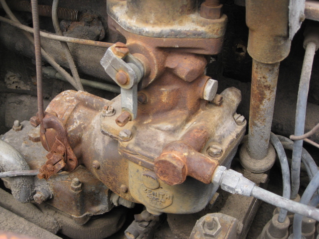

    I pulled the front fender off to get better access to the engine. It has a Thermodyne EN-510, Inline 6 cylinder gas engine w/ a duplex transmission. I pulled the dipstick and the oil looks clean. Is is not over-full and does not show any signs of having had water in it. Sunday morning early, I pulled the spark plugs and sprayed PB Blaster in the cylinders. I then started s****ing all the years of oil, grease and road grime from the frame rails. That brings me to where I'm at now. Here are some pictures of the engine.

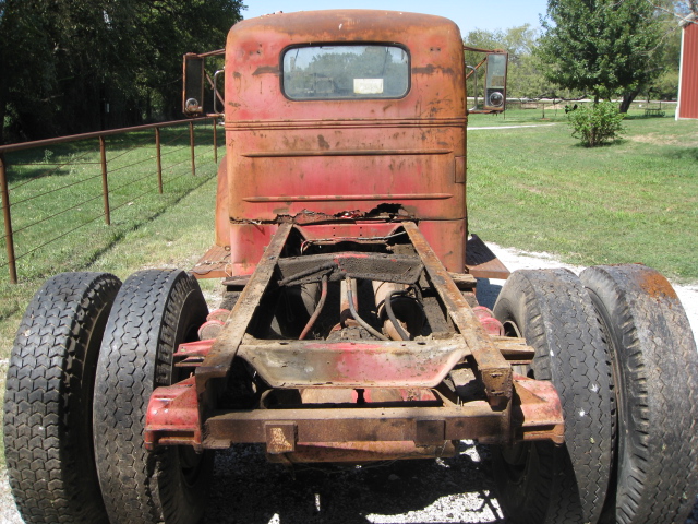

    I am currently out of town, but my next step is to see if the engine will bar over. I have a very good feeling that it is not stuck. Hopefully, it will not take much to get her started. Once I get her fired up, I will be able to move her in and out of my shop. This will allow me a little more flexibility as far as working.
    What are your thoughts on how this thing should go? I have a 10 year old son that has shown some interest in it. He is already asking me if he can drive it to school when he gets older!! I am a novice at this value the opinion of those involved with this forum. I look forward to your input.

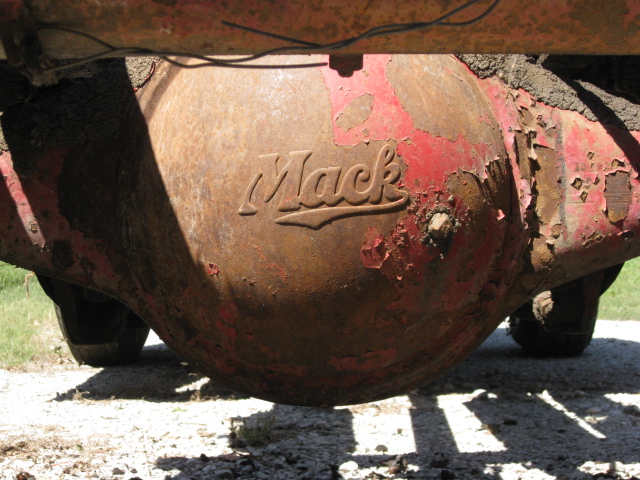

    Neat old truck. Love the "Mack" cast into the rear housing. Never seen that before, but can't say I've ever really looked over one of these trucks closely.

  21. O/P stated trans is a Du-plex, that means 5 in the main and 2 in the auxilliary trans. I used to drive a 5X3 and a 5X4 on and around the the farm. Tri-Plex and Quadra-Plex.
    Yes, you must progressively shift both transmissions and they have NO synchros either. Many old timers had their forearms broken while shifting both sticks and having their arm through the spokes of the steering wheel.
    There are some crazy you-tube videos on shifting 5X4 ******s in Screaming 2 stroke detroit deisels, you have to watch if you dig this thread.
    Just a suggestion, have your son practice shifting a regular car trans with NO clutch up and down through the gears before even attempting driving this rig.

    Before trying to start it loosen all drain plugs a couple of turns, any water sitting on the bottom will run out through the threads. Truck has air brakes with the old style bolt together chambers,the diaphrams for those are tough to find. A lot of those old chambers had mounts as part of their housing ,hard to replace with new style without some fab work. Did not see the air compressor in the pictures though. I use to collect BIG trucks a few years ago. Top speedon that truck any where between 50-65 MPH depending on gearing. Have fun !!!
